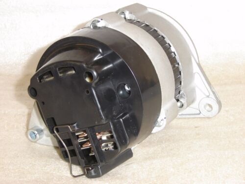

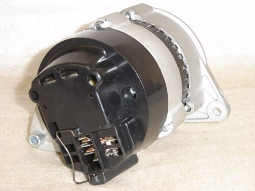

I found this on line when trying to get the original alternator number and I found this
Alternator - Lucas Style (12089N) - For Ford tractor models 2310, 2600 (, N, R, V), 2610, 2810, 2910, 3600 (, N, NO, R, V), 3610, 3900, 3910 (, H, N, R), 4100, 4110, 4600, 4600SU, 4610, 4610SU, 5110, 5600, 5610, 5700, 5900, 6600, 6610, 6700, 6710, 6810, 7410, 7600, 7610, 7700, 7710, 9030, Compatible with Ford Construction and industrial models 230A, 231, 233, 234, 333, 334, 335, 420, 455, 515, 530A, 531, 532, 535, 550, 555, 555A, 555B, 655, 655A, Compatible with Ford Engine (s) BSD332, BSD333, BSD442, BSD444, BSD444T, Replaces Ford OEM number E3NN10B376AB, E3NN10B376AC, E3NN10B376AD, Replaces Lucas manufacturer number LRA00530, Lucas Style, Design: IR/EF, Voltage: 12, Rotation: Clockwise, Amperage: 45, Regulator: Internal, Pulley: Class V1, Single Groove, NOTE 1:Battery sense through external thermistor on vehicle. Do not apply full voltage (14V) to wire, will damage regulator. Need to use 1/4 watt 200 ohm resistor between S-terminal wire (orange) to B+ to test., (Item #: 189295)
$123.00

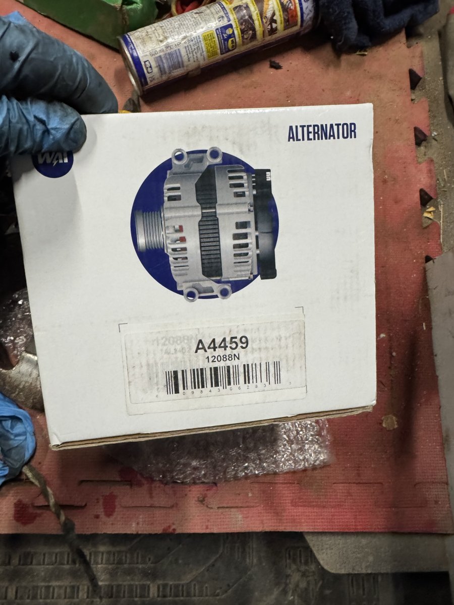

I called the local parts guys and they have a helpful electro diesel guy . I had found out that the original alternator number from the USA ad above was Lucas 12089N .
I explained this to him and that I needed one exactly the same but without the supply from battery thermister . He called me back with the Lucas no 12088N and said they had it in stock and delivered it this afternoon . It’s made by WAI .
I had a go at it when got home , The alternator didn’t have a pulley on it and the spacers and fan on it stopped the pulleys lining up correctly but when I took the old set up fan and spacers off the original alternator it all lined up perfectly .
It’s fitted and charging at 14.4V . When I turn off the ignition with engine running the alt light comes on and also ignition on without engine running so that all seems to be working correctly .
