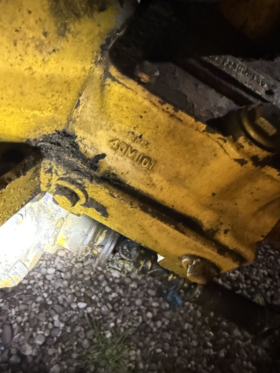

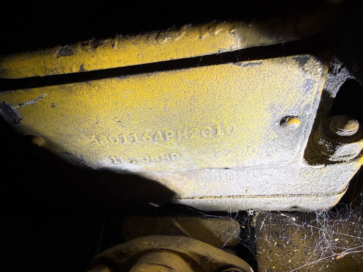

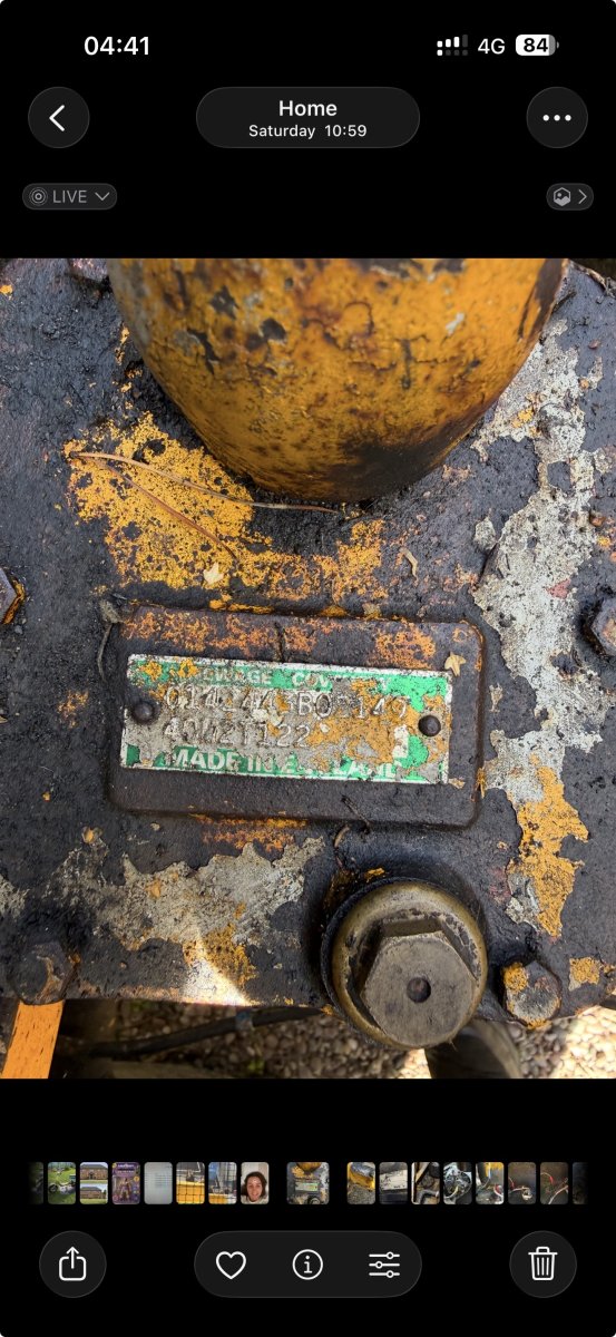

Oh it’s an old rod type, (petter engine) what’s the letter on the serial number,

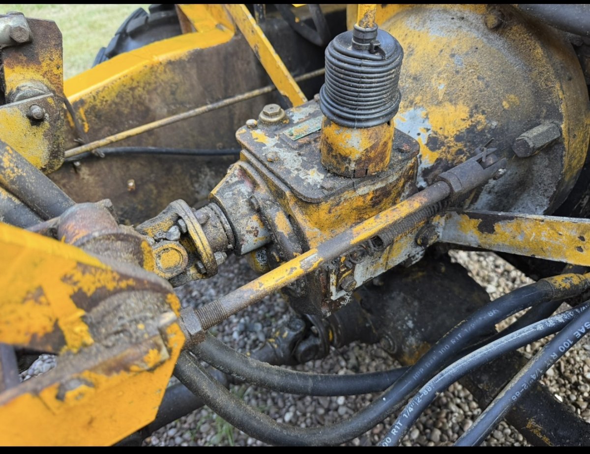

It was bathed in hydraulic fluid, 😂 so far none of the bolts have caused to much trouble, I’m tempted to use as is till it causes me problems, it was cheap starts on the button. Must be 40 years old now I can’t complain for what I need it for.

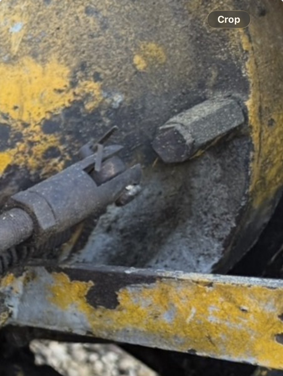

hvae you tried this 👇👇
slack off the adjustments until you have a little free play ... could well be over adjusted and being held off with the release bearing in constant contact/pressure
Mike_510
Not yet, I was looking at it, but I’m not sure how to do it, there is no resistance until about 1 inch from the stop in the picture, doesn’t look like I can shorten the rod, as clutch arm is as far back as it can go, lengthening it will take some of the slack, but will still only have 1 inch of engagement before the stop, does the clutch arm come off and have spline, in which case I could take off, and put back on set further back and would give me 2 inch of engagement, if that makes sense.

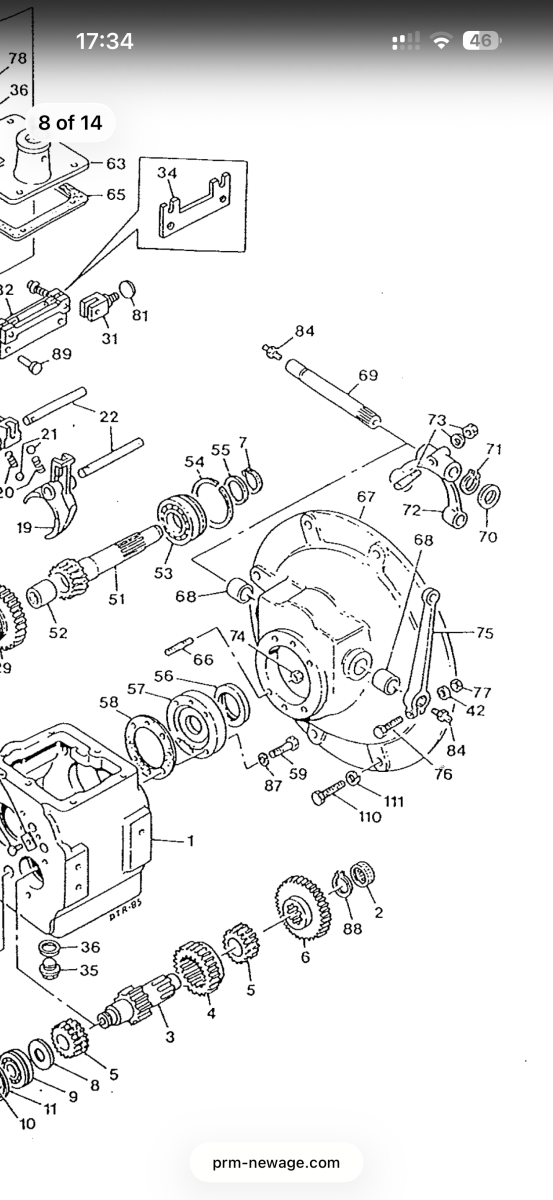

Number 69 🫣 does seem to been splined so it may work, rotate and refit would lose the free play and give more engagement.
box out then sadly

69 in the diagram is the splined shaft for the clutch
Looks like it attaches to 75, I was thinking if if it took 75 off, rotated the splines shaft 69 clockwise, and refitted 75 arm, say a quarter turn, it would loose the slop and give more engagement.
What you don’t want is the bearing under pressure plate load all the time!
