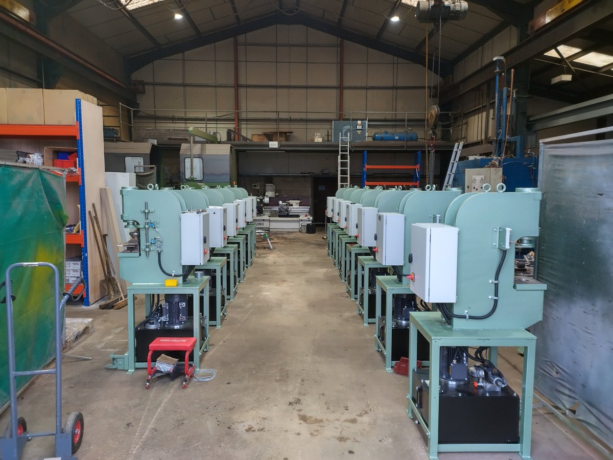

Hare punches Mike?? .... lot of 'em ! what're they going to be producing ?Production line in full swing, getting wiring in and HPU plumbed.View attachment 33087
All in the name of whisky. When we finish this batch that'll be 100 of these we've made in the last 20years.Hare punches Mike?? .... lot of 'em ! what're they going to be producing ?
nice work BoyoAll in the name of whisky. When we finish this batch that'll be 100 of these we've made in the last 20years.
"never a truer word... "Never have enough clamps
They are I think 16T for the most, there are some bigger ones at 25Tnice work Boyo... looked very much like Hare's small C frame presses .... what sort of tonnage are they ?
What are you doing with them? I’m none the wiser.They are I think 16T for the most, there are some bigger ones at 25T
The people who make whisky have to store it in oak casks for a minimum of 3 years before it can be called scotch whisky, there's 10's of millions of oak casks going around which need repairs and rework and one of the things they do is take the steel hoop off and remove the rivets holding it together and tighten it in slightly and fit new rivets. This is fitted back on the cask and driven on tighter then before and hopefully good enough for another term. The machines we have here are used to extract and refit the rivets.What are you doing with them? I’m none the wiser.
jeeeezus tha's a lorra rivetsThe people who make whisky have to store it in oak casks for a minimum of 3 years before it can be called scotch whisky, there's 10's of millions of oak casks going around which need repairs and rework and one of the things they do is take the steel hoop off and remove the rivets holding it together and tighten it in slightly and fit new rivets. This is fitted back on the cask and driven on tighter then before and hopefully good enough for another term. The machines we have here are used to extract and refit the rivets.
So you build the punches?The people who make whisky have to store it in oak casks for a minimum of 3 years before it can be called scotch whisky, there's 10's of millions of oak casks going around which need repairs and rework and one of the things they do is take the steel hoop off and remove the rivets holding it together and tighten it in slightly and fit new rivets. This is fitted back on the cask and driven on tighter then before and hopefully good enough for another term. The machines we have here are used to extract and refit the rivets.
no the C frame presses the punches are mounted in ...... the green things DoobSo you build the punches?
