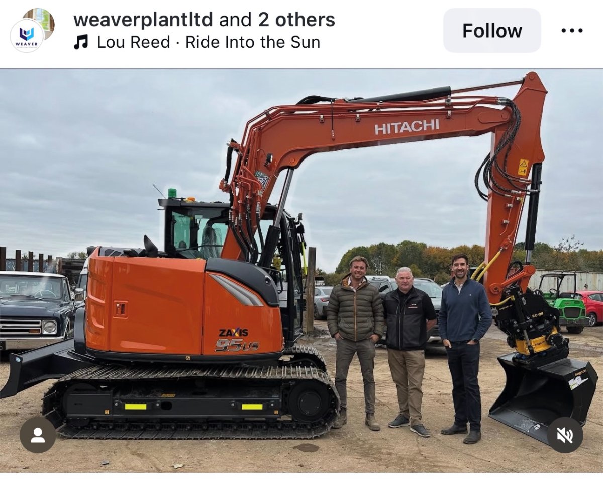

I have had mine for about 5 years. Only disappointment is I think it is a bit slow on tracking. Mine has rubber blocks which I don’t think help. Think I am on about 5500hrs
Is your one a -3? Spend a while on one of them! Damn good machine. tracking and bucket curl was always my gripes
Thats a -7, tracking speed/ power and curl/cycle times are on a different level:love:

looks good - i spent a bit of time in an ex100 hitachi a fair while ago now but i really liked it - since then my own machines have all been kingpost, plus's and minuses really i think.
is it your first tilty machine ?

Exactly theres good bits to both but in my mind the tilty kinda fixes some of the short falls?
Yes first one of my own, first time using one on a 8/9t class machine first time with rototilt!
Have maybe 500 hours on 14t machines with tiltys...so im hoping i get as much benefit on a 8t as i found on a 14T

yes i imagine your right about a tilty making up for some shortfalls over kingpost machines, people who like them certainly seem keen to stick with them, guy i know likes them over a king post machine enough to special order them.
suppose the only people qualified to comment are the people who have had plenty of seat time in both, otherwise theres far too much choice supportive bias going on, like on faceache.
I’d like a 8/10ton mono fixed boom with tilty.. so long as your not going into moderately tight spaces I see no disadvantage! Visibility is solved by booming up or a decent camera setup - which most new ones have as standard now anyway!
Kobelco dont make a VA boom in that configuration at this time (few dealers in Europe retrofit/ modify) also i have enough new buttons/rollers to learn without that :ROFLMAO:

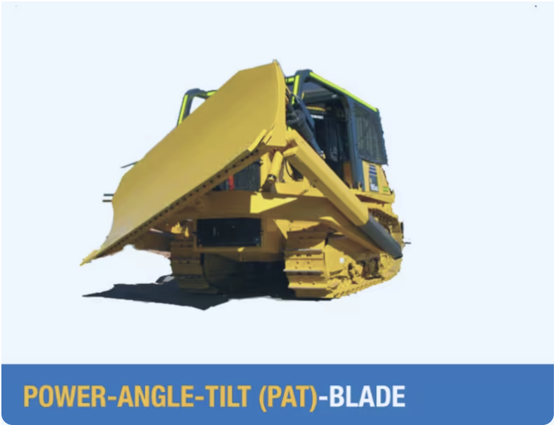

PAT blade???
6 way blade adjustment
"Power Angle Tilt (PAT) Blade​
The Power-Angle-Tilt (PAT) blade is one of the most versatile dozer blades, known for its ability to move in six directions (up, down, left, right, and tilting forward or backward.) This range of motion gives operators excellent control, making it perfect for tasks like grading, land clearing, working on slopes, landscaping and road construction, where precision is key. Its flexibility allows operators to adjust on the go, even on uneven surfaces, for smooth and accurate results. "
would be nice to have had the 'blade runner's' blade set up :cool:

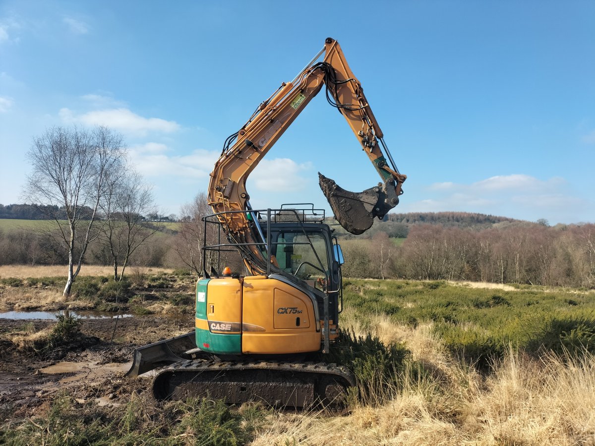

Pretty much. Bigger machine for bigger space. I wanted a mono boom for the project I was going. I think they are better for lifting and it was having the tilty put on!!

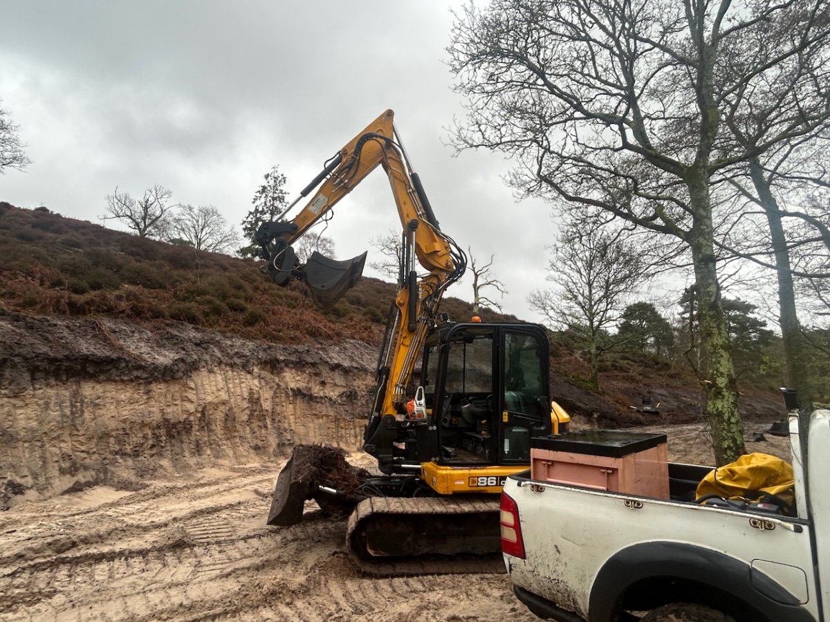

Kingpost obvious benefit of working in line with tracks or digging along side a fence or whatever but really for me this was where the benefits ended. The monoboom on my case lifted better and in close-as per pic I could swing a bucket of soil around in a tighter radius than my 3 ton takeuchi! Plus with the grab on I could work in really tight areas building walls because the bucket/grab works so well in close to the cab, visibility so much better and having all the weight of the arm back in close to center of gravity it was just a weapon- plus lack of wear compared to kingpost. For my work if I was ordering an 8 tonner now it'd be mono all the way.

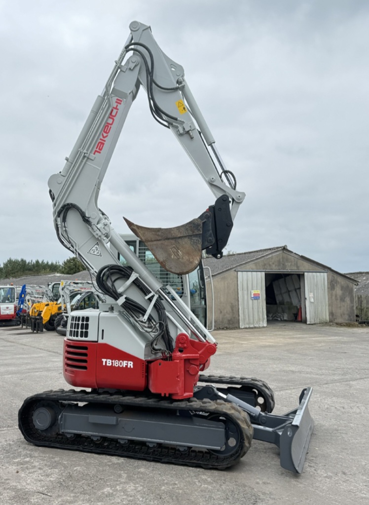

I still think this is more versatile.
