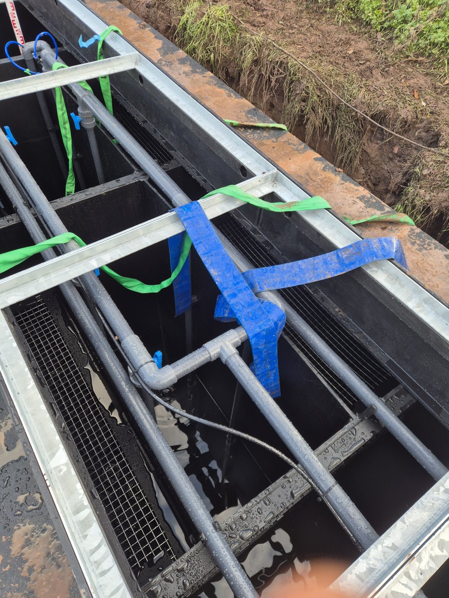

Chuck a 9” perf pipe in the corner where your pump is.. can just drop a pump in. backfill the whole thing with dry mix! And fill the thing with water! (Without teaching you to suck eggs!!)
We need to take the water away as it will end up washing the corner of the tank away. The pump has been running 24hrs a day since Tuesday so will put a chamber in otherwise we will end up constantly burning pumps out along with the electric cost

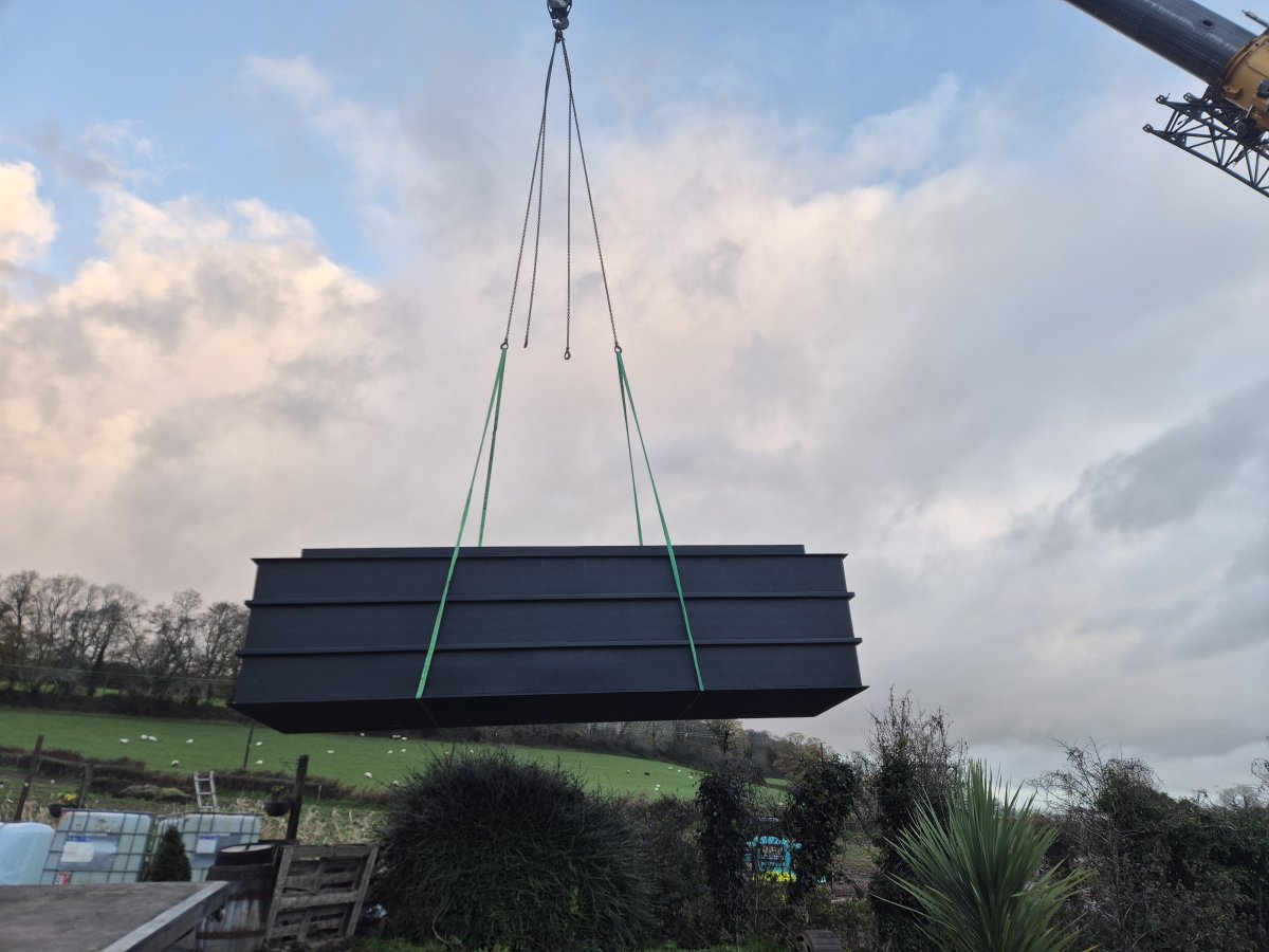

She's in and concreted

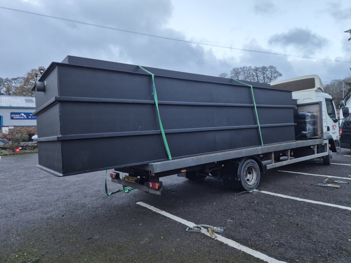

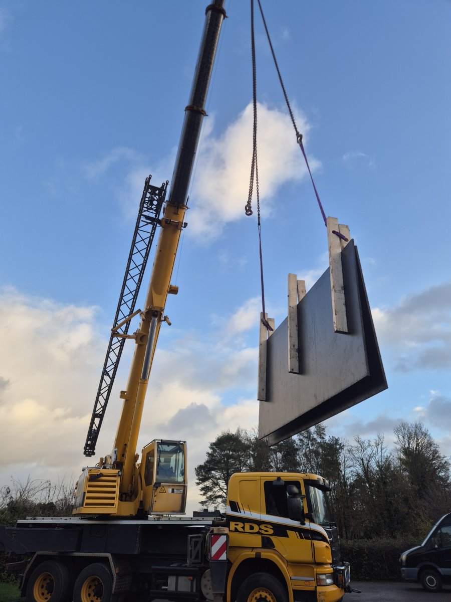

really PO-ed I didn't make it ... Russ said it went well this morning ... and enjoyed you guys' company over a coffee after :cool::giggle:. ... he's a good bloke is our Russ
looks like they need a bigger truck though :oops:
Yeah had a good natter with Russ, nice guy.
In 1st time.
Lorry turned up I thought the hole was too short got the measure out pretty quick lol
You drop the pump into the pipe 😉
