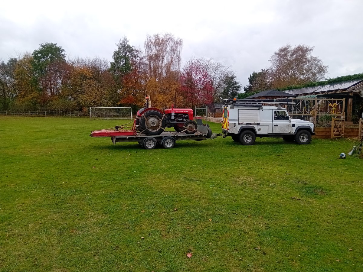

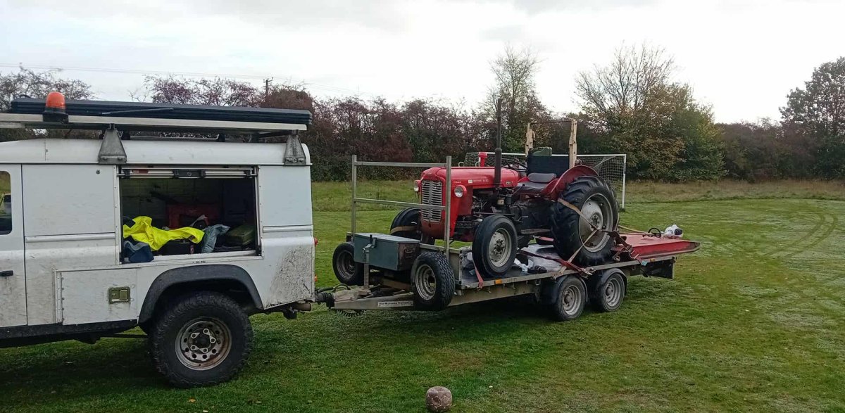

Days topping and striming around the outside of the football pitch👍
Robot mower keeps everything in really good order, apart from the long stuff, which had gone wild.

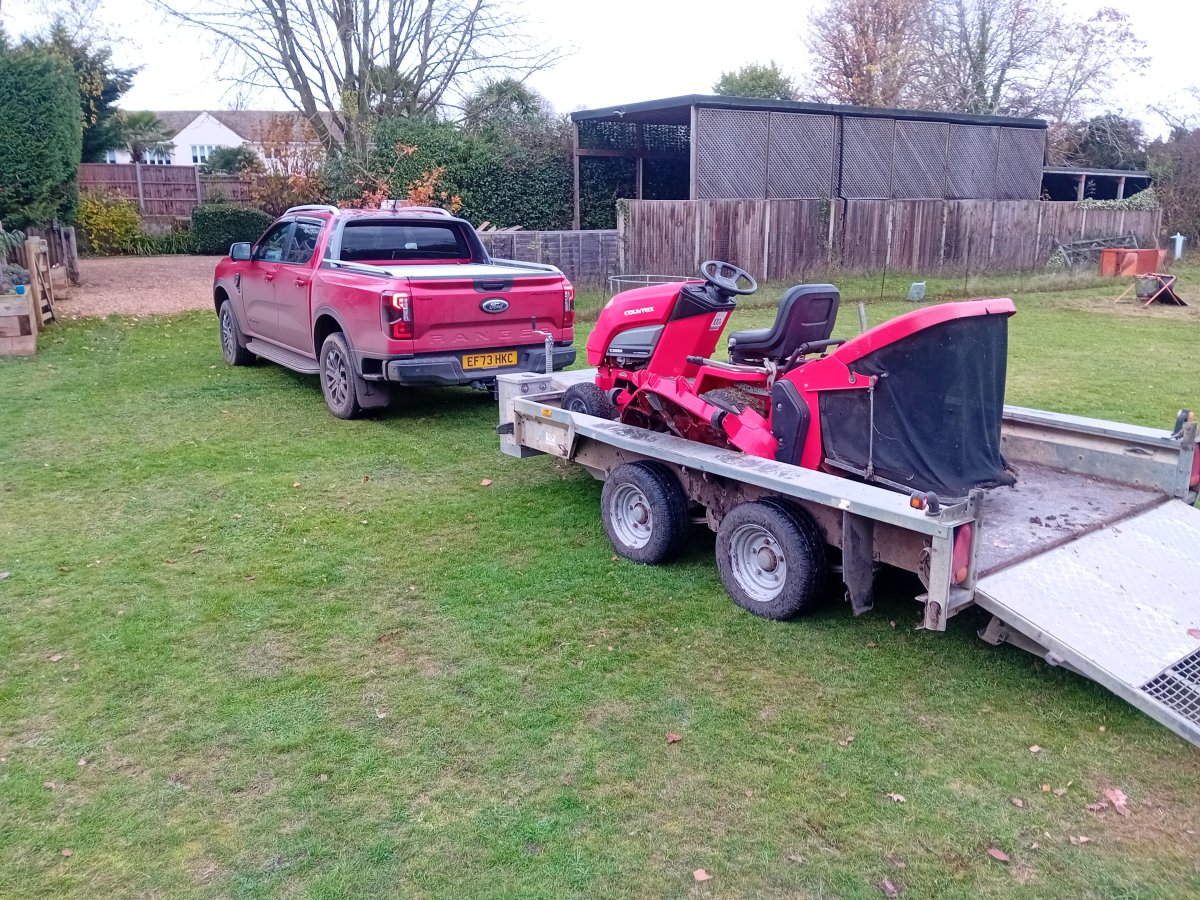

Customer said 'can you do me a favour and take this old ride on mower away please? There's something wrong with it.'
Er yes, I think I can do that 😆 even has the rough cut/mulching deck, and a second normal deck!
Looking forward to seeing what it needs to get it going (apart from a track rod, which we managed to snap pulling it up the ramp by hand!🤦🏻🤣😂)👍
to quote Vinny " you lucky bast**d !! " :oops:..... 's a grandsworth of Countax an' another 300 quidsworth of deck :rolleyes:
Honda or Briggs/Vanguard?
