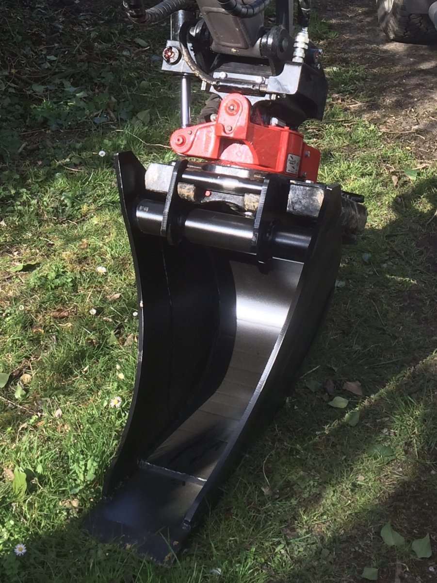

We often have foul and vent in same trench 240mm is about perfect - quite like the taper although we are 9o% of the time shallow with our runs, suppose the taper will help stop material packing in though...
I really like my tapered bucket. Its done a few jobs now, and is a lovely shape under the tilty. I've been thinking about having another one maybe slightly wider. 150mm at the bottom is good for land drainage but foul pipe is tight.

@CPS I have one of your 300mm nordic trenching buckets and its a nice bucket, what does the taper add if your not going deep ?
After a 240mm bucket for the 6t - dont seem to be able to get one this narrow on s40 for the 6.5t machine.....
Been using an old 240mm on the 3t today and its very worn so the sides come right down to the blade , it makes a really tidy job.

This is the tidy little bucket from the 3t
Hmmm not sure whether taper would serve much purpose for our work ....trenches for foul are usually shallow so not much wants to drop back in , and never really need to batter it to clear tilty 🤷‍♂️
If tapered it poss wouldn't want to be too severe,so bucket would need to be quite tall, unless more material could potentially be needed to backfill, for foul we bed a couple of cms depending on going, then pipe followed by +/- 20cm of bedding material and then warning tape before backfill.

The beauty of a taper bucket as @CPS says is that it can be made to suit your job

My tapered bucket is 200 to about 400 I think, I mainly use it in trenches more than 600 deep, as well as saving on shingle it gives you more room to work in the trench and you don’t get your trousers so dirty 🤣
