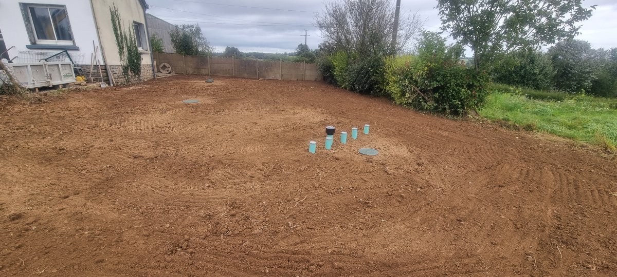

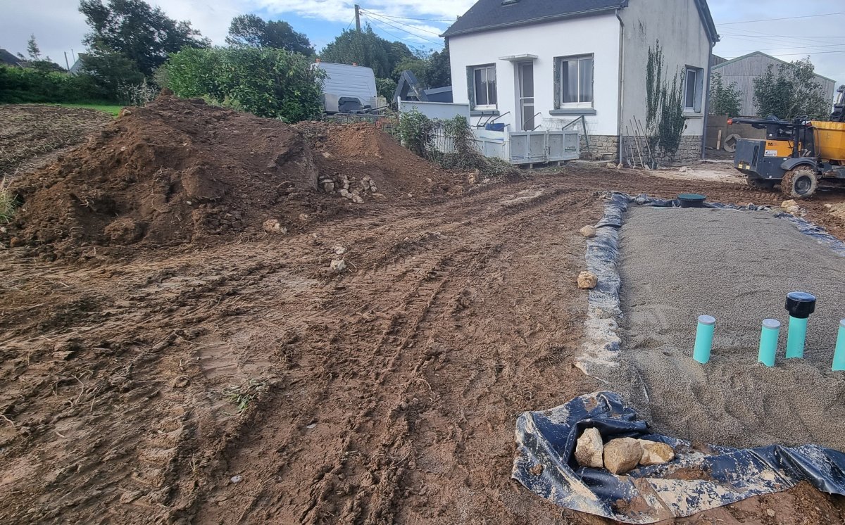

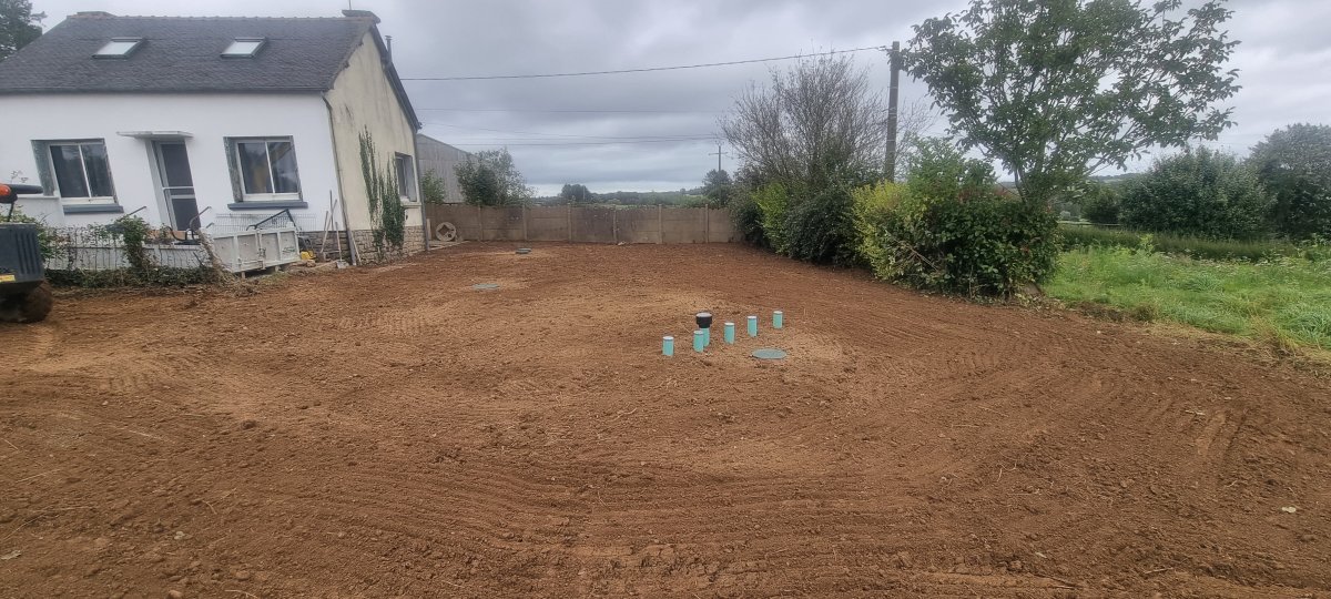

Lots of arisings and not a lot of space meant some messing to get it all back something like.

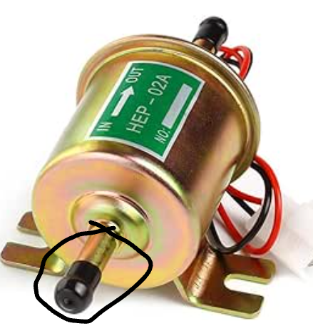

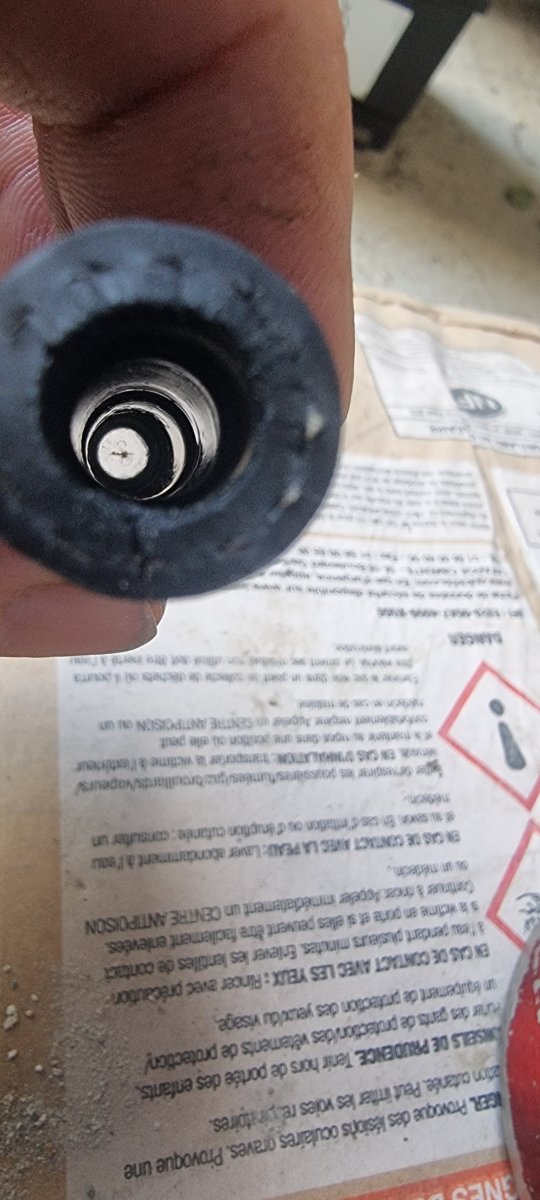

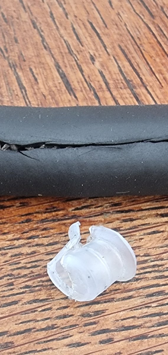

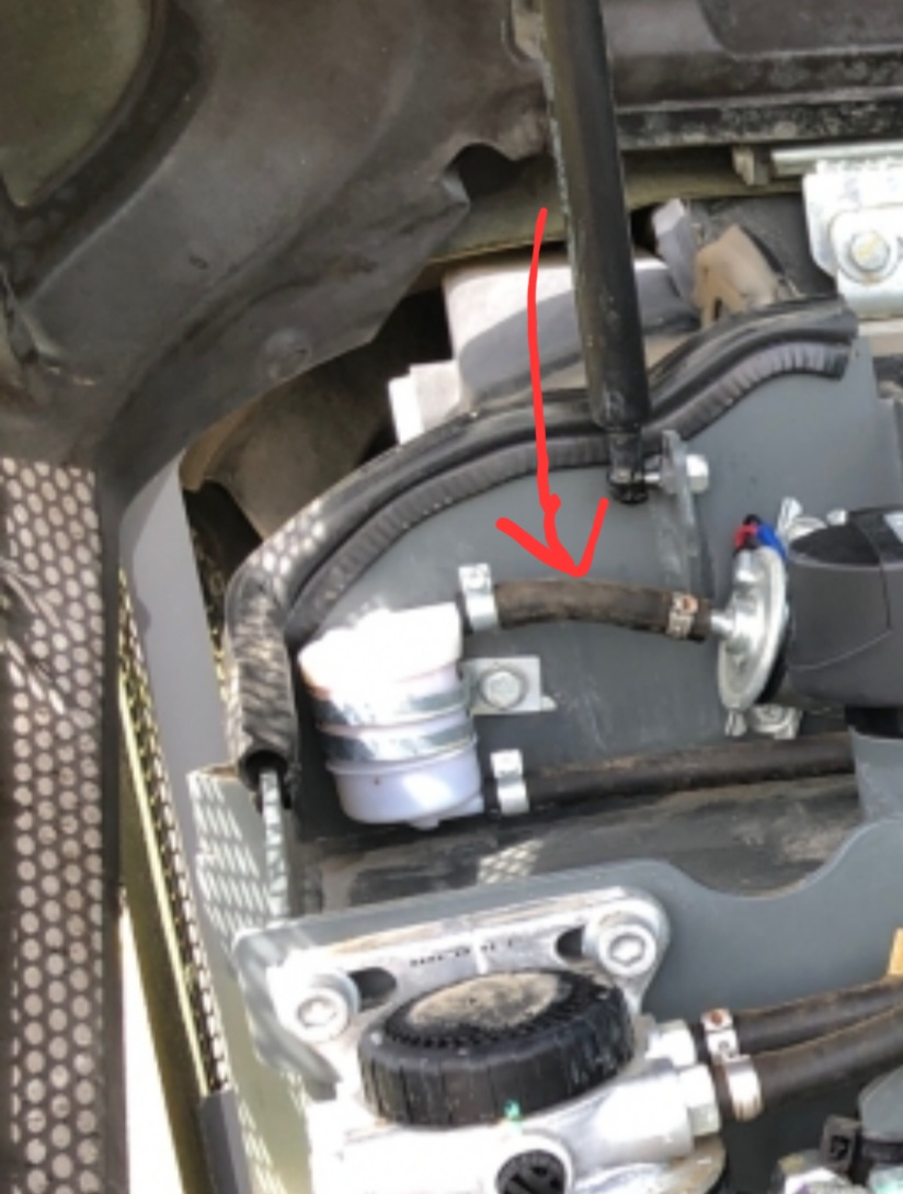

Wacker seemed to starve of fuel occasionally last week, it had run short of fuel so changed filters, when tried to prime up ut wouldnt draw up from tank, suspected little pump but changed this piece of pipe out that seemed not to want to let any fuel through in any direction after it filled up filters like normal, seems to have a one way valve in it that is buggered, would stop fuel draining back to tank.
Cant see generic replacement online🤷‍♂️

A one way valve inside the bit of pipe? Not come across that before, sounds abit restrictive? does everything work fine with a normal bit of pipe?
Just pop one of these in some new pipe
That was my idea 👍 - yes all seems to run fine with a normal piece - cut pipe open and it looks like it could even be a blank off the end of something :) im no mechanic and often thinking of 3 things at once so my stupidity knows no bounds !
Maybe someone will enlighten me.
groundworker
groundworker
Definitely looks like a bung, like the male version of the caps on a new inline pump/filter.
Surprised it would run at all like that, when was it last worked on?

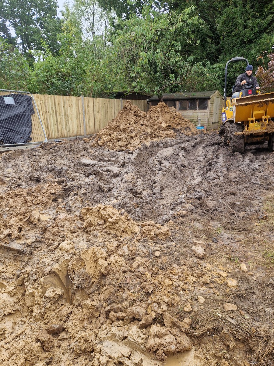

This weeks load of fun little micro earning its keep but deffinatly a job suited to a bigger machine rain makes tracking around a pain in the ass would love steel tracks on it but not sure they can be put on a micro its more like trench warfare rather than groundworks

Wheeled dumpers are an abomination on most domestic groundworks at this time of year.

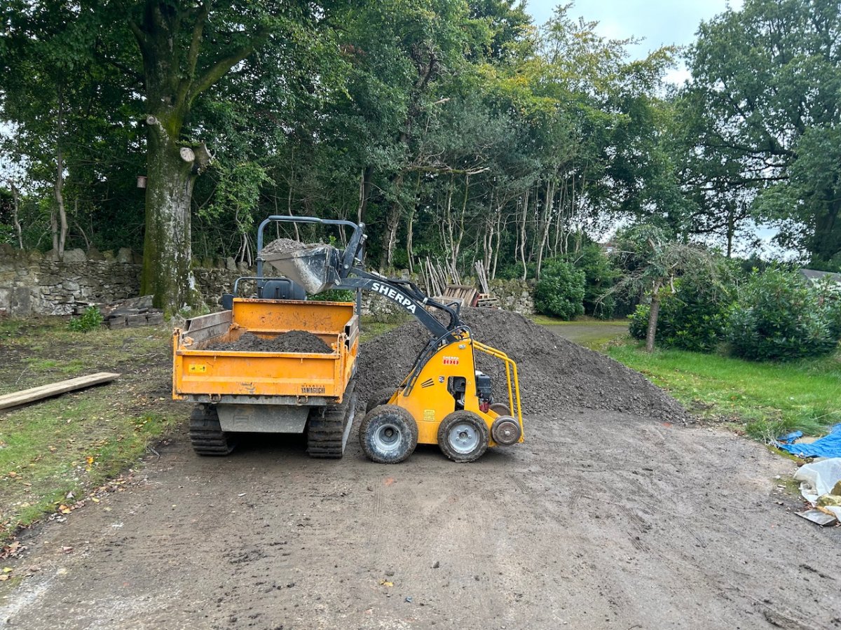

Little Sherpa earning her keep today. Will fit the other wide tyres when I get a moment!
