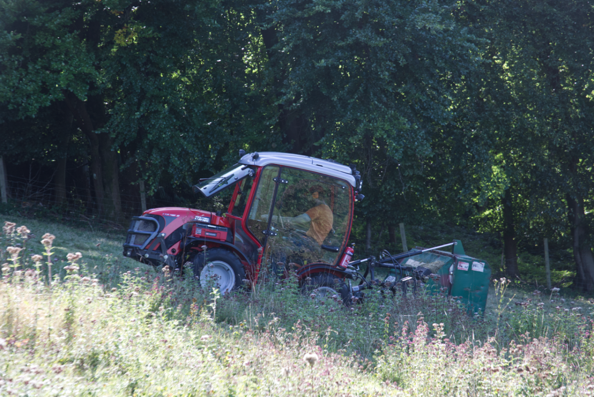

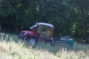

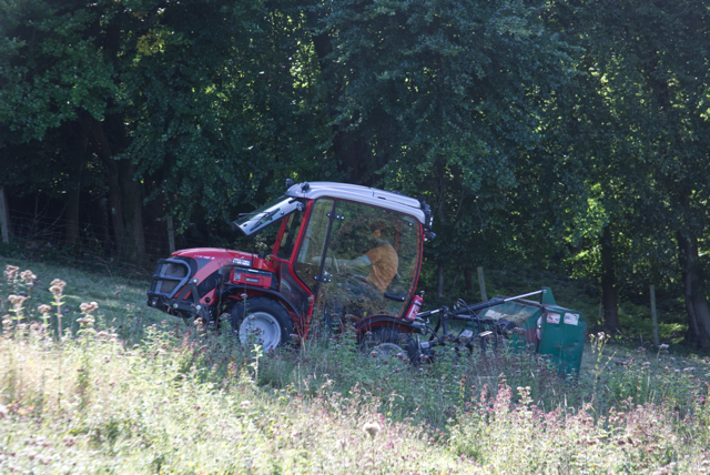

Busy week on cut and collect whilst the weather is good.
Poxy alpine has s**t the bed again. Air con failed for second time and then yesterday a steering pipe blew. For a ‘premium’ brand (it’s the premium of all alpine tractors) it’s not doing great. Very glad I got a five year warranty. When it works it’s just the tool for the job, and I should easily do the 3000 hours of the warranty in five years.

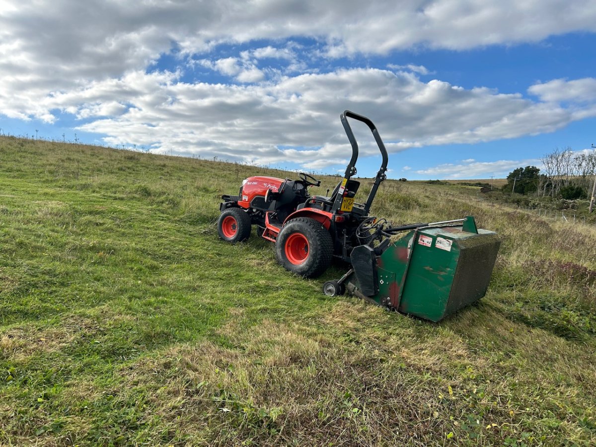

So Kubota and some flatter ground today.

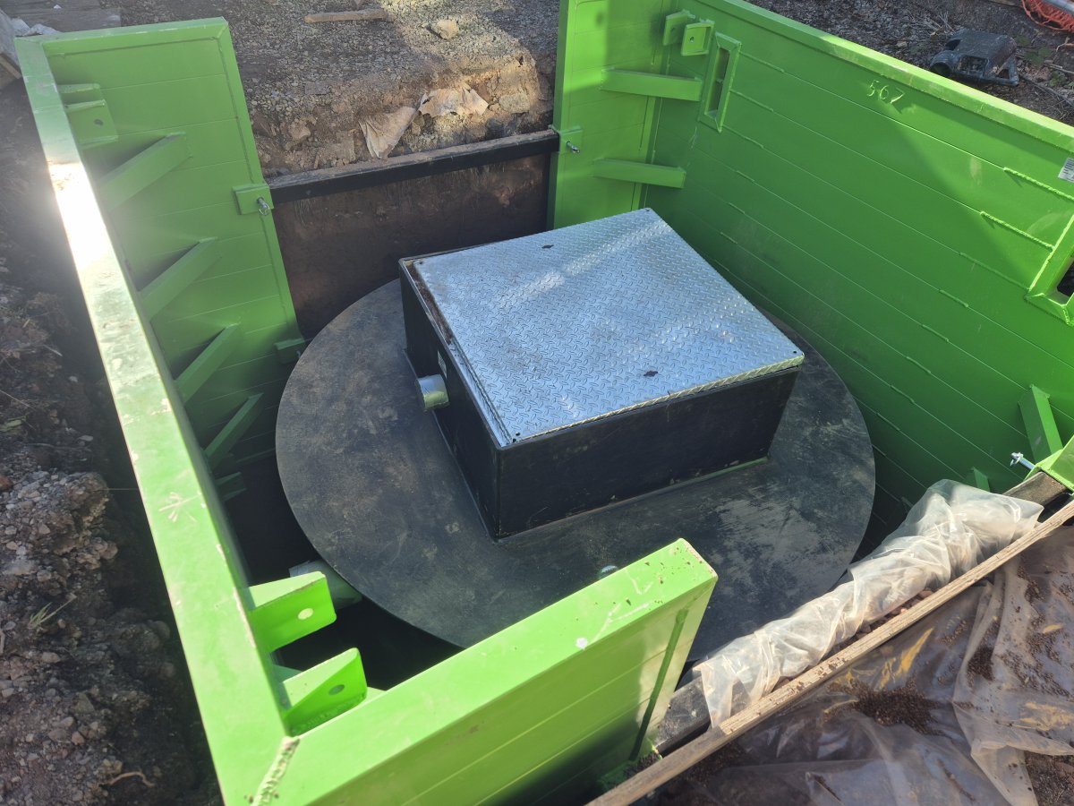

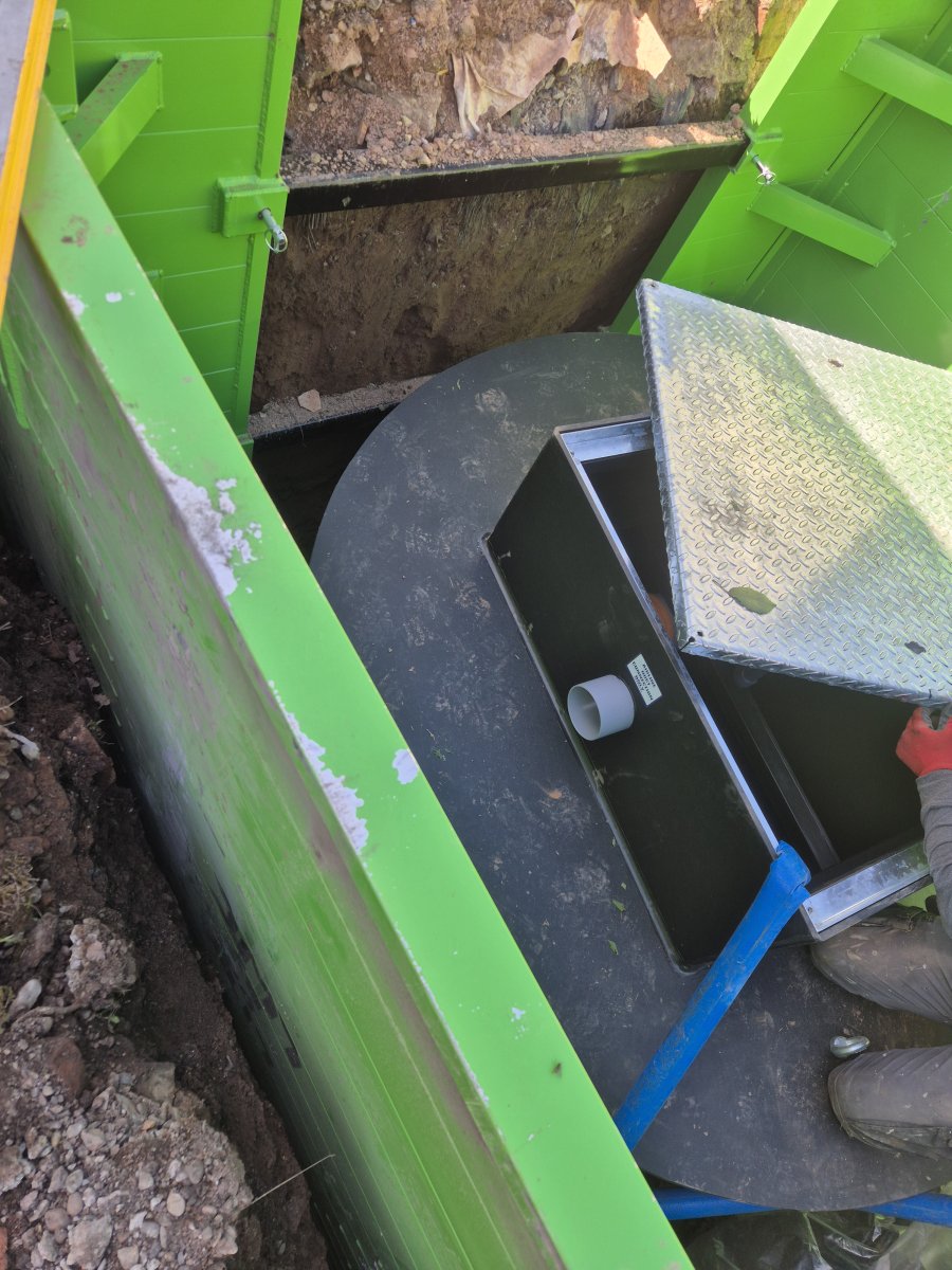

A question… if the ground is that bad, what happens when you pull the box and everything caves into the side of the tank…. Because normally on manholes etc you’d shutter the rings in & concrete before removing the box?
Are you lifting and backfilling at the same time?
Or you’d have sheet piles and pull them out after back filling..
abit of a chicken/egg situation?

Lean mix and it should escape ?
I’d concrete rd it with some celotex etc lining bottom of box then fill with gravel and lift in stages until you’ve only a 1m left etc

We kept the box up on 4 ledges so it was approx 600 up, then backfilled further up again, the grd surprisingly held but we were more concerned about getting the base in level and flat safely
