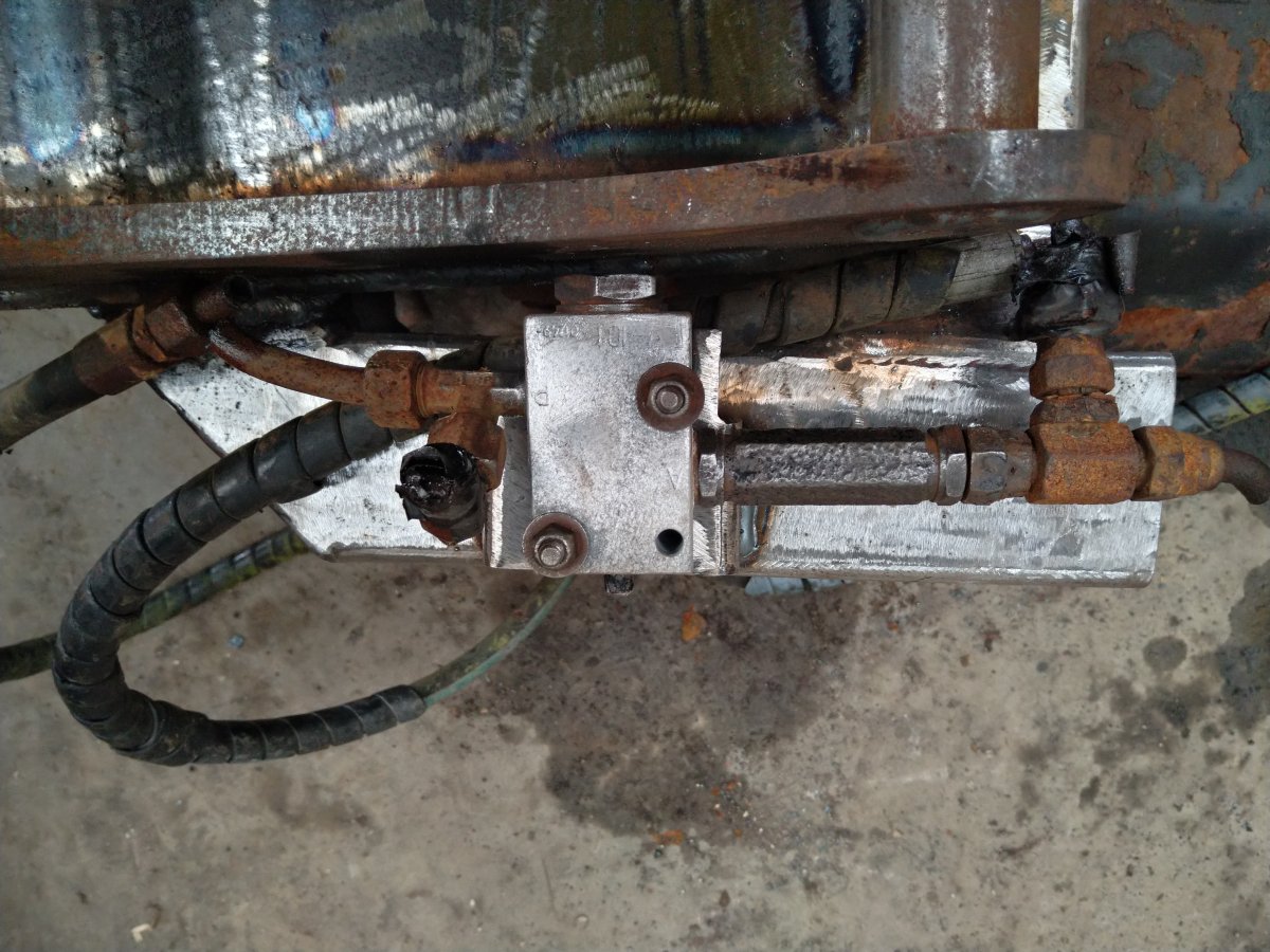

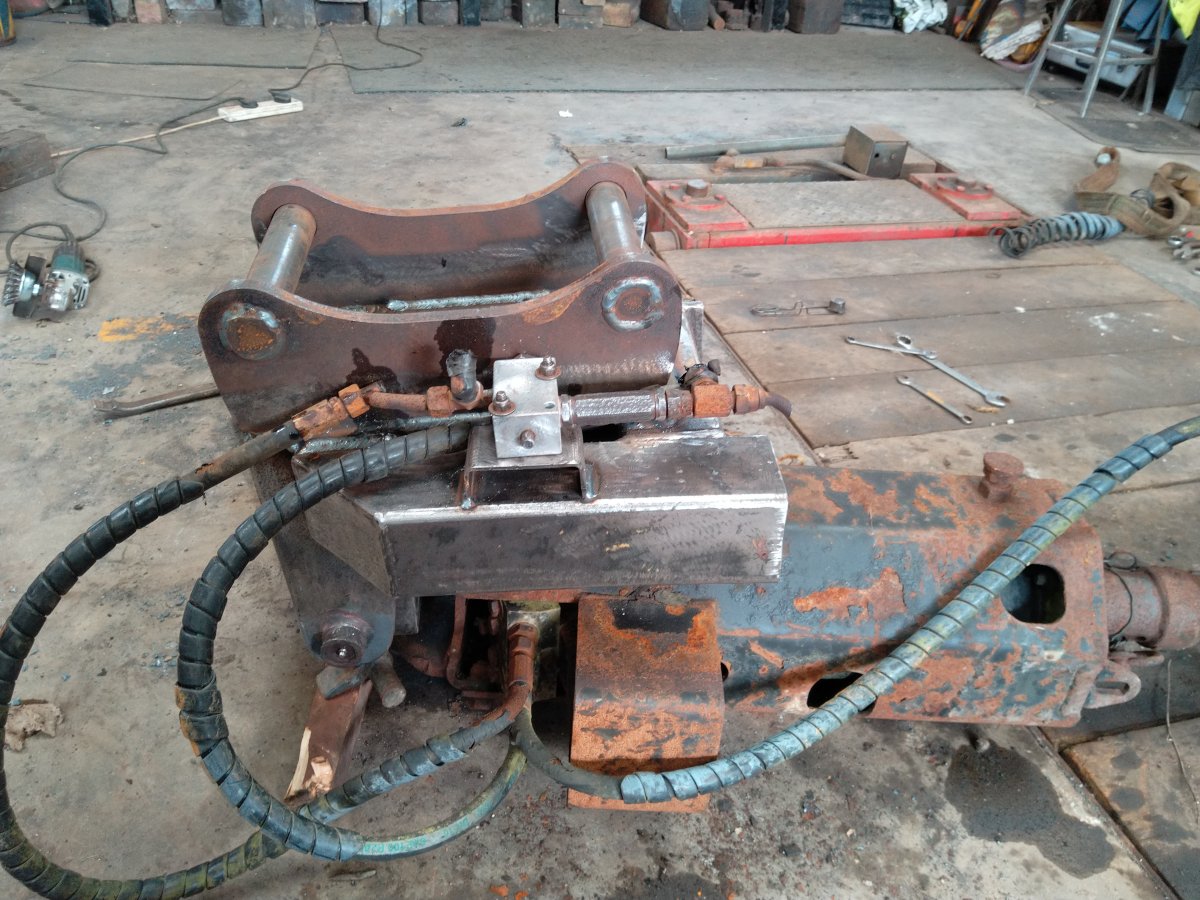

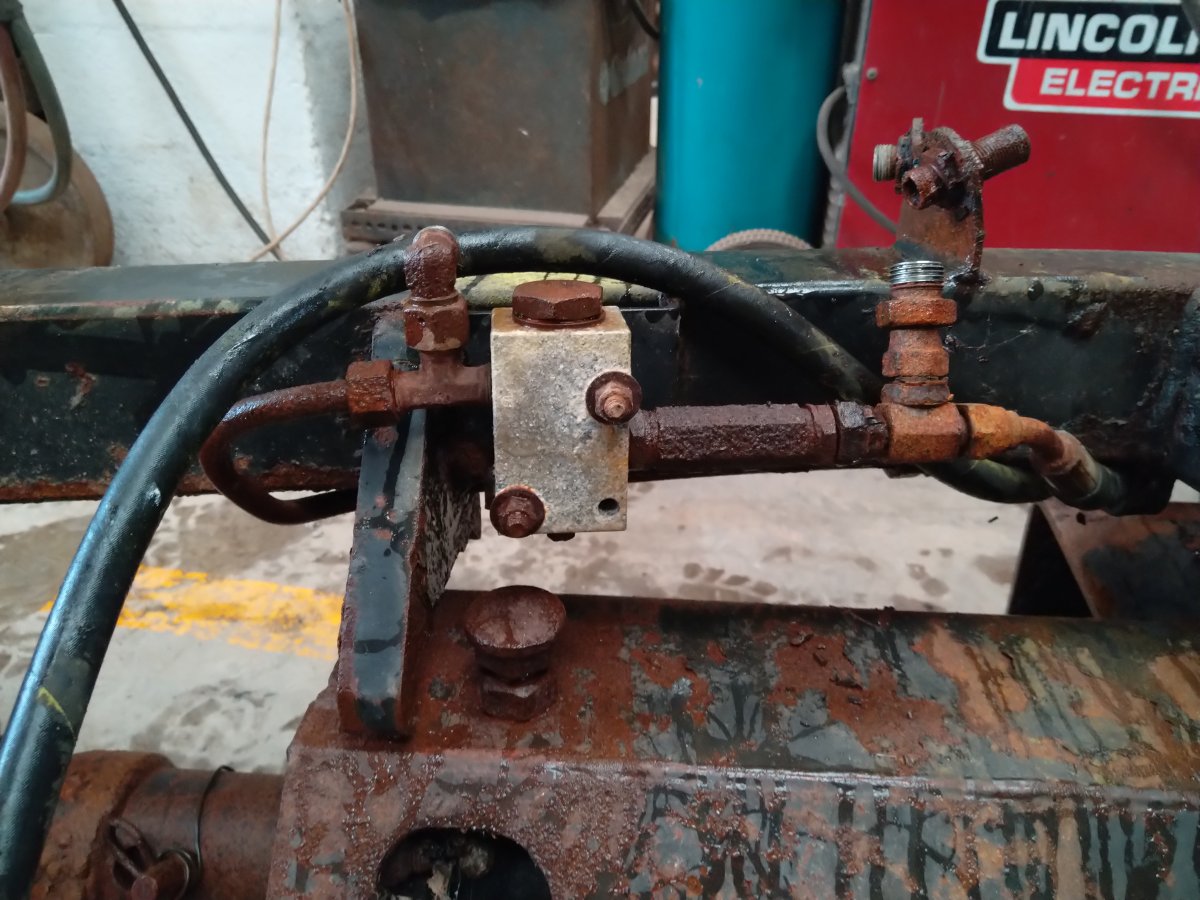

Any guesses as to this part is , both are power for directions that go to it is it a crossline relief?

need some form of CLRV or the motor'll stop dead, when the P line is disengaged ... a check valve tee-ed across the P & T appropriately will suffice... issue with doing it that way though is the motor can be run in both directions, so realistically needs to be a dedicated CLRV
So I will use the one that's come off it 👍
Just got to make a new home for it as where it was liberated from ain't no more 🤣

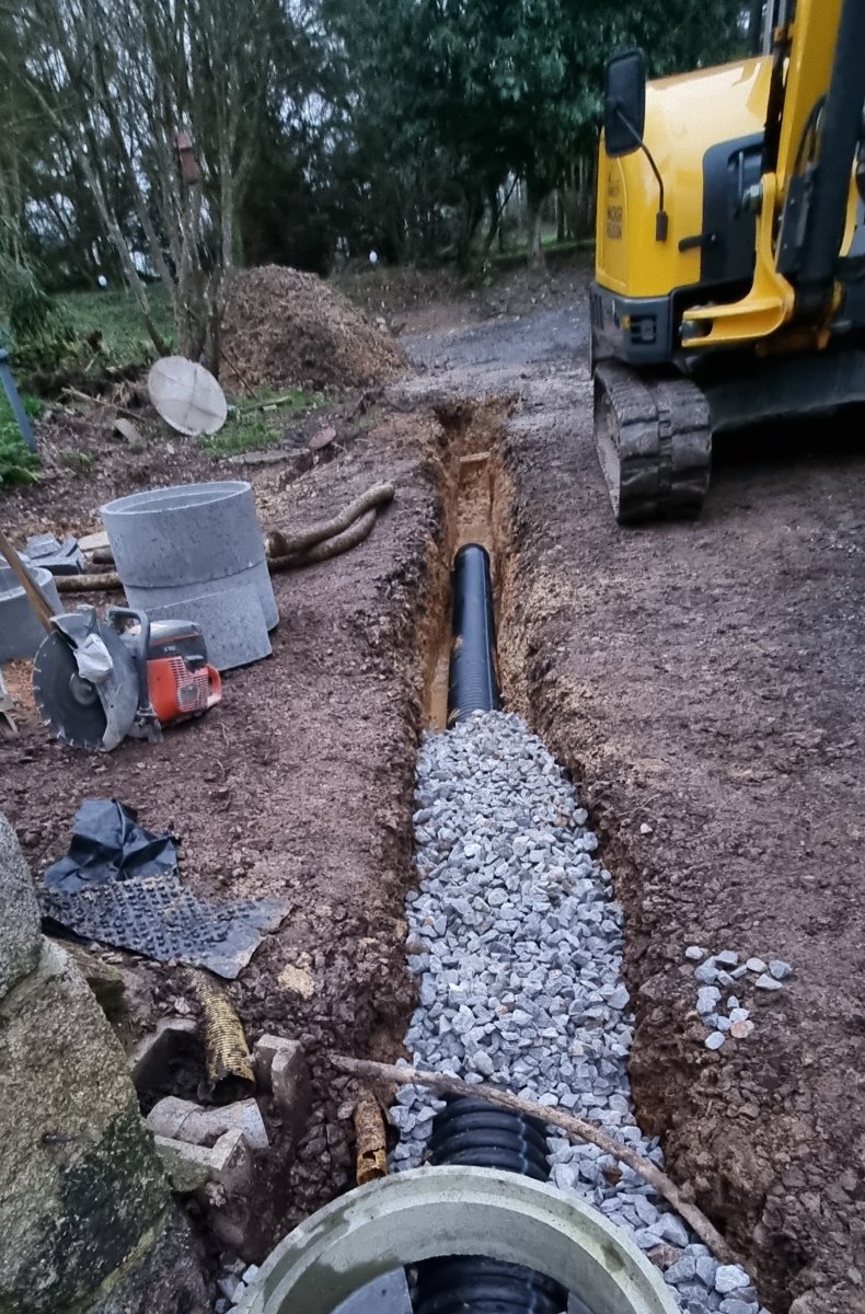

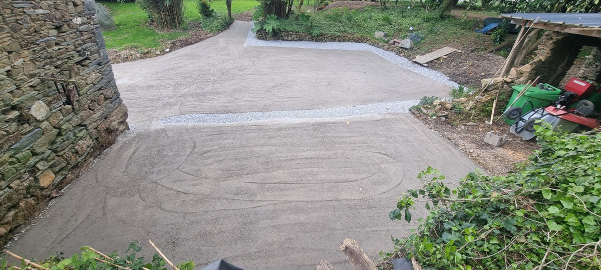

Todays job... its to gravel at some stage after the renovation work on the house but this scheme should dry it up ....drains and gravel up to surface to isolate the parking areas.
Bit of an improvement since we first went to put some drainage in and change a knackered tank.

Is it linked to a case drain on the motor?
It's the outer 2 pipes on the motor that join at that block the middle pipe would just go up the arm as it's longer than the other 2 🤔

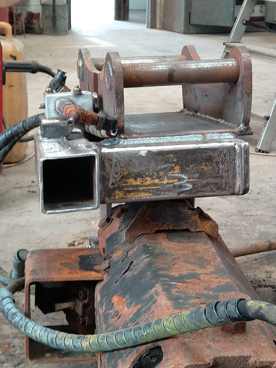

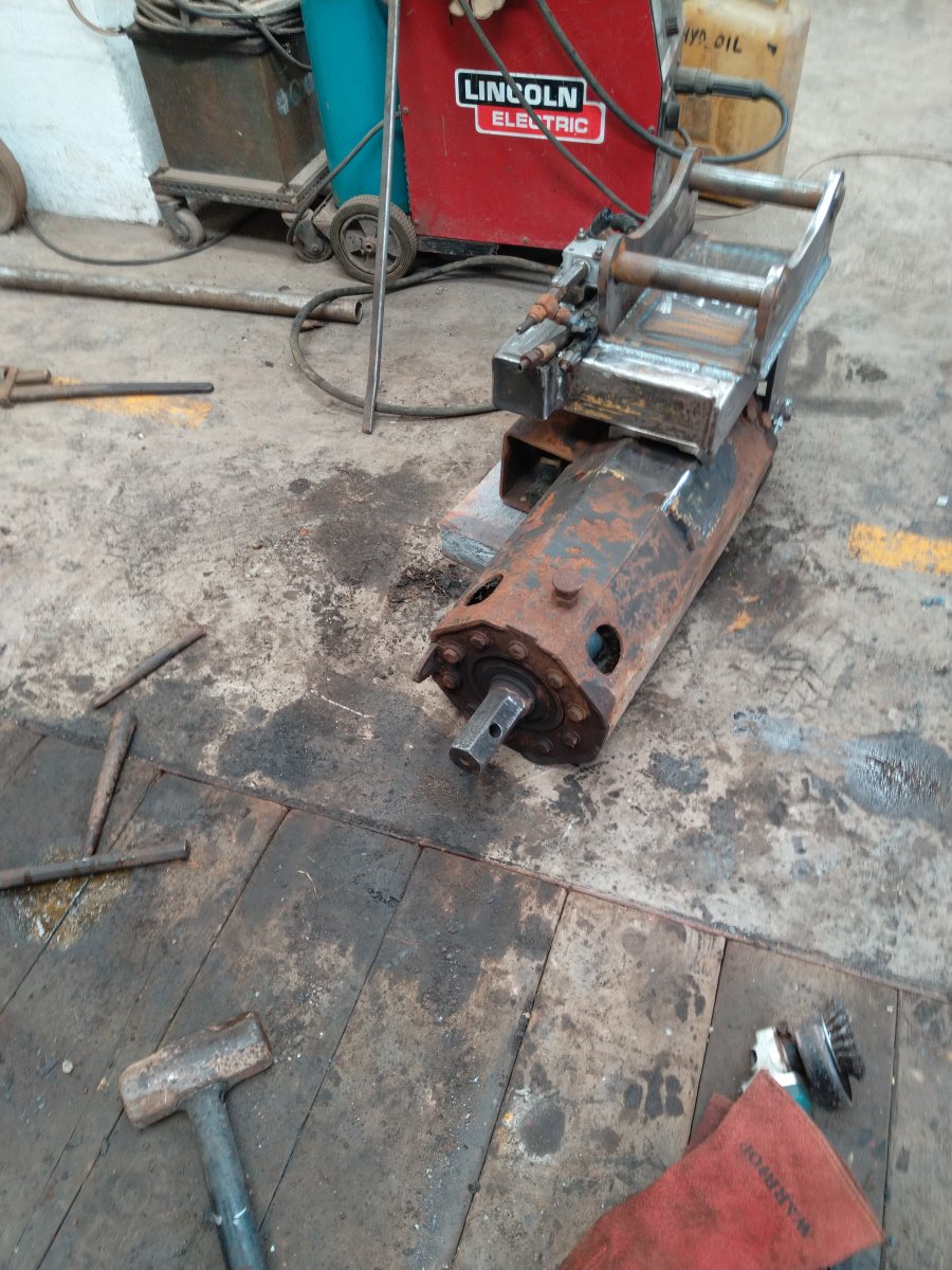

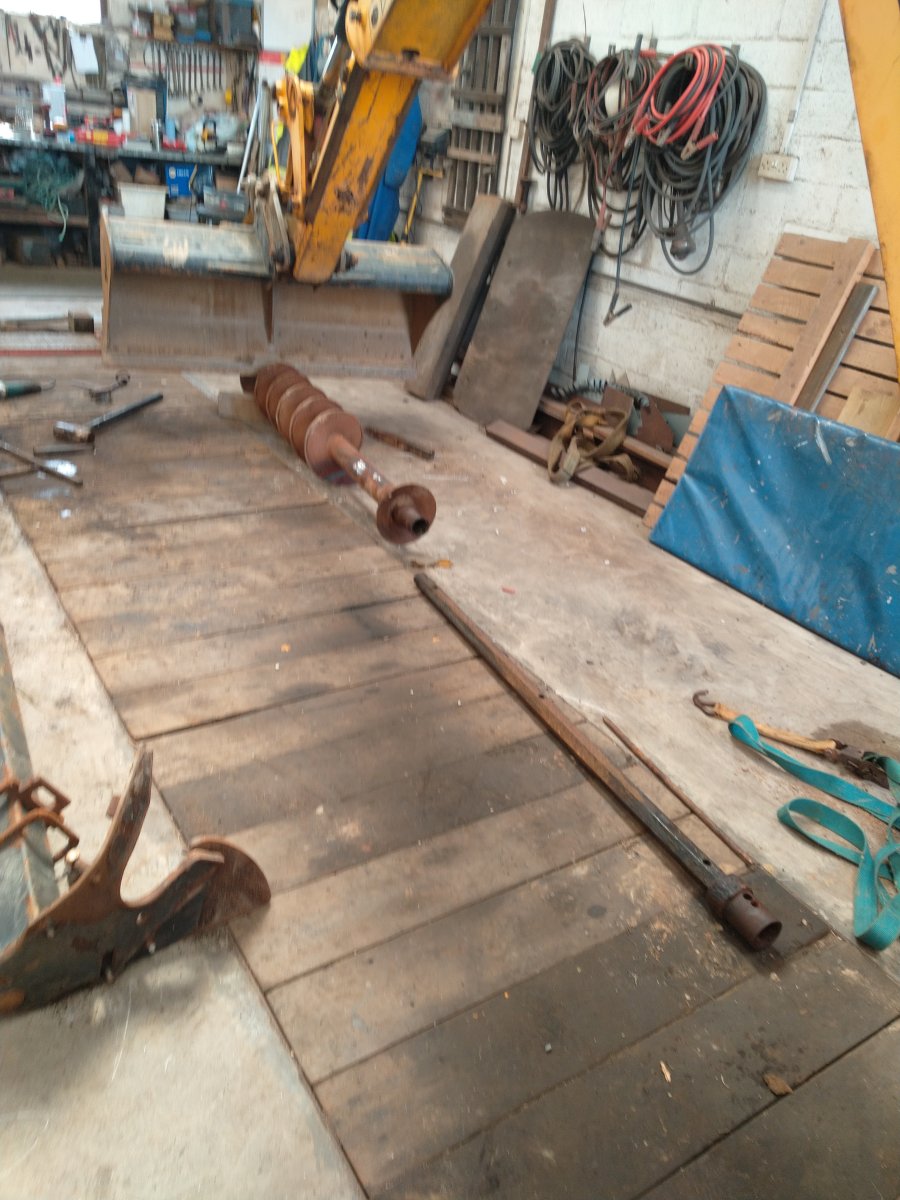

As far as I got today needs some new hinge pins 32mm with grease journals in the middle made that's for another day as had to heat up the bosses to extract one pin rusted in place oxygen hose blew off the flame arrestor on the torch while I was cutting and pipe whipped my inner thigh f**k that hurt plus scared the sbit out of me 😳 so 2 new hoses now about time really as ones are probably old as me
Bit more to do tomorrow but can't get hoses made till digger back in yard

@CPS both hoses are sat to the sides they came from originally with the spurs from the t fittings going up the arm the 3rd pipe was straight from motor to the arm and not part of this valve

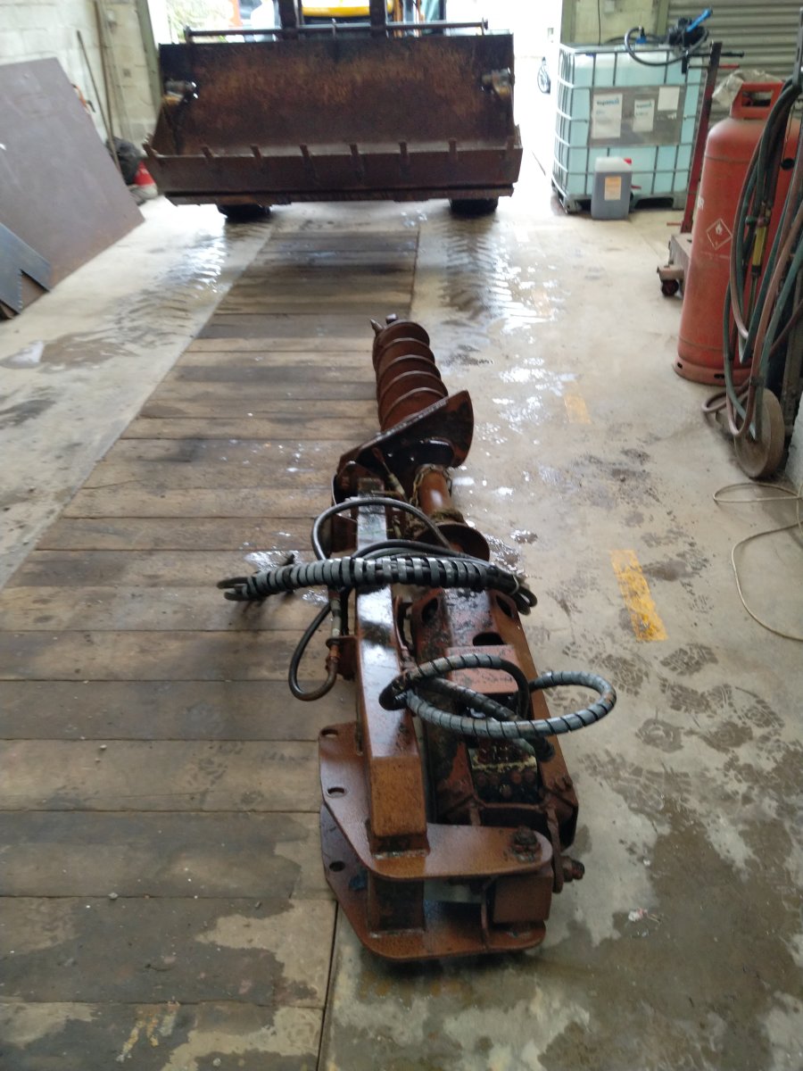

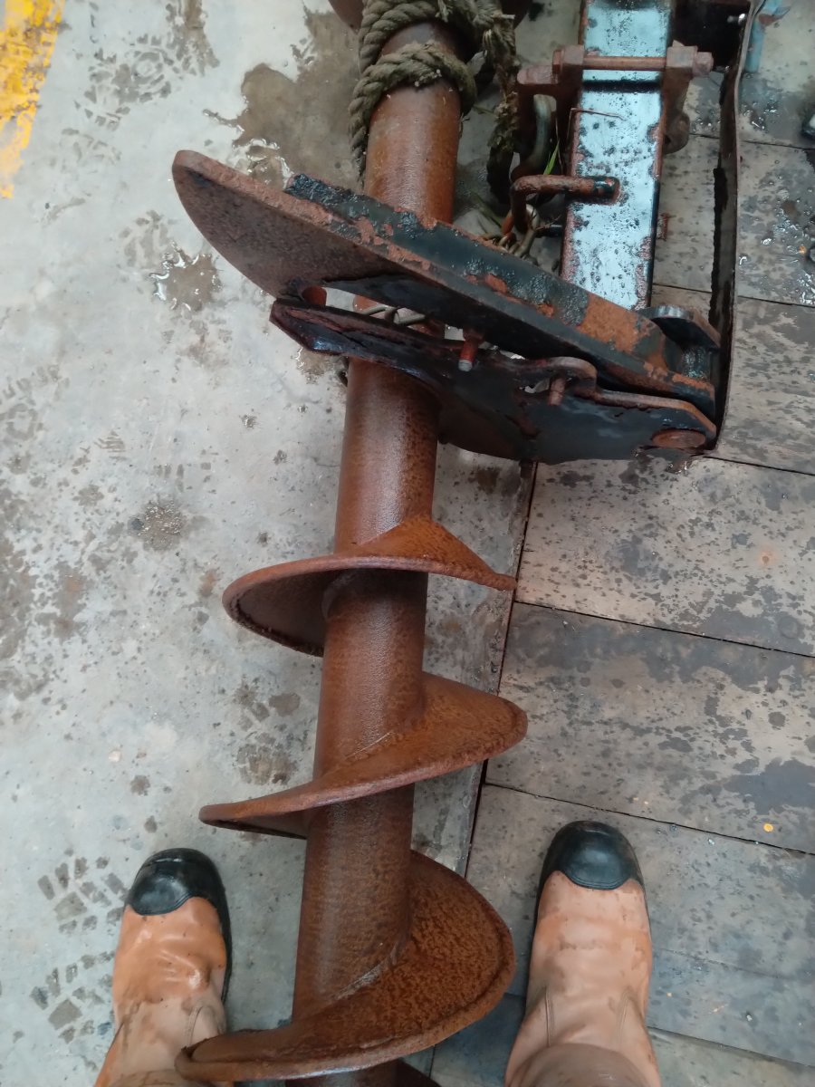

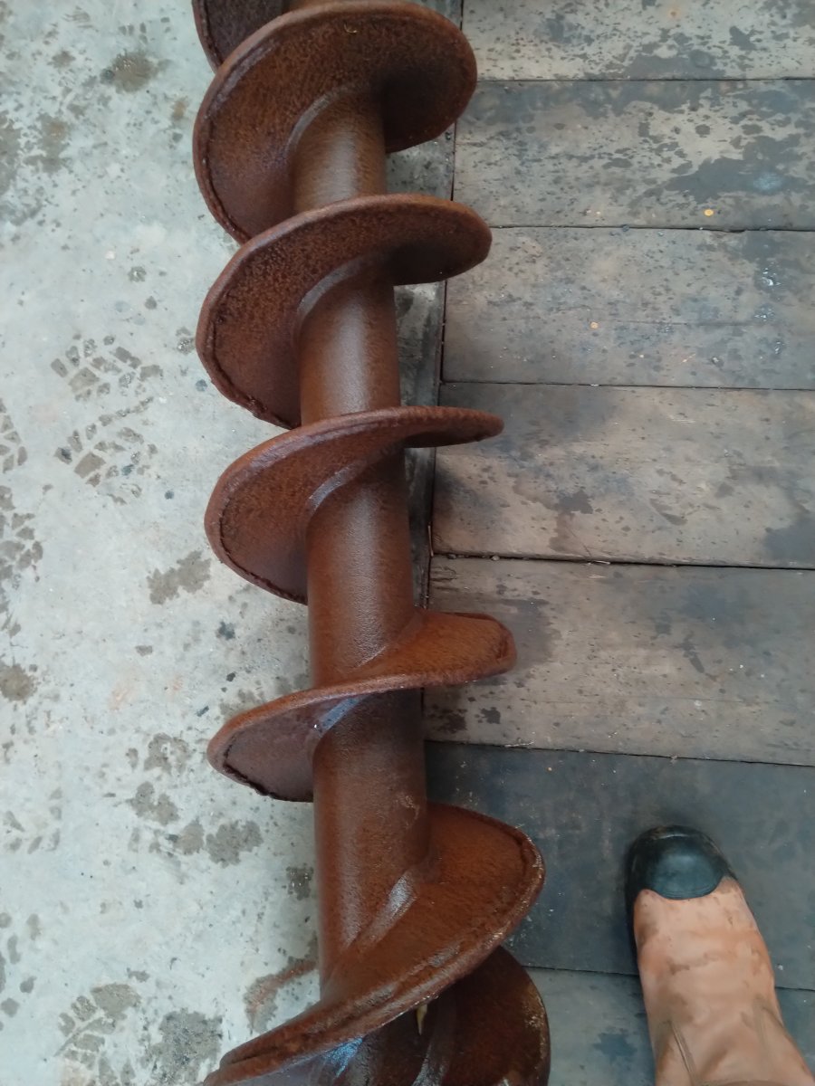

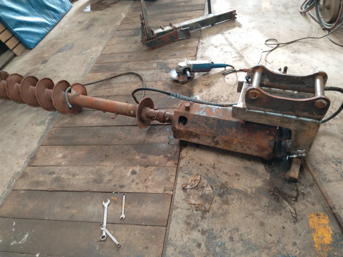

Huh that's why the auger flight is so heavy a hidden extension 😎

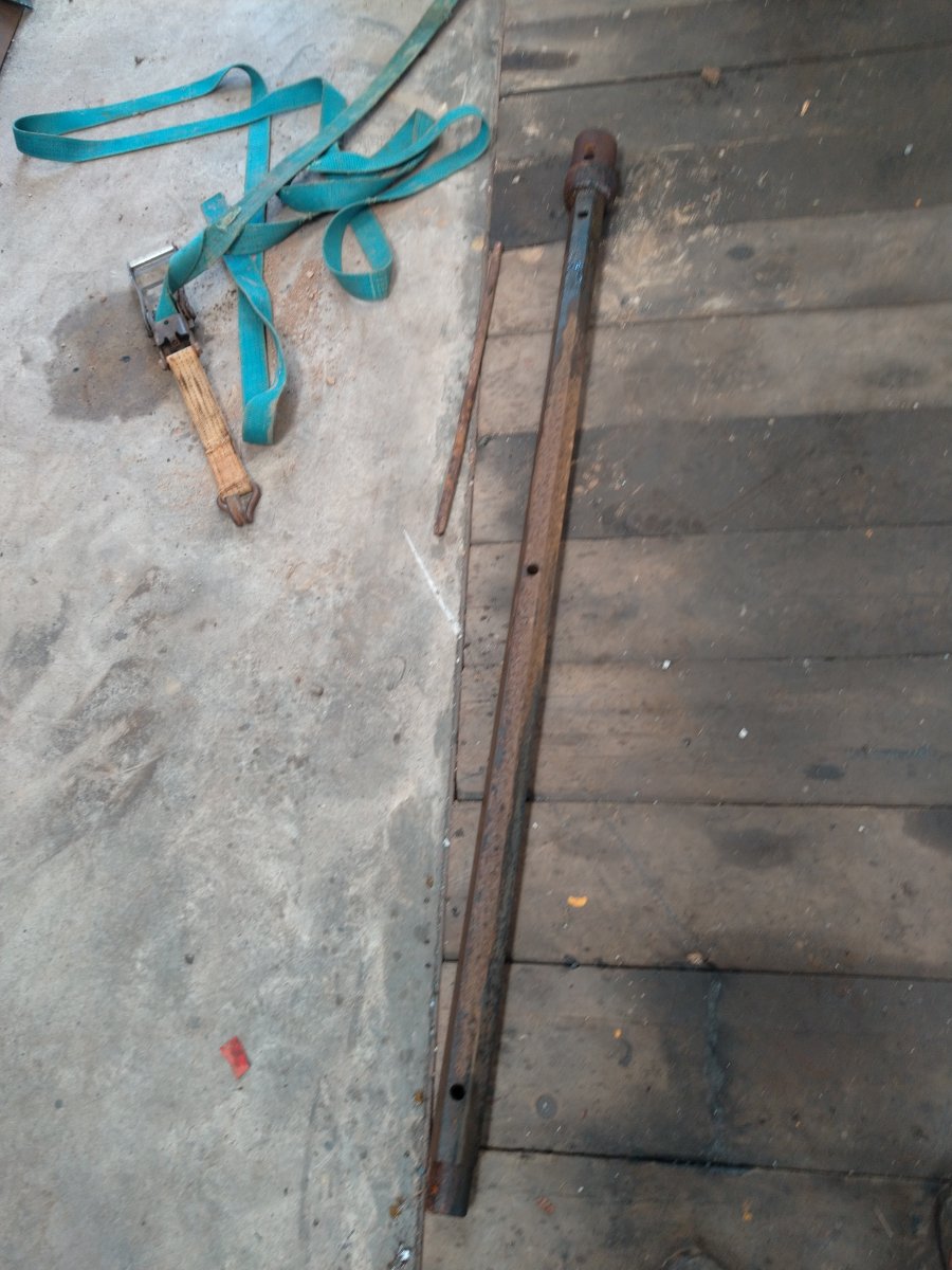

Took a lot of duck oil and hitting with persuader to free off the top end and a ratchet strap around the JCB to keep tension on
