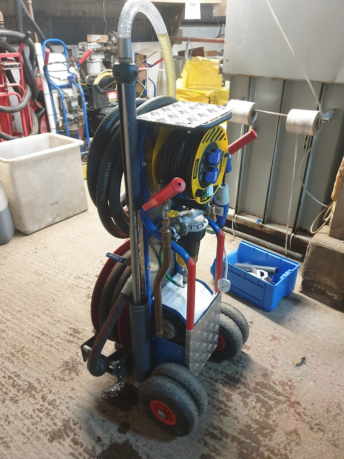

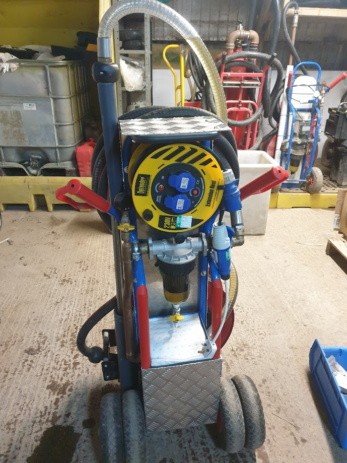

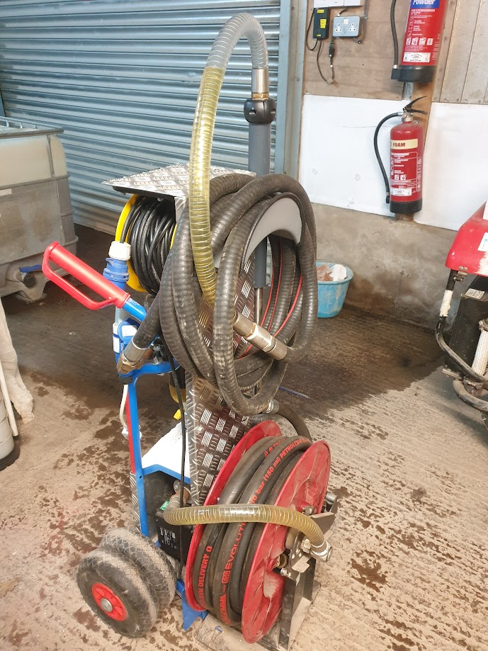

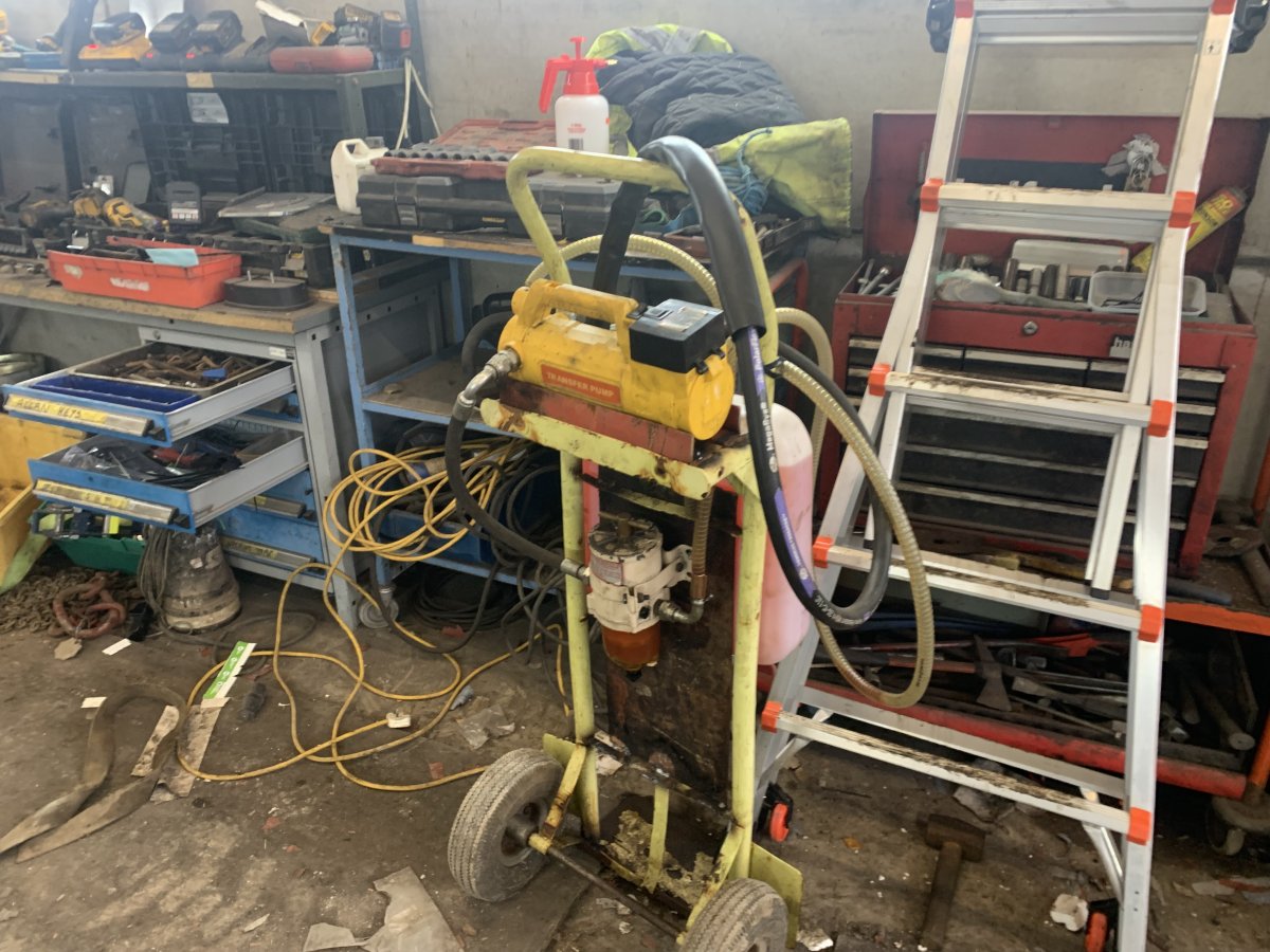

Finally got around to wet testing the new MK6 Kero Transfer pump today. (the wet on the floor is from something else). Runs a lot quieter than the MK5 and self primes properly. The last one was a trial rig built during lockdown, and its had heavy use since so needs a full rebuild. This one now needs the controls properly wiring in and a bit of blue paint on the copper pipes. Its been about 3 years since I bought the bits so glad to see it nearly done. Surprising how many hours go into something that looks so simple.
The new rig has:
Dual puncture proof wheels on solid axle.
Pump located lower down to avoid catching air.
Mesh strainer on inlet.
Vacuum gauge to check for blocked foot valve or strainer.
Shorter 7m suction hose with stainless dip tube.
Clear hose on dip tube for instant feedback on fuel cleanliness.
Shorter 10m discharge hose on autorewind reel.
Puisi 120 pump.
25m power lead.
Decent hose storage
Decent dip tube hanger to avoid foot valve getting squashed.
Drip tray under strainer to protect pump.
Runs nicely at about 65lpm with tanks level.
MK5 can be seen on blue trolley in background.

Brill mate. Sometimes if you want something to work properly you have to build it yourself!

I made the poor man’s version
The tank on the back collects the big stuff and water🤞

Racor and that pump is standing up to diesel pretty good👍👍
Deisel is a lot kinder than Kero on rubber seals. We have been using a Milwaukee M18 for 2ish years for dewatering and other misc jobs and it's finally failed today (faulty switch?) So today we have started using the yellow chinesium version that's been sat ready for a few months. Preforms as well as the red one.
Turns out the red one is still under warranty so fingers crossed.
