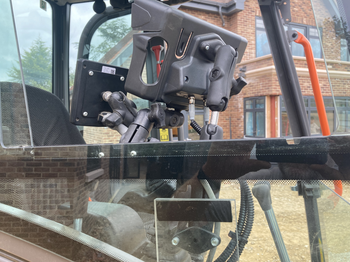

@Nasco do perspex mounts with 3M tape, i spent a small fortune on Ram mount bits and managed to mount the Rototilt panel as well and still be able to open the window.View attachment 54285
I need to look at doing something like this . It really gets jerked about in the hitachi . My glass doesn’t open that side so the Perspex thing might be an option . What’s the second screen mount ? How are those ram mounts for the screens attached ?
JerryRtilt
JerryRtilt
I need to look at doing something like this . It really gets jerked about in the hitachi . My glass doesn’t open that side so the Perspex thing might be an option . What’s the second screen mount ? Now are those ram mounts for the screens attached ?
I fixed a second ram ball mount to the cradle with small countersuit screws and another to the window frame so it's triangulated. Lots of trial and error involved to position every thing , clear opening front window, movement of blade lever ext ext. Will try and get better pics. Tomorrow. Did the same in the TB280fr. Much easier as more space and no Rototilt screen to contend with.
