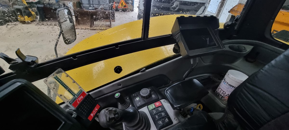

The second RAM mount makes it much easier to get the cradle steady.I need to look at doing something like this . It really gets jerked about in the hitachi . My glass doesn’t open that side so the Perspex thing might be an option . What’s the second screen mount ? How are those ram mounts for the screens attached ?

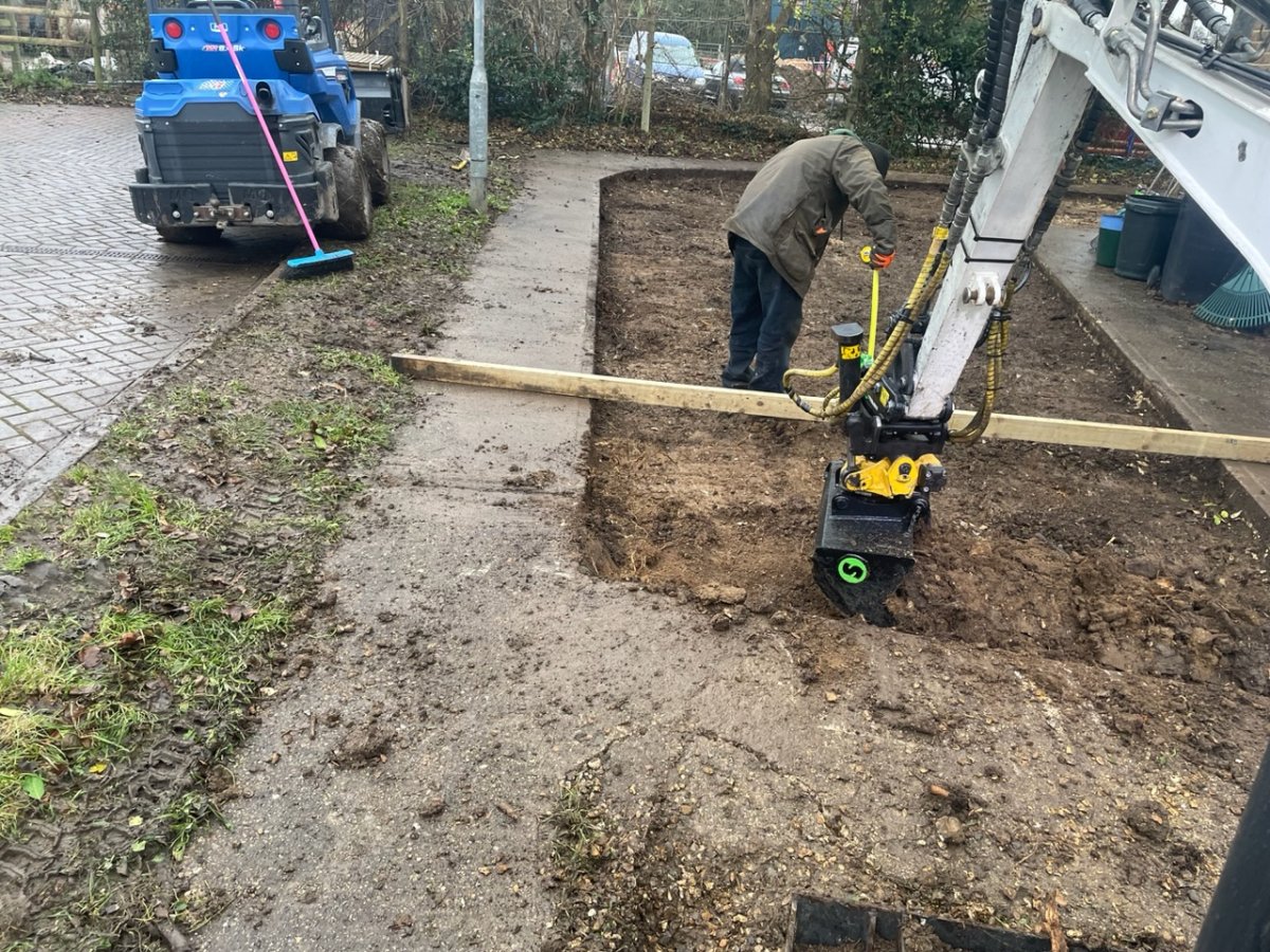

It was fine until the rain we hadlooks a tad sticky under foot there Doob
f**k me, you've even hired the obligatory @Gunners lookalikeIt was fine until the rain we hadyou can see it was ok in the first photo with the tilty and grade board. Luckily a wagon of stone hides a multitude of shite, got it all laid out, graded and rolled as much as I dared. Really nice to be able to sit the digger anywhere to do that- major benefit in those conditions. I laid all that out on my own whilst ordering some more materials and helping harry do the fencing. Even got the obligatory 'use a tilty for EVERYTHING no matter how small' Instagram shot
I’ll finish the fencing but the rest of the job will have to wait until it’s drier. View attachment 54323View attachment 54324
Just waiting for the hour long YouTube video about the lack of cup holdersf**k me, you've even hired the obligatory @Gunners lookalike
Im guessing hes got his hair caught up in that pipework !It was fine until the rain we hadyou can see it was ok in the first photo with the tilty and grade board. Luckily a wagon of stone hides a multitude of shite, got it all laid out, graded and rolled as much as I dared. Really nice to be able to sit the digger anywhere to do that- major benefit in those conditions. I laid all that out on my own whilst ordering some more materials and helping harry do the fencing. Even got the obligatory 'use a tilty for EVERYTHING no matter how small' Instagram shot
I’ll finish the fencing but the rest of the job will have to wait until it’s drier.View attachment 54324
I thought that , but it can’t be gunners , he’s using a shovelf**k me, you've even hired the obligatory @Gunners lookalike
I’m seeing you’ve got the main screen to your side . Is it not the case that you need to be looking at it when you’re digging ? Or do you just use the we glass thing ?
Plenty of room in the machine up there and works for me, once its set its a combination of sound and lights for finding grade, but for others who maybe get more out of it then i dunnoI’m seeing you’ve got the main screen to your side . Is it not the case that you need to be looking at it when you’re digging ? Or do you just use the we glass thing ?

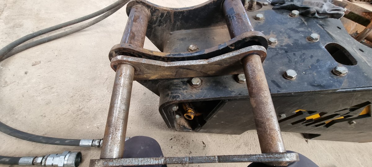

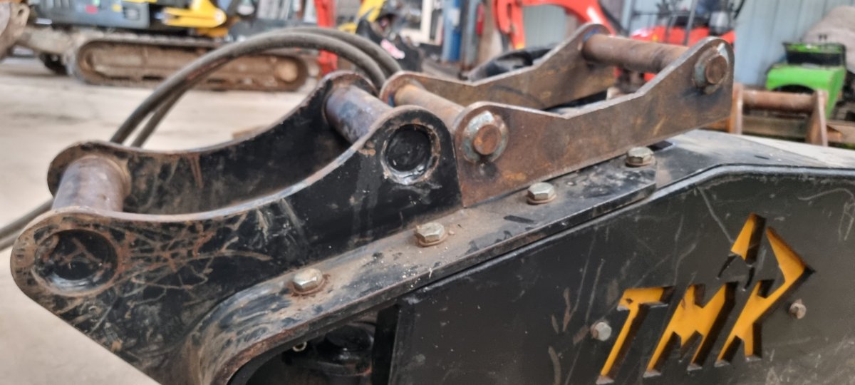

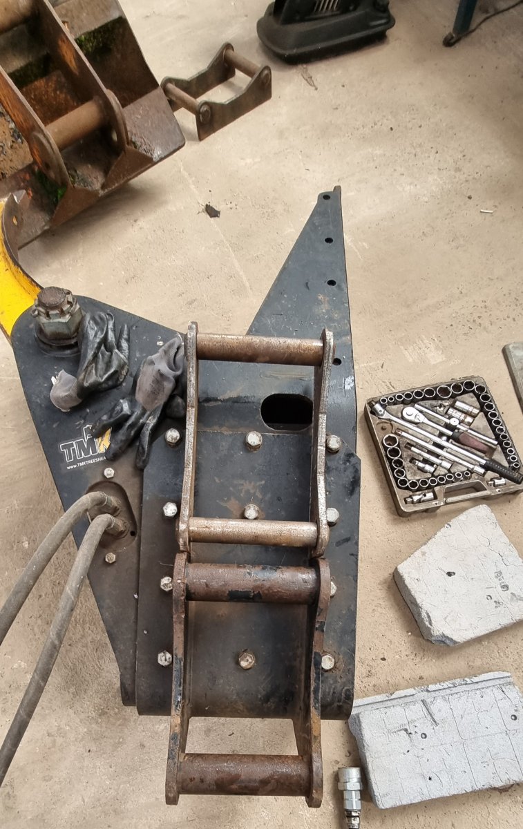

I'd cut the pins off internally. Mark the centres of them on the outside, then drill through with a 50mm mag drill. Insert 40mm pins, check and weld. Easy enough.Question for you @V8Druid
Turns out that the s40 shares same dipper width and centers as the old 8t kubota, its only the 8t 60mm pins that differ.
Which makes me think there may be an easy way to convert the shear ....whats your thoughts ?
