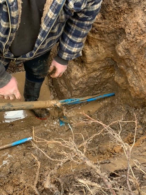

I had to go and meet some blokes from the water company the other day trying to do a connection. I had buried the pipes running across the fields to three new properties and they were trying to find them in the driveway where the meters were to be installed. But they couldn't find them. They had given up digging at about 500mm and when I said dig deeper their only response was they certainly won't be being hurried that deep across the road. If the water company won't do it not a surprise that noone else will

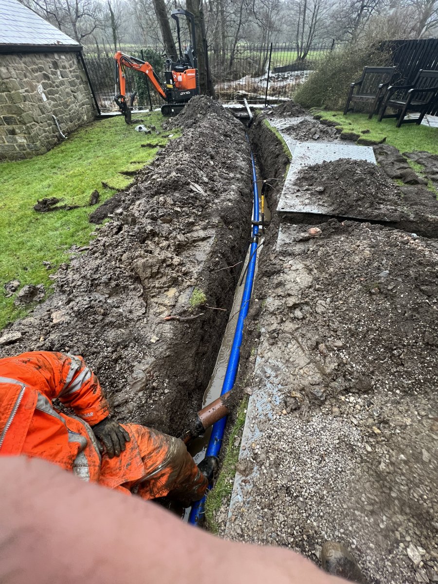

I got a heads up today from scottish water that if we don’t tick every box by the letter for new connections they will be refused . Pictures need to be exactly as the manual shows if not they won’t connect . They are getting out of hand . I recently done one that I put in at 900mm cover on private ground sanded with marker tape . I moles it under a road so I had all pictures showing it passing under the road . I couldn’t get a connection because I had put it in a duct . I had to dig both sides of the road up and then managed to slide the duct back out of the hole leaving the pipe in there . No way was he letting me away with it .
That’s the ducts coming back out .
I was fuming !
I was fuming !

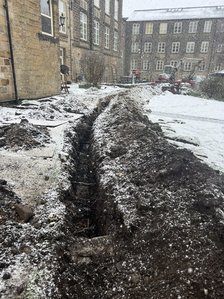

First real dig with dx10 pleasantly surprised but could be a bit quicker on boom up stroke.

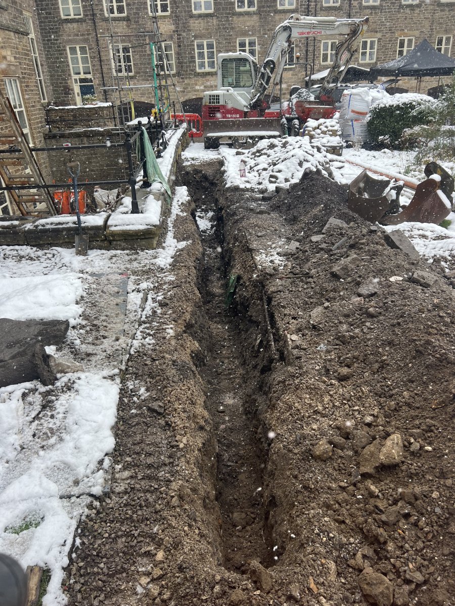

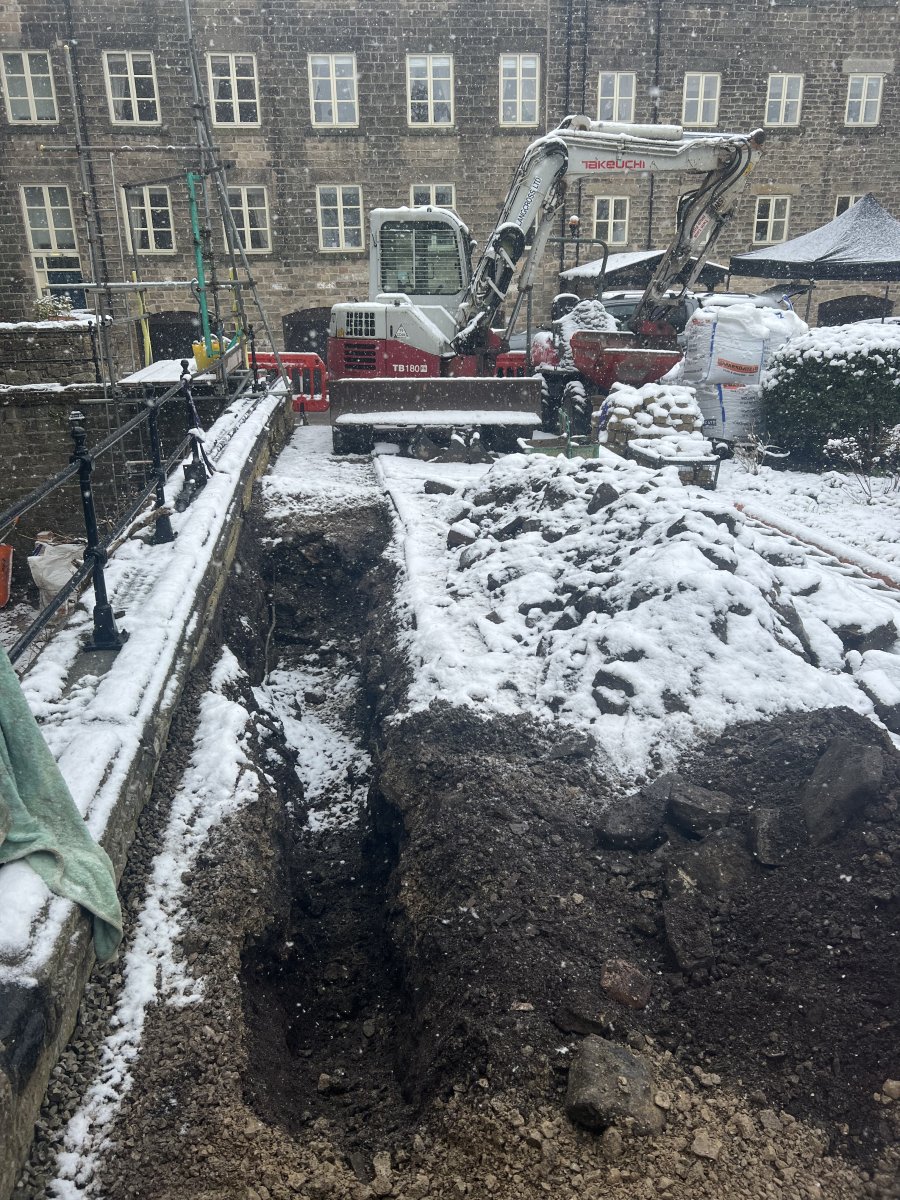

Joys of the Peak District but you’ll see diggers in snow beautiful blue day lol just 14” wet on the floor 😂

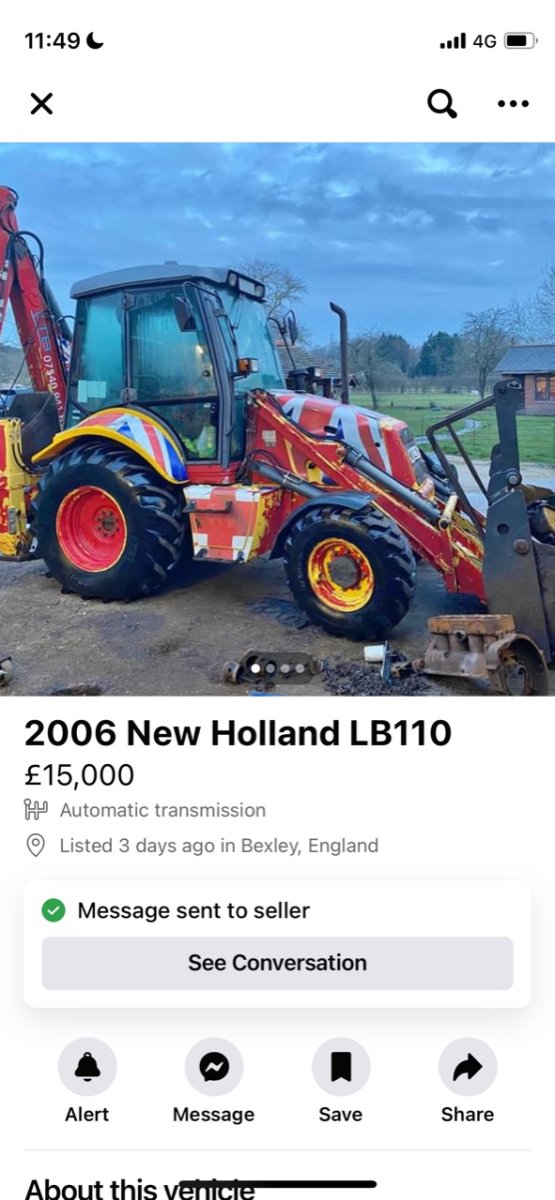

How about this one? It’s a manual with power shuttle, servo controls, air seat, soft ride, 40k box, extendahoe and a Geith hydraulic hitch with four buckets. 56 plate, 6400 hours. Apparently the stickers will come off easy enough. Got breaker if I want it for £2k extra
