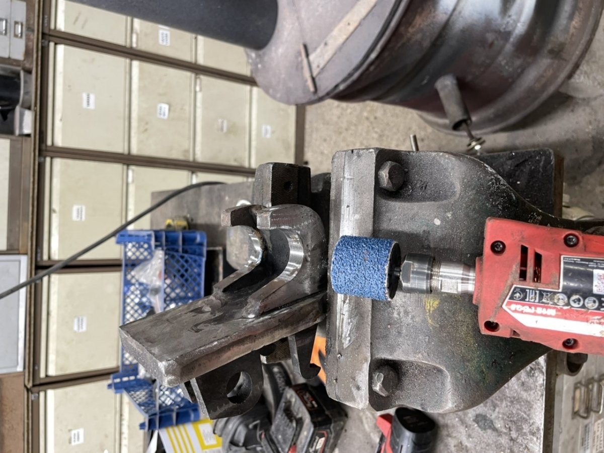

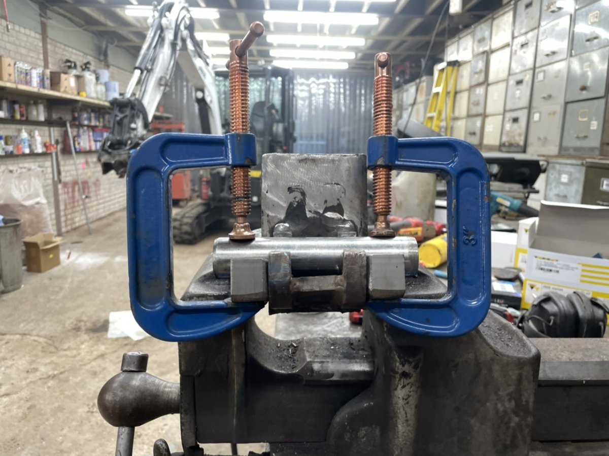

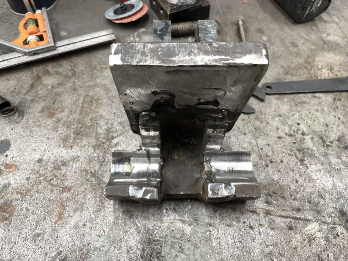

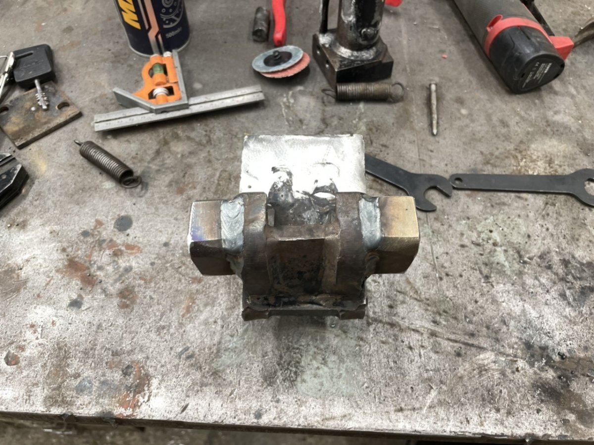

Widened the top jaw on my quick hitch. It takes a lot of abuse being used with a grab and post knocker, plus Whites hadn’t welded it square in the first place 🙄. 30mm spiraband in a die grinder was just what the doctor had ordered for matching the two sides up. Then wrung the last bit of life out of a poor 30mm rota roach bit and welded before dressing with the spiraband as required. I also built up and dressed the edges of the plate where it had worn.
Most of the play was in fact coming from two tiny dimples of wear on the main sliding face, a five minute weld and grind job with no disassembly required- but widening the jaw will certainly help and I feel better for having done it. Things like the cone splitter are particularly bad for it.
If I had my time again I’d be all S30 but such is life.View attachment 41226View attachment 41227View attachment 41228View attachment 41229View attachment 41230

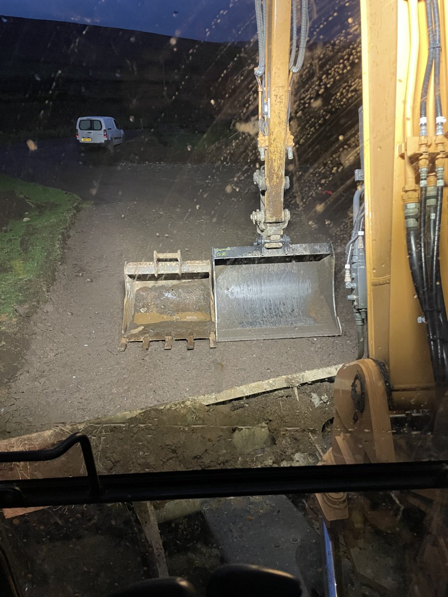

Well over a 1000t in on hardcore for this job to get levels right 5ft deep with 6-4 inch clean RC in some places and then some 3/4 - 4 inch clean to fill all the holes and regulate surface ready for
Type 1 coming in tomorrow to cap it off
Spring high tide was testing bottom of my banks on Monday
Everything shakes when tracking around as not much under here and only used roller today as tracked everything in so far and 44t artics delivering hardcore didn't make a wheel mark driving on it

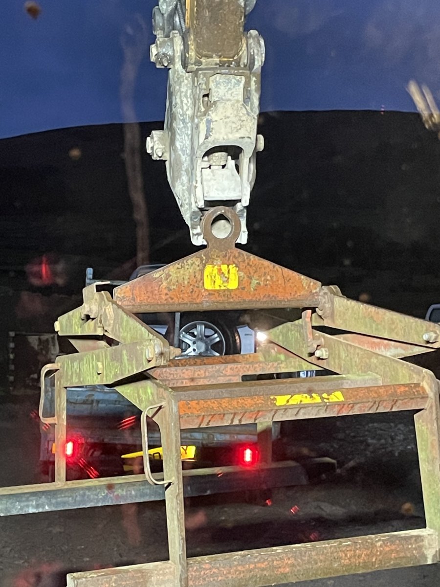

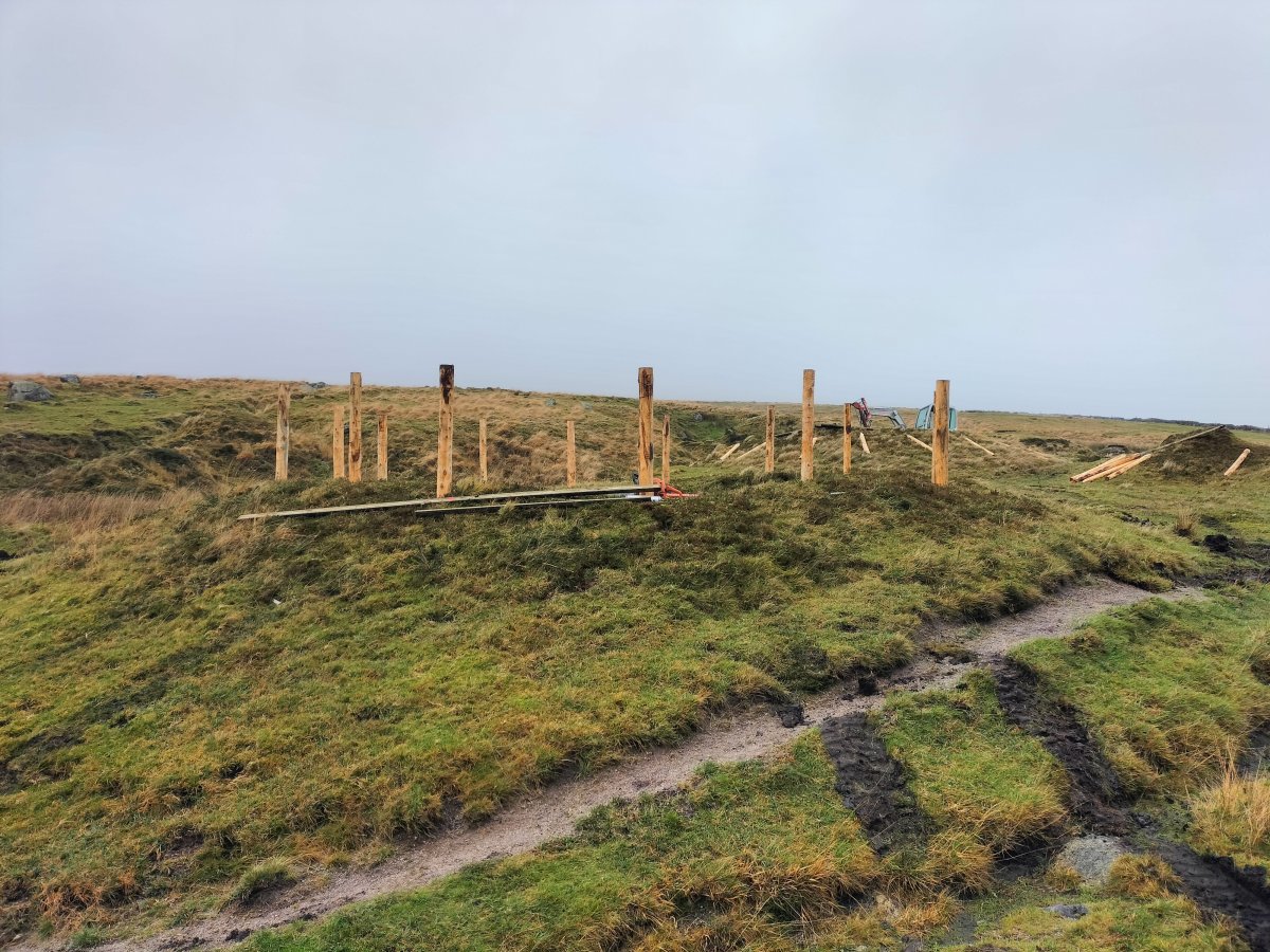

Fencing round mine shafts. Awkward stuff really. Not much room for error with the knocker on either but it does get places which sure beats doing it by hand!
that looks 'exciting' work .. not a lot of room for error with that on the dipper

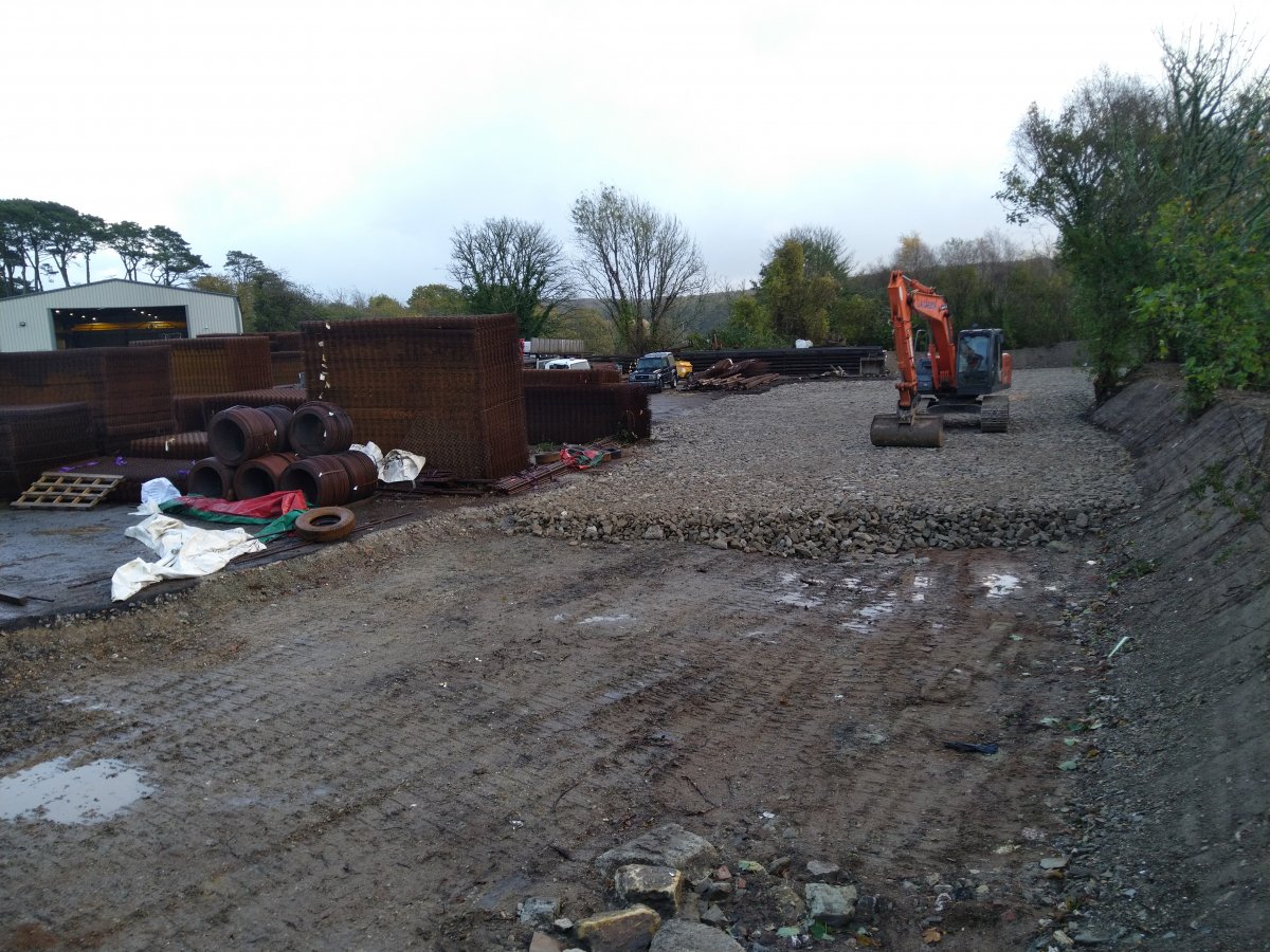

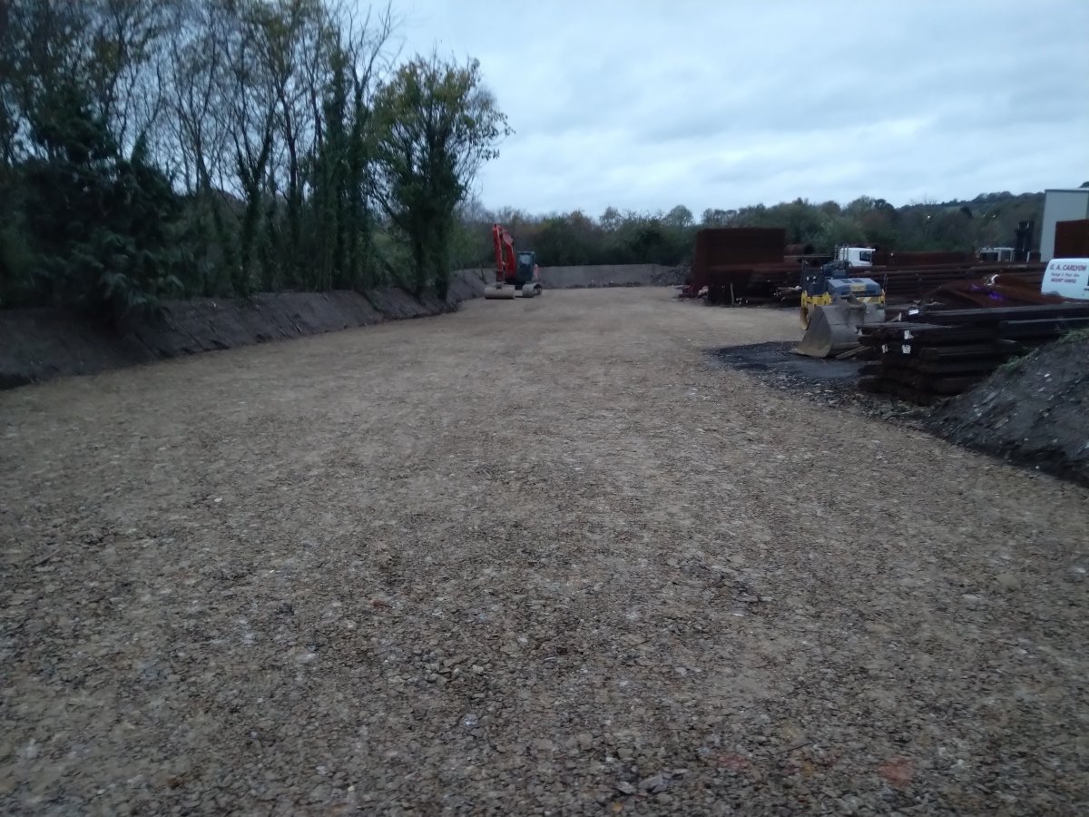

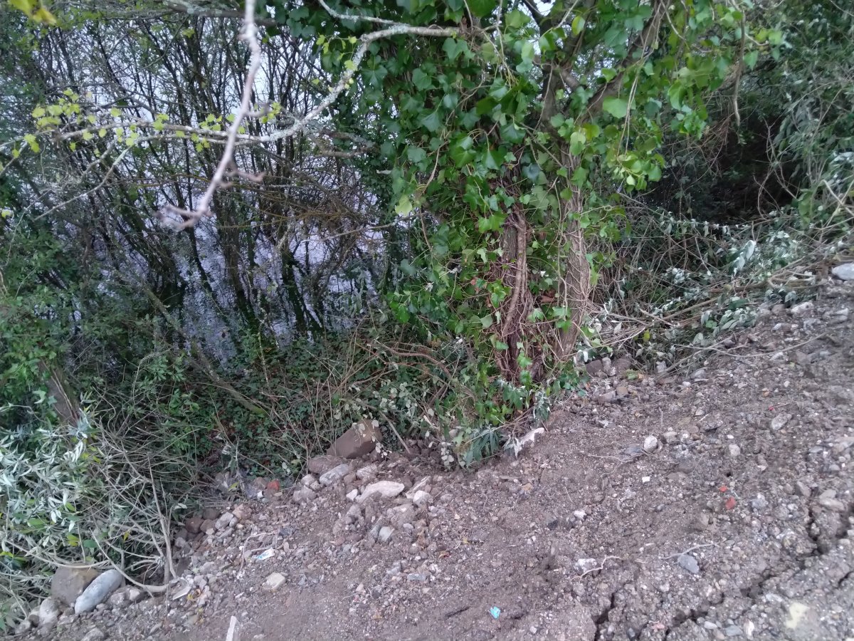

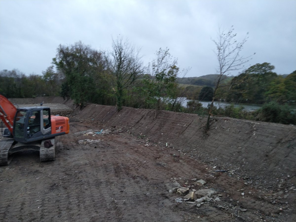

can't see them trees surviving long, buried like that .... lovely job though Stu (y):cool:
