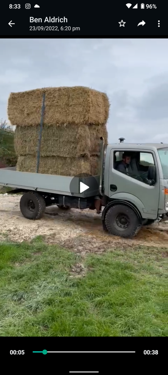

The best loopholes for using dads tractor as a lorry. DVSA please don't look in here.

top and bottom is .... the bloke thinks he's above the law ... the pic that started the discussion illustrates that in no uncertain manner ... as for the rest .. well as said at the start :rolleyes:

load it to youtube, then link it to here ..... I'm sure DVSA 'd be grateful :ROFLMAO:
The three bales on the back didn't go on the road. Lee was testing it out around the field. Realistically it probably has a legal payload of one bale.
that'd be a very big ......... perhaps!!
in fairness, as I said before, it looks a tidy-ish job, but it's totally impractical with current UK C&U reg.s and licensing for much else than towing ... a basic Disco 1 is nigh on 2 tonne and they ain't exactly a heavy tub to start with ... with that cab and body, etc, I'd be very surprised if that was much under 3t
