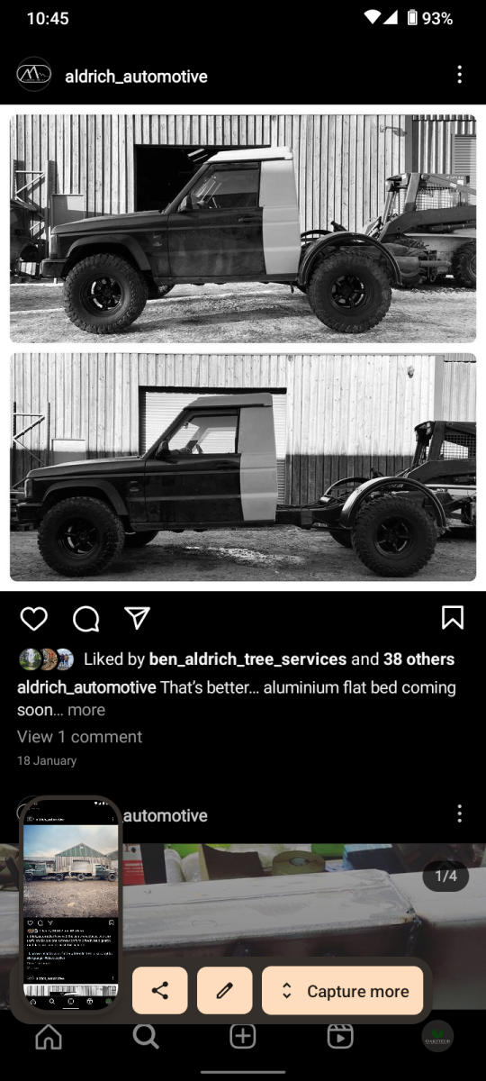

in fairness, as I said before, it looks a tidy-ish job, but it's totally impractical with current UK C&U reg.s and licensing for much else than towing ... a basic Disco 1 is nigh on 2 tonne and they ain't exactly a heavy tub to start with ... with that cab and body, etc, I'd be very surprised if that was much under 3t
It's a bloody shame as that truck would be perfect for me and a lot of others, but as you say basically pointless legally ๐Ÿ˜’๐Ÿ˜’
I agree it does look very business like, but like a luton Tranny .. good for fresh air only :(

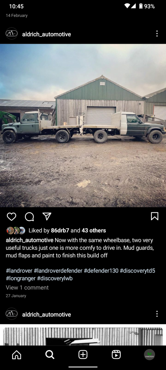

look up his instagram, hes recently built a 130 disco trayback, really nice work.
you mean a disco tub on a 130 hi-cap chassis? gonna have the same issues with weight though sadly :( ...... there's also the magic 2070kgs to take into account :rolleyes:
HuntingHicap
HuntingHicap
No he stretched a disco chassis to 130. Ally trayback on it. Does some landscaping so can tow his digger and put the buckets on the flatbed.

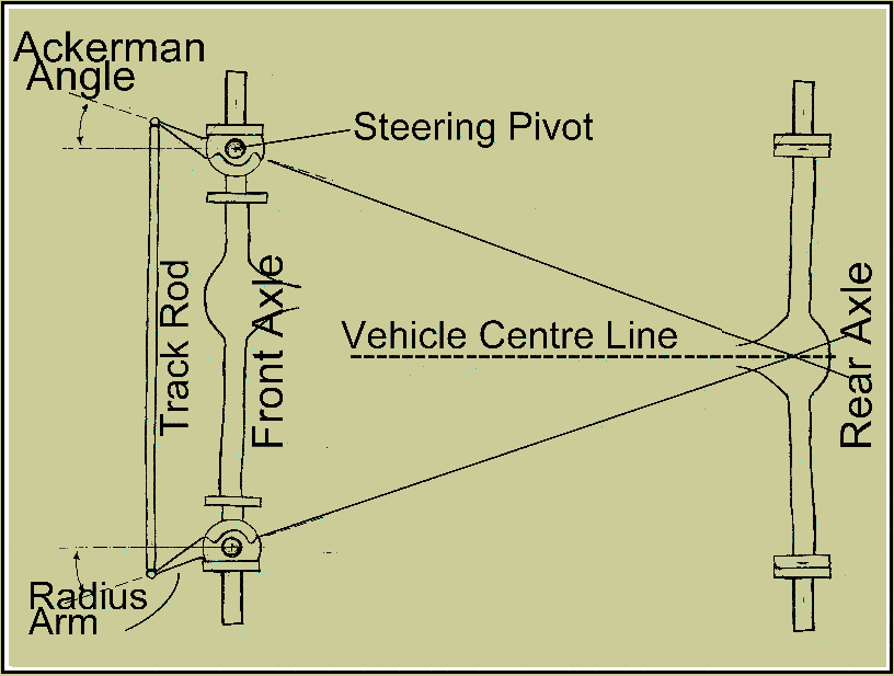

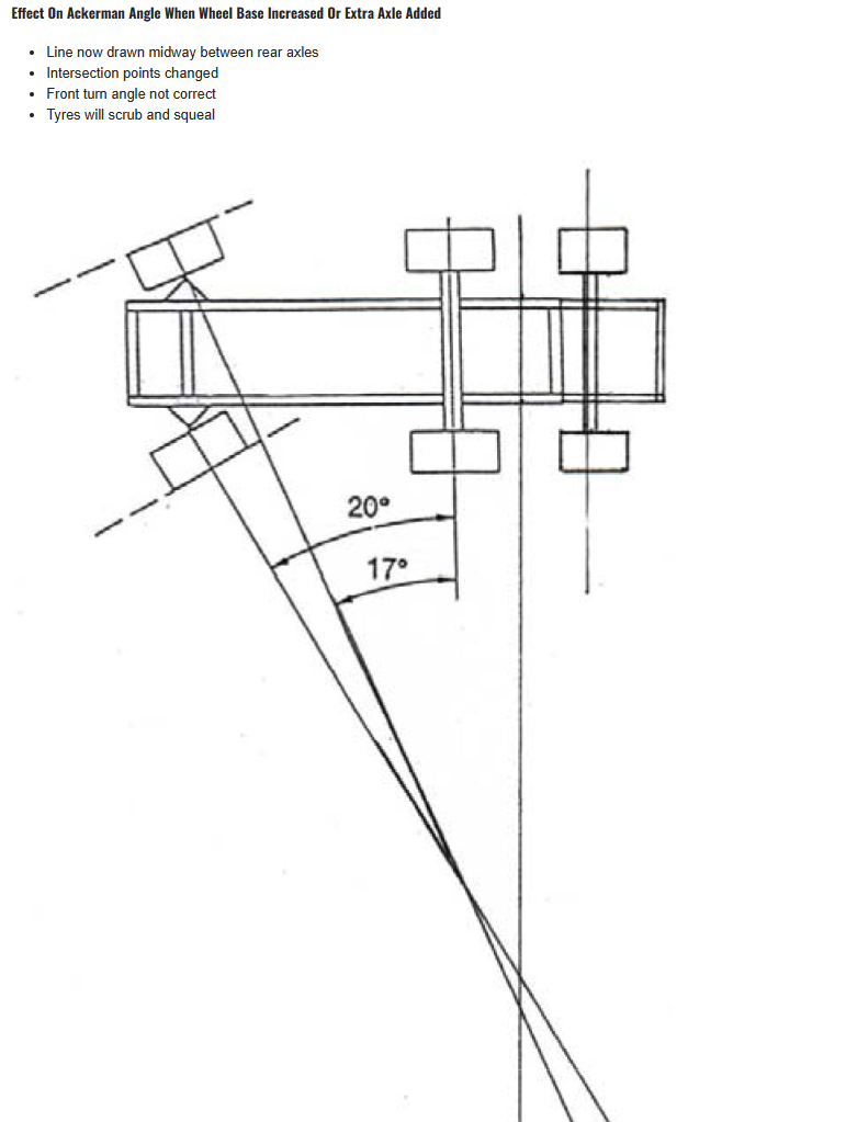

the track arms're set up for a 100" wheel base on the disco axle .. at 130" the angle the arms're set at will be different and need a 130" front axle swivels .... look at the first drawing above .... the steering geometry is completely different after being stretched and will scuff the steering wheels
Akerman linkage, although subtle, has a big effect on steering geometry

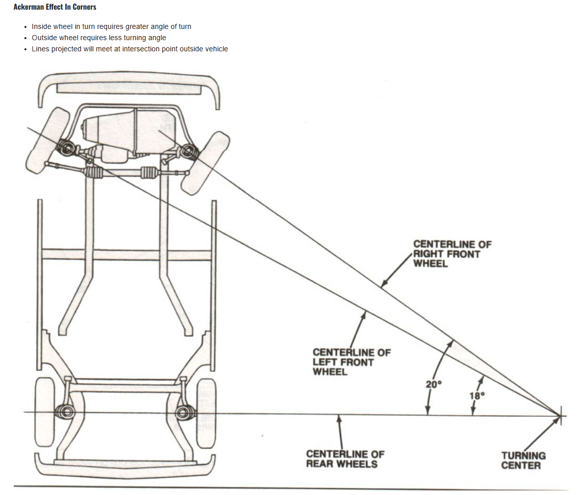

same applies to the extra axle .. see drg 3 .. the steering centre point moves back
