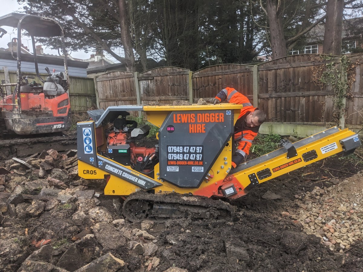

Only using it here as we had huge pile of as dug rock and rather than get rid we crushed it.

Looks like there's been a lot of shite in with the stone you've crushed by the looks of it.
Normally just buy in lovely hard Derbyshire limestone from the 10 quarries nearby
None of the limestone dug round here is frost proof, but generally it overlays shale which is. I‘ve levelled that Derbyshire limestone on one job, good stuff.

I was just commenting on what i could see from the pics and the stuff in the pile looked ok but the pic where the wacker is on it looks like its got soily stuff in it. How else do you say it?
There's a temptation when crushing to mix/let a bit of soily stuff through with it, it's why i wouldn't buy crushed in and part of the reason why a lot of folk crushing want to make it 80/100mm down in size as it hides the shitty stuff and it doesn't puddle the same when wet but it doesn't bind well either.

Yeah that’s the idea I was doing one load of crushed stone one of soil in the dumper just to make my day go worse! For my biggest client!

Maybe a more constructive comment. Have you tried putting layers of geogrid in. Not always an answer but can help.
I built a turning splay on a flood plain. In the winter. Used standard recycled 6f5 from a skip yard. Horrible stuff that turns to mush at the sight of moisture but cheap full. Usually need to get in capped off with something pretty quick.
As we where building this we put layers of geogrid in. Every night it completely submerged in flood water and pumped out again the next day. Track on it and the top would go mushy but only to the top layer of geogrid. Not a wonder product but can definitely help in the right environment. Especially when you know you will get tramline problems as their isn't enough room to vary where you are running
