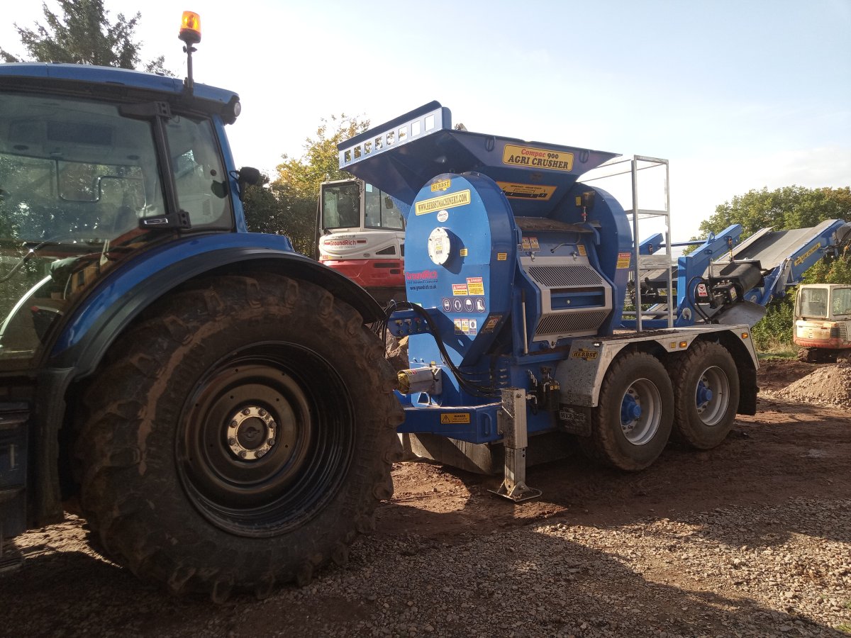

I like the way they stick a label saying agri on it.
Like that makes it all legal. Should have added a Grassmen sticker for extra surety.
Lad I know has a fully stickered grassmen nh and triaxle lowloader...hardly been off tarmac...but likewise it's never been tugged either...🤪
Trouble with anything tractor orientated is the lack of clarity in the rules..... It's pretty black and white in reality but the outstanding inability of the DoT to publish meaningful legal legislation is what makes it grey
Hired this for 200 ton of conglomerate stone 3 hours job done
