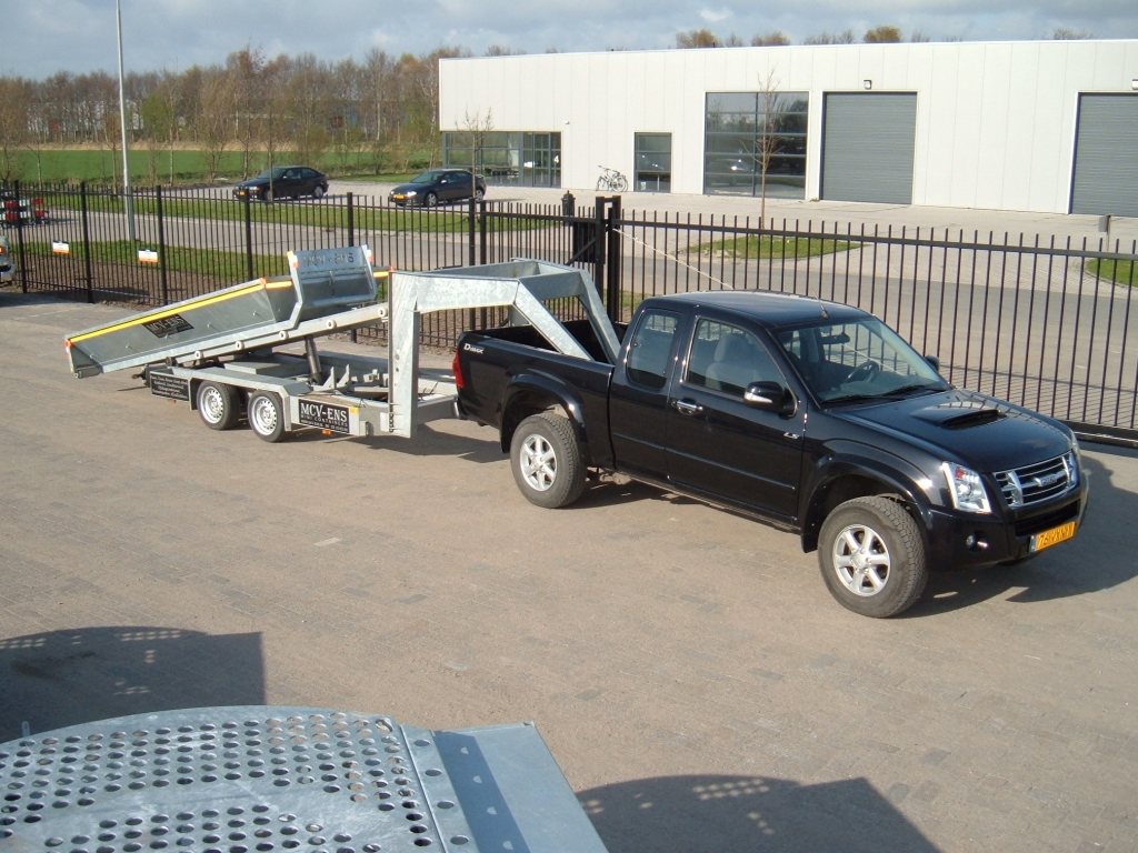

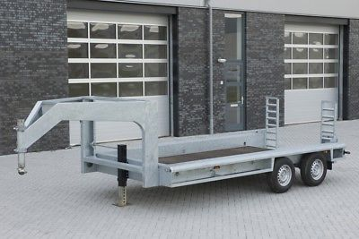

saw this on ebay any one seen one in the flesh, from the add it appears to be ok to use in the UK
No bulky coupling in the bed of your truck like traditional 5th wheel systems.
Advanced electronic braking system means no air brake hardware required!
Spherical coupling minimises chassis stress from twisting unlike traditional fifth wheel couplings
Up to 5300kg technical gross weight of fifth wheel setup!
Gross weight is calculated by vehicle towing capacity + vehicle payload.
No Class 1 licence required!
EU Type approved Braking System and Coupling
These products are built to a specification - not a price.
They are built to last but also to look good, these trailers can be completely custom built to suit your individual requirements.
-Get your business noticed for the right reasons-​
Standard equipment:
  • - A fully plated laser-cut frame (calculated FEM)
  • - The floor height is 54 cm,
  • - Fixed mudguards
  • - Low sides ideal for 360 machines
  • - 3500x1800mm bed
  • - A plywood floor 18mm (birch)
  • - Two axes of 1900kg
  • - Folding and sliding ramps with integrated support legs
  • - An adjustable drawbar height (650-750 mm)
  • - Tyres 195 / 50R14C
  • - Spare wheel
  • - Fifth wheel coupling
  • - Front and side LED lighting
  • - Reversing light
  • - An E35 EC approved electric braking system
  • - A gross weight of 5.300kg
  • - An unladen weight +/- 850kg
  • - Lash hooks down each side (2 x 4)
  • Available in custom sizes
  • Wide variety of subframes available to convert your towing vehicle- please ask!
Price figure same if paid in Euros!! Please Ask!
There are various different specifications available, please get in contact with your requirements and we can tailor something to suit your individual needs.
Orders for trailers have a 8-12 week delivery time from Holland.
If you are looking for a trailer than can stand up to everyday use and gives you maximum load capacity then come and look at what we have to offer,
Please call for Will at Wabtec Developments Ltd for more information - use google
All prices plus VAT and shipping
all seems a bit on the pricey side and another £3k to fit the kit to the pick up but a pay load of 4000kg with out 8 week inspections and all that faf may be worth it your thoughts please
Likes
171
#24
First thought is the axle weights seem a bit on the low side. 2 x 1900kg = 3800kg. Yet gross weight at 5300kg
Antony Holmes
Antony Holmes
Likes
70
#25
I assume you use the pick up axle weight allowance to get from 3800kg to 5300kg but 1500 kg difference seems a lot
Likes
686
#26
minus the weight of the trailer itself :rolleyes: ..... and would need a pre-'97 license for the B class, or do the trailer test if license gained after '97 .... however ...
this would've fallen into the old class 4 category (light artic, like the old Scammel Scarabs) as it's a semi-imposed load trailer and I'd want ministry confirmation that it doesn't fall into C+E before spending my wonga on one :eek:
won't get much more than that on the tyre sizes Shaun :rolleyes: ..... without going to very expensive HD tyres ... like 10 plys to up the capacity and then fit bigger axles in the manufacture
you'd need the coupling very carefully positioned in the bed to get the full carrying capacity of the trucks capabilities ;)
Likes
686
#27
would need to made out of Zintec to get that down to 850kgs o_O
