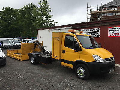

Hi guys i am not shore if this is the right place but i am confidant that i am not the only one looking to make more money out of our mini diggers
i am looking at a 6 ton roro skip lorry to replace my d-max my thinking is be able to
  • take materials to the job type 1,gravel ect
  • more carrying capacity 3300kg net
  • remove some materials top soil or hard core all of witch go to the tip at the moment with skips or grab lorry
  • this is the type of thing i had in mind room carry tools in the box
  • What extra costs do i need to be thing about
  • thanks for your help
