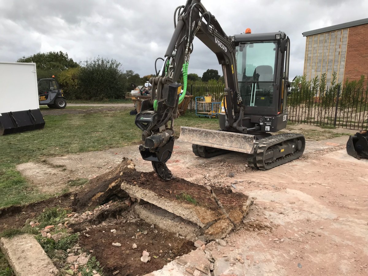

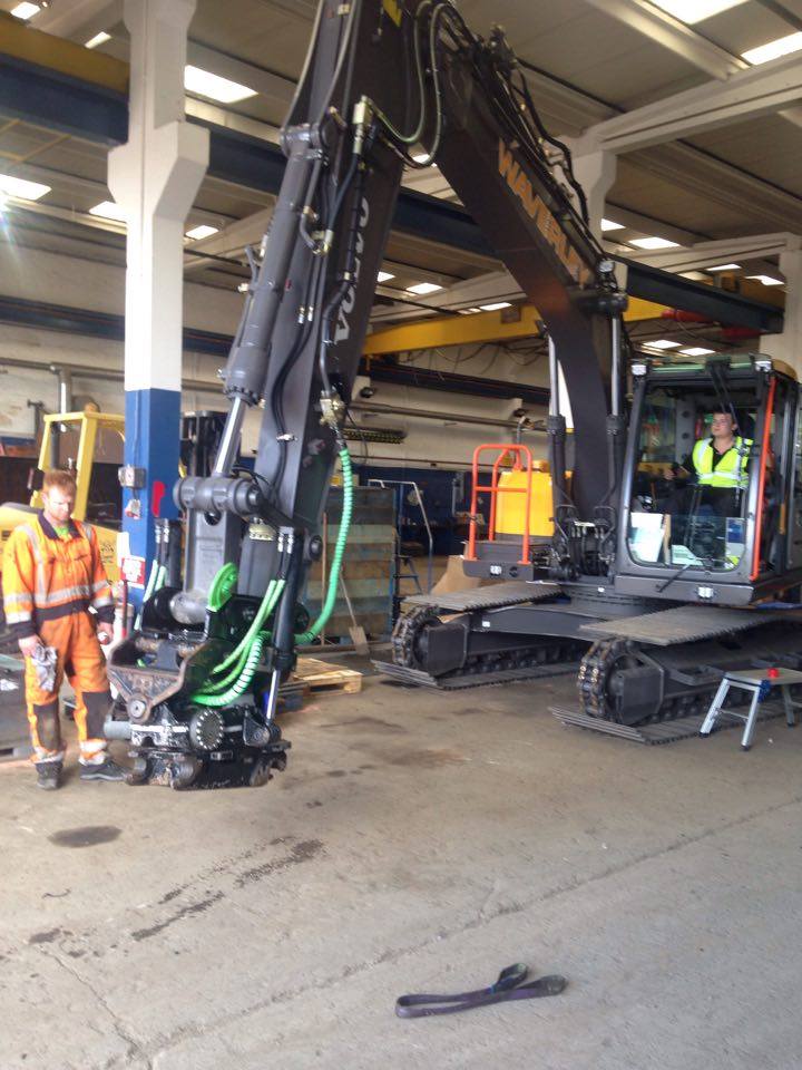

This was our Steelwrist getting fitted at Volvo Stirling. It had been on one of our 140Ds and Steelwrist overhauled it before it was fitted to the 140E.

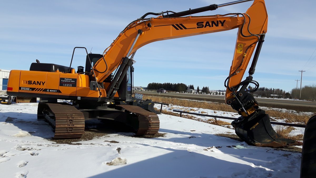

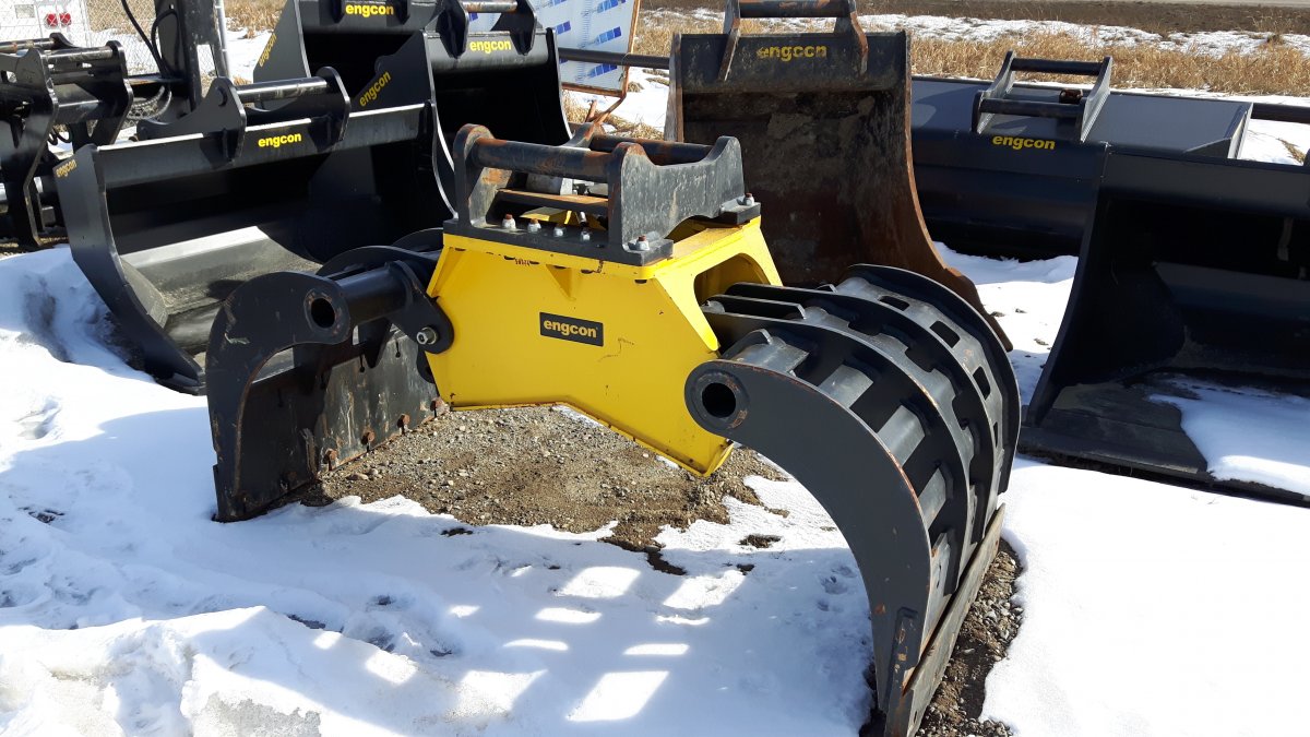

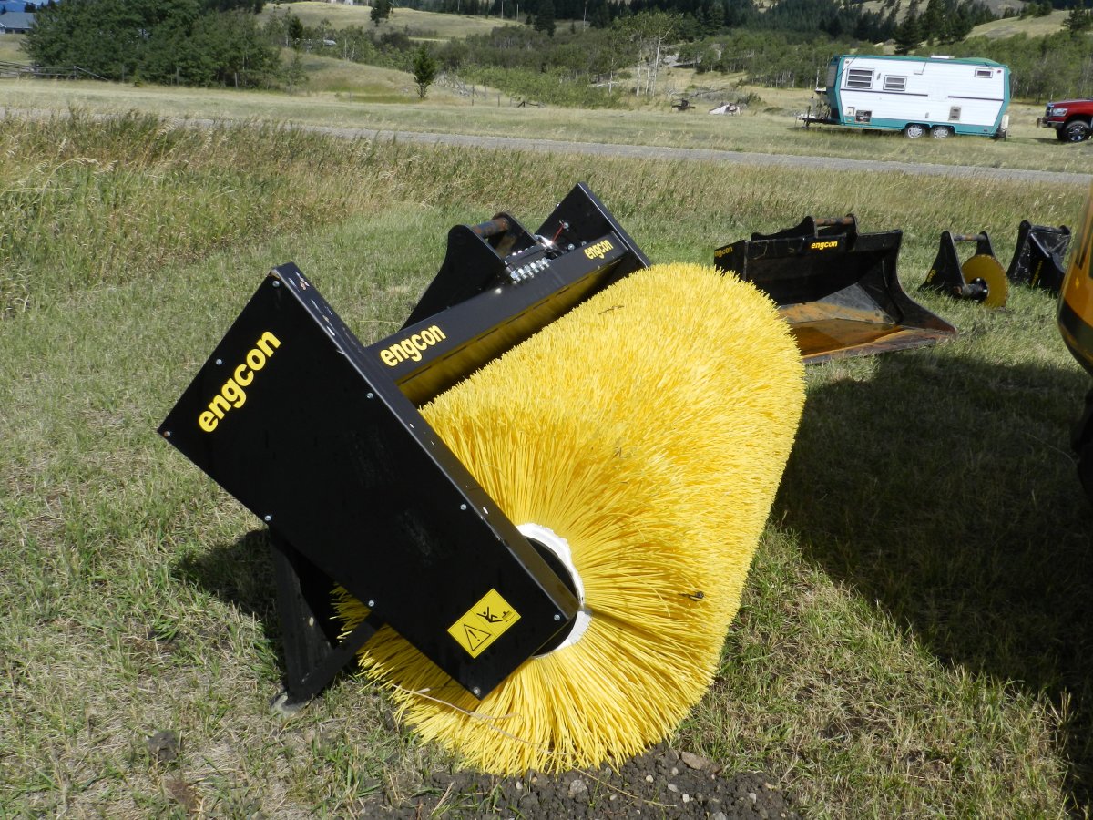

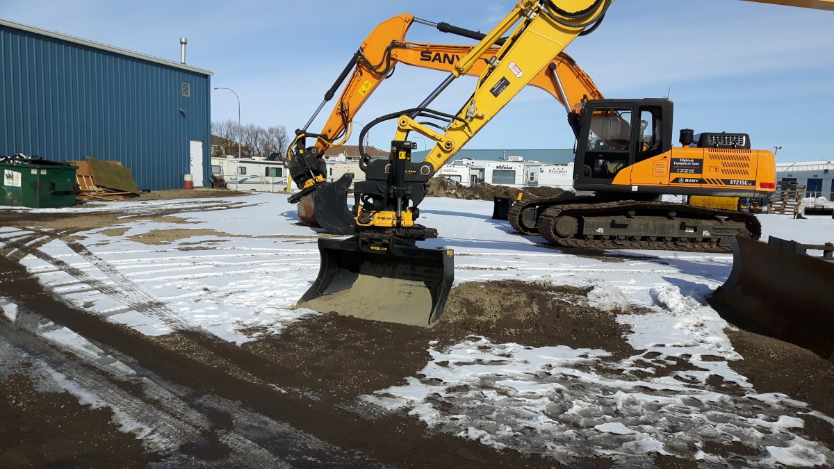

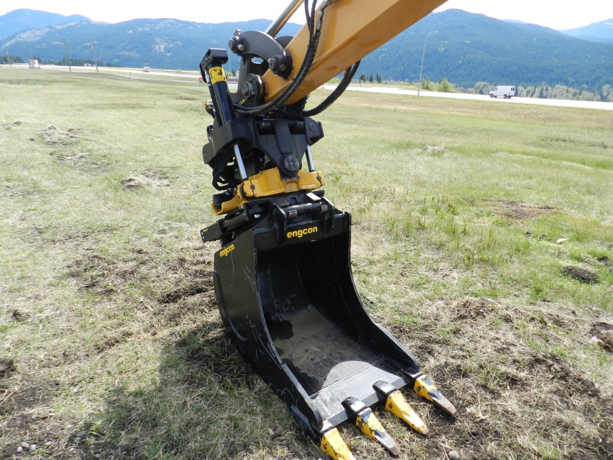

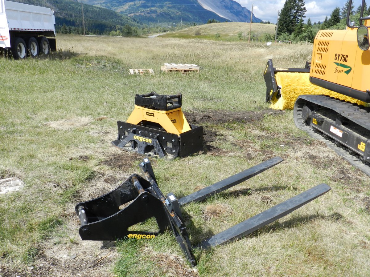

I posted these photos once before either on our Facebook group or my facebook group or on BCEF. But the guys that took over the engcon sales in Calgary a couple years ago also bought out this Sany and recently contacted me about buying it from them as they are looking to get a smaller demonstrator machine to make it easier to transport behind their van. They want $175,000CAD for it which is quite steep for me as I'm in that 'startup' phase trying to get the work and some financing. Apparently it would come with all these attachments, as well an autogreaser, and 'I Dig Best' grade control system which is worth about $26,000CAD. I talked to this financing outfit and of course they didn't want to deal with me as I'm just a startup. I wasn't surprised and didn't really want to be on the hook for that much money to start with. But I thought you guys might like to see some photos of a neat machine with the Canadian Rockies as a backdrop.
few bobs-worth of tackle there, for the bucks, Bert .... aside from the yellow thing it all comes with :rolleyes:;)

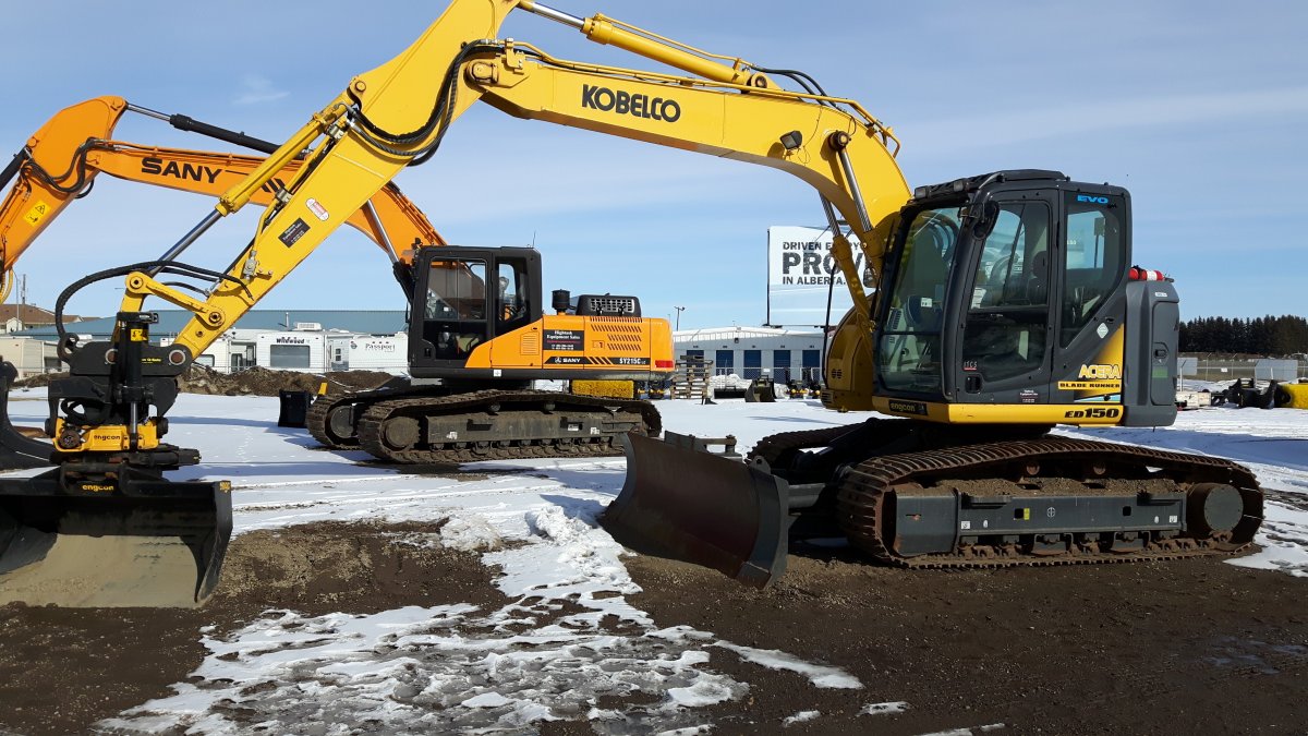

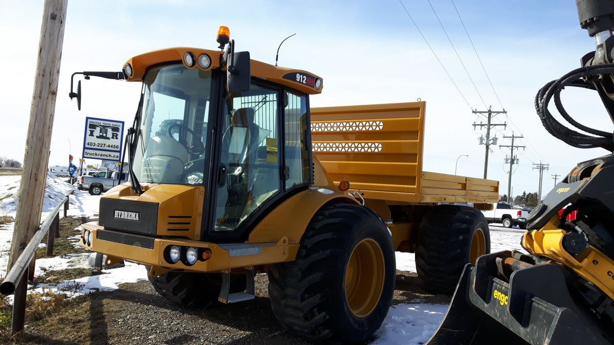

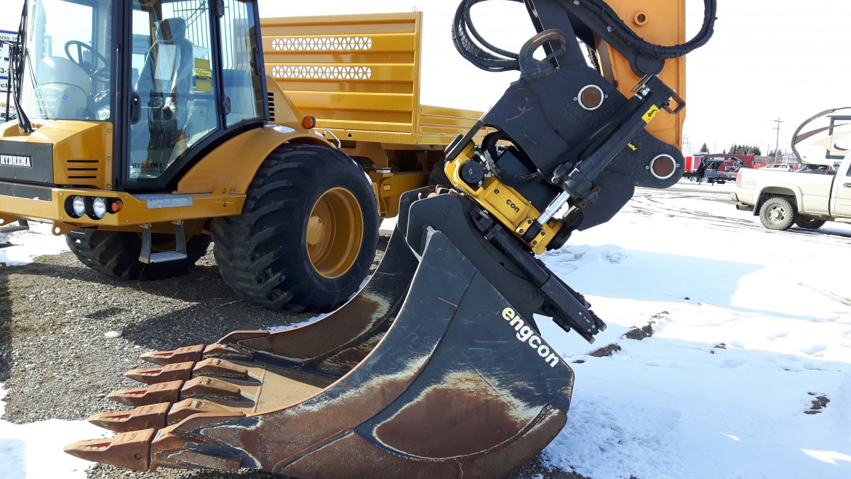

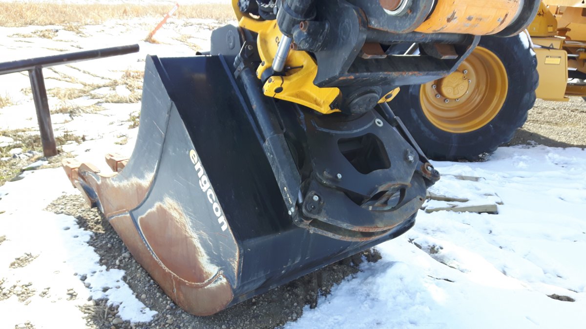

These guys at the time were a Sany dealer as well Eng con but they weren't very good at it and marked up the prices ridiculously and pretty much lost their shirts doing it. I however demo the Kobelco Blade Runner which was a really nice machine but all the gizmo's on the tilt-rotator didn't function properly and the salesman of course didn't know how to work it.

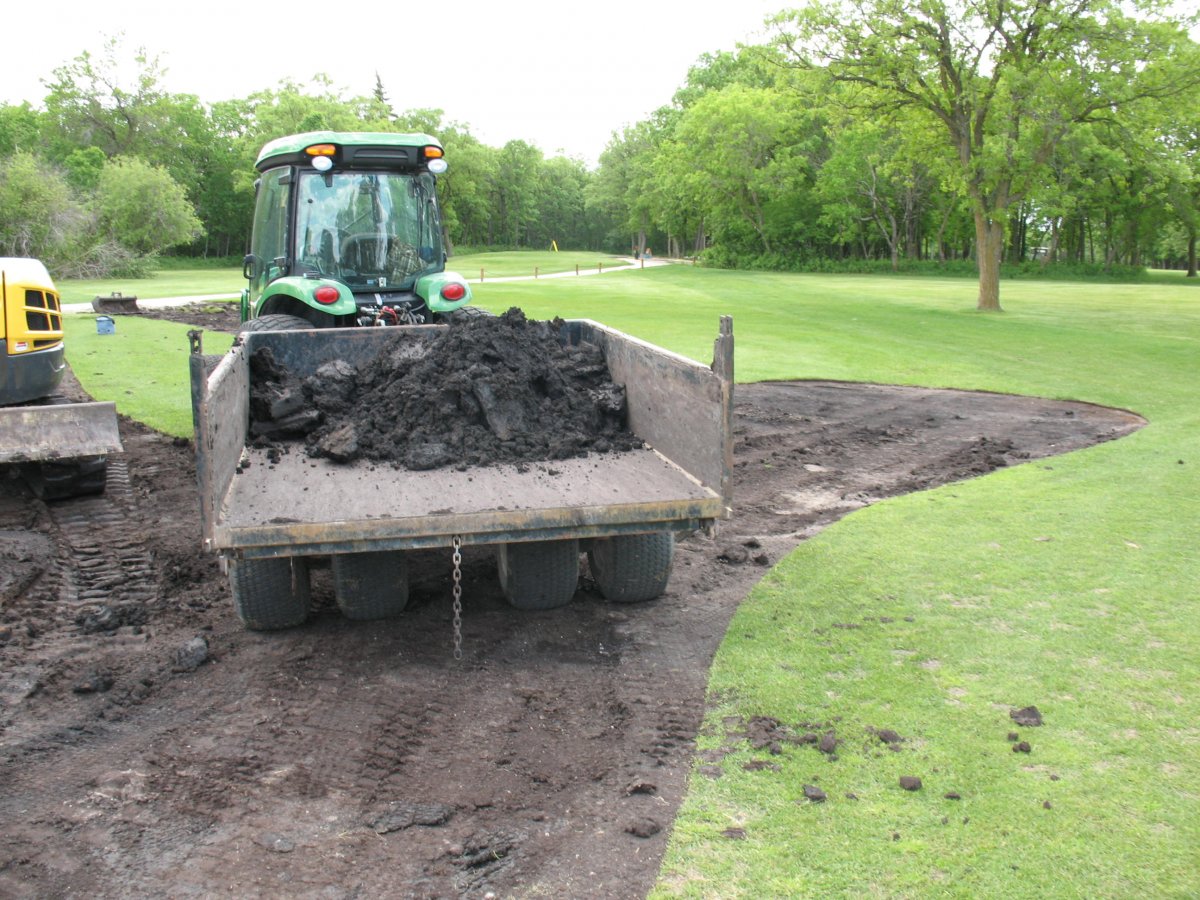

This is the only machine I've used with a tilt-rotator it's an Indexator Rototilt in case you can't tell. It didn't have an automatic oil coupling system or anything fancy like that. But it had three buckets a home made 12" trenching bucket (shown), 24" tooth bucket, and a 30" or 32" ditching type bucket. Controls seemed to be of a solenoid type so no rollers or anything nice like that on the joysticks. It was purchased largely for doing golf course work so minimal disturbance was key. The 12" bucket was a pain in the ass to use as it would plug up right away with clay and would require digging out with a spade. I never used the 24" bucket but loved using the ditching bucket it was about as close to perfect as one could get for working in our shitty effing clay. Sadly this company was really weird to work for and they started running out of work and had to sell off a bunch of equipment and lay off a couple of us but that's a story for a different day.

Anymore photos of the kobelco with the dozen blade Bert? Looking like one of they fancy v pat blade.
BertB.
BertB.
Not of that machine in particular but that is a 6 way blade on that machine it's built specifically for dozer work and has a beefed up undercarriage to do it. Friend of mine has one of the first ones that came out in the late '90's.

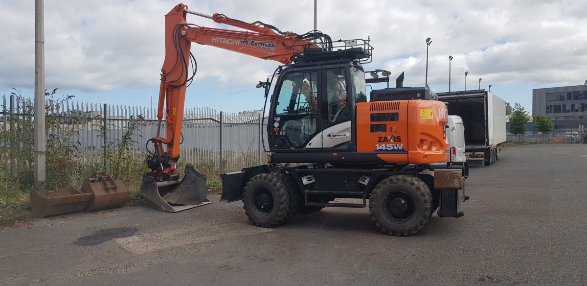

Hi here’s a few pictures of my set up. Just about got the hang of it now 😂.
