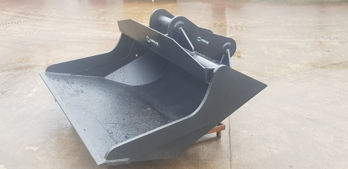

Actually there are times when a simple tilting bucket would benefit from the Scandinavian style back to it, I can think of a few instances where the corner of the bucket would get in the way. But it’s no big deal really. Really depends what your doing with it I suppose.
One of the reasons I've gone for a proper bucket rather than modifying a grader to S45.... Also future proofing

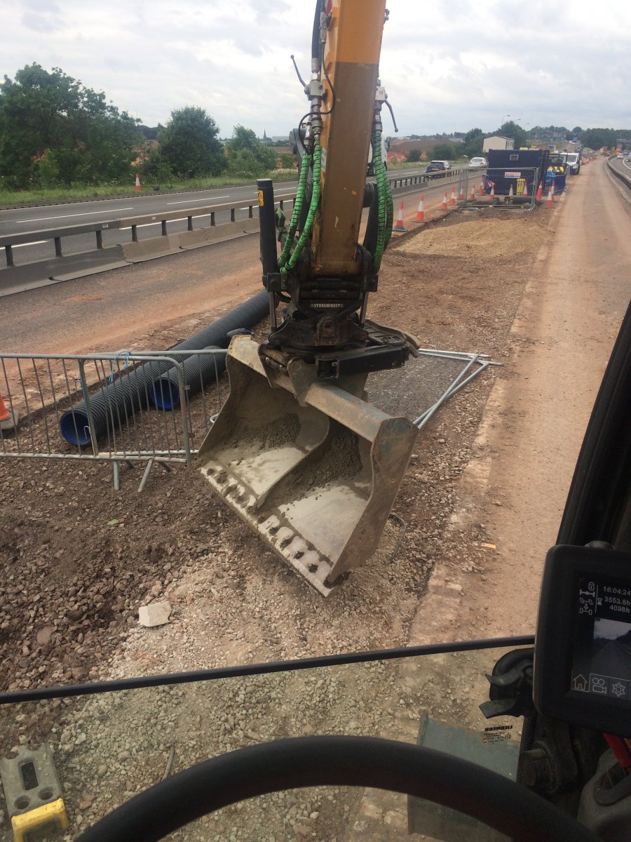

Talking of Ditching/Grading buckets, Whoever's make this is, its like having a 1 ton weight on the end of the dipper plus the weight of a steelwrist cant knock the build quality but very thick plate, wrong profile and geometry, It was altered while up on the M1 at Rotherham/Sheffield a couple of years ago
No one makes this, this was done by a lad up there who’s main work is refurbishing attachments for the demo industry, (when I first went to meet him, he was line-boring out a concrete muncher for I think a 50/60 machine!!),if I remember it was a good ditching bucket that the driver at the time wanted altering to that style and Robert (the welder) was just working to what said driver wanted, with no drawings or anything.
On a side note, he’s one of the old school type gentlemen, and helped me and another owner driver out a number of times during that contract. The first job he did for me was replacing the cutting on my engcon bucket. He understood that we were working 7 days a week and was more than happy for me to drop it of at 8 in the evening and pick it up, all done and dusted at 6 the following morning.
As I said Ollie the build quality is great but it sure is a heavy bucket, quite why Phil would want to transform a good bucket into that is only for Phil to know, I have also seen a guy advertising the very same converted bucket on the web I'm not saying it is Robert as it was a bucket company but I cant remember the name.
Your right Old school can be a godsend at times
Pretty sure it wouldn’t be him, like I said, his main line of work was with the demo boys and was flat out with them.....as for someone advertising converted buckets, there seems to be plenty who have jumped on the band waggon who are knocking up buckets and passing them off as tiltrotor buckets, only for the end user to have to pick up the pieces of something that is, wrong weight, wrong size, wrong geometry, and that makes a big difference to the performance of the tilty.
