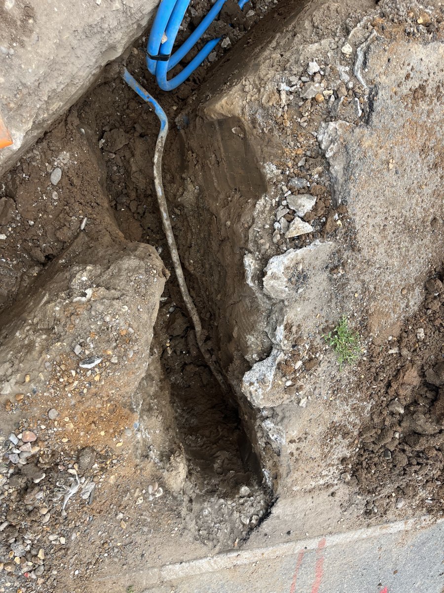

The main thing that Affinity was concerned about was the new was at the correct depth.
Mind you the old lead was at about 2 feet :eek:
And this is how I found out when my toothless bucket touched it :p
I hate lead pipes. Hobble stuff to work with and you need proper magic to do anything with them.
That lead pipe is really thick with a really small bore up the middle.
Even the 'lead lock' connector used by Affinity wouldn't seal at the first attempt :oops:

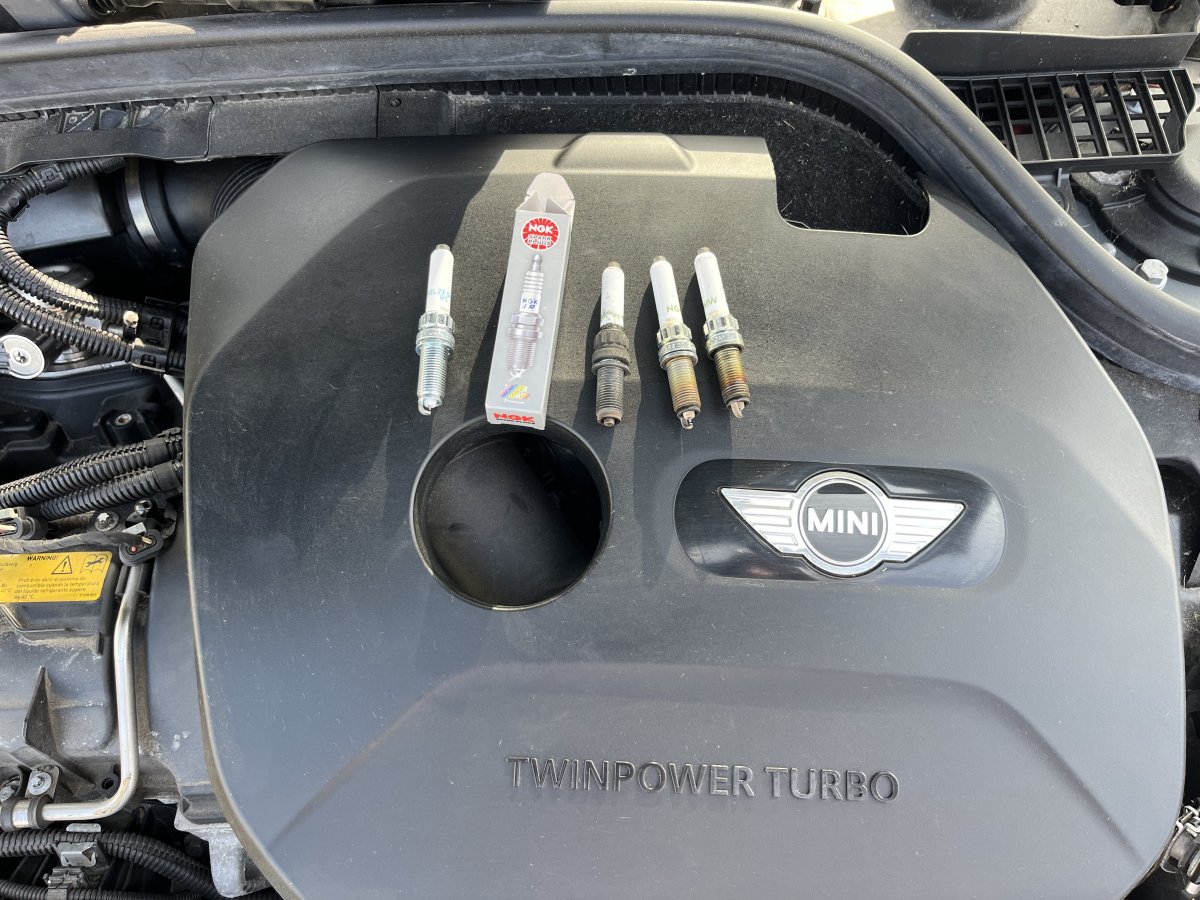

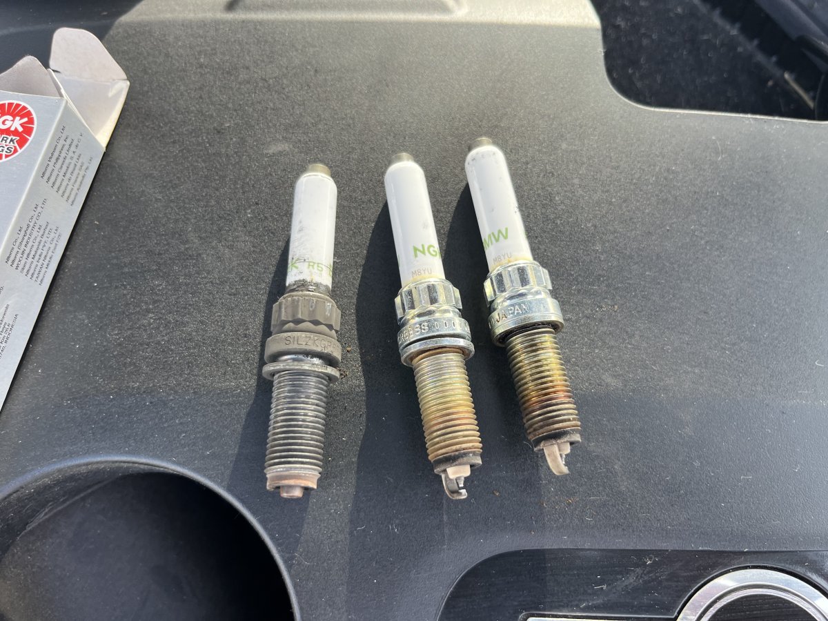

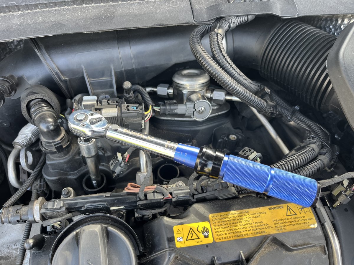

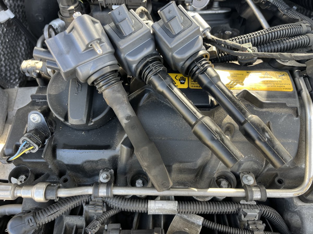

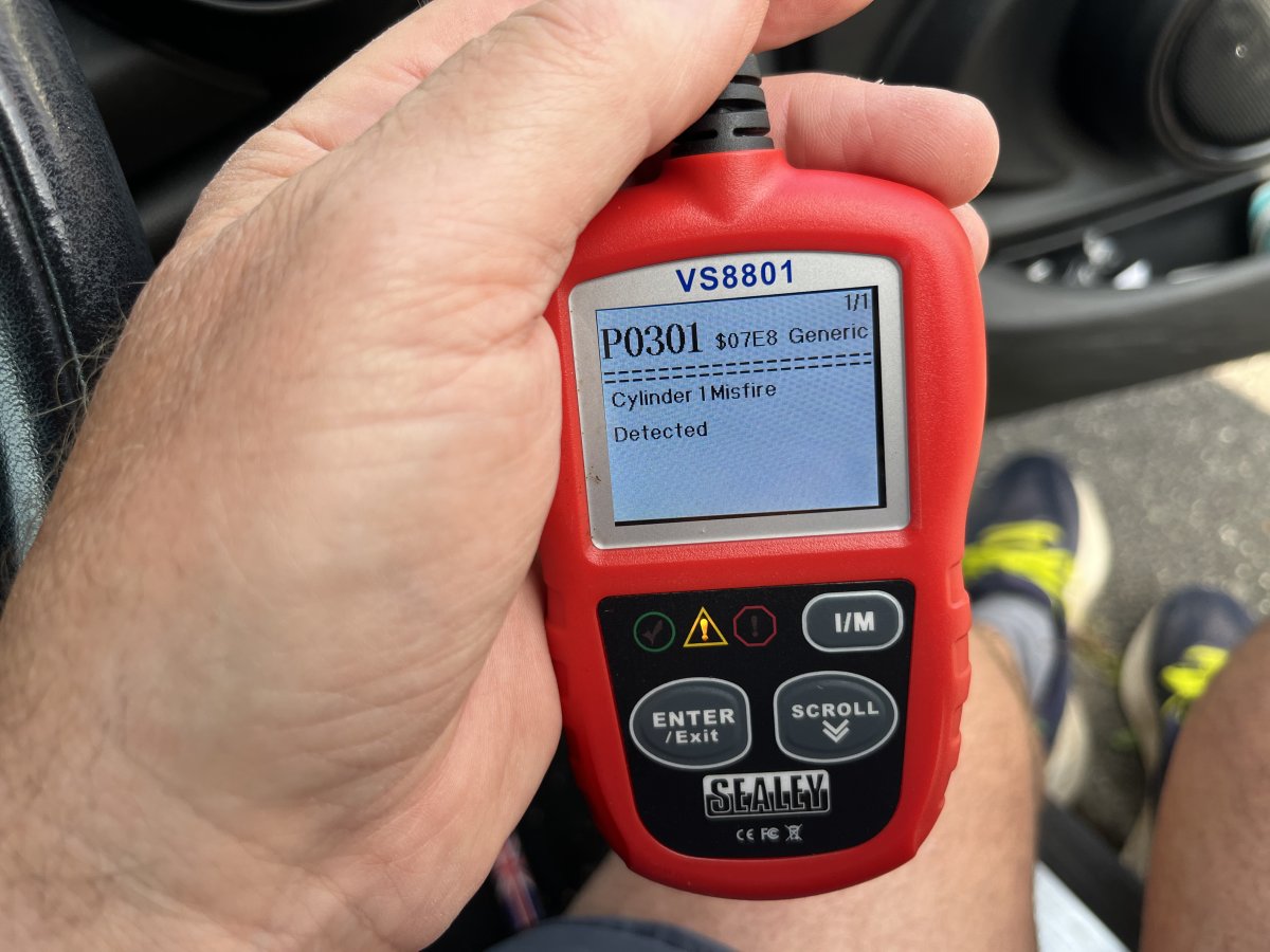

So the day after the lead mains replacement debacle my eldest daughter phoned, "Dad my car is running rough and has a warning light on the dashboard" :oops:
She has a Mini Cooper which I usually service for her....
Me - "I know what that will be. I still have the new spark plugs on my bench"
When I serviced it months ago I couldn't change the plugs because I didn't have the skinny plug spanner.
So a few months later, I was still waiting for her to pop in for a spark plugs pit stop....
Yep here's a clue...
And another clue....
And THREE nice new NGKs going in....
All torqued up and good as new ;)
My brother said, "So what happened to the tip. Can you just take the head off and look for it" :eek:
I don't even want to go there. See told y'all I've been busy.
But in actual fact it quite a nice car, no wonder she loves it
Another job jobbed :cool:

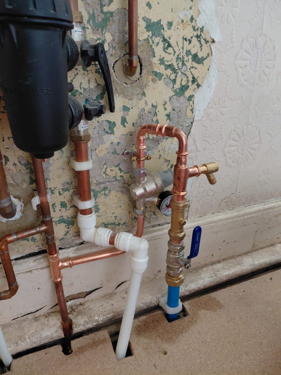

Something like this .
Ignore all the shite plumbing to the left… that’s not ours.
I’ve given up on brass taps . We use full bore lever for cold mains , and pegler full bore HU bib taps . Don’t get issue with them . Traditional brass stop taps and outside taps are not worth touching these days .

Now that is an excellent example of how to do it properly (y)
But I do note a few things worthy of comment.
1. You are using those crimp on joints as opposed to nice end feed solder joints. How do you find them?
No 'use of heat' and saving in time springs to mind.
2. Pressure gauge on the regulator may be difficult to read, but still a nice touch.
3. Love the lever valve (as opposed to brass). Do you know if they available as a 90 deg fitting?
And yes the stuff to the left is utter crap :poop:, even I know that :ROFLMAO:

We have been using press fit on domestic since 2009. Quicker and cleaner and safer and more reliable than endfeed. Less contamination to flush out in heating systems ….
Only down sides are cost of fittings - easily offset by labour saving, and they are bulky and not really suitable for anything left on show .
Think we have about £15000 worth of press tools spread around the vans. And half that again in fittings.
Plumbing isn’t a cheap hobby.
Plumbing isn’t a cheap ….
Those 316 stainless ones with the blue bands could look very lovely on show 🙂
Do like to see tidy installation 😁
