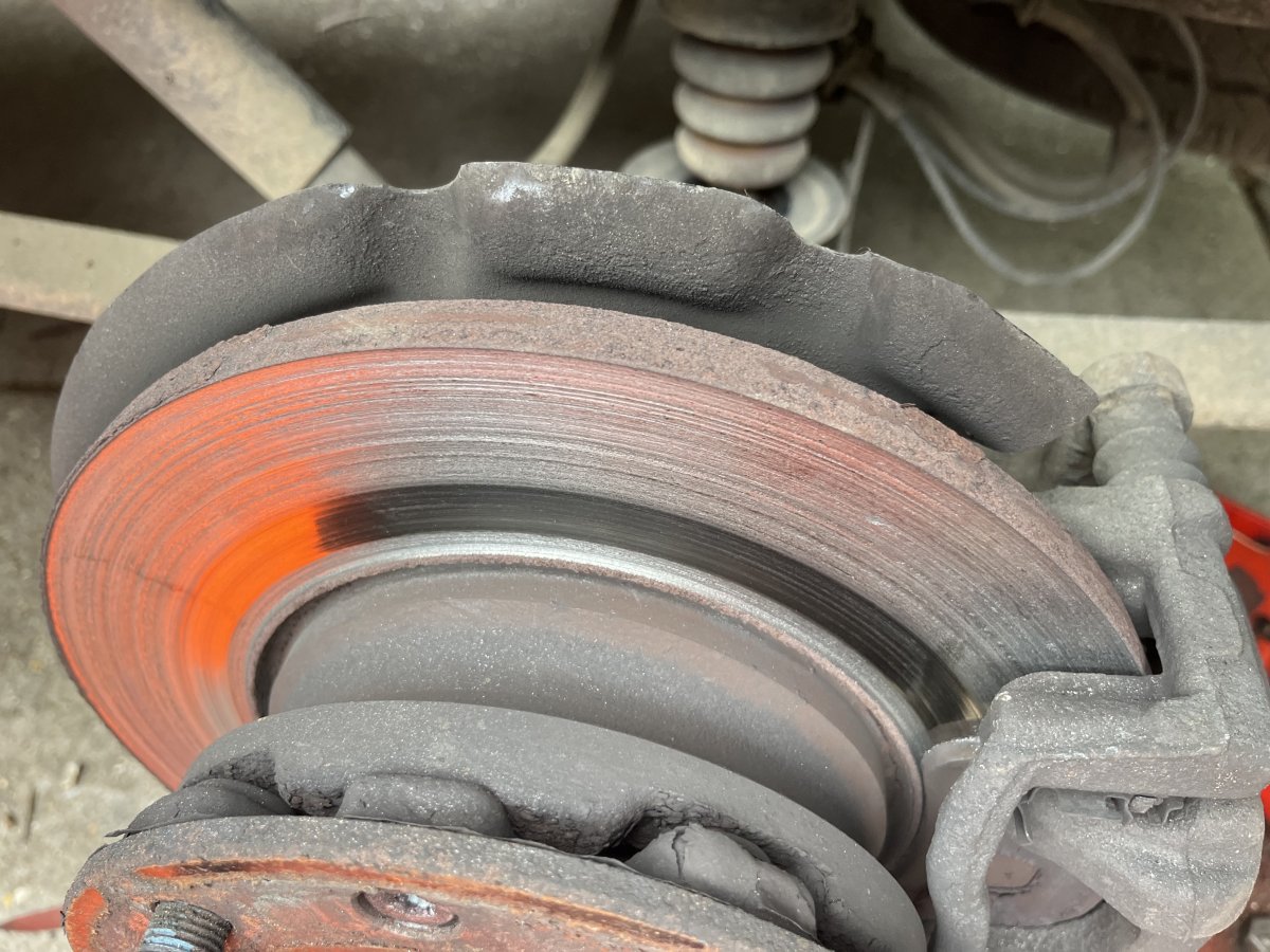

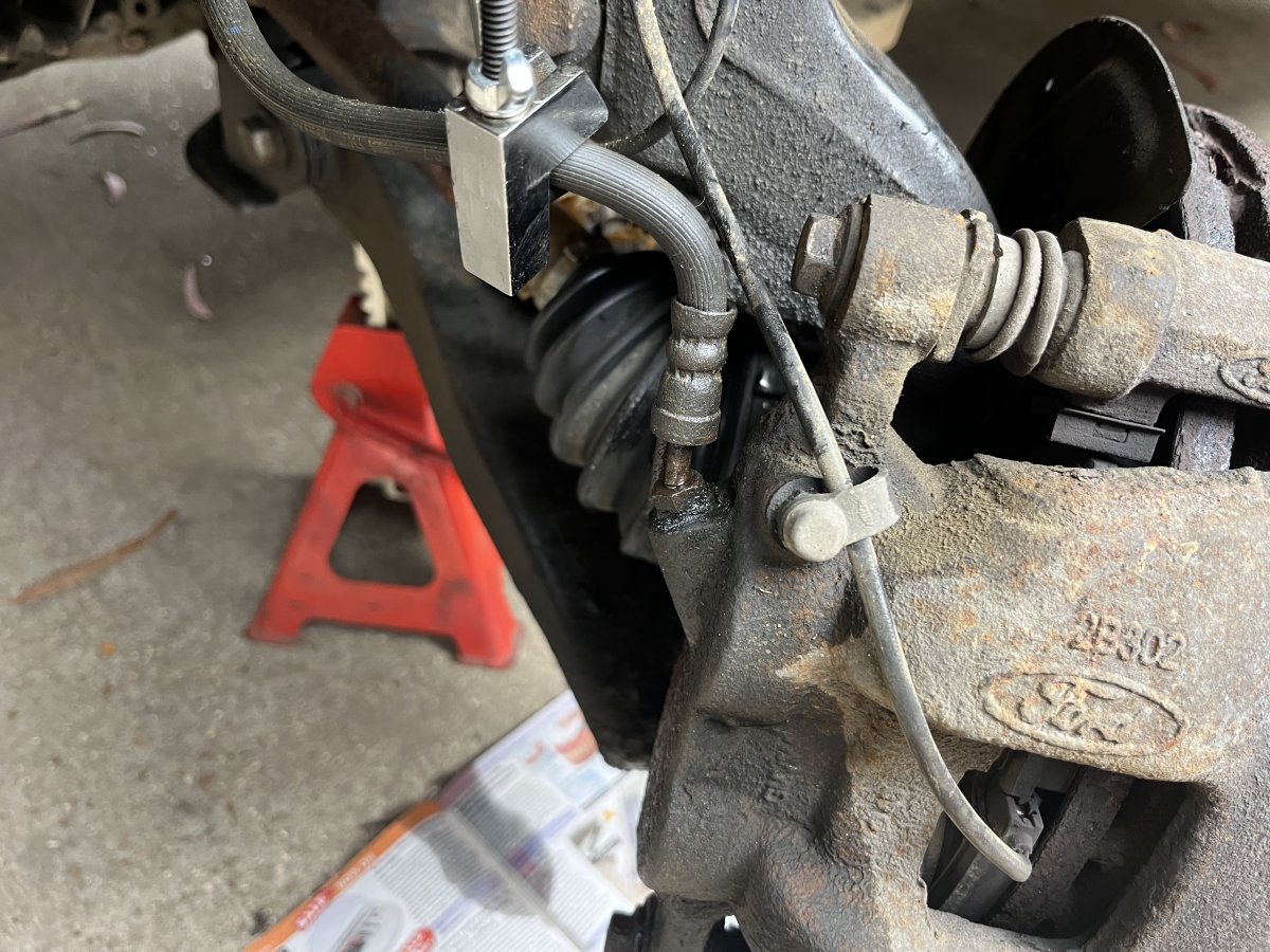

Apparently his groundworker reported that the brakes were worn and it needed new discs and pads on the front.
Quick inspection revealed this to be a load of bull

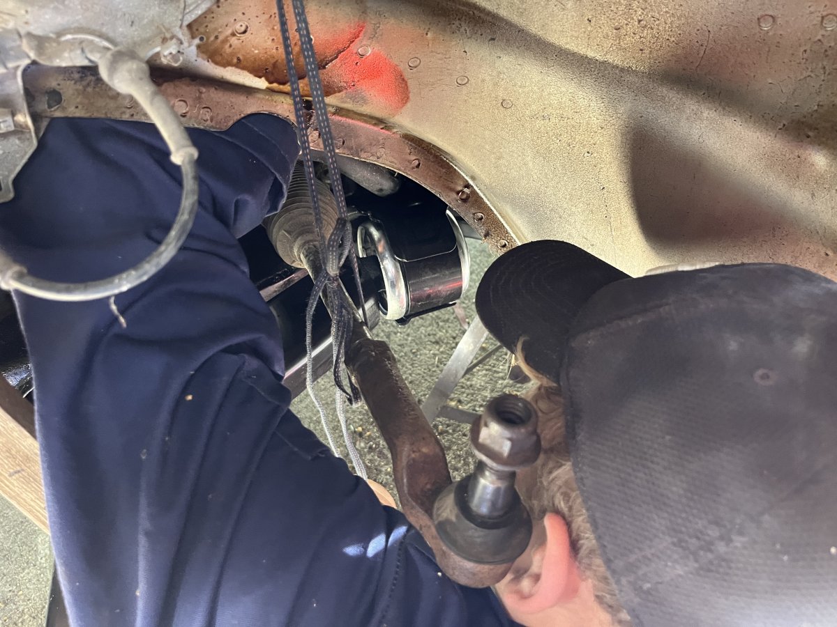

- the big clue was the whole left front wheel was covered in brake fluid....

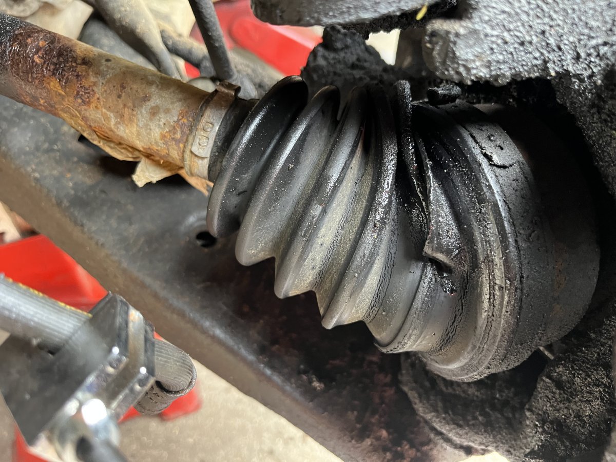

The remnants of a large carrier bag were wound around the drive shaft. And had destroyed the CV rubber boot and fractured the steel part of the flexible brake pipe. The discs and pads were about half worn and serviceable

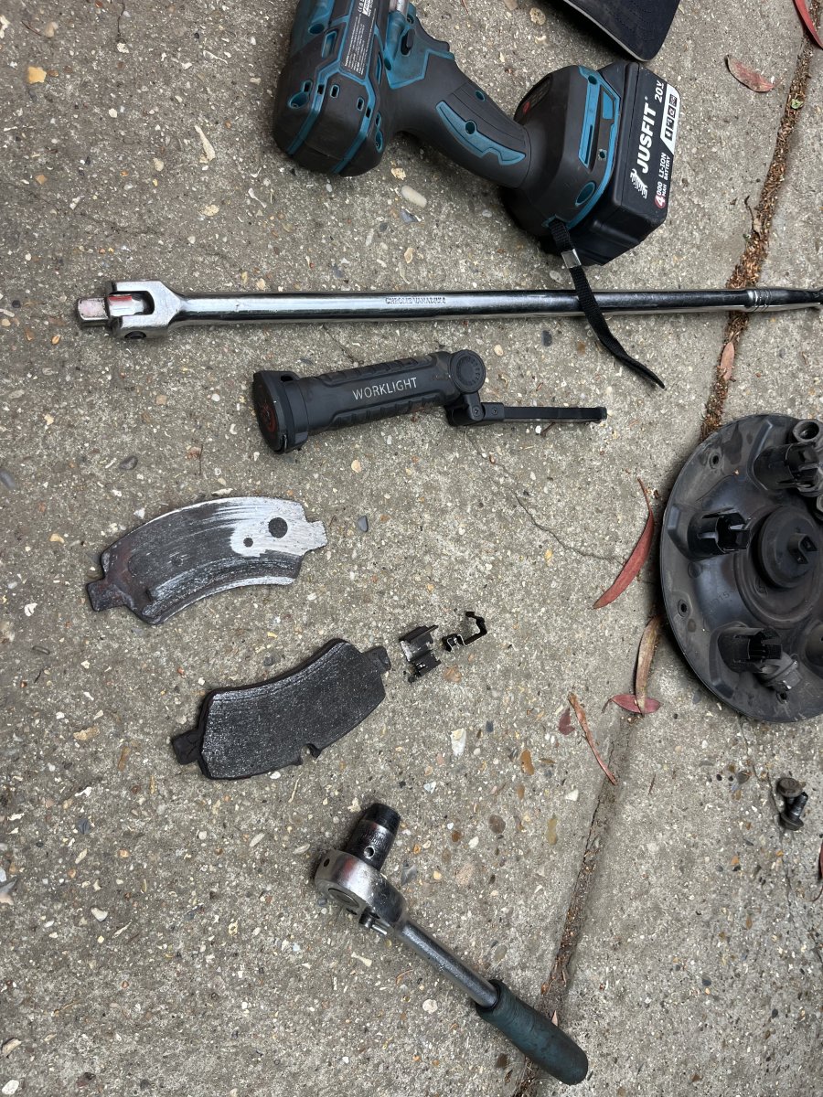

So while we were waiting for Eurocarparts to open, "Let's just check the rear brakes".....
HTF do you drive around in a van when the brakes sound like a train coming into the station.
This is the van that has just had an engine rebuild after the wet belt let go
So we added rear brake pads to our click and collect list...
