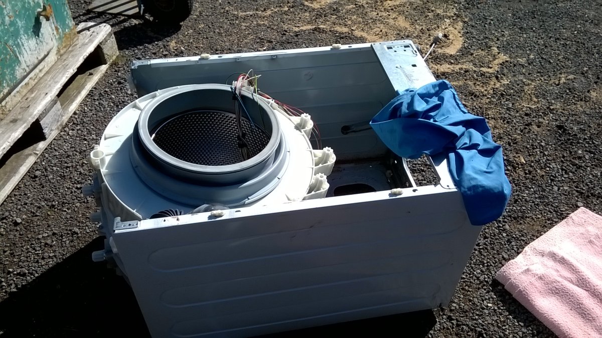

Sharon (SWMBO) said the other day, "Oh by the way the washing machine has been making a banging noise for a few days now." :eek:
It's a very nice 'top of the range' Miele Supertronic W5000 which was new back in 2012.
Thinking "Bugger, it could be the spider gone"
So I set about stripping it down with view to fixing whatever was wrong.....
Usual check on the drum revealed absolutely no play in bearings and/or spider. 1600rpm spin with no load, still quiet, and these machines are super quiet.
So stuck a few items of my stinky, sweaty running gear in for a quick wash - and there it was on spin - a clanking/banging noise like I was trying to wash a toolbox full of spanners - WTF :ROFLMAO:
So you will see that I took the sump drain off to check for metal filings etc. And there was this little heater clip that fell out :oops:
Ah ha a clue - gave the heater terminal a wiggle and it moved. Obviously flapping around and banging the drum!
Pull the heater and found that it was cracked and which had obviously caused it to let go of the little bracket and the one inside the drum.
Quick check with the Fluke revealed that it was indeed dying :geek:
Anyway good old Amazon had a pattern heater at £21.99 v £85 for genuine Miele.
Delivered the next day and now back up and running.
Gonna keep this machine going forever - we love it :love:

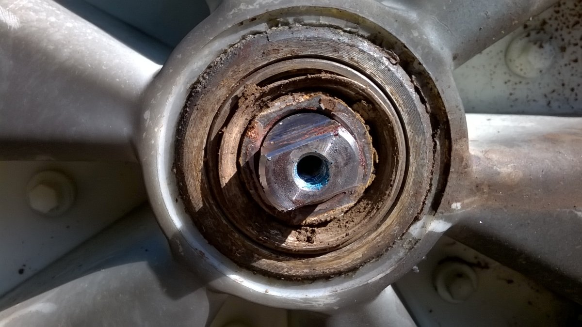

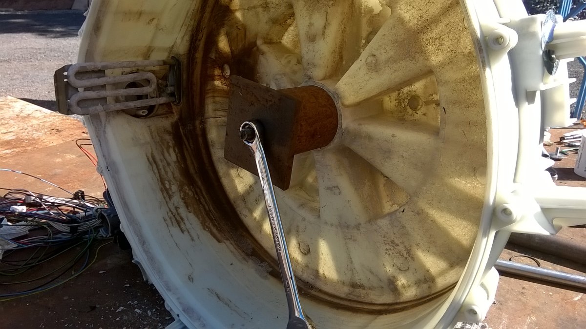

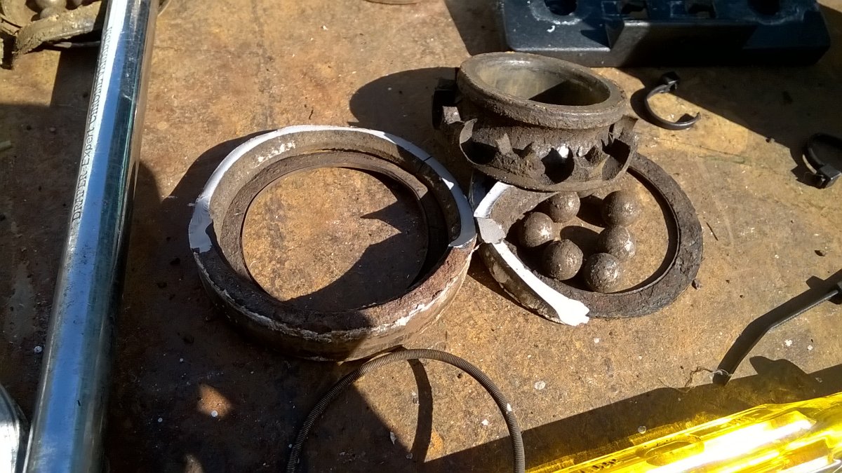

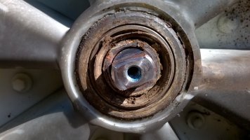

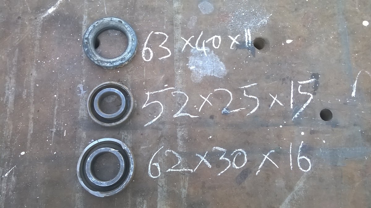

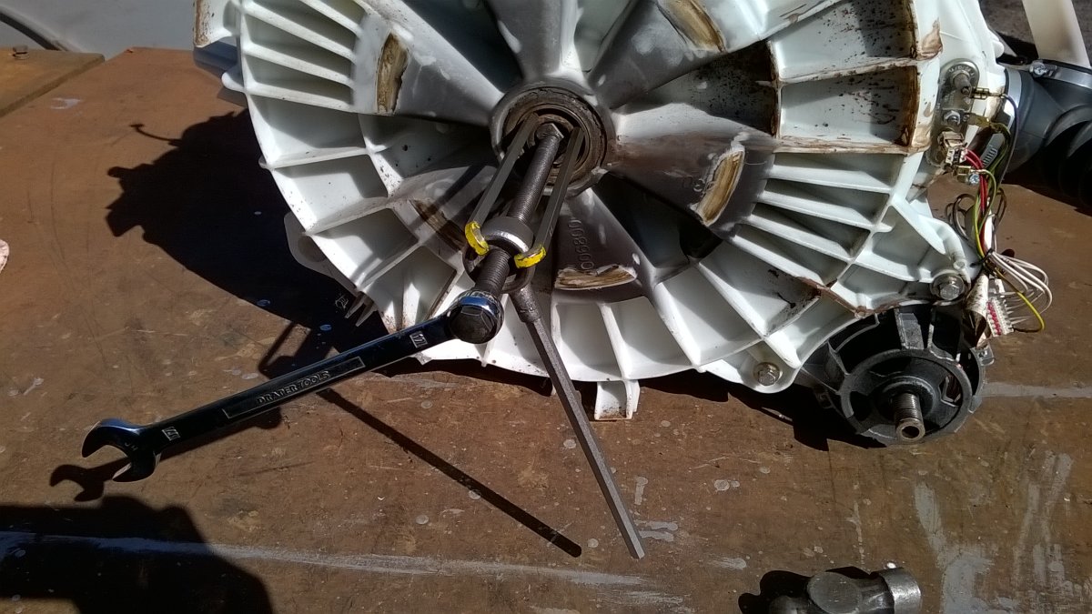

Creda Excel 1200 here on its 18th year IIRC -- had a set of drum bearings about 7 years ago - otherwise, been a great machine (touch wood) -- complete strip to do the bearings though
View attachment 70163 View attachment 70164 View attachment 70165View attachment 70166View attachment 70167 View attachment 70168
Yep I too have done loads of bearing replacements like this over the years for us and family (y)
How was the spider on the Creda? On ones made from cheap cast aluminium they often corrode and let go.
On newer machines, it's difficult to change the bearings and seals. The outer drum is 'sealed' and you are expected to change the whole drum unit.
Had this with our very nice Bosch a few years ago. You can carefully cut open the outer drum, replace the gubbins and reseal.
Drum assemblies cost hundreds of pounds, so that Bosch was flogged to a 'messer' for spares or repairs :ROFLMAO:
