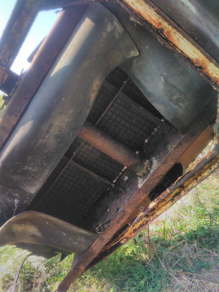

I built this to wash gravel👍 it’s now got a 15 mm punch plate to clean ceramic balls that go in a aluminium Furniss

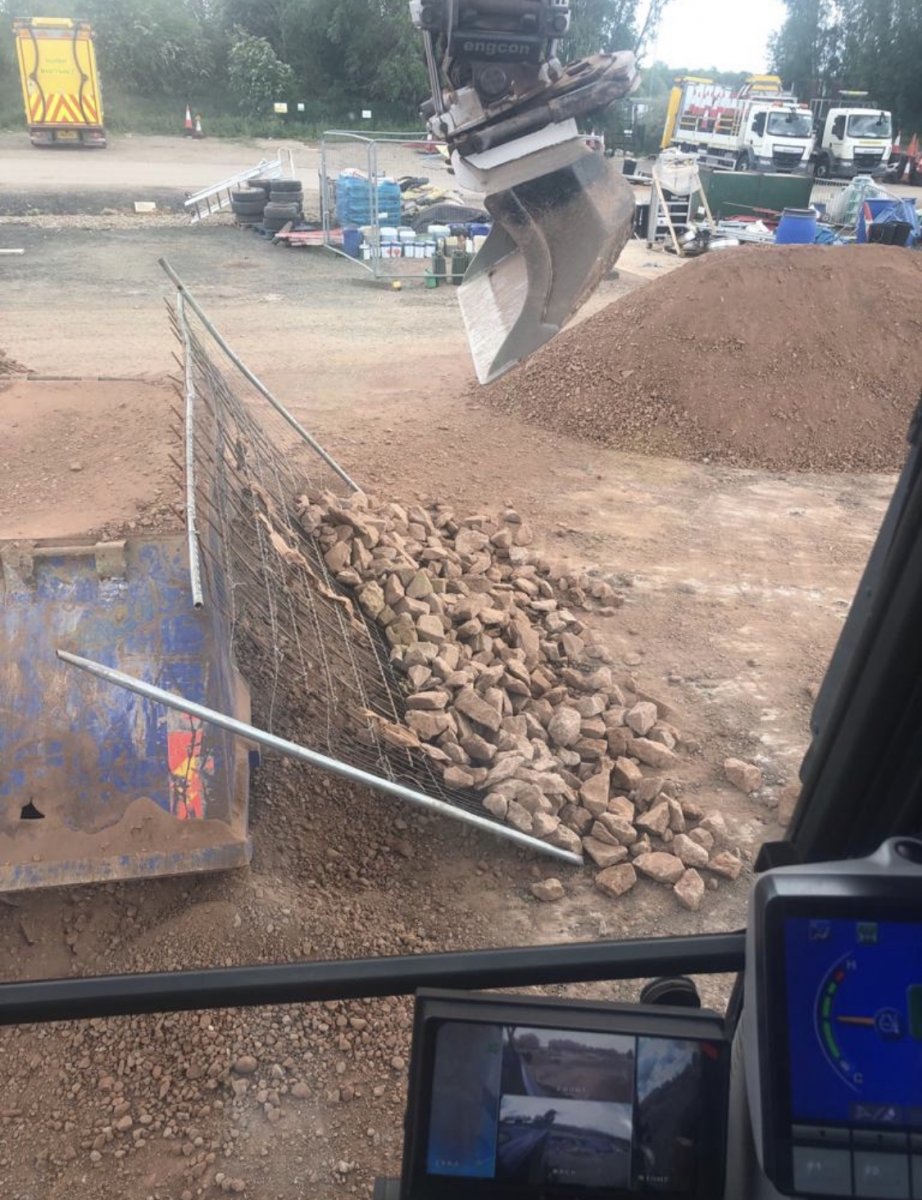

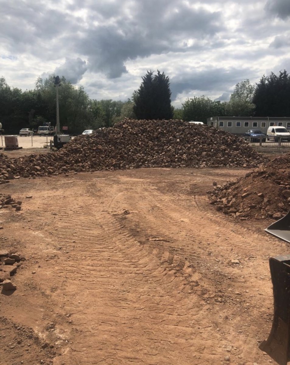

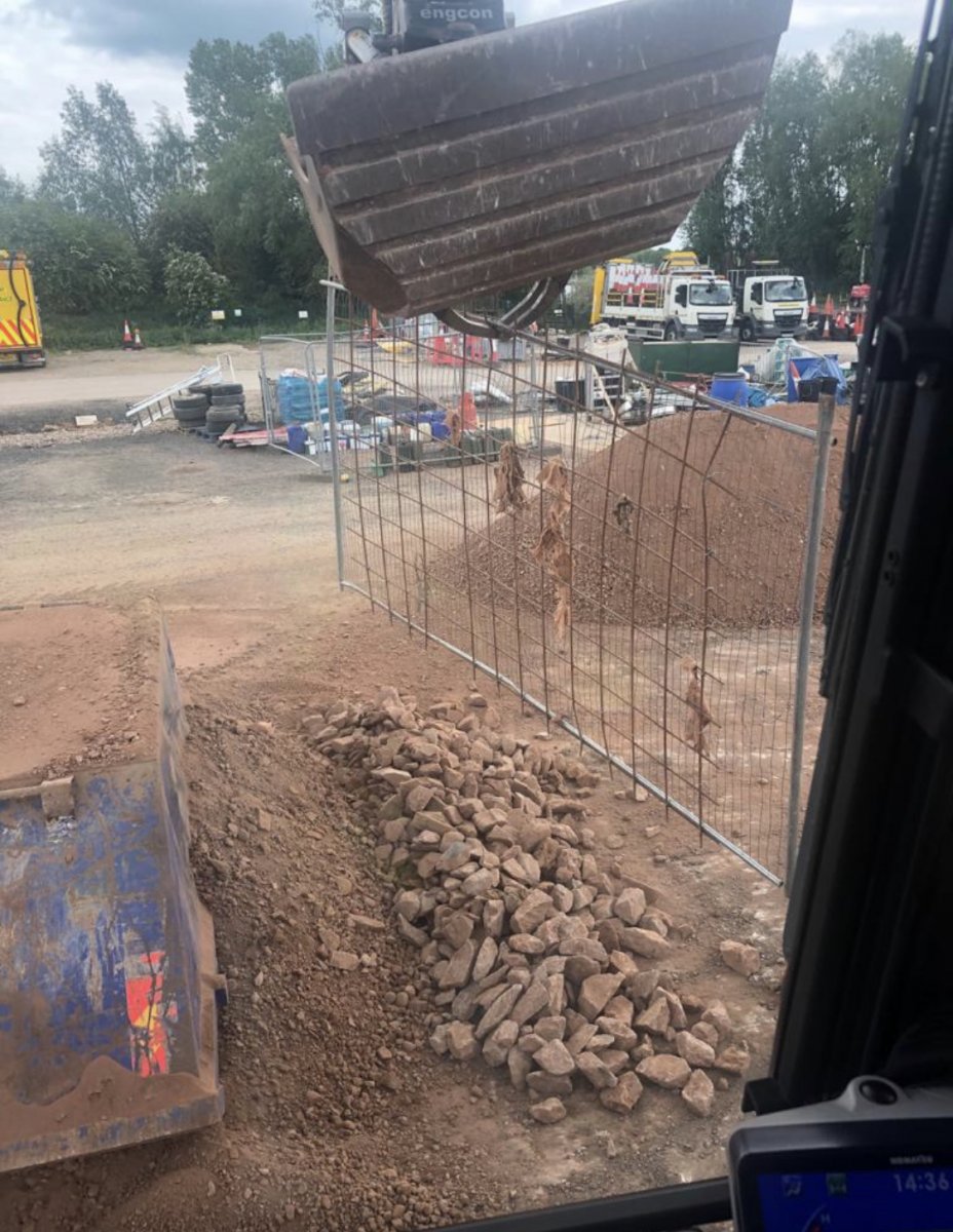

That idea might just get borrowed next week!!
If I remember it was all going to get off loaded to the tip🙈, this way they had two useable products🙂, just tied the mesh (used that to give it a bit of strength) to the harris panel with tie wire and away I went...got a few strange looks when I was setting everything up, but when they returned after an hour and saw the start of two sample piles starting to grow......I got the nod of approval and that was me set for another two weeks worth of work🙂
