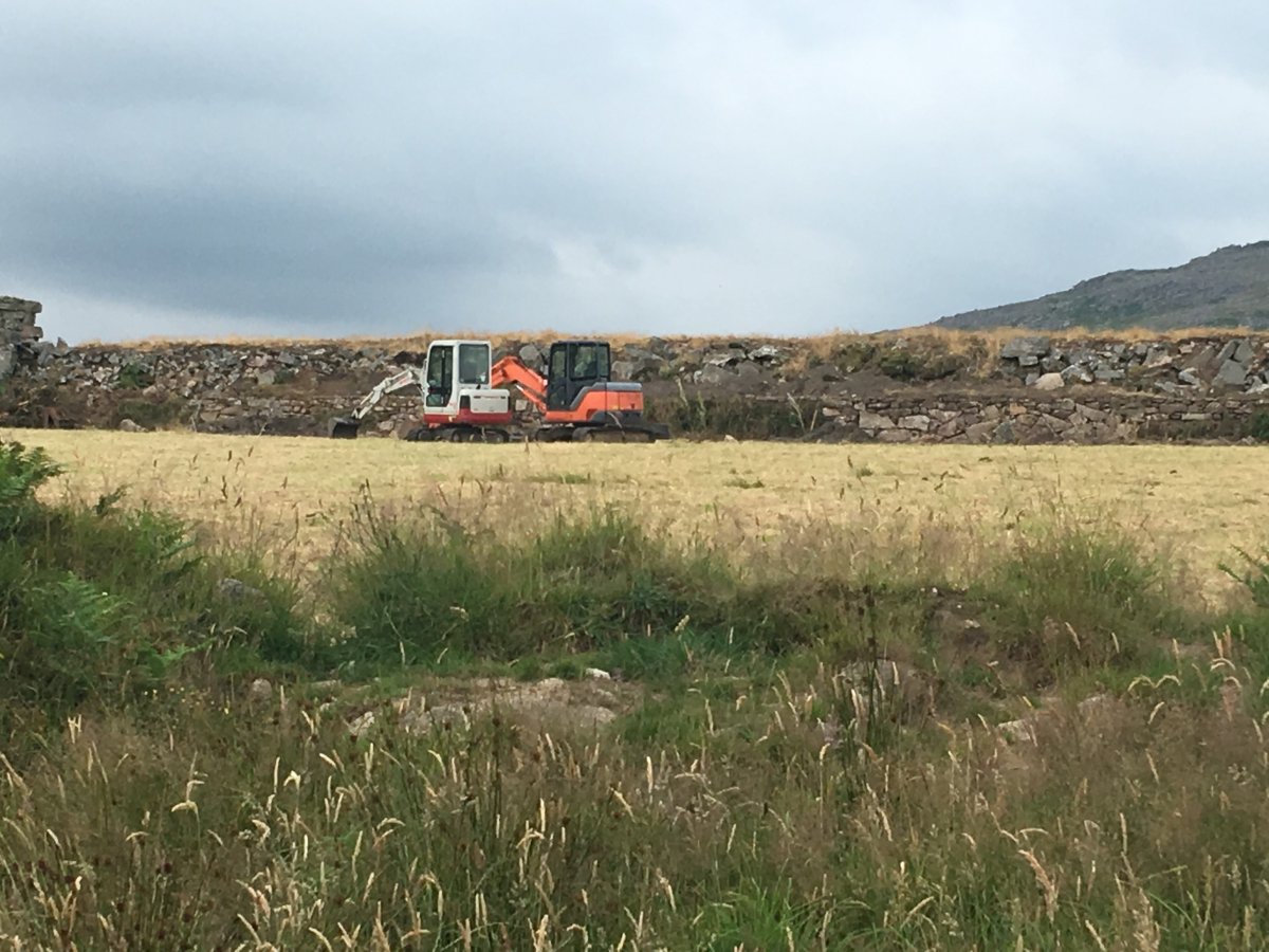

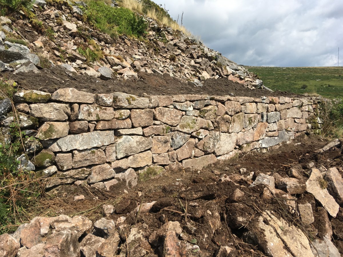

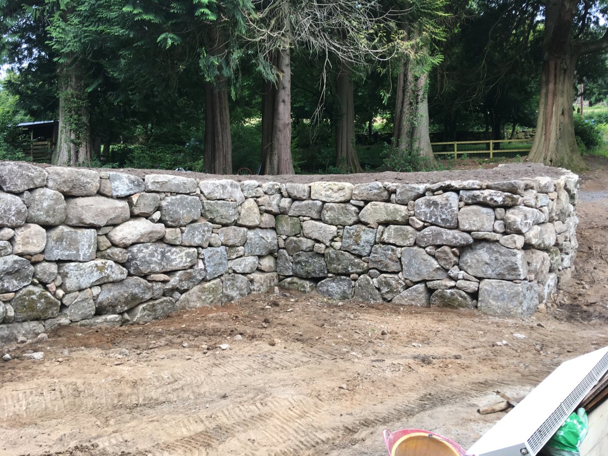

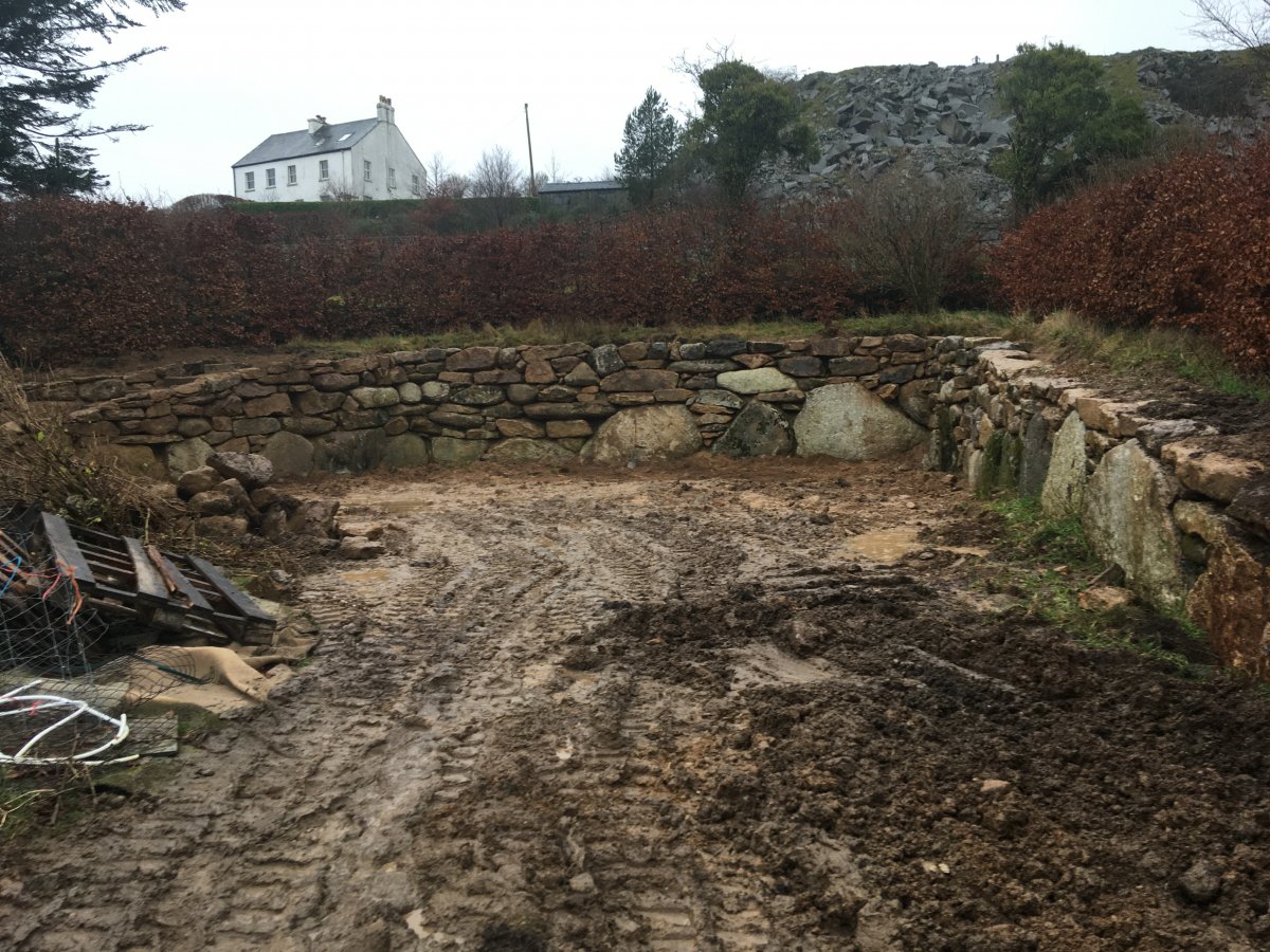

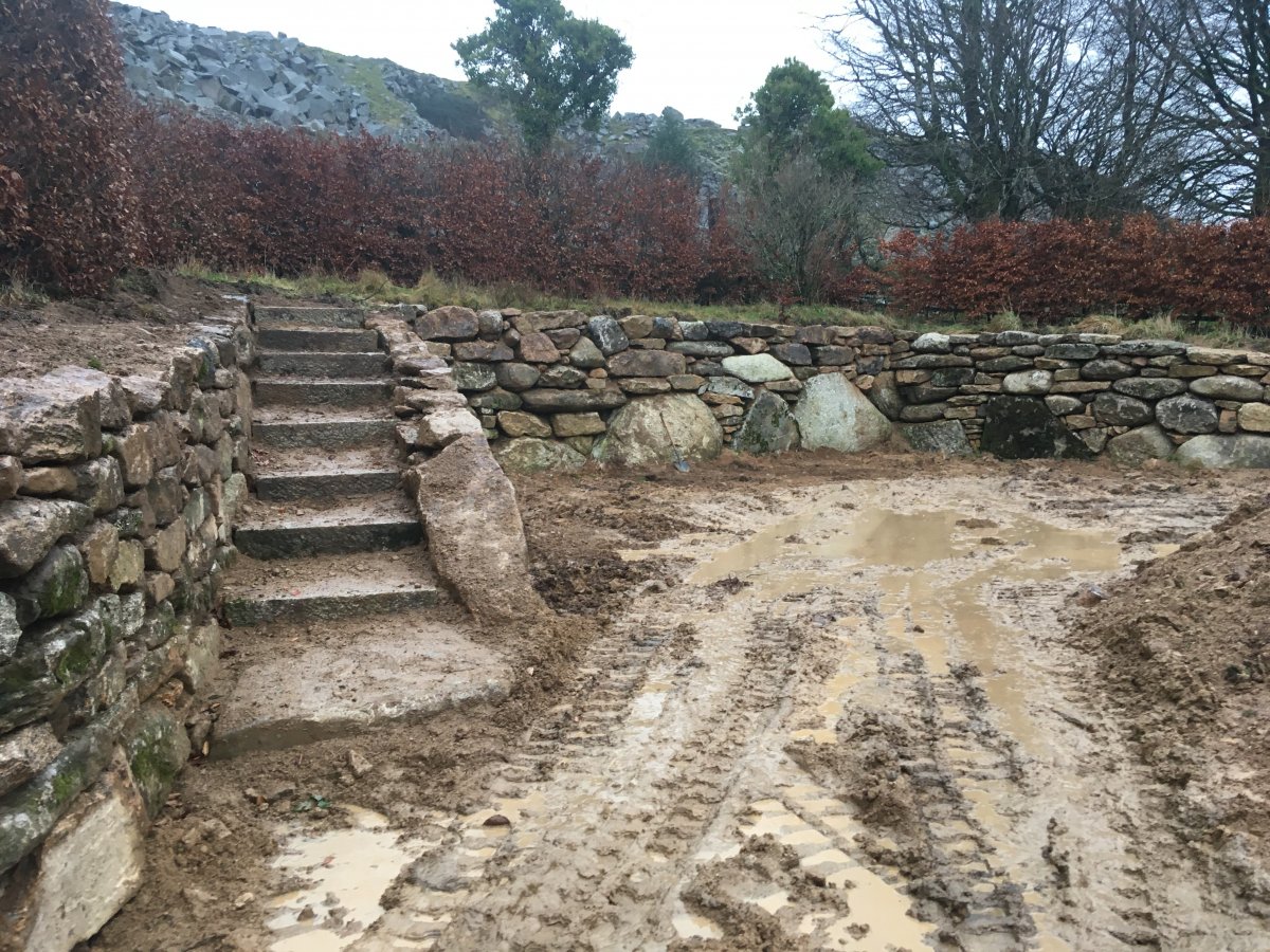

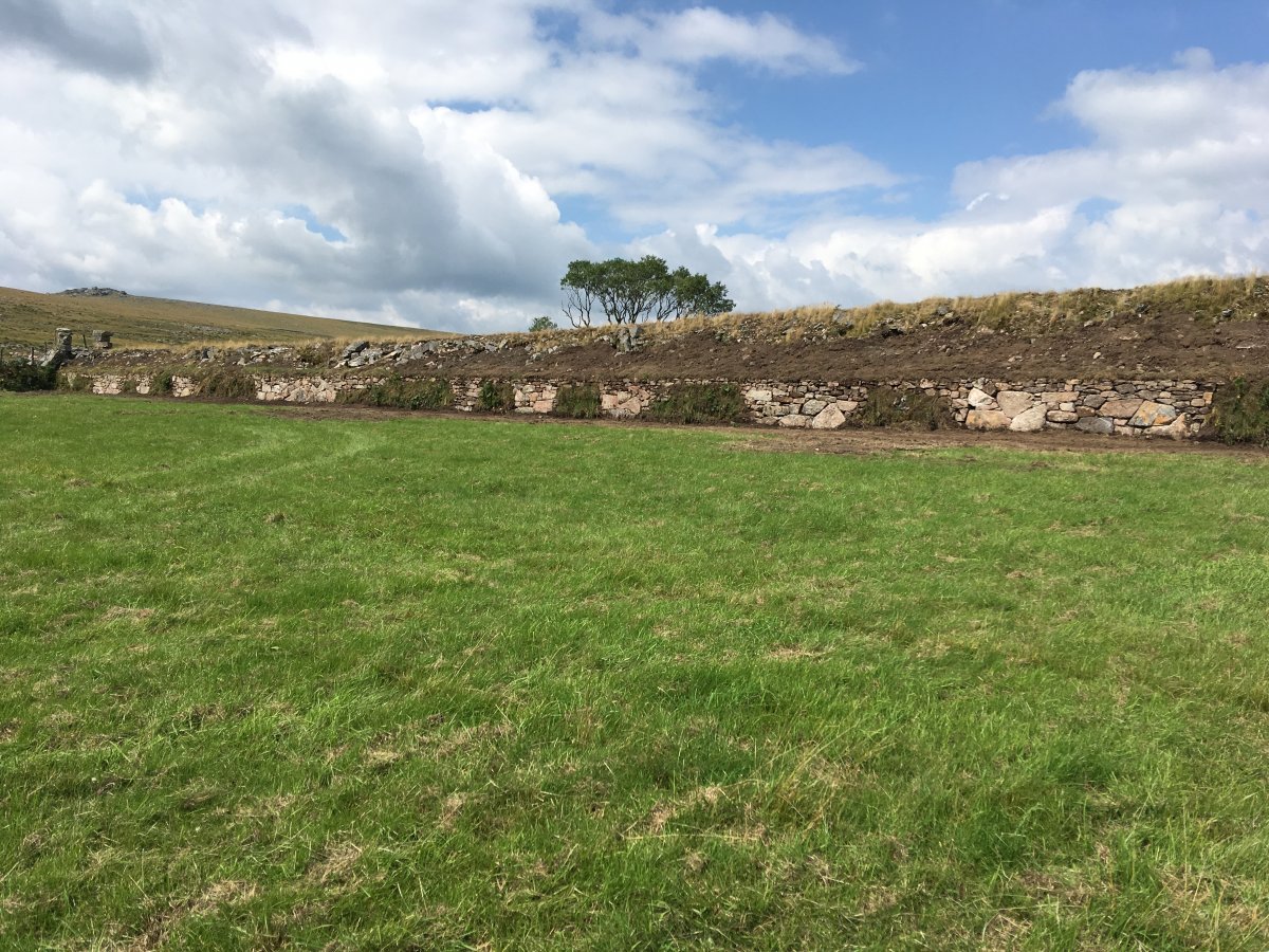

I dunno- I do loads of retaining walls using nothing but dry stone granite- an engineer would probably have a fit- but often they're just replacing what has lasted 100 years or so. With dry stone you just need a bit of batter and some nice big lumps- I guess it's the natural alternative to Lego blocks. Haven't had one fail to be fair.
Finished height of this one I did last year was 7ft.
And last one was a restoring sections of retaining dry stone wall
I once had a complete stranger who'd spotted my working clothes in the chip shop queue start ranting about structural engineers. Turned out he had had a not very constructive conversation about the unsuitability of using wooden pegs to hold a green oak frame together, he wanted stainless steel :cry:
Your walling does like properly good and in keeping (y)
yeh real quality job :cool:

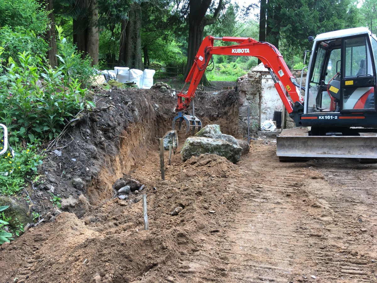

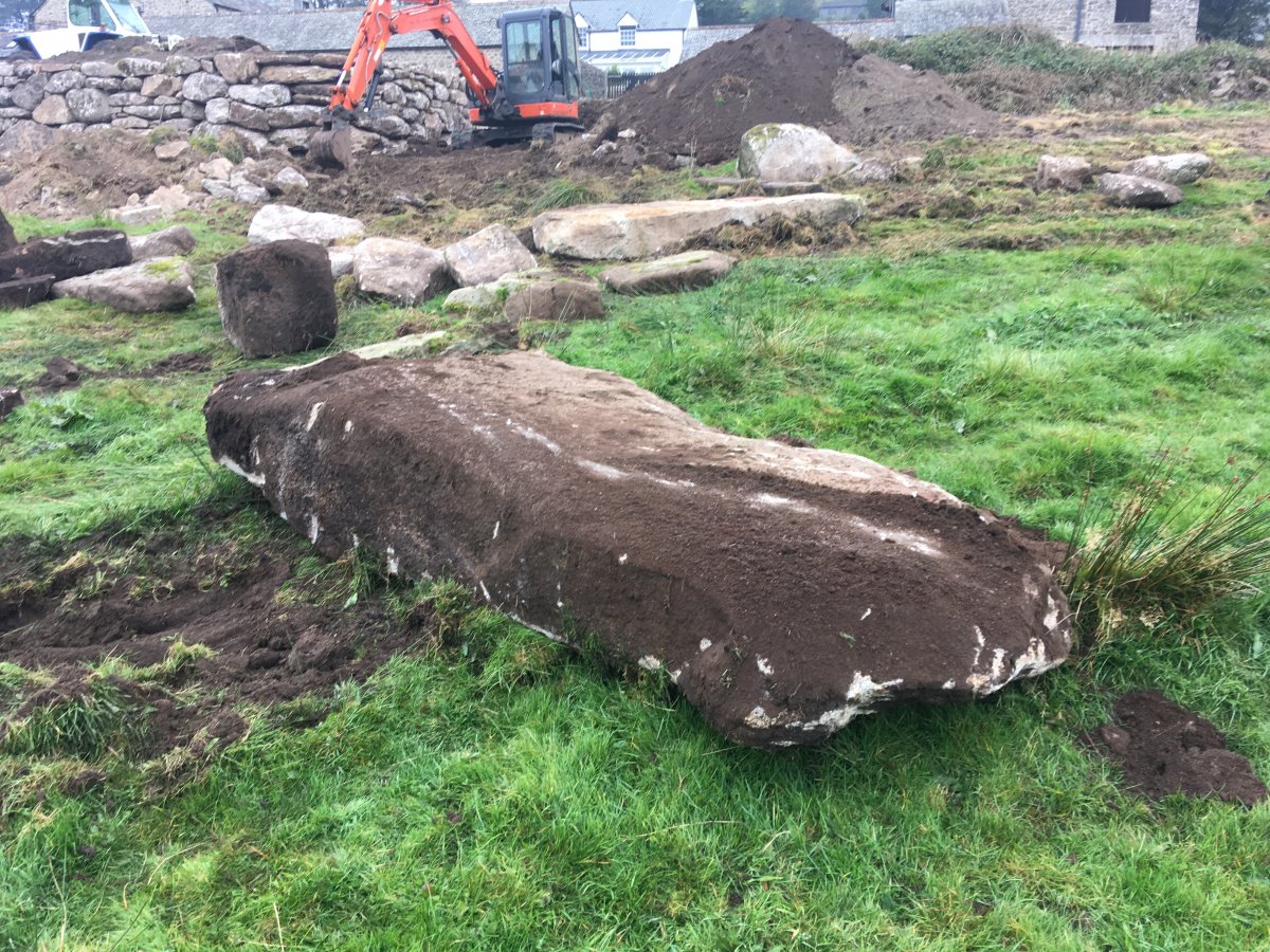

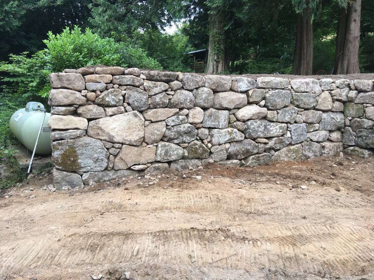

Thanks- I wouldn't go that far! But generally where I live there's granite everywhere so it's what's always been used to do such tasks. Another one I did- it's pretty rustic to be fair but cleared a pile of granite and made use out of it in the process- the shovel leaning against the rock at the back gives an idea of size of some of these rocks- so pretty confidence it will be there for a year or two.. another one in progress- but forgot to take final pic.

Those are some lovely natural walls, excellent work.
And whilst no engineer was involved, they aren't holding up a track or building, so the risk is less, and you are following good practice with the batter, larger stone at bottom, its free draining etc The principles are all there (y)
