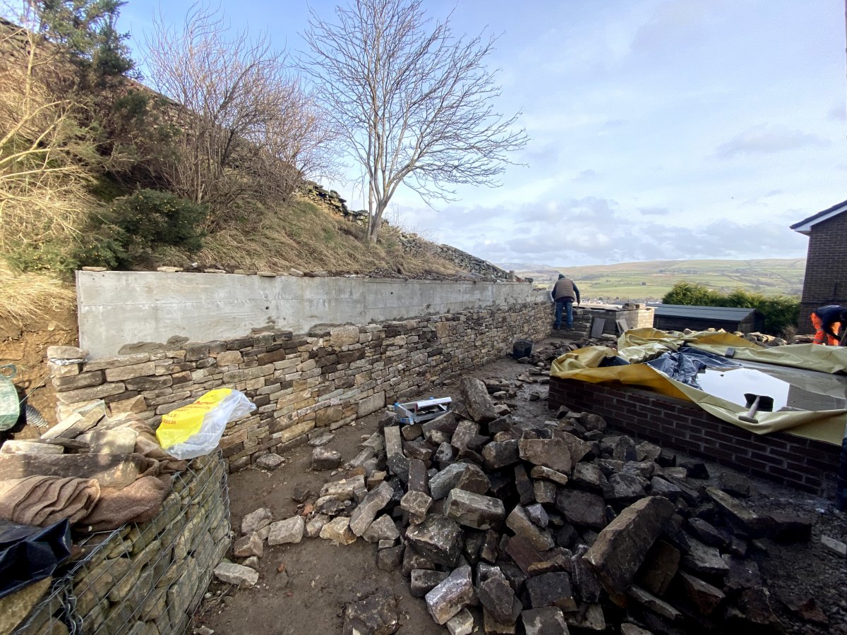

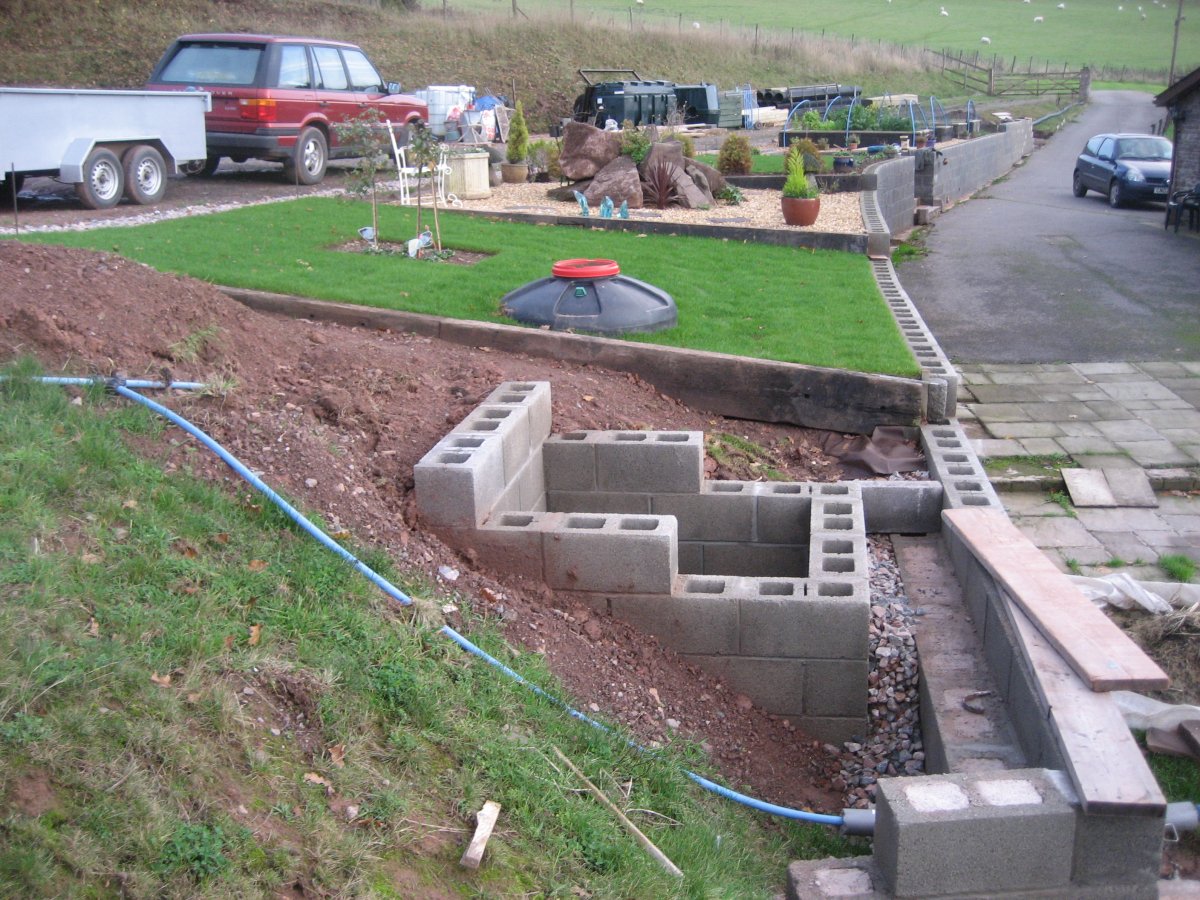

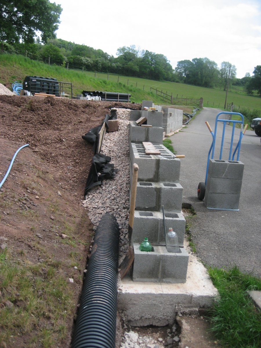

as said ..... plenty of drainage at base behind any retainer .... wall beside my drive fell over, 'fore my ownership .. virtually zero drainage ... when i replaced the wall there was plenty of drainage and clean 40 went in behind it
View attachment 30154 View attachment 30157 View attachment 30156 View attachment 30155

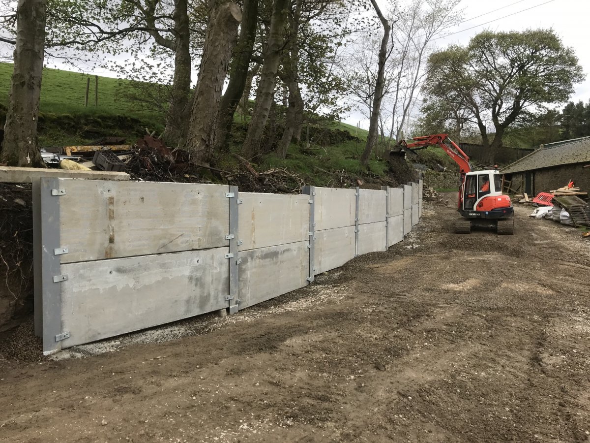

That’s my go to. Perforated pipe at the bottom and 4m clean right to the top. I’ve seen a lot of walls use that method but forget to connect the drain into anything and create an underground swimming pool behind the wall 😡

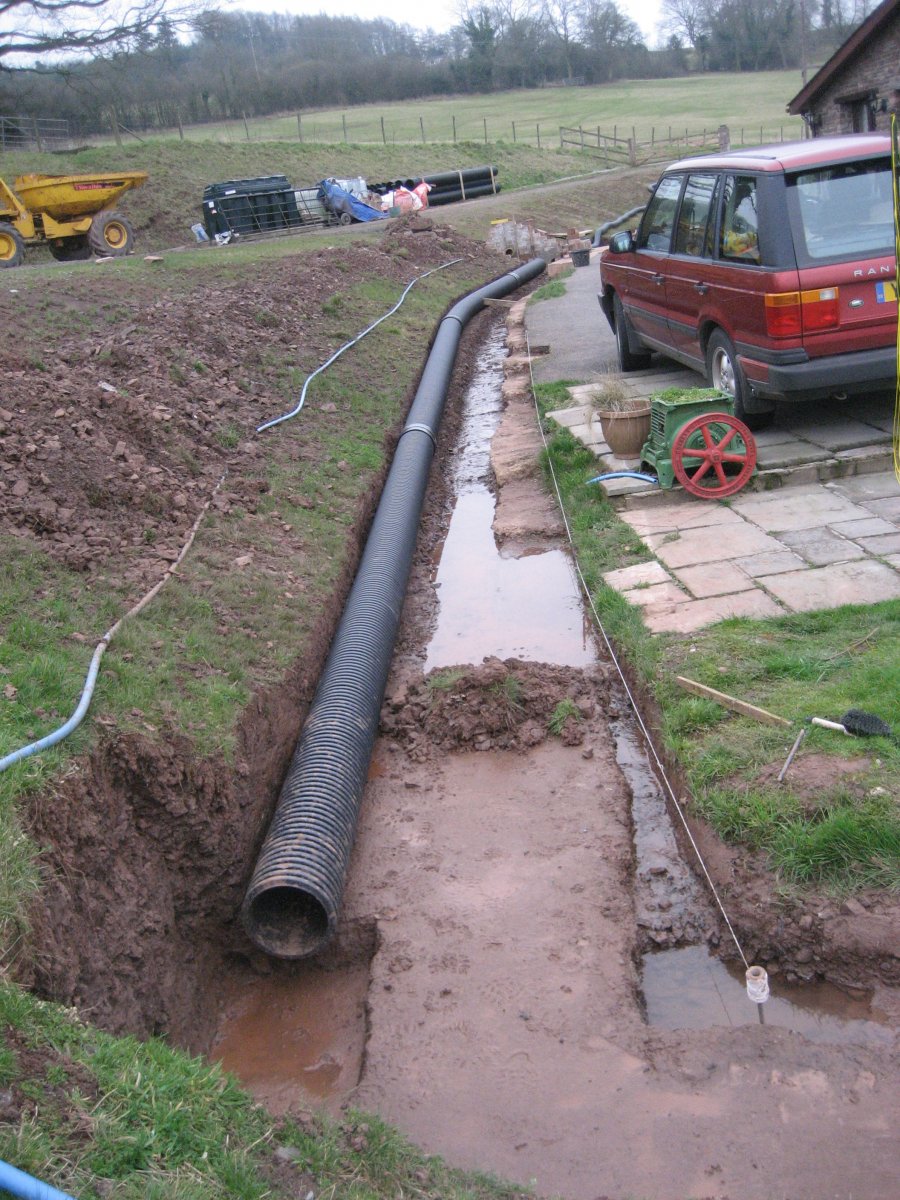

Oh that's connected all over the place Jimbo .... couple of collection/attenuation sumps and out into the field drains below ...... takes some sort of water when it pees down here

If you stick with the remit the base is a third of the height you won’t go far wrong . Put drainage behind it all the way to the surface and weep holes in it for the water to escape to eliminate hydraulic pressure . Corners will make it even stronger

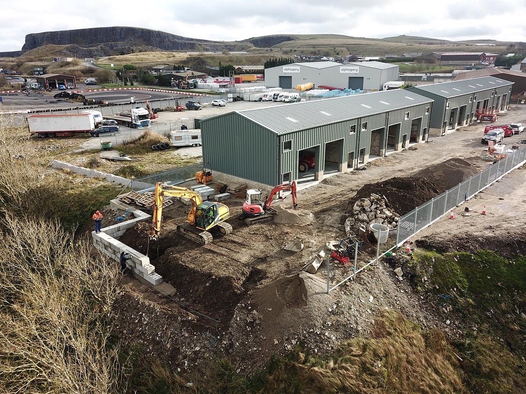

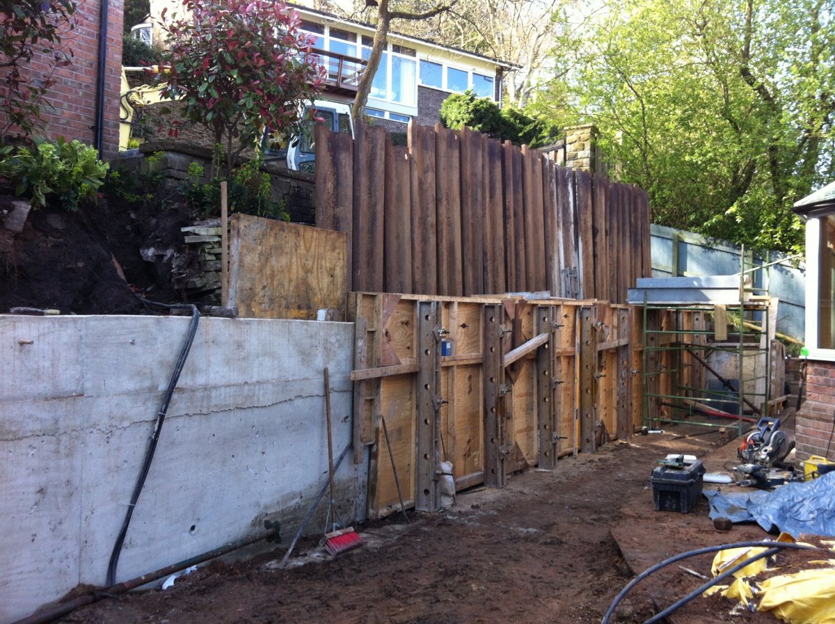

You can go 4 times the width of the wall high without engineers drawing involvement as well (have had bc ok this) but the key with any retaining wall is the bond between the wall and the footing. Dense blocks laid flat make a surprisingly strong wall (stronger than a poorly built hollow block wall imho) but the join to the footing is the weak point.
I’m like @Gunners done nearly every style of retaining wall and fixed a few failing ones, 1 rule is engineer designs it or we suggest to the engineer how we want to to do it and he does the math.
some good hand lay systems like the cribbing and the American style interlocking concrete blocks ones

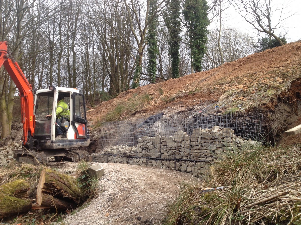

we do a lot of cast in situ concrete walls then clad in stone they work well but need experience in steel fixing shuttering erc, everyone thinks Gabion are cheap and quick but in order to get them looking great you need to spend the time hand stacking and straightening then you have sharp wires that catch on everything.
weve done a few now with precast concrete panels placed into rsjs then clad in stone
lego blocks are good but heavy 5.5 will lift close in but really need 8 or 13 ton, they don’t look the best when done but are super quick, £60 a block from my supplier.
done some of the 4“ round posts as well driven in next to each other or sleepers on end or fixed to concrete post behind etc
as has been said relieving water pressure with drains and weep holes is critical

That footing isn’t wide enough for a retaining wall the rule is 2/3 the height width of the footing for overturning too many builders and Brickies do them like strip footings for normal walls

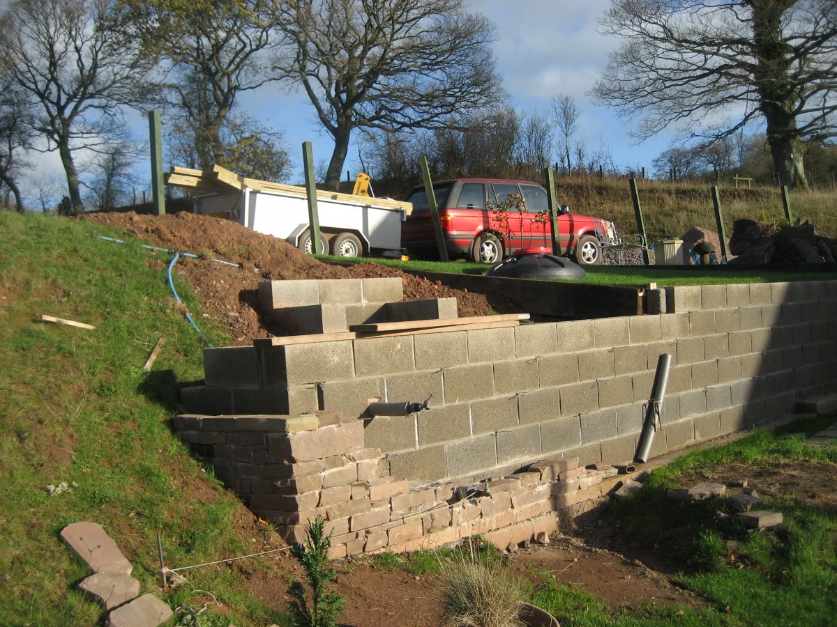

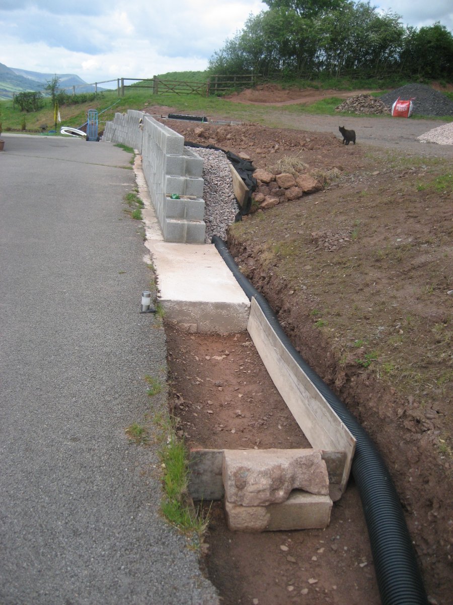

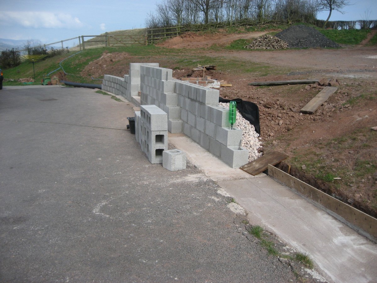

was working on a third plus Giles .. plenty of drainage and a lot of what is behind it is virgin undisturbed ground, plus the tallest part is a curved wall (in the right direction) ... none of it is taller than three times the footing width.
Going 2/3rds'd 've meant disturbing a large volume of virgin ground and banging in a hell of a lot more loose backfill
Was replying to graham vince why it fell over originally
it fell over originally Giles, 'cos it was single 6" block on a foot wide strip, 6" deep, with zero drainage at bottom and no porous (clean stone) backfill or weeps .... just filled up with water and got pushed over, the year before I bought it ... I found 99% of it buried in where I was digging out me patch .... and crushed most of the blocks for hardcore/blinding, once down to level :giggle:
my founds were 33-36" wide and 12-16" deep .... both skins of 9" hollows are filled to the top with concrete and a lot of 20mm pins tying to founds too
