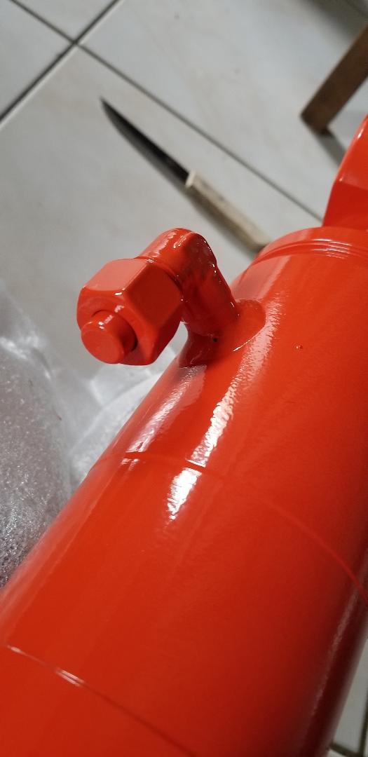

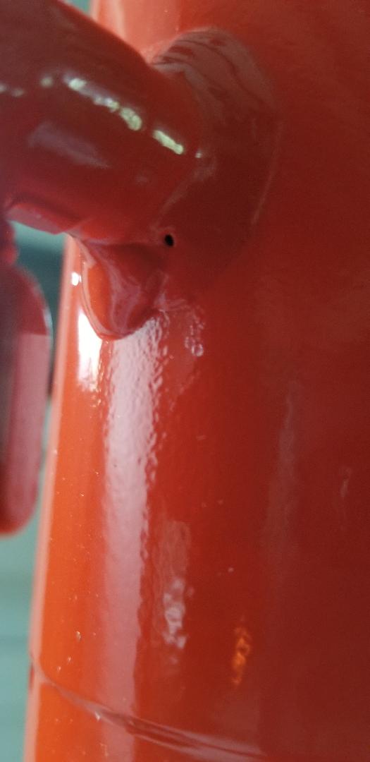

Could really do with it that's the thing 😡 I have emailed those photos to the supplier and see what they say 🤔...at least they are aware then if it doesnt last I have a record.

Sorry. I laughed when i saw the picture. You couldn't make it up.
Use it for you urgent work (if it doesn't fail)
Get druid to mend the old one and send the new one back.👍
FFS your right you couldnt make it up .... and bucket ram went on 1.5t today :rolleyes: Daredent go back to collect 8t from last weeks job.... prob been nicked :LOL:
TBF prob didnt go far in - a pin in the hole only went in 2 or 3mm so was prob fine but shouldnt be like it and didnt want any hassle later down the road so thought it best go back. Dealer was very good about it and are sending out another tomorrow but before it leaves they will make sure it is checked, dealer spot on but suprising lack of quality control from Kubota.
you may have only been able to push a pin in a few mil Kev, but nothing to say a few hundred bar would not force out what ever your pin was up against ...... it wasn't right .. end of ... done the best thing, slinging it back at 'em
And fair play that they are changing without a fuss!! Saves having to throw it through the window of reception!!! Perhaps this forum is being watched!!🤣🤣🤣🤣
it's probably fast gaining a reputation as the place not to be discussed on :ROFLMAO: :ROFLMAO: if you care for your reputation (y):cool: .... anything that gives the small O/op some teeth has got to be a good thing
It was PVDobsons and Steve in parts ...... bought a few machines from them over the years always been good to deal with;
