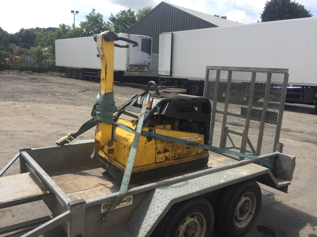

Mines heavy as sin I don’t think my 3 ton would move it around I tend not to use it for that reason I’ve a pic somewhere of it on an 8 x 5 plant trailer they’re big lumps

Yeah that's the downside I think is it's not going to fit on a trailer with the digger due to weight. I'm tending to think go for a circa 200kg reversible plate that's convenient and just have to hire in the rollers for the bigger areas.

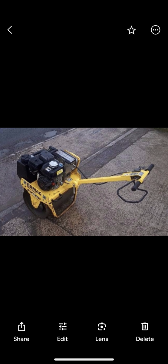

I miss my little bomag pedestrian roller tbh. Not many seem to like them on here but they were handy being able to cover ground quite quickly compared to a plate and still fit it on a trailer with the 1.8t digger etc
that's a beast :oops:
I like my little 400kg ped roller ... been a good little tool aside from the rubber cotton reels on the drive flange - an OE set cured those issues though and always park it on two blocks to take the weight off the drum drive, when not in use
