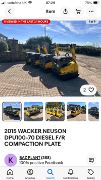

Distinct lack of decent used Wackers about. There's a 500kg WN 6555 up in London for £4kish but that about it

Thanks Giles. I think if it's a small one I'd just buy new. But was trying to see if there are any used big bastards around like you and stroppy have. Got a few car park repairs coming up and they'd be just the job.
You can hire mine to see how you like it…. They pop up on eBay occasionally. Usually in 2s and 3s as they get linked up in teams and run on remote control for railway bedding
