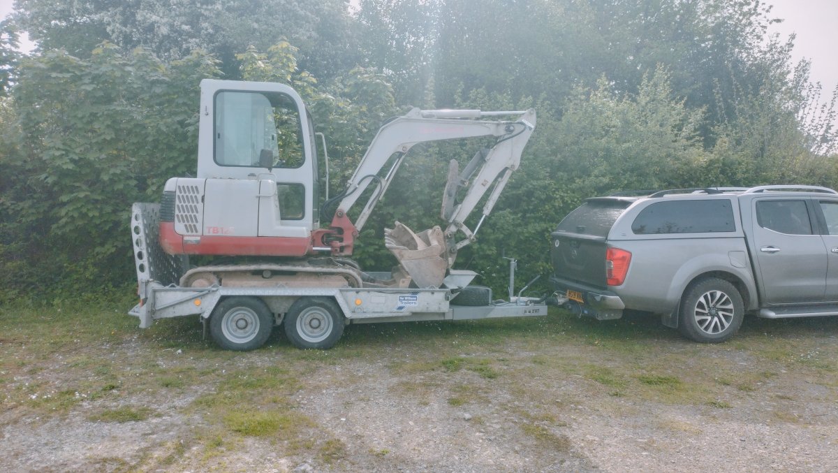

Anyone else ever use the bucket rest, I rarely do to get as much weight back on the trailer as poss Even with the digger right back against the tail gate there is still more nose weight than id like- these ifor 1054s have their axles a bit further back then a bateson plant trailer and it is a bit of problem sometimes..

Get a smaller digger.
The wheels are a long way back aren’t they. Part of why they tow nice. Not much difference between the LM166 and the GD1054 from hitch to front axle
Do use it with the 216 tows beautiful
I load with the blade behind (as close to the tailgate as possible) and always use the bucket rest - it’s pretty heavy on the hitch but tows great tbh. That’s with my tb230, and did the same with the E27.
Surprised at that because when Ive tried it with the blade behind it feel even worse because the whole machine then has to shunt forwards so the tailgate can shut with the blade🤔
