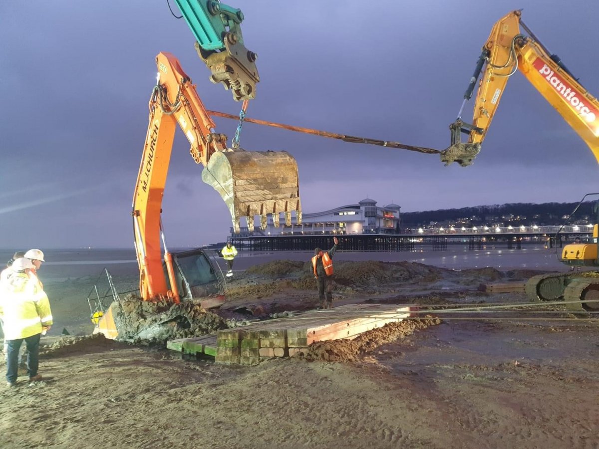

In the recovery pics there is also a big yellow wrecker in attendance that doesn’t appear to be used - I bet you that was only there as a fall-back if the main recovery truck got bogged.

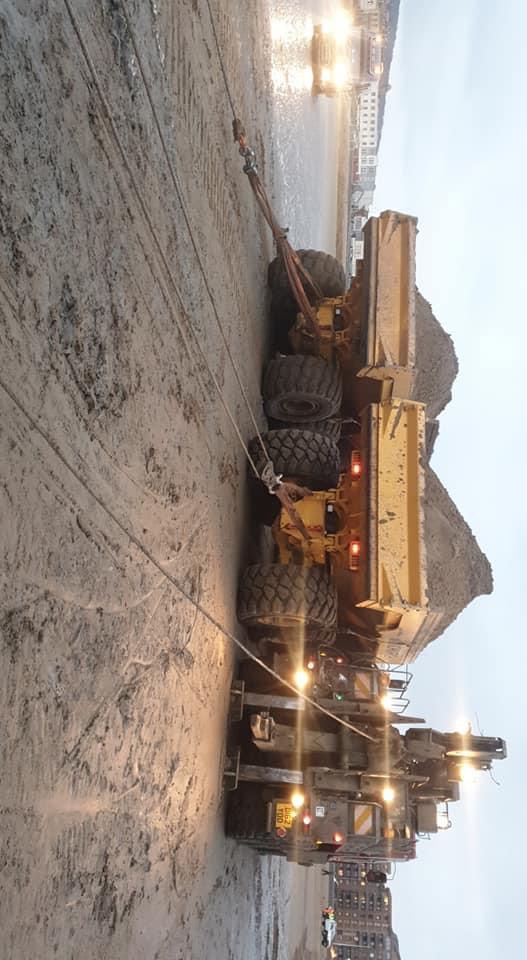

They did have a big winch truck there and it did the work as I seen in other pictures somewhere, it had its line doubled up a few times and anchored to a couple of Volvo dump trucks.
I think the machine where just there to steady it up and stop it going over

Absolutely they did drag it out with a big winch.

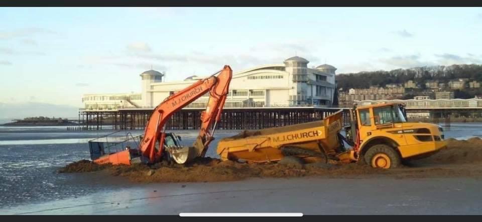

The day before they’d been trying to drag it out with a couple of ADT’s and another digger and failed (hence the tide coming in over it),which shows how much suction was holding it in!

A combination of everything I’d say. Dig around it where possible to reduce the ‘ground anchor’ effect and potentially open up a ramp to climb out of the hole. I think in the beach recovery they also used a couple of diggers to pull either way on the stuck machine’s boom to wobble it in the hole to try and break the suction as they winched it.
If possible, winch/pull up as well as out - run the tow cable over bogmats or similar to gain lift.
A properly anchored winch will provide incredible amounts of pull - not necessarily more than big machines can achieve but the issue is delivering that pull into the tow rope. If you are pulling on sand most machines will spin their tyres/tracks fairly easily.
The pics and vids from the previous day’s failed recovery attempts showed the ADTs spinning up whilst attempting recovery. They had no load in them though, which I reckon was a mistake as they would have benefitted from better traction if full/heavy IMO and may possibly have saved the digger from the tide (though that is obviously huge conjecture). Interestingly the successful recovery firm used the dump trucks as ground anchors but filled them up first.
