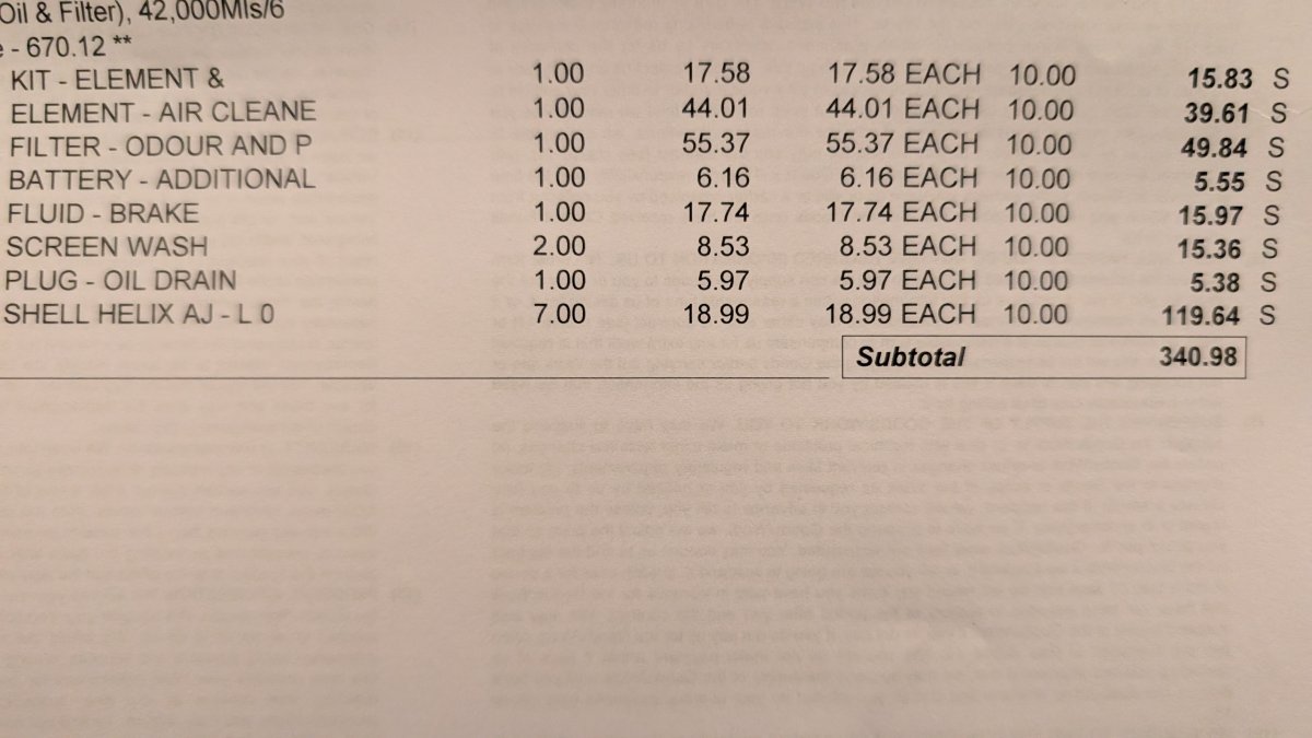

Hilux engine oil and filter change and a replacement cabin filter is £380……..
