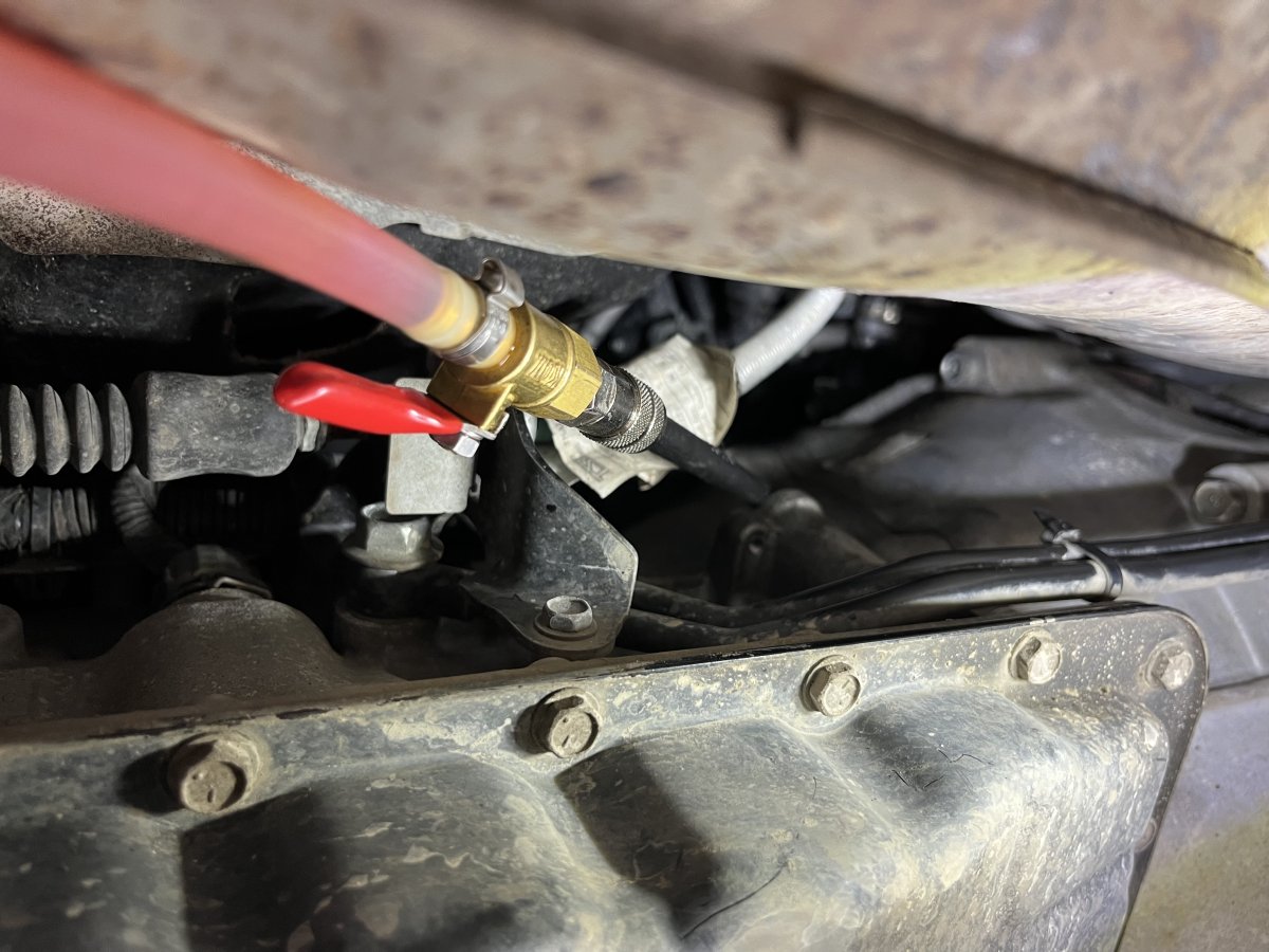

Interesting way to get it refilled. Exactly what I did with our C320 Mercedes. Good job that I have an inspection pit :giggle:

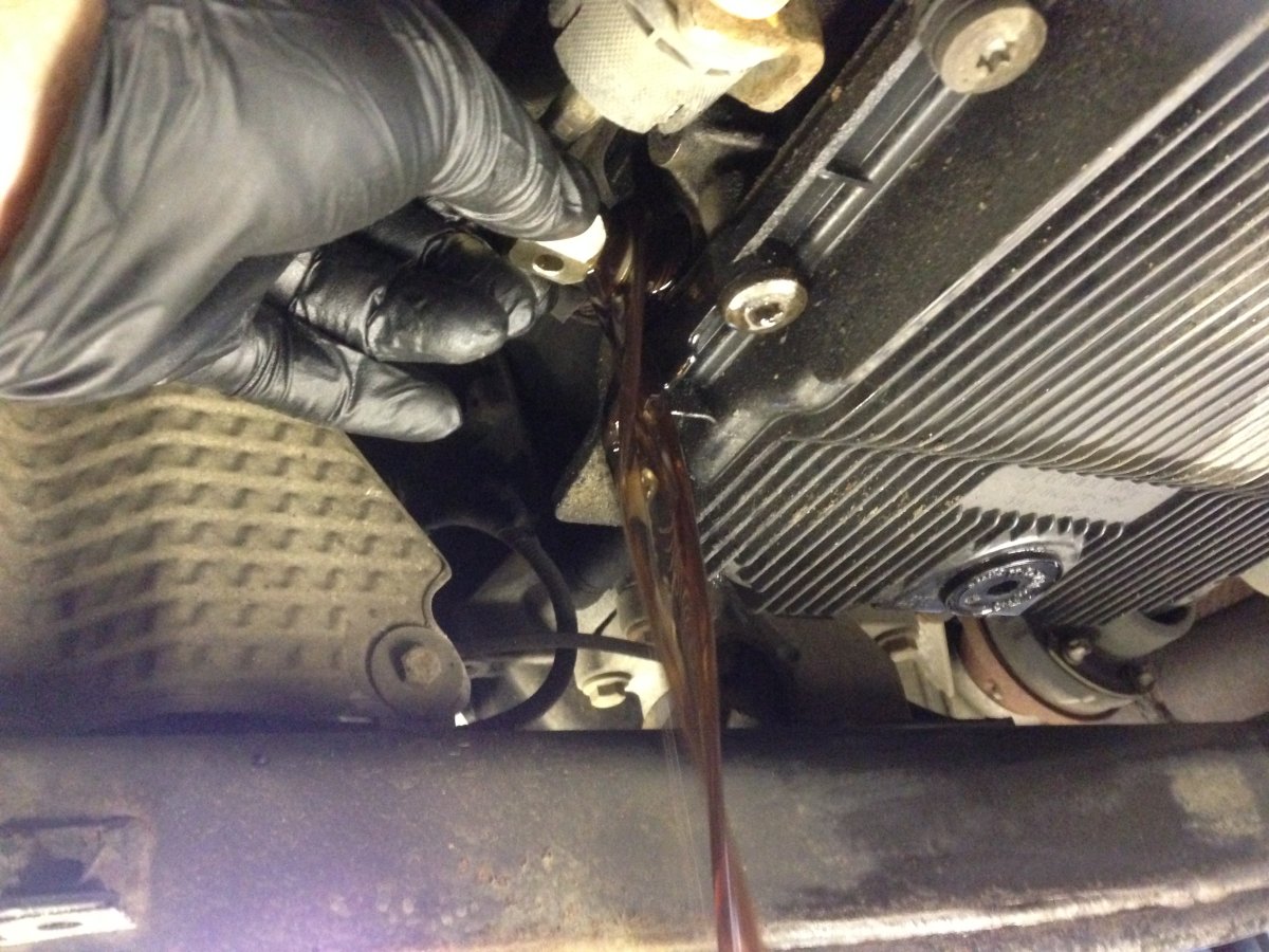

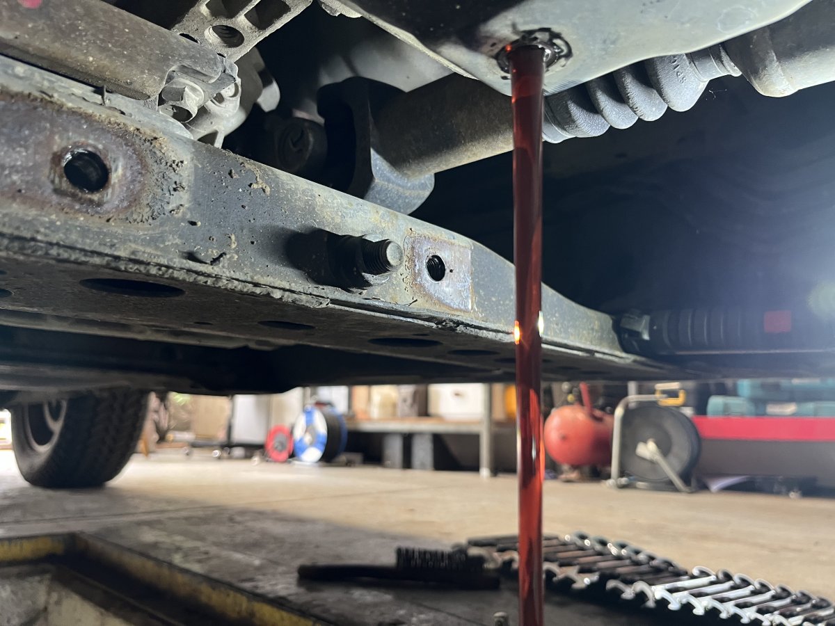

How do I know this - 'cos I had a very nice Disco 3 HSE auto and did all the prevention stuff to prevent it from occurring :cool:View attachment 81685

that oil looks pristine, compared to what came out of Simon's - apparently .. black and smelly ..... and he's a pretty 'sympathetic' driver - not a lead welly merchant - has had the Nissan many years

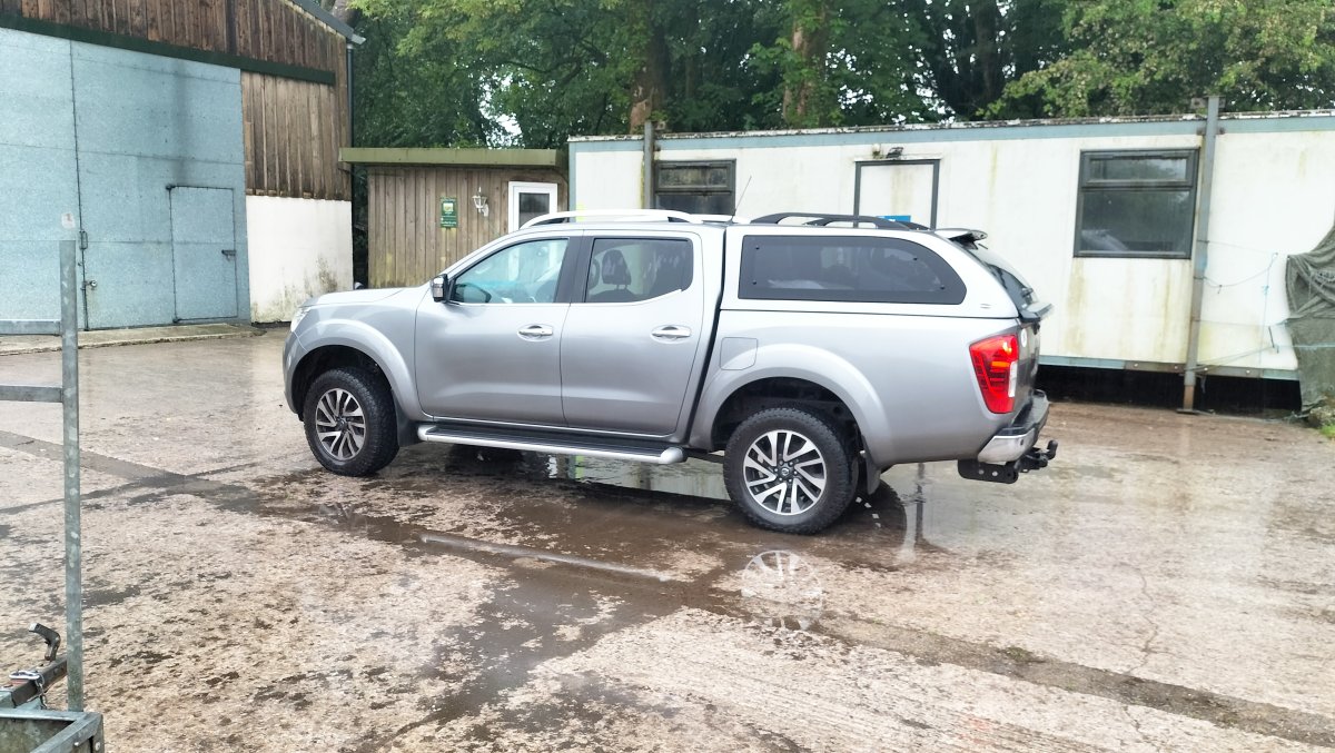

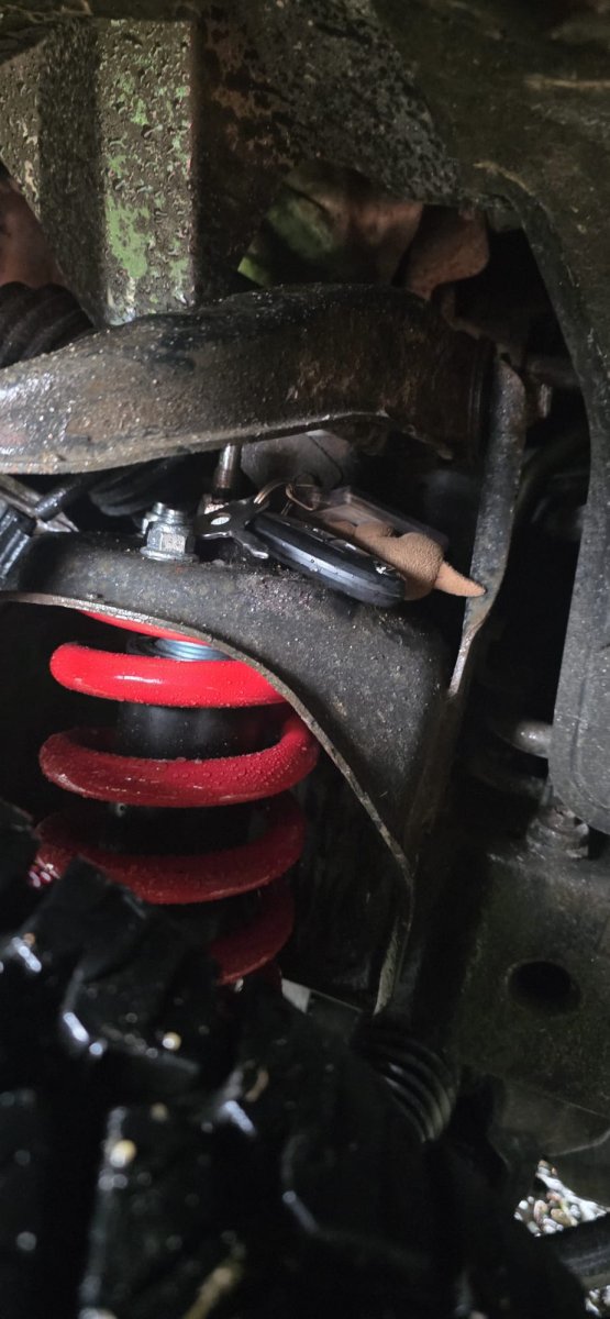

Well changed the shocks and springs all round on the Navara. Went for Pedders heavy duty kit which has lifted the rear by 5 centimetres over the original (which was sat on its arse). Got all my tools and fuel tank etc in the back in this photo and it's barely dropped at all. Doesn't seem any harsher ride either which is good
Excellent job - now I've got suspension envy :ROFLMAO:

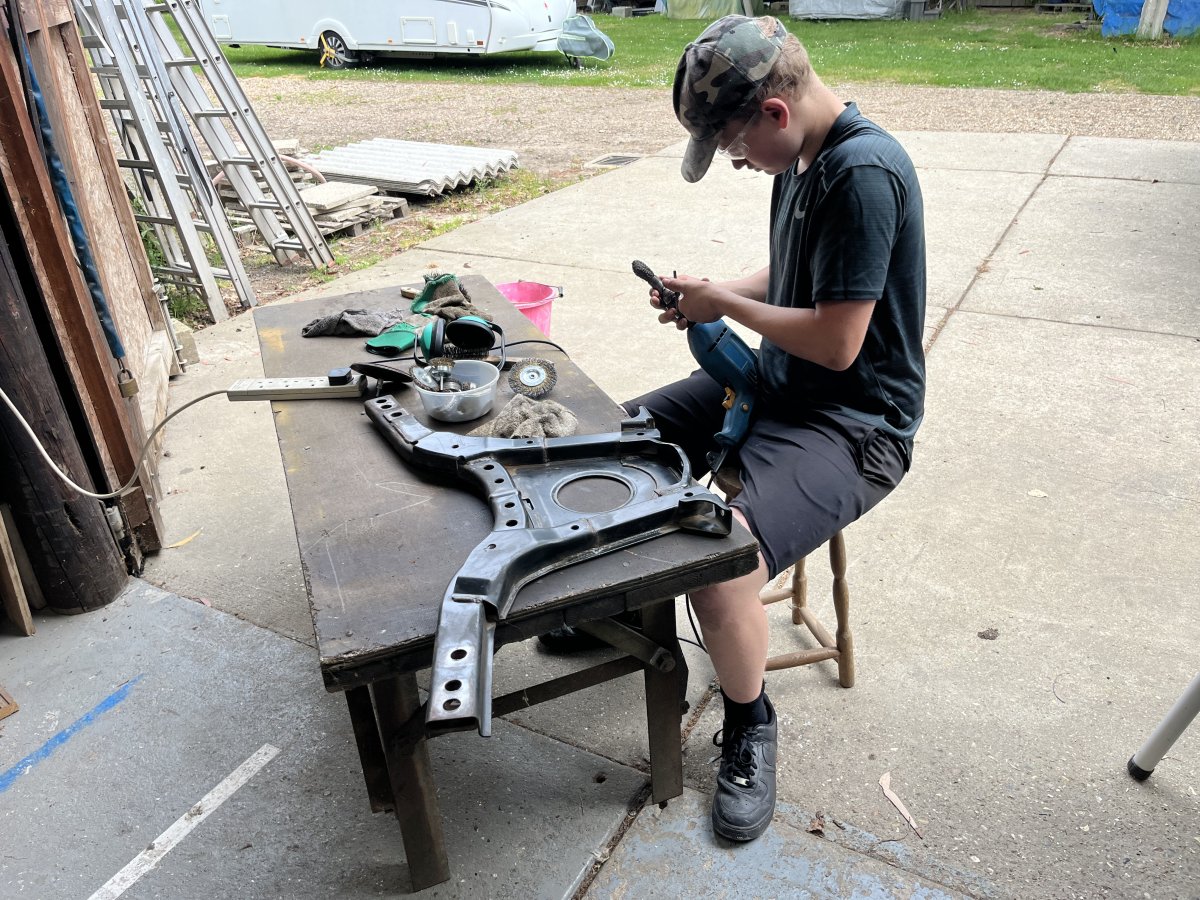

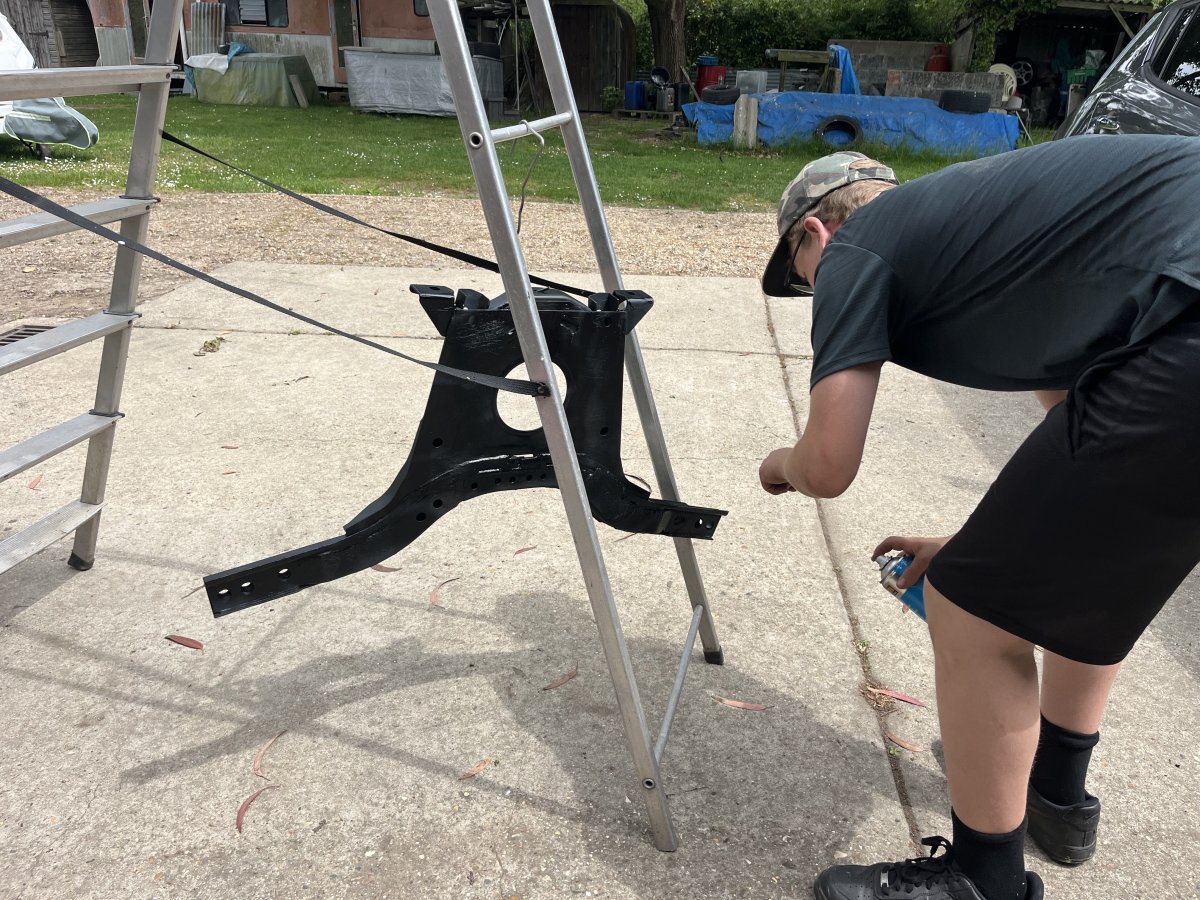

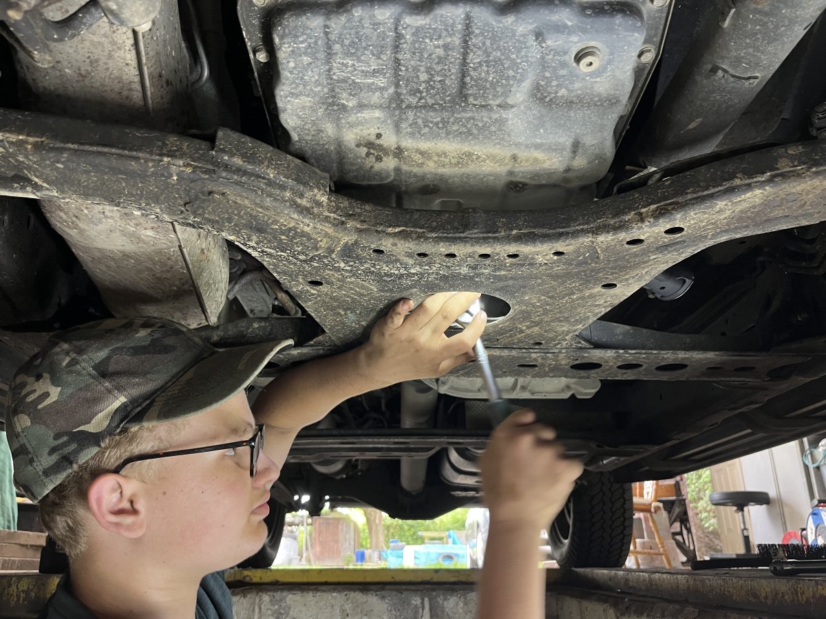

So last week, during half term school holidays, got Jack to help me do the auto gearbox oil change
But first we had to take off the H shaped cross member. Bolts were effing tight
Then we got access to the drain plug. Not too bad for 43k.

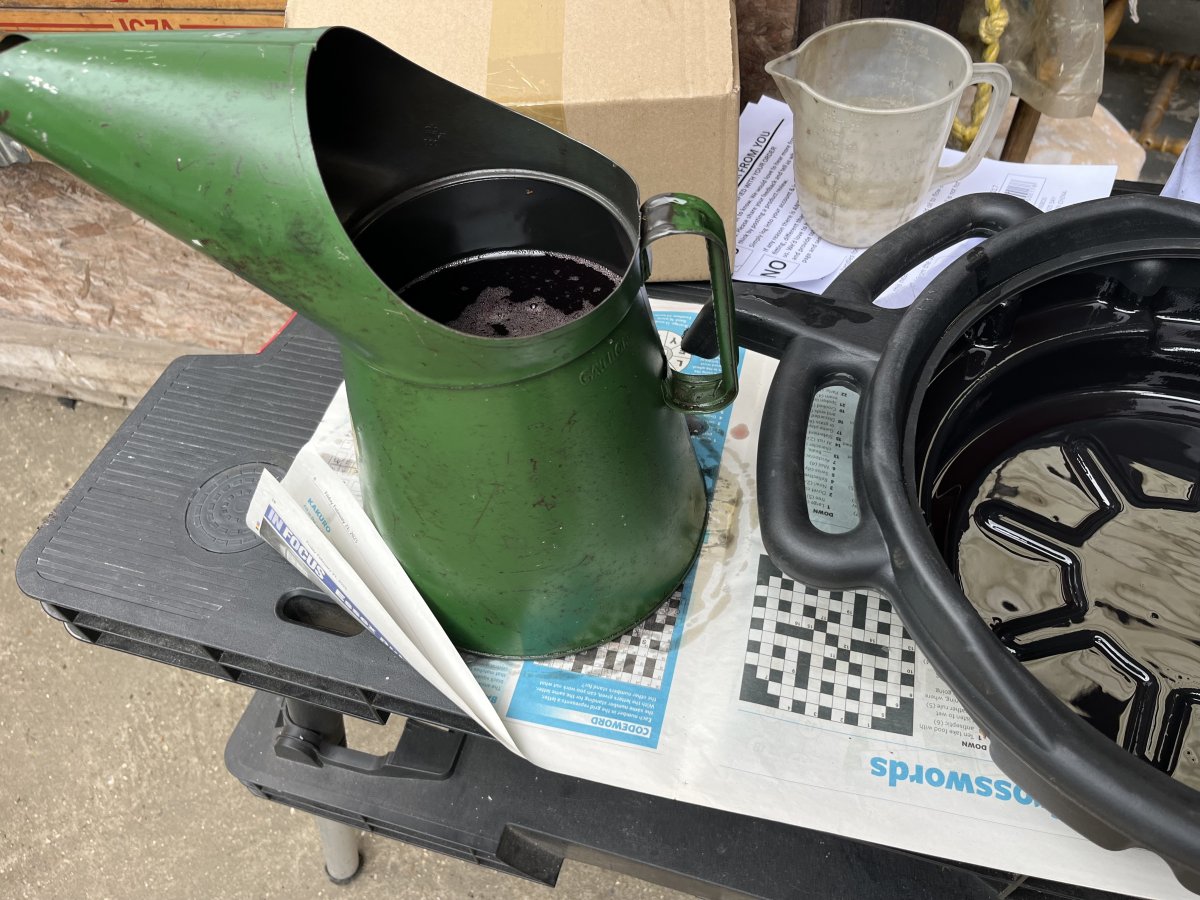

About 4 x litres came out
So used the 'secret' filler on the side to squirt in about 5.5 litres
Meanwhile Jack did some cleaning and fettling.
He loves a rattle can :ROFLMAO:
And finally ran the engine and got the gearbox up to 40c to then remove the level plug and drained about a litre back out.
This meant that in just over 7 years it was down by only half a litre.
Another job jobbed :cool:
Peddars is good tackle 👌🏻
Looks loads better than usual speed boating navvarra or the pseudo Merc version 🤣
The real test will be when I have the digger on the back too but I'm feeling hopeful!
