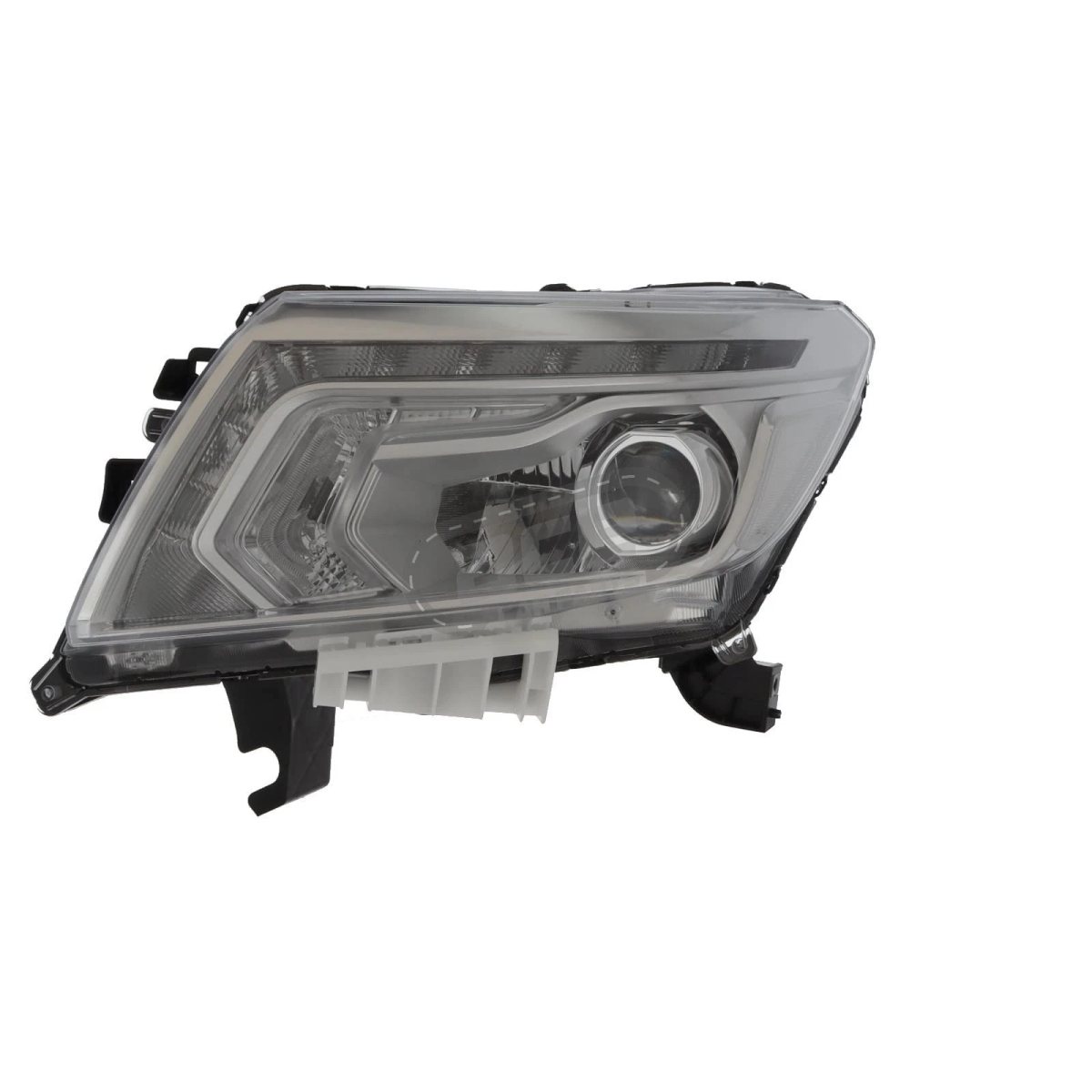

Not sure where to post this, so stuck under Navara 4wd thread.
My Navara is up for MOT on Friday and this afternoon discovered that the LED running light on the nearside headlight is off.
The same LED is the sidelight and it functions fine on the sidelights, so the LED's are good.
Its a 2019 Navara, same model as @Routy56 and is the sealed Zenon light unit.
Anything I can glean from internet, its an unservicable item and a replacement headlight is the only option. I'd be really pissed to have to change the light given its obviously an electronics issue and not the LED's themselves, but running short of options with the MOT looming.
A secondhand light will be circa £300, and I'd still have to get one and fit it before Friday.
Anyone heard of this issue, or know of any options for repair?

can bus fault? can it be plugged in and interrogated ... LEDs are obviously not the fault .. supply circuit is, so an alternative may well present the same issue

Not heard of that problem before. And I'd be interested to know the solution.
If it happened on mine I'd start with diagnostics and go from there :geek:

Yeah, I'm of the same mind Graham.
I've a basic Autel OBDB scanner that tells me that the headlights have a CANBUS controller for headlight levelling etc. No faults are presented on the scan, but doubt it's capable of interrogating in sufficent detail.
I'll get it up to autoelectrician early in the week, but looks like I'm forfeiting MOT appointment at this point. Nothing worse than a failure fault showing up to the tester as they drive it into the test hall. They immediately think you've taken no time to prepare the vehicle and then they're a bit more inquisitive.
