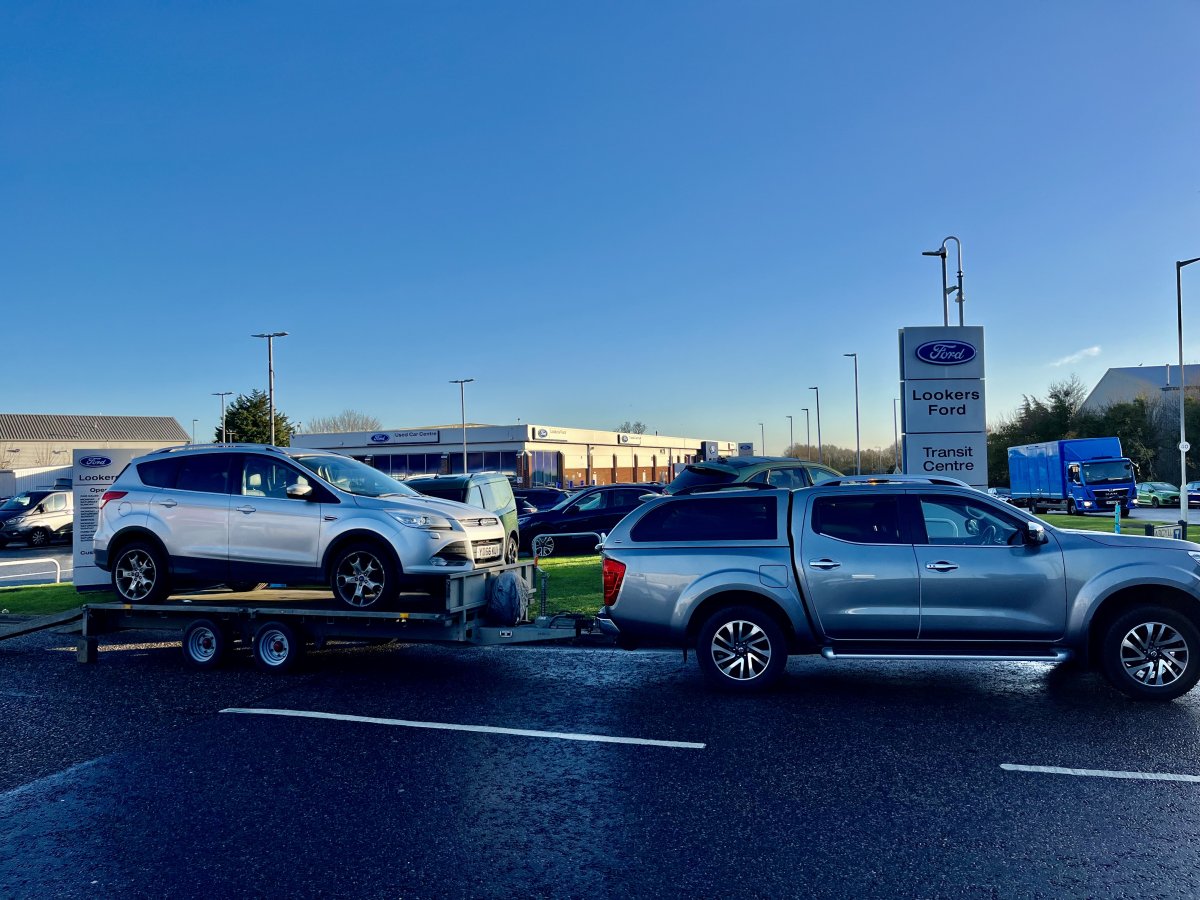

My plumbers Ford pick up, 21 plate with 90k miles. Wet belt decided to part itself. £10k bill for new replacement engine.
Yep those wet belts make the engines a tad vulnerable. My mate son's bought an immaculate Ford Kuga from Carwow a few months ago. Within 2 months the engine went bang. Now involved in a legal wrangle getting it repaired under warranty etc. :mad:
I did my good deed getting it to the Ford stealers and back again .....
Ford changed the wet belt service interval from 10yr/150k to 6yr/100k
There was also a service bulletin but can't find it about how no oil flush or additives should be used unless they ford approved but the document didn't list any of the approved ones
