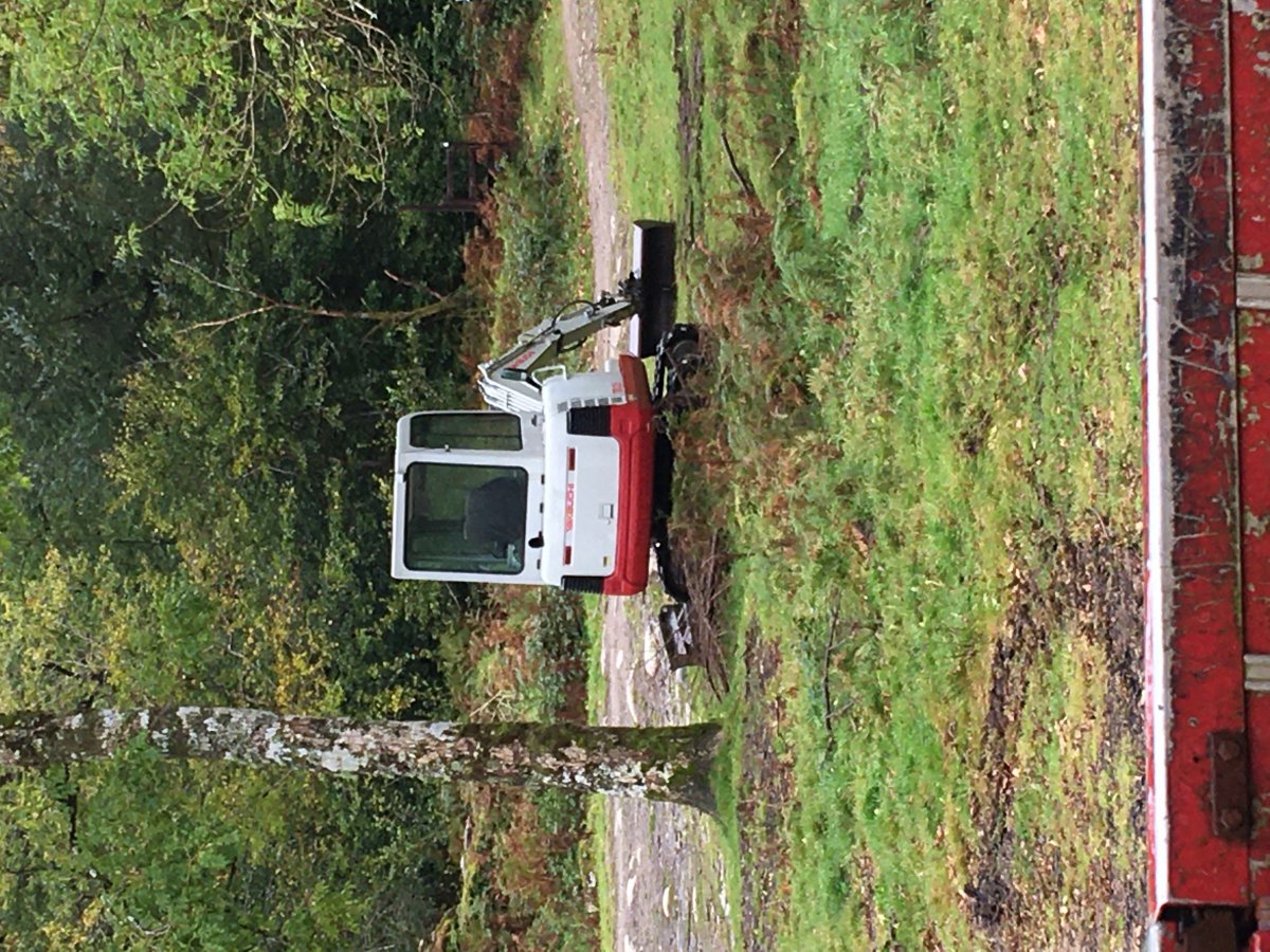

As long as you don’t scratch it 😂 here she is, not bad for a 2007 machine, original paint mostly- just the odd touch up here and there.
