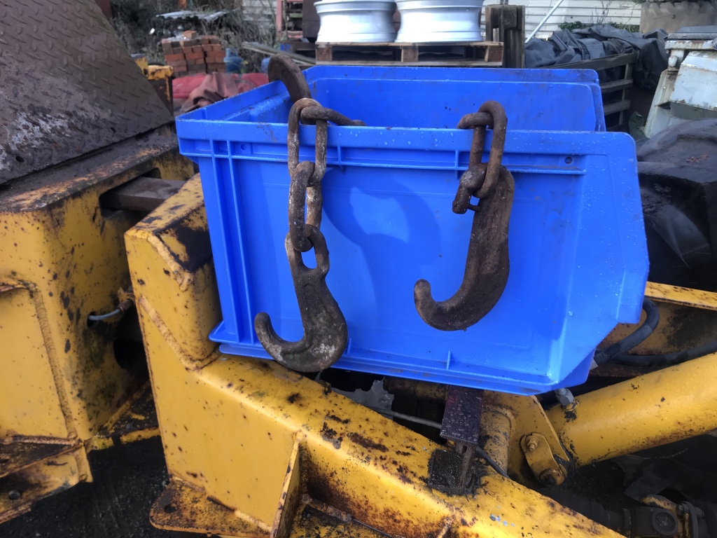

Speaking of chains what are these hooks for? came in the scrap and thought be good to pull a few trees with
those hooks actually fit into the links as opposed to the way in which clutch hooks work IIRC Mog

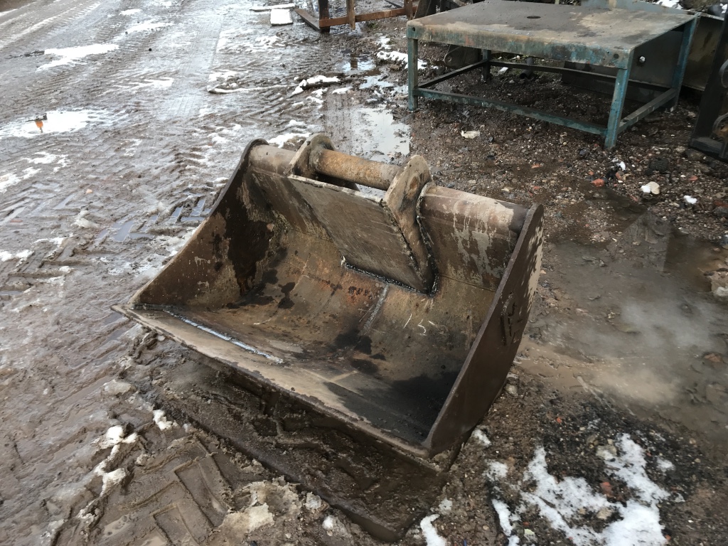

On another note got to dig 30 odd holes for shed bases on a farm 1m square, now i only have 20 tonnes so the buckets are a bit big front to back plus i don't have a 1000mm bucket got 600 then jump to 1200, so thought id convert a old ditching bucket that i pulled from the scrap a few years back it was on 60mm pins and the hangers were too close together to do anything with my machines (have to cut them off and start again anyway) so enter my latest project
wanted to keep the toe plate in one to make it easier to line up plus will be stronger

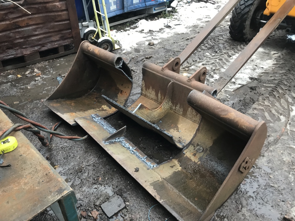

wished id taken more pictures but was in the "zone":unsure: made the pins lower so it curls tighter only problem is the hangers stick out the back a bit:whistle:
but still within 1 meter(y) so after a nights thinking about it, and a day cutting and shunting a bucket that didn't fit anything I own, I have a bucket that will scoop out meter square holes for fun:giggle:
you could be right, going to use them like a chocker as the chain slips through the hooks quite well
see them most often on old 'dog' chains .... I've a few lashing chains with them fitted
shipping company’s use this style of chain for securing loads to the boat for transportation.
Great practical fab job there making something really useful (y)

This bucket would be ideal to dig a hole for a metre cube of baskets:cool:
You may need to wriggle it a bit to give some clearance down the sides....
