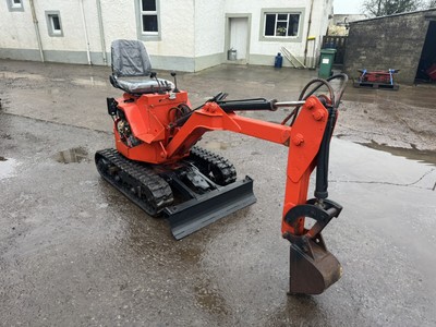

because they are ancient home build kit things. Look elsewhere.

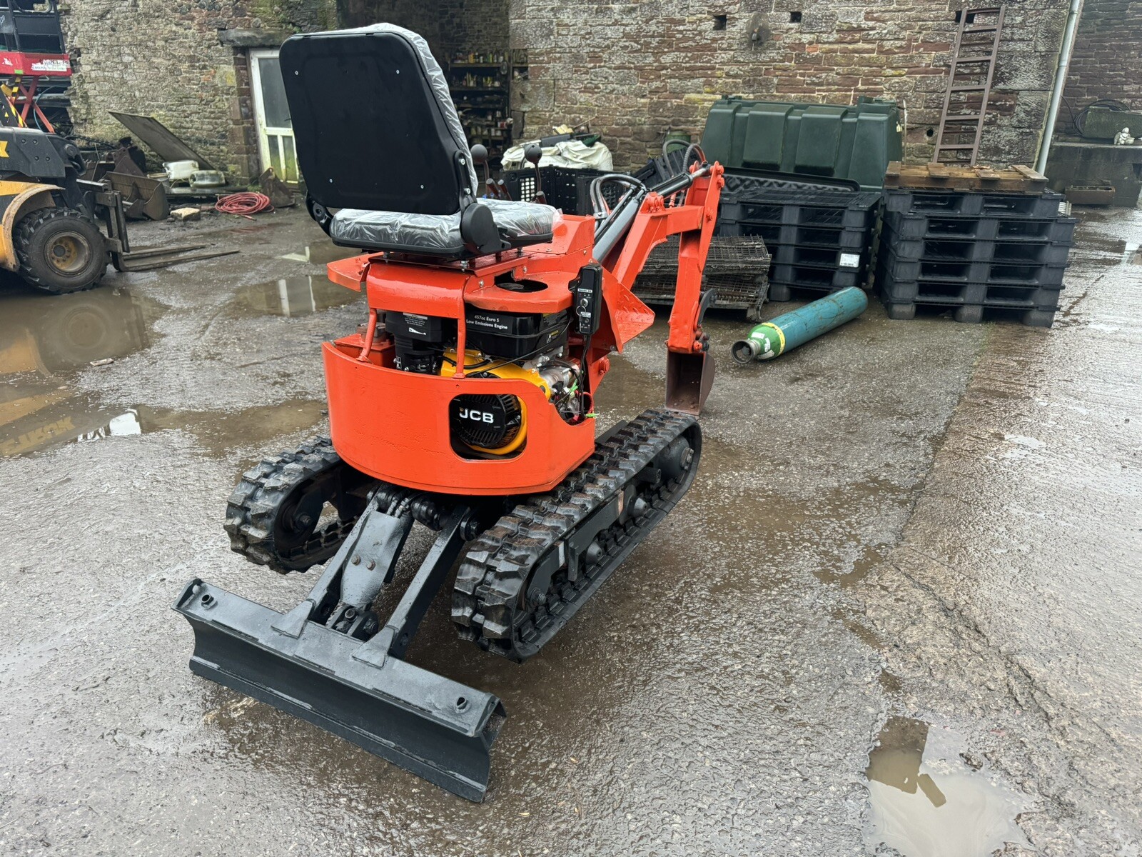

JCB don’t make petrol engines. Will be a rebadged Chinese thing fitted as a replacement.
powerfab were built in Tredegar Doob ... Knew the bloke who's company it was ... deffo wouldn't want one though - as said - ancient
although this must be a very late one

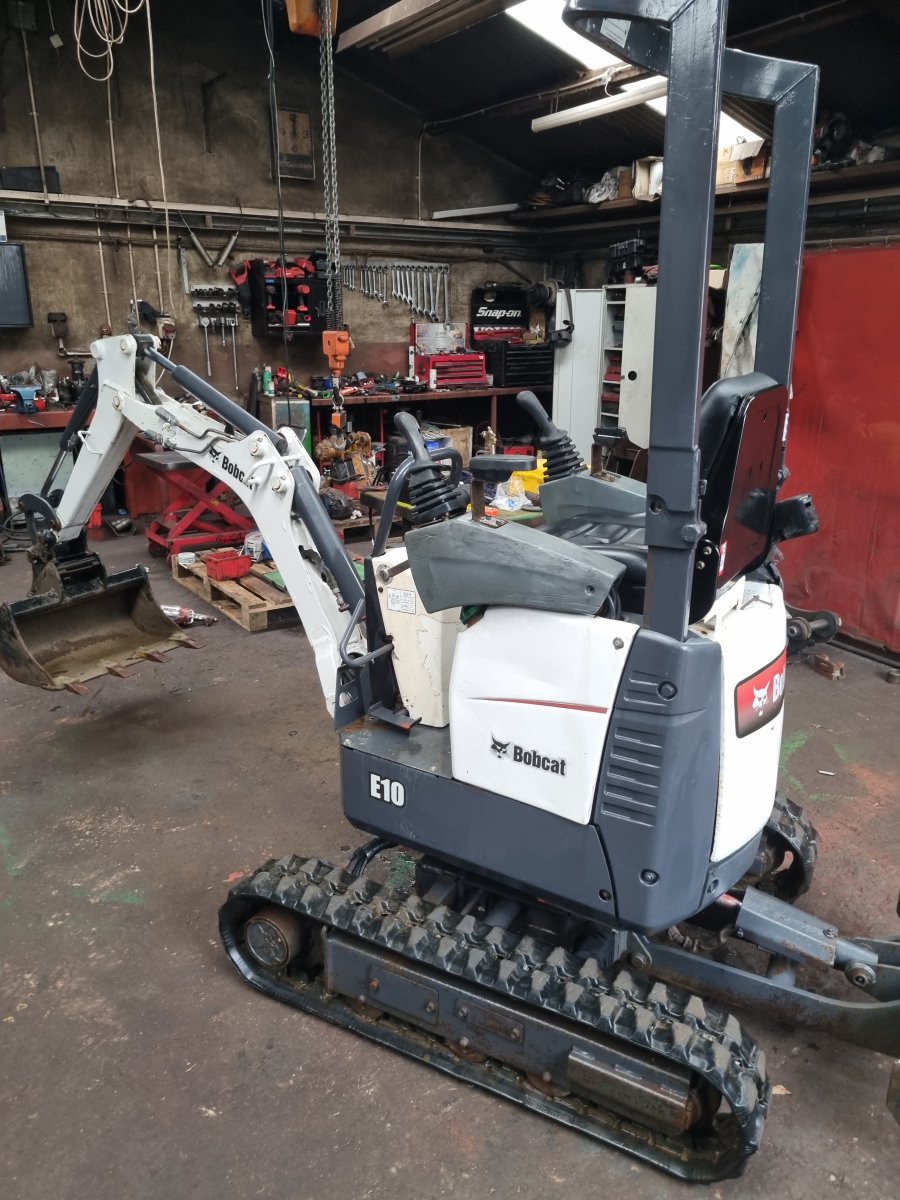

Regarding Powerfab some used a single variable pump & closed centre hydraulics, that pump £1800 to replace, a guy on my welding forum bought a non runner & made this mistake. Gear pumps tend to be cheaper & can sometimes be bought from Flowfit etc. The E10 could be worth looking at. Bri963 also replaced his own slew ring on the 008? Always admired that! Lot of aftermarket pins & bushes for the JCB 8014/16/18 range (I used them slightly modified on my Gopher rebuild as originals unobtainable). Agree anything Chinese a load of rubbish with poor components. I would never put anything of mine on self drive hire unless I was driving another machine on same job.

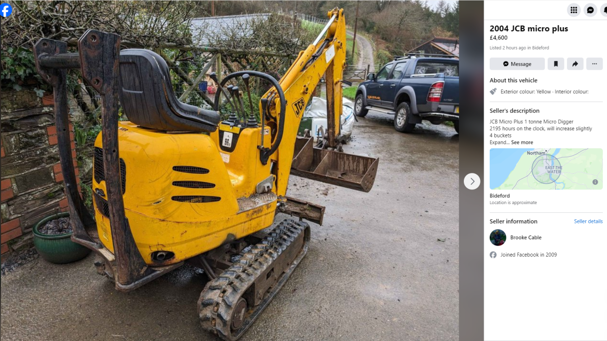

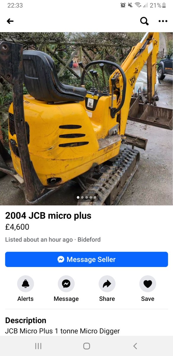

Seller's description​
JCB Micro Plus 1 tonne Micro Digger 2195 hours on the clock, will increase slightly 4 buckets Expanding tracks LED Lights Loads of work done recently, including several hydraulic hoses, ram rods, bushes, ram seals, rebuilt track gearbox, rewiring etc. Good tracks Auxiliary hydraulic lines Very recently serviced Bad bits: Bit of play in some pins, but digs well Tracks slightly slower on one side This is by no means a perfect machine, however its a solid workhorse which has done me a good turn. Reason for sale is a potential change of direction with the business means the JCB potentially has to go! Currently just having fuel lines replaced and will be ready to go once done Also have a breaker that can go with the machine for extra if of interest
Mate had a quote few weeks back 1k for k008 for all pins, bushes and bucket links
Was that genuine? Aftermarket you can do a bit better, if you do a bit of trawling you can find complete re-bush/ pin kits.
