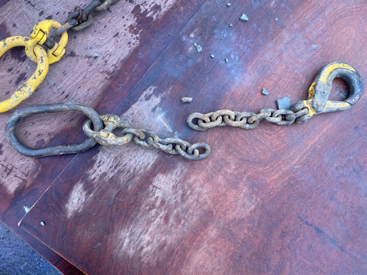

towing?? tha's 10mm chain :oops:
good for 3.15t if it is grade 8/80 which looking at the hook I should think it is. quite common to see really normally if they keep the bucket on and over curl it snaps the chain or trying to pull trench boxes with out freeing them up first. had a chain a couple of weeks ago they had managed to stretch a 13mm hook and also caught them using a set of 4 legers to drag a full loaded 20ft container along the tarmacked site road with a 360'
SWL ...... proof load is IIRC, 5 times that though Andy and that's not to destruction usually ............

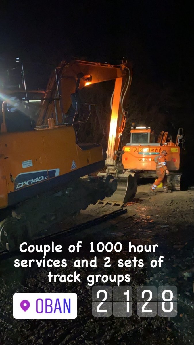

Keeping the customer going,
2 sets of undercarriages replaced on 2 x 14t Doosans.
1 Doosan 1k service and also a 1k service on case 210D,
All carried out on night shift to keep the lads working through the day on a time sensitive job.
