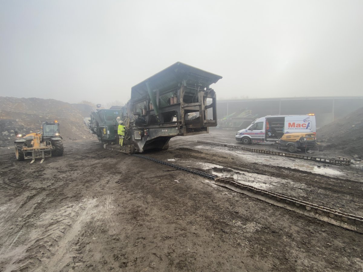

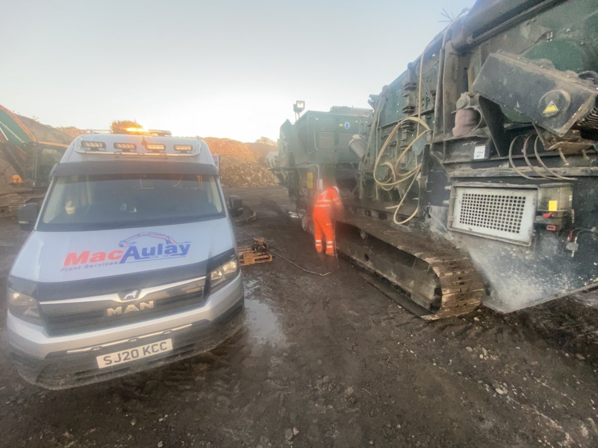

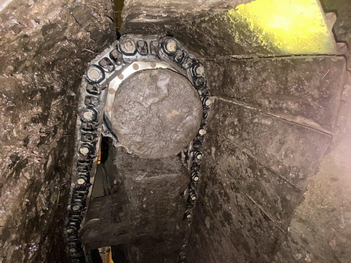

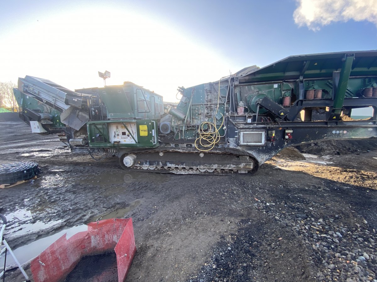

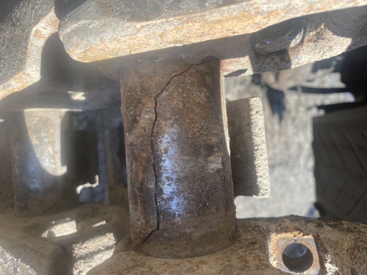

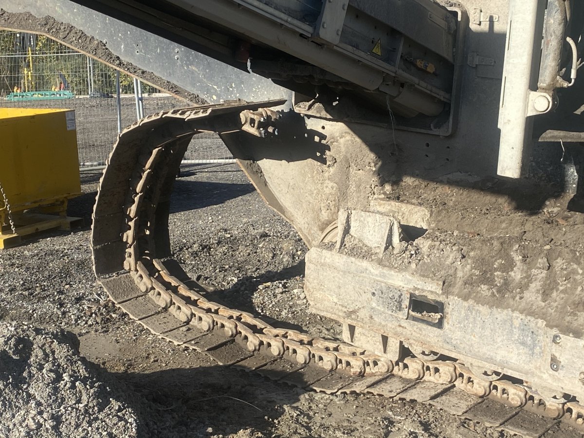

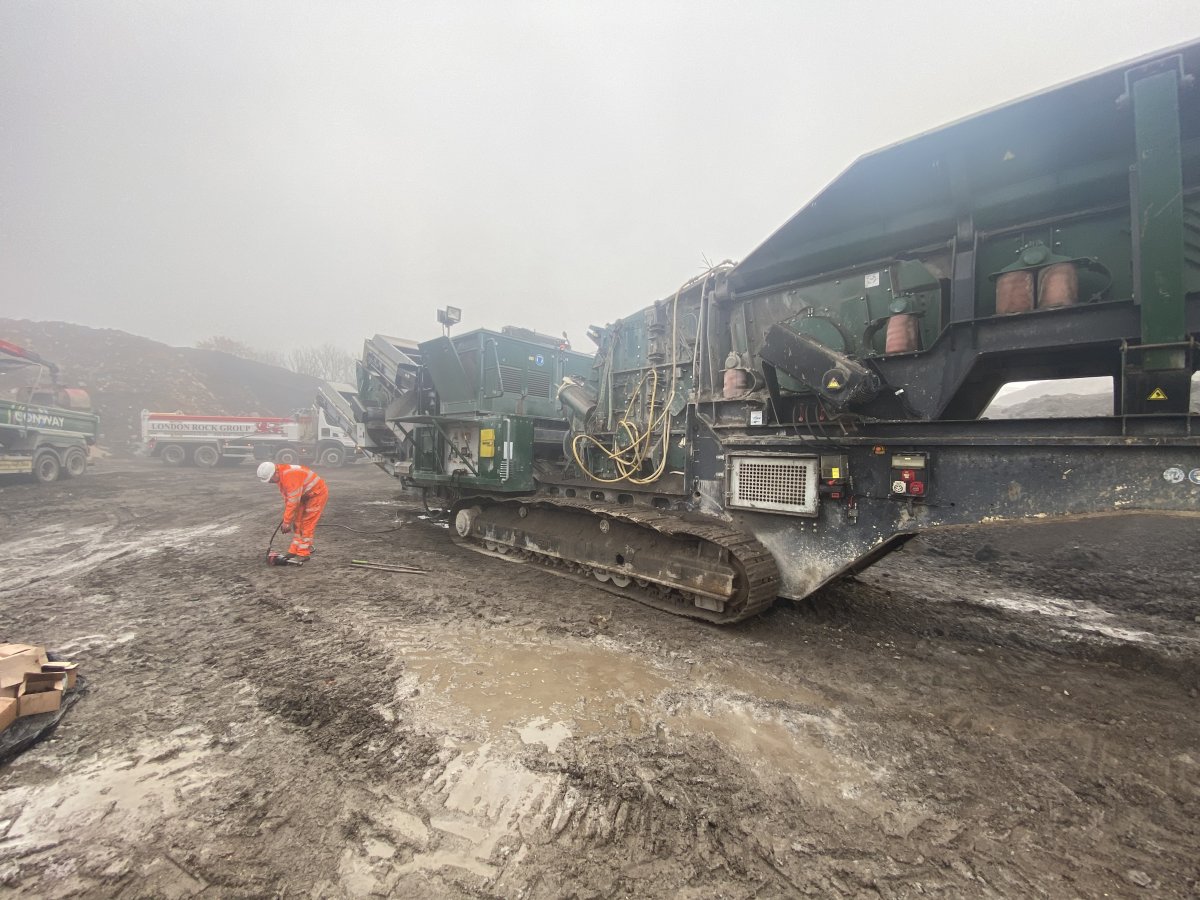

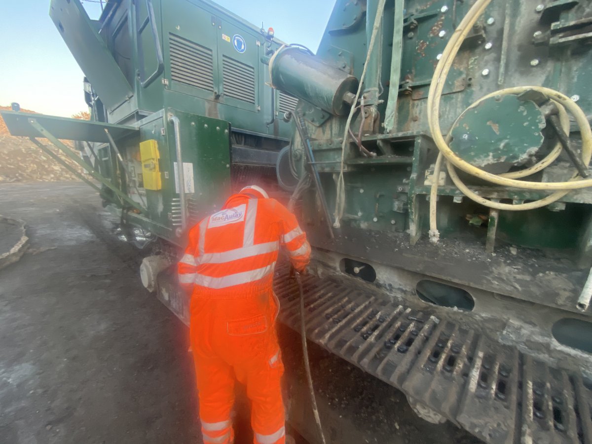

SBM Remax 1313 impact crusher we
Fitted new chains on in at Heathrow tar plant.

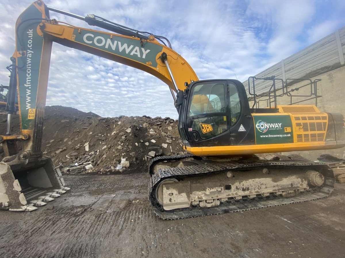

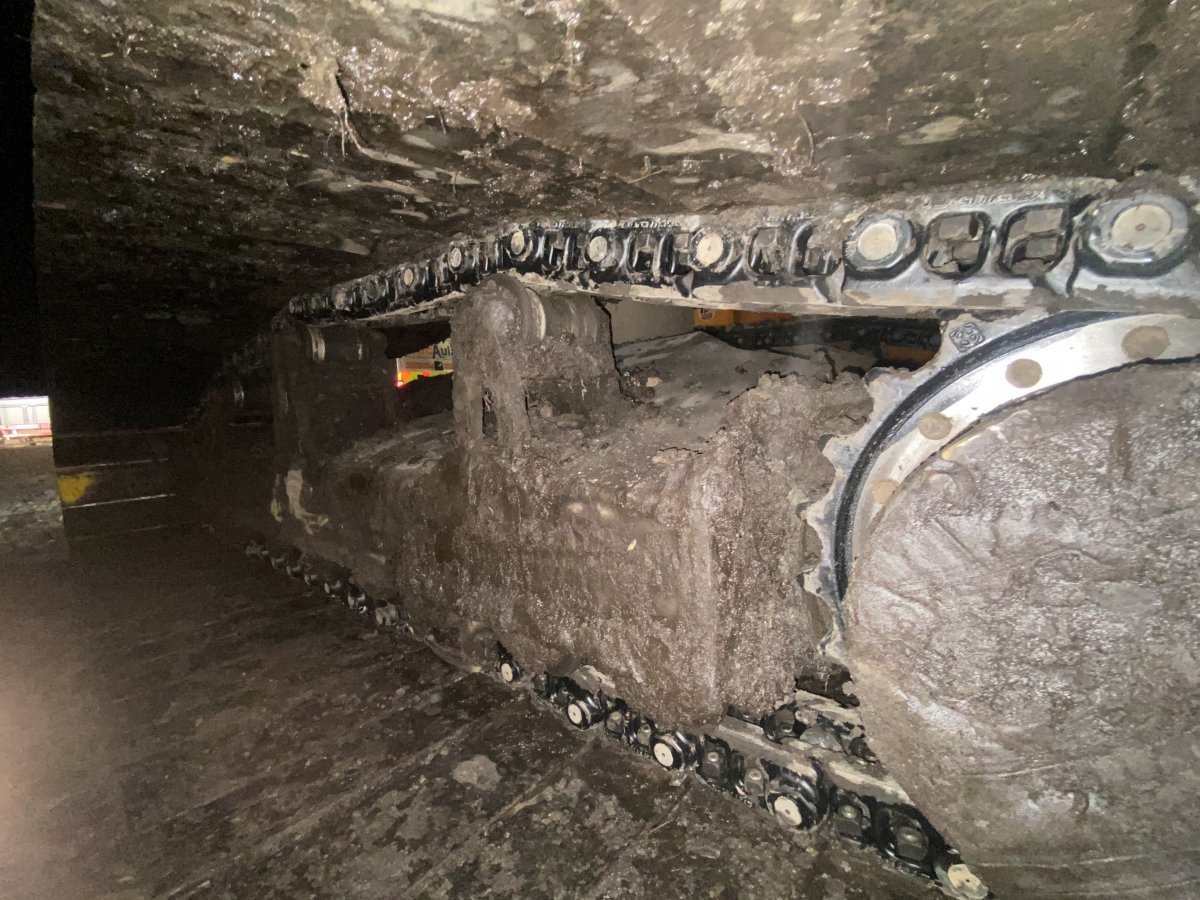

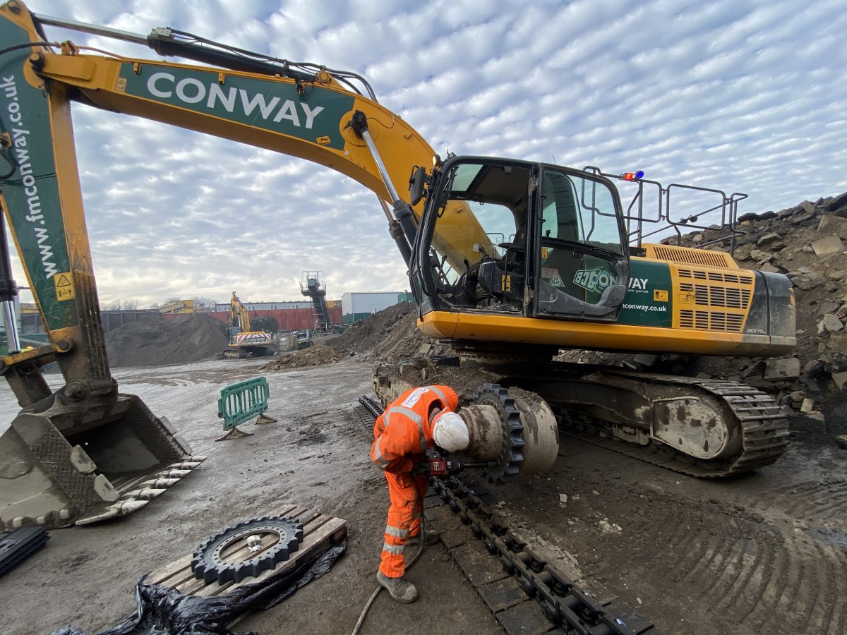

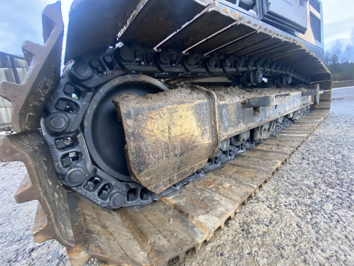

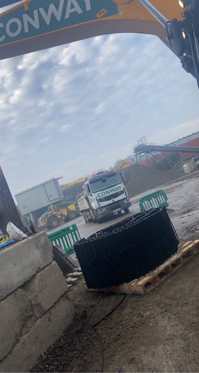

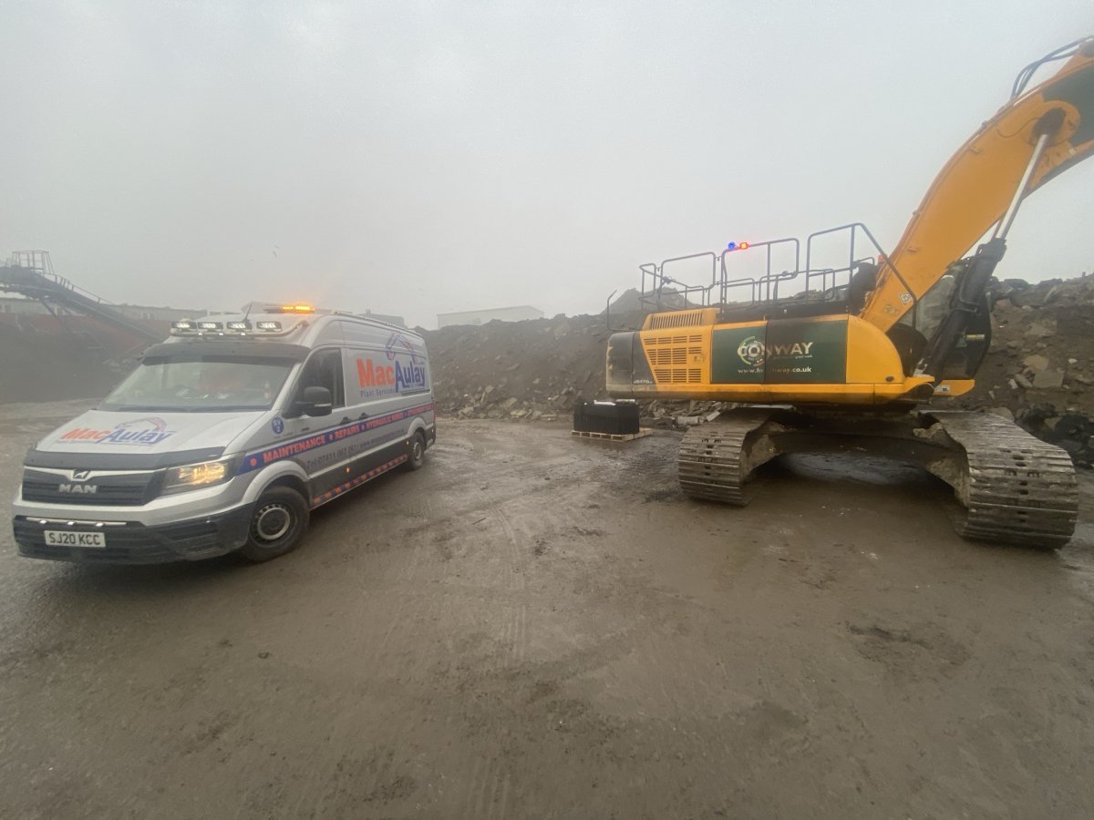

JCB JS370 replacement track groups and sprockets fitted in Dartford recycling centre

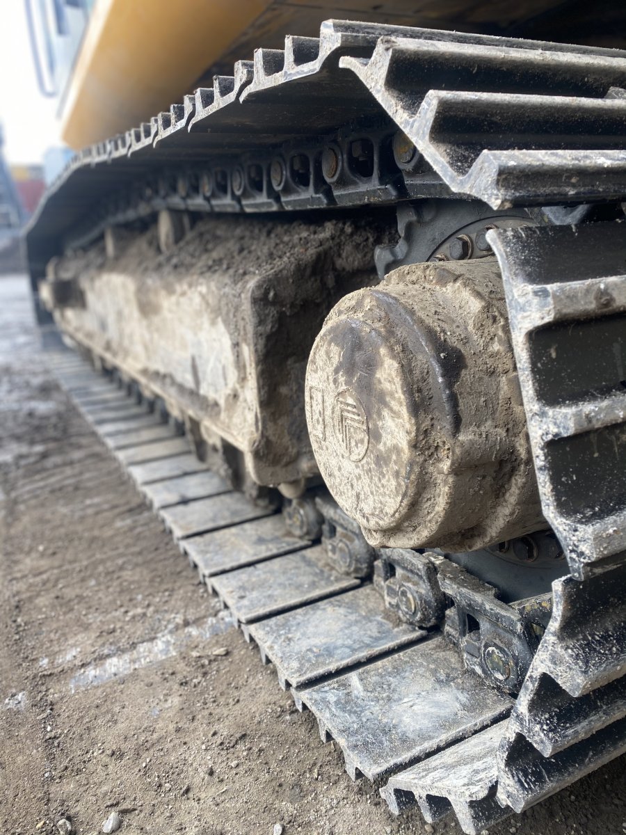

Replacement chains on this widespread 13t hitachi

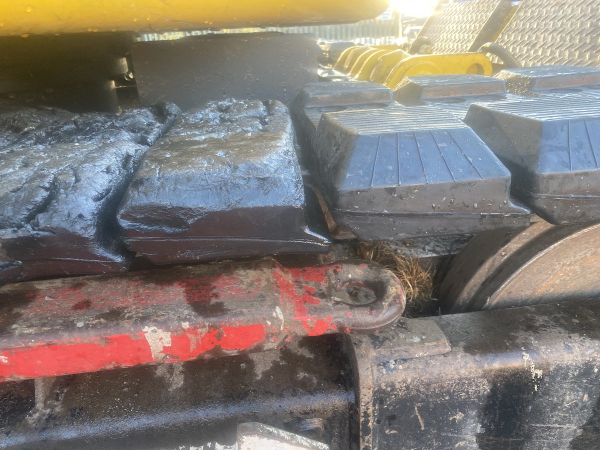

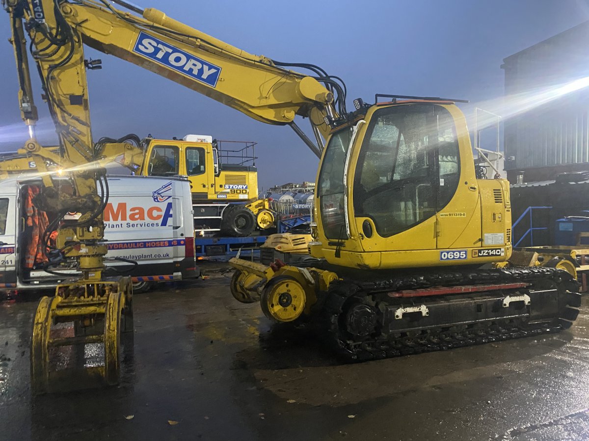

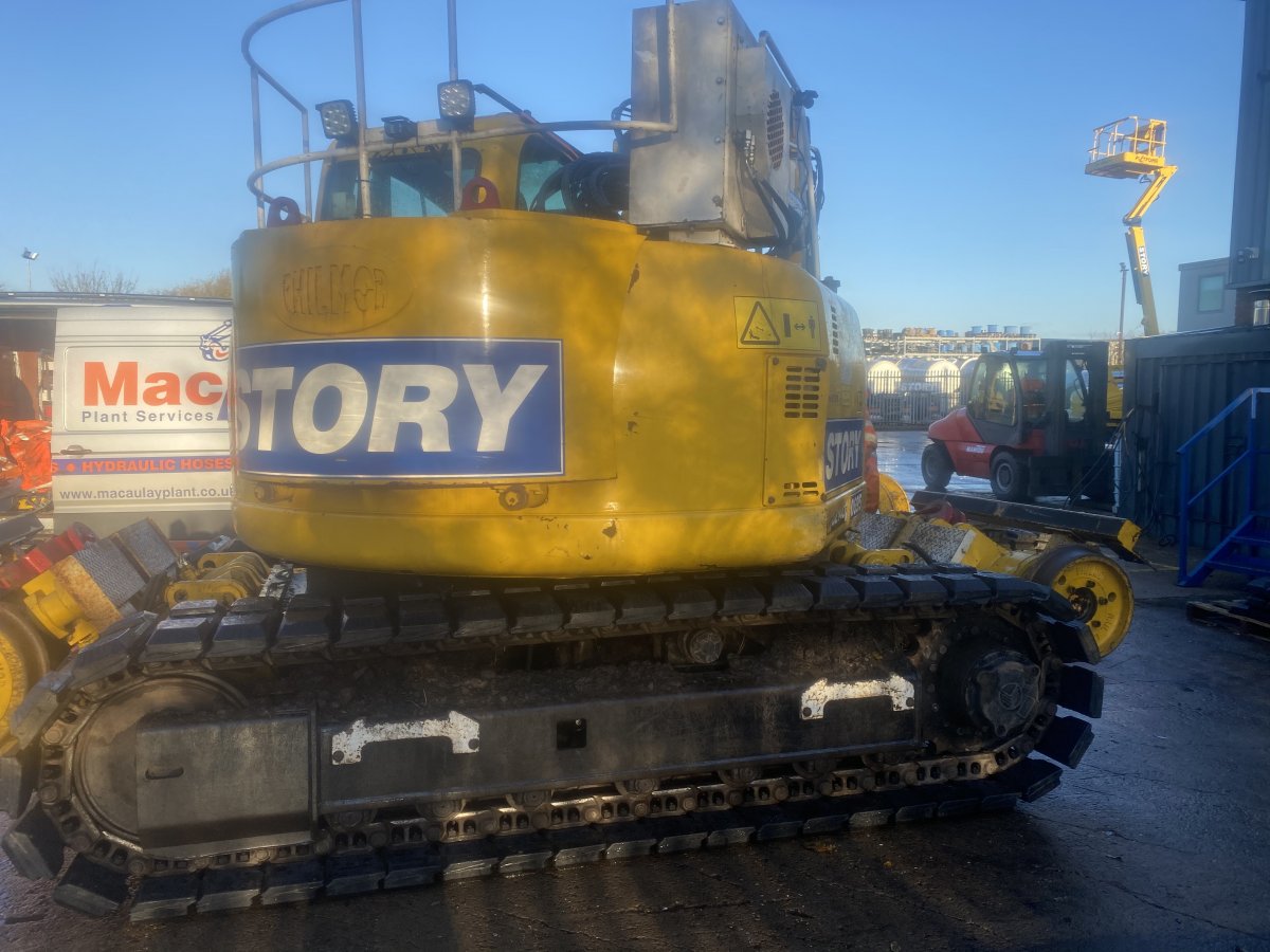

Road liner pads in his BUG for story rail

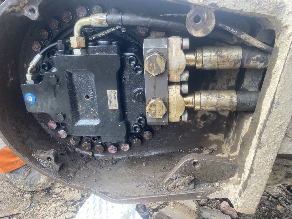

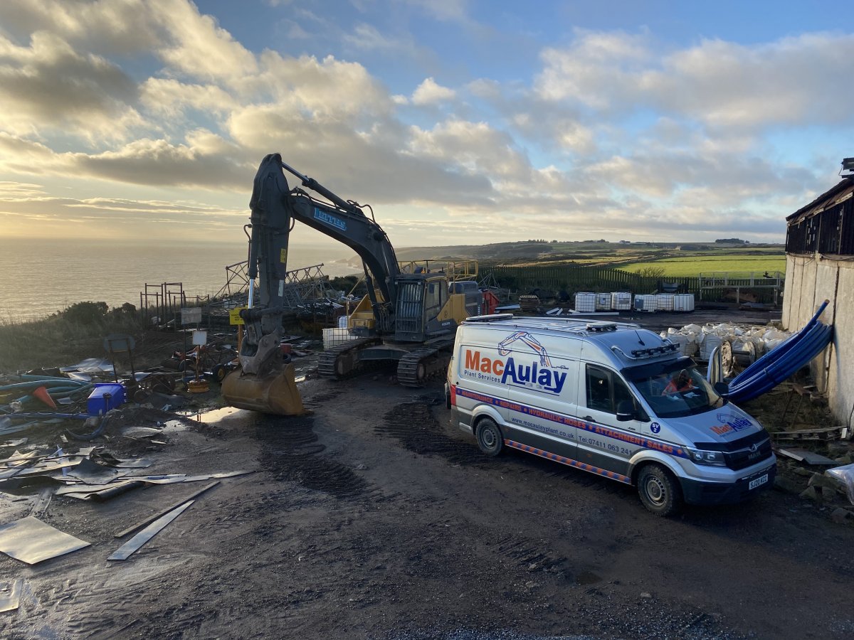

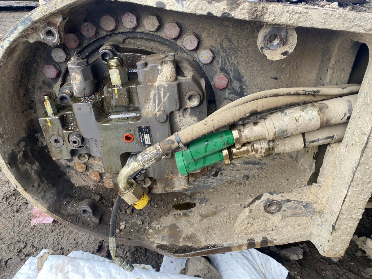

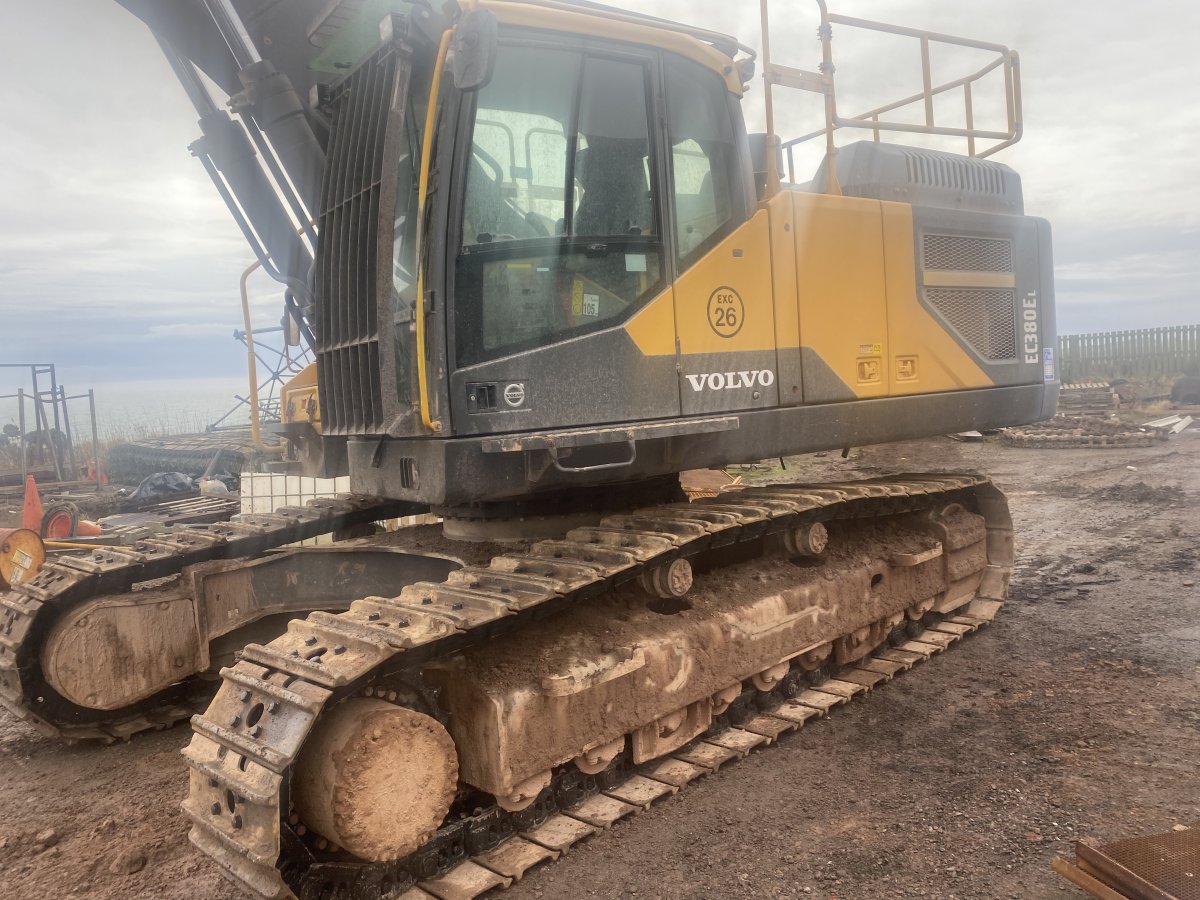

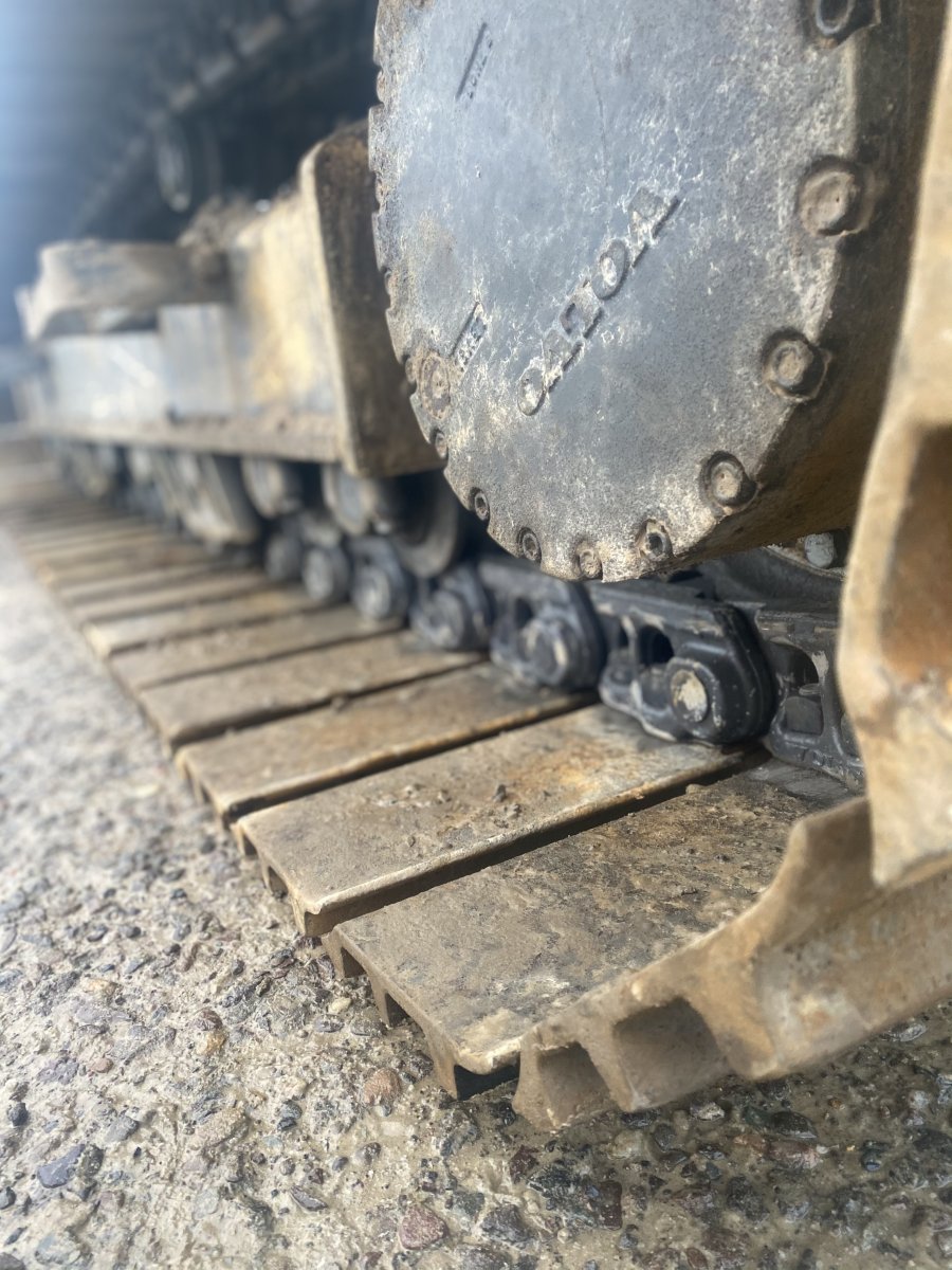

Replacement Final Drive and sprockets on this Volvo EC380E in leeds

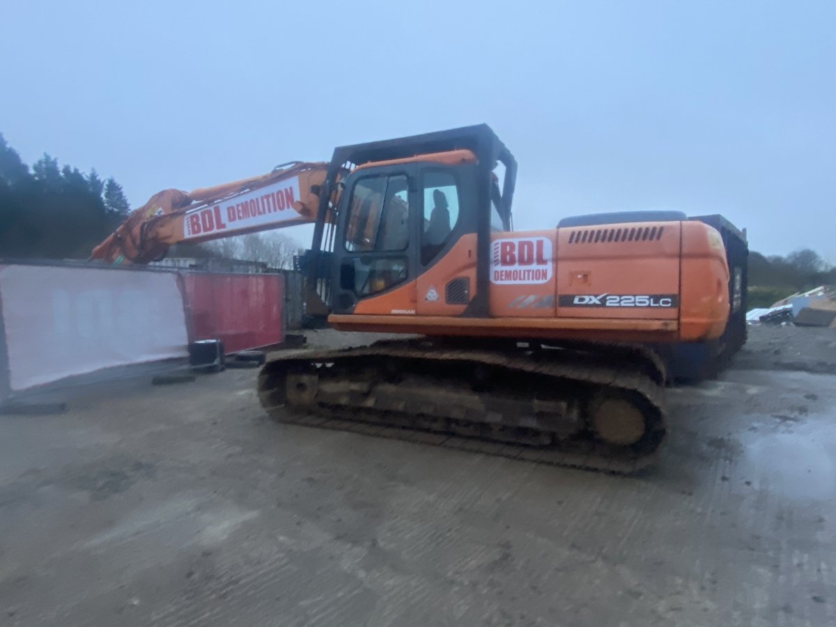

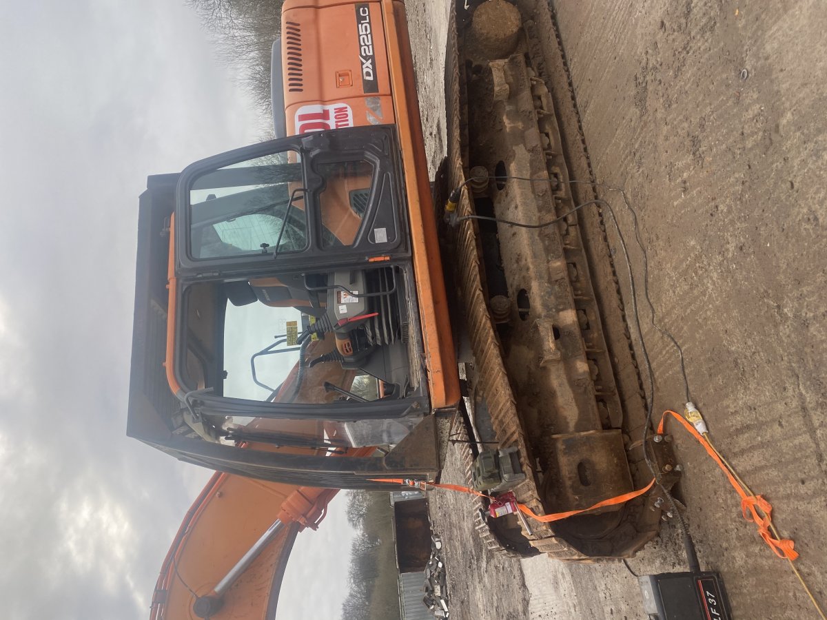

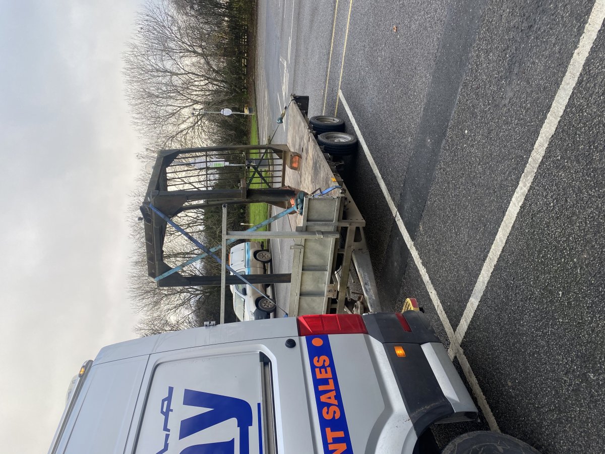

Doosan DX225-1, 1000hour service, low flow rotation kit installed, demolition cage installed and new hoses on selector grab

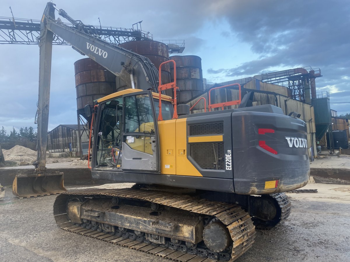

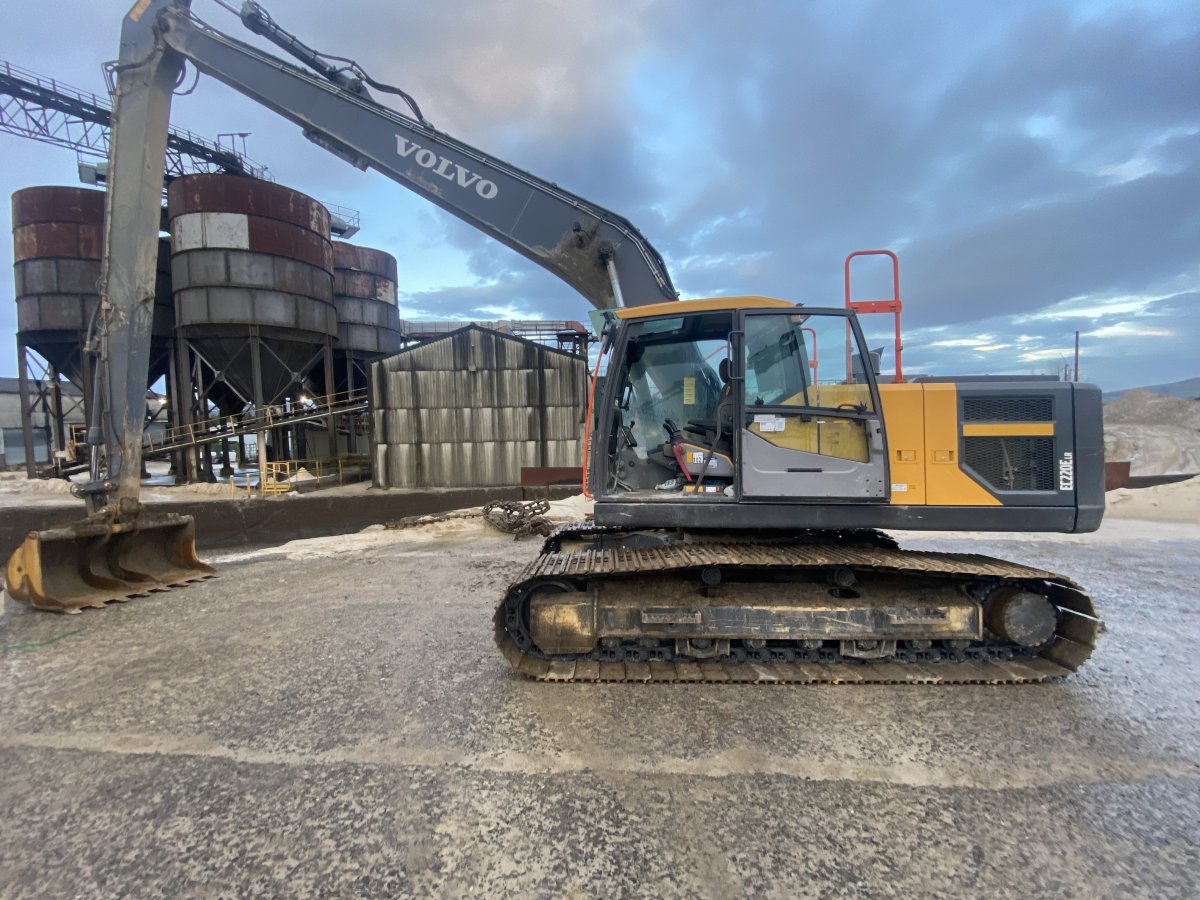

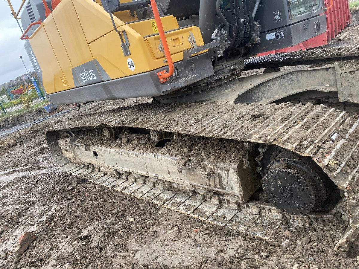

Full Undercarriage replacement on this Volvo EC220ELR for SMT Stirling working in a sand quarry

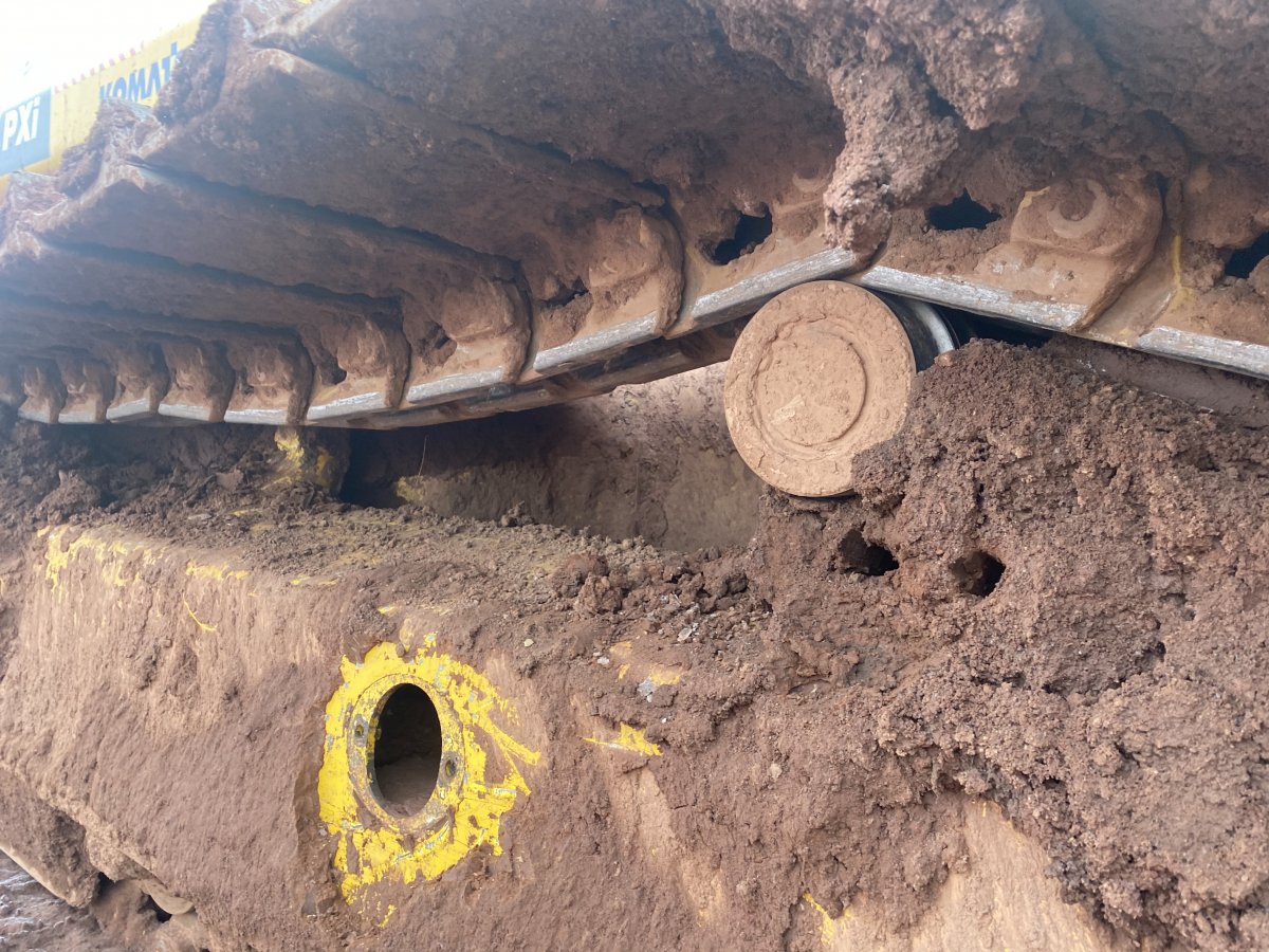

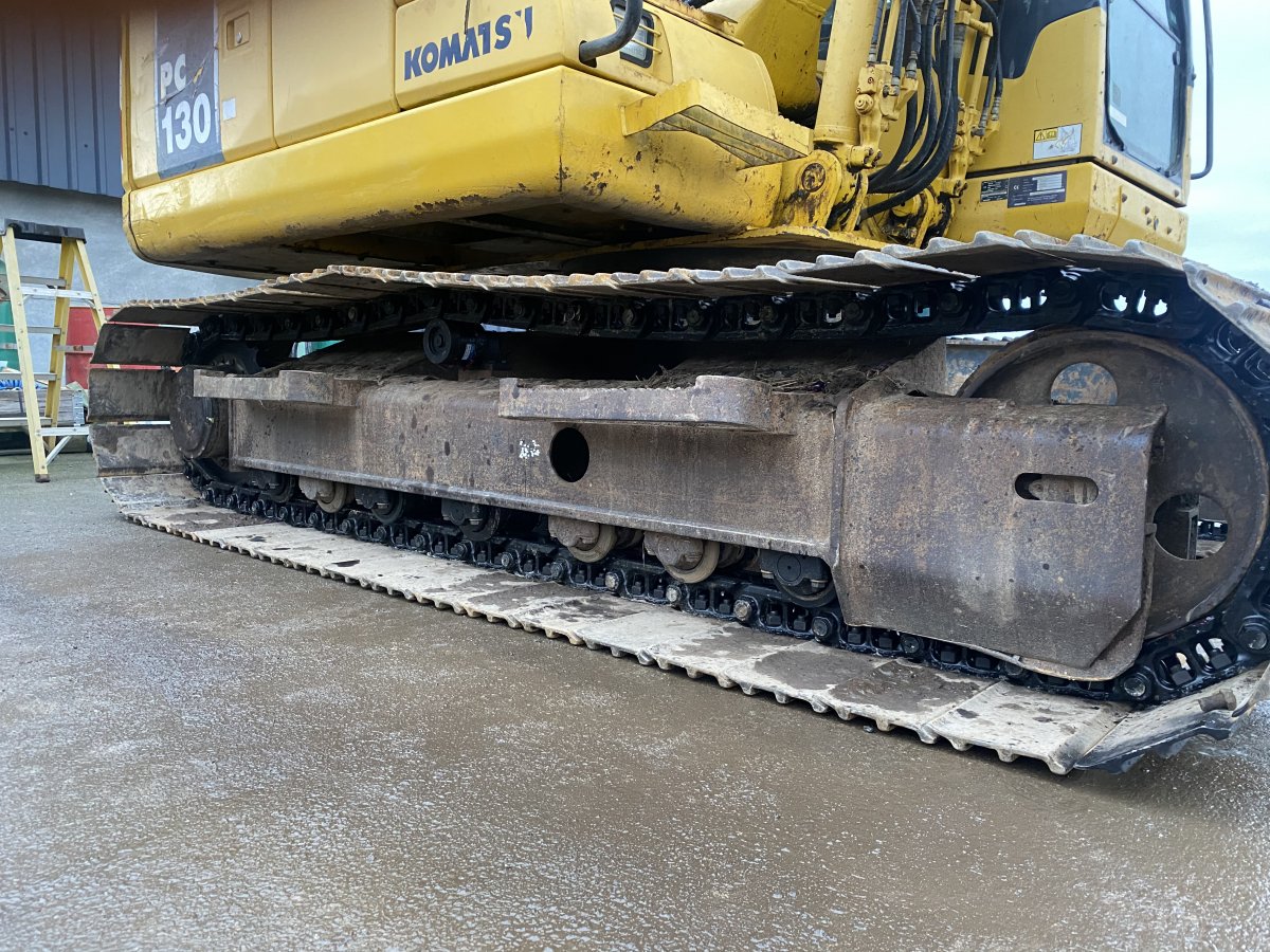

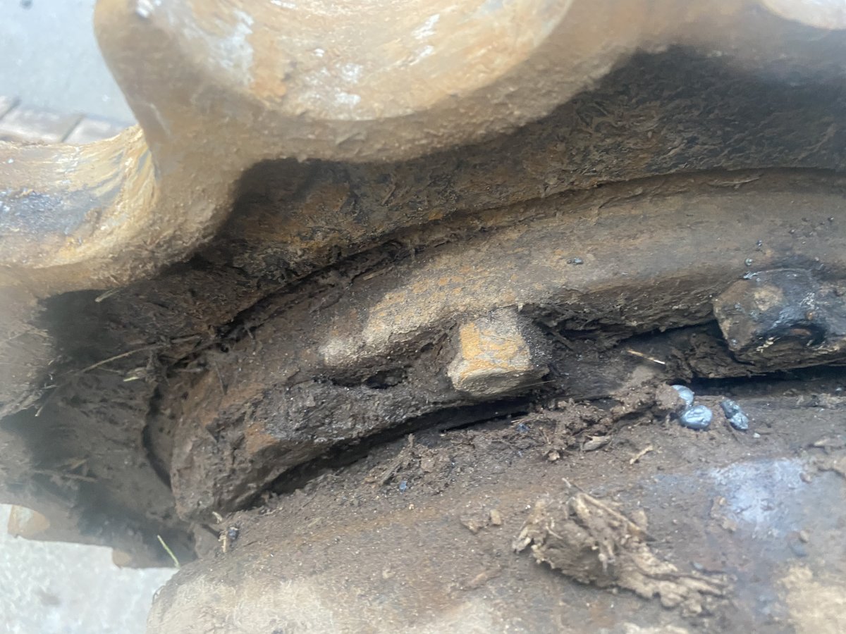

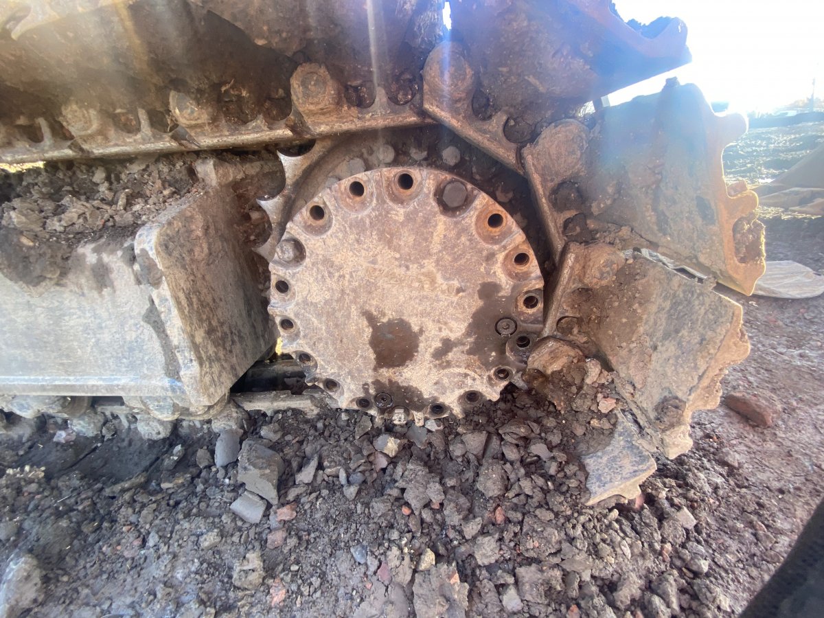

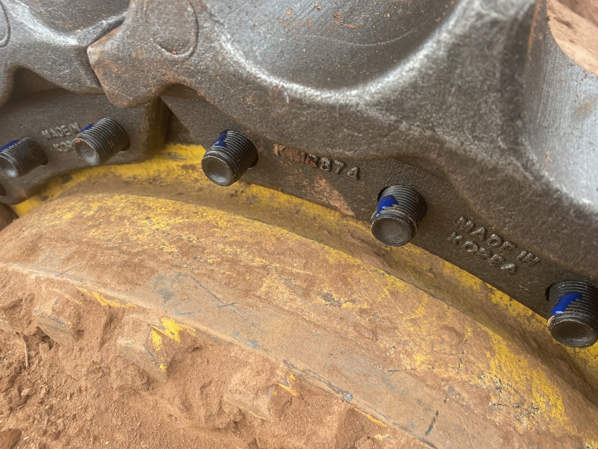

Replacement chains + sprockets on this Komatsu,
she snapped every bolt in the final drive, if guys are going to do a repair at least do it properly

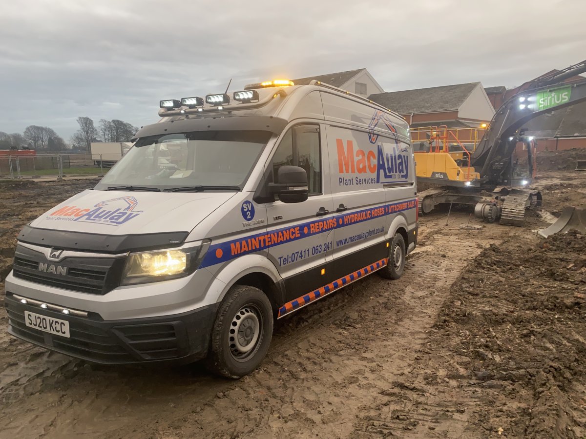

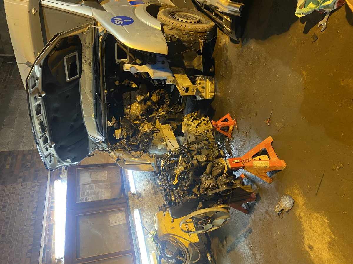

Another engine coming out of SV1, she’s been a naughty van in 2020, dropped a valve on 1 engine, roasted another, we rebuilt it and she spun the exhaust cam.

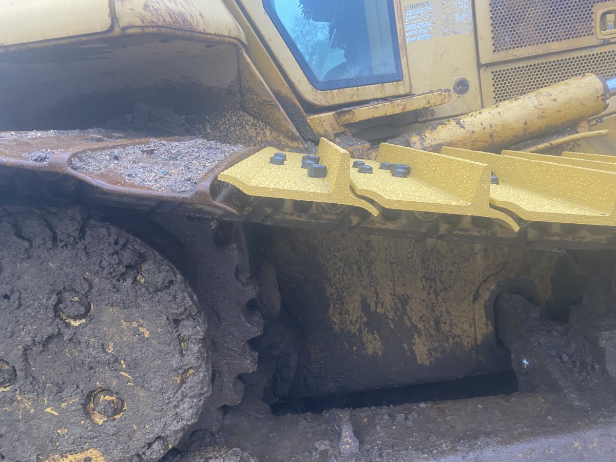

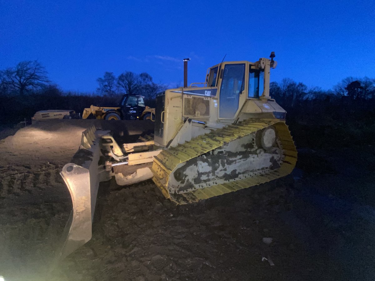

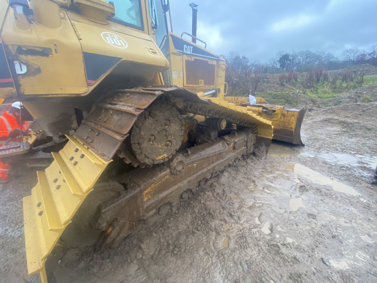

D6N pad swap, she had new chains last year, insurance man condemned her this year on pads.

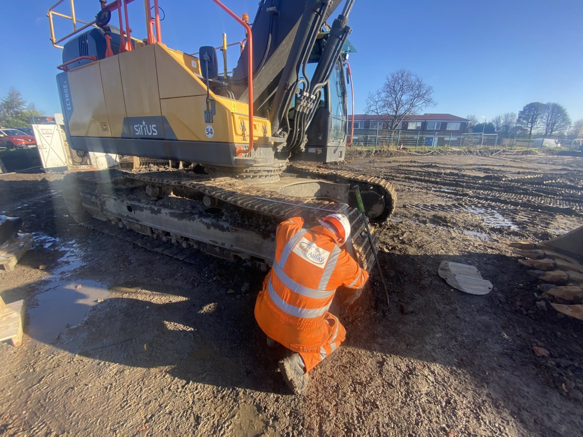

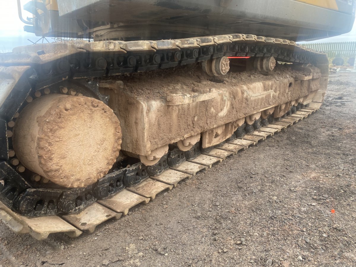

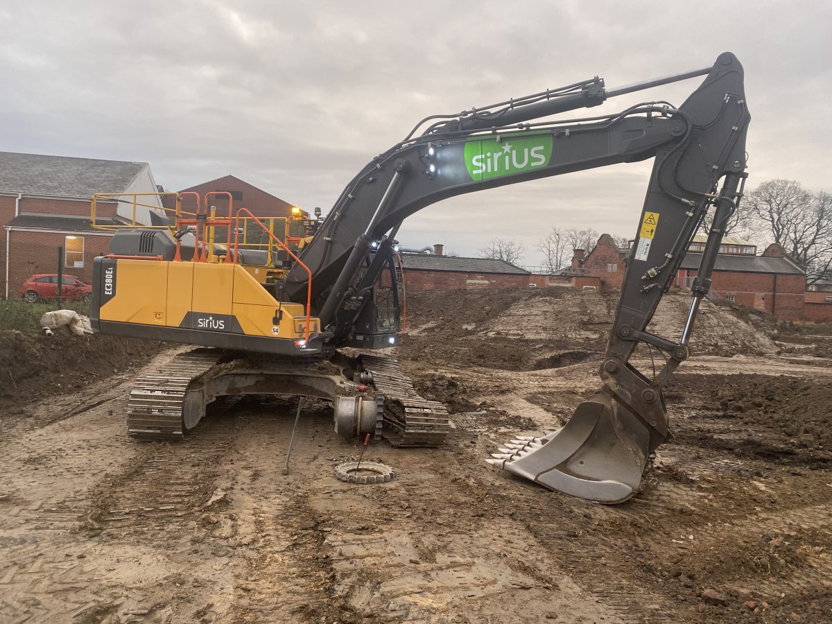

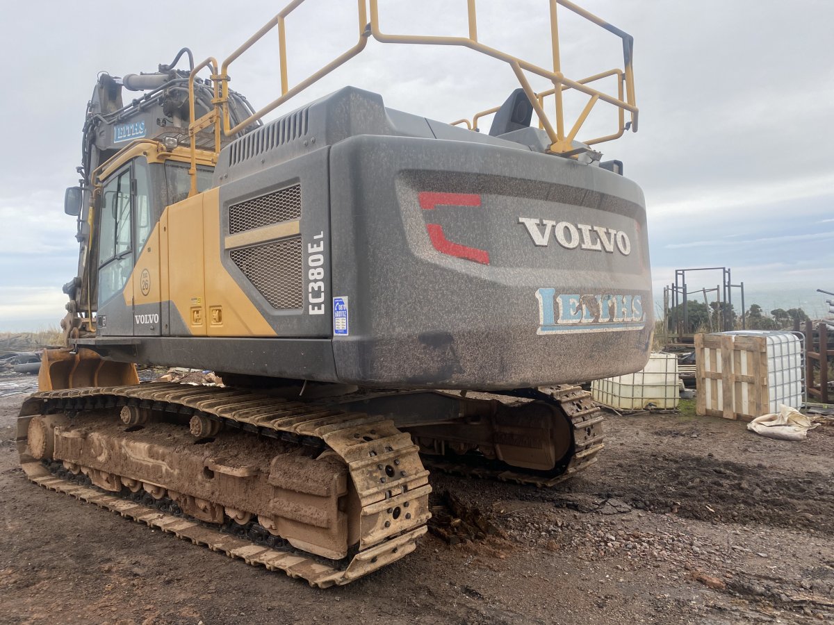

2017 Volvo EC380E with shy of 12k hours getting replacement chains + sprockets.

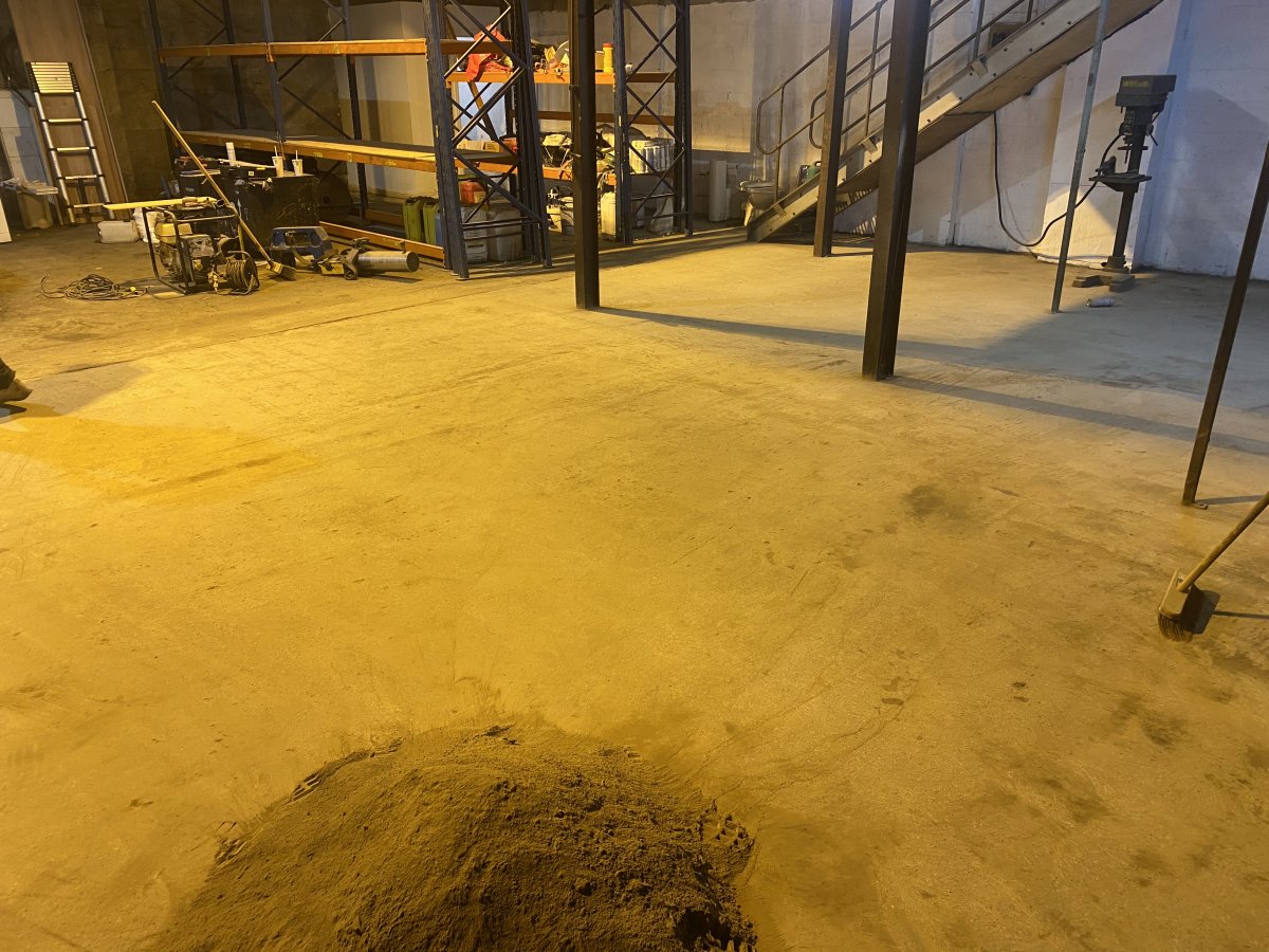

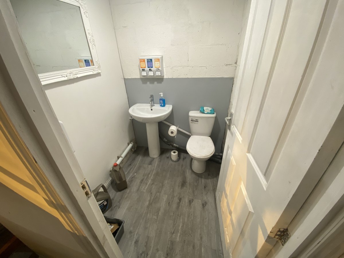

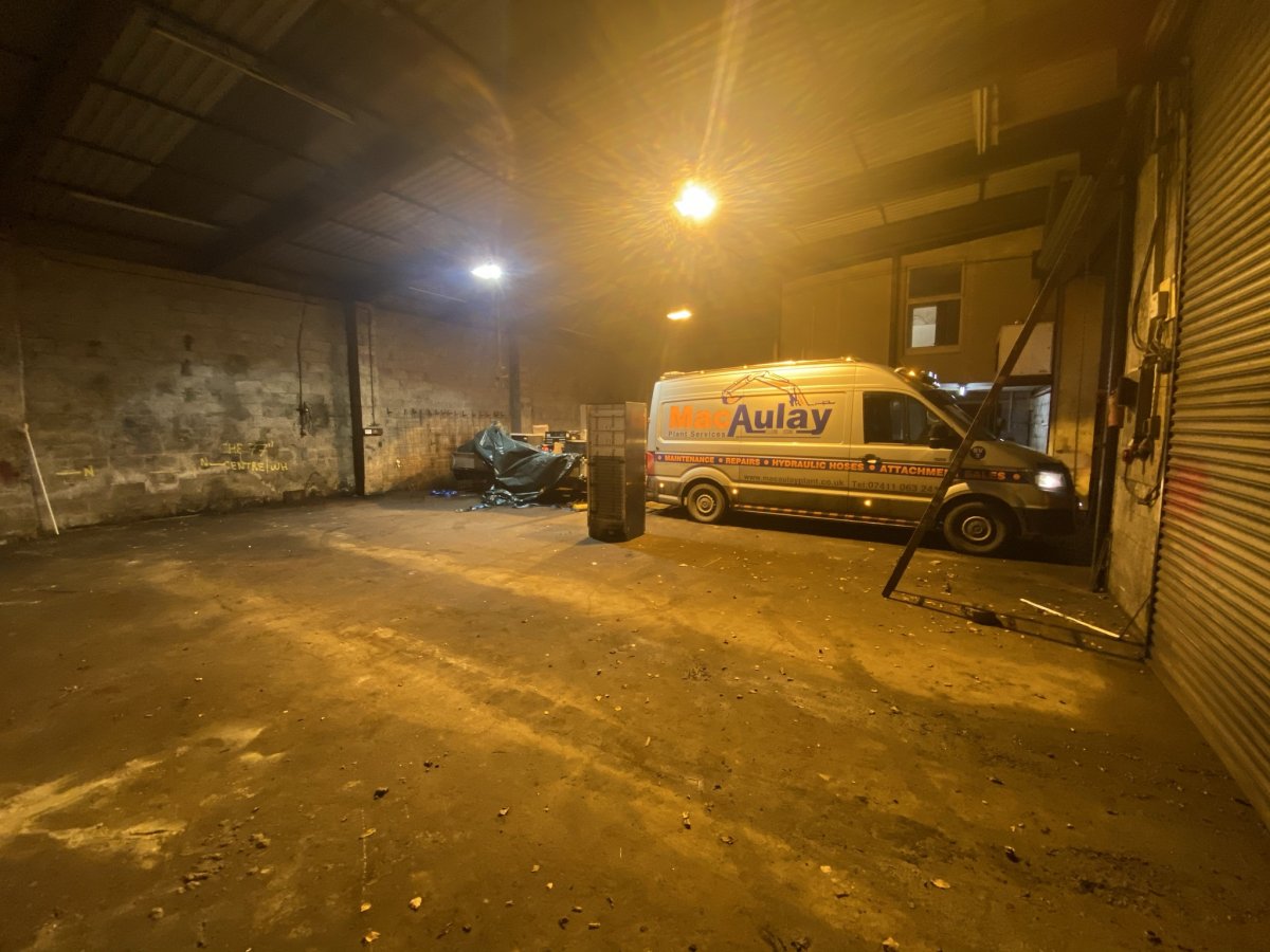

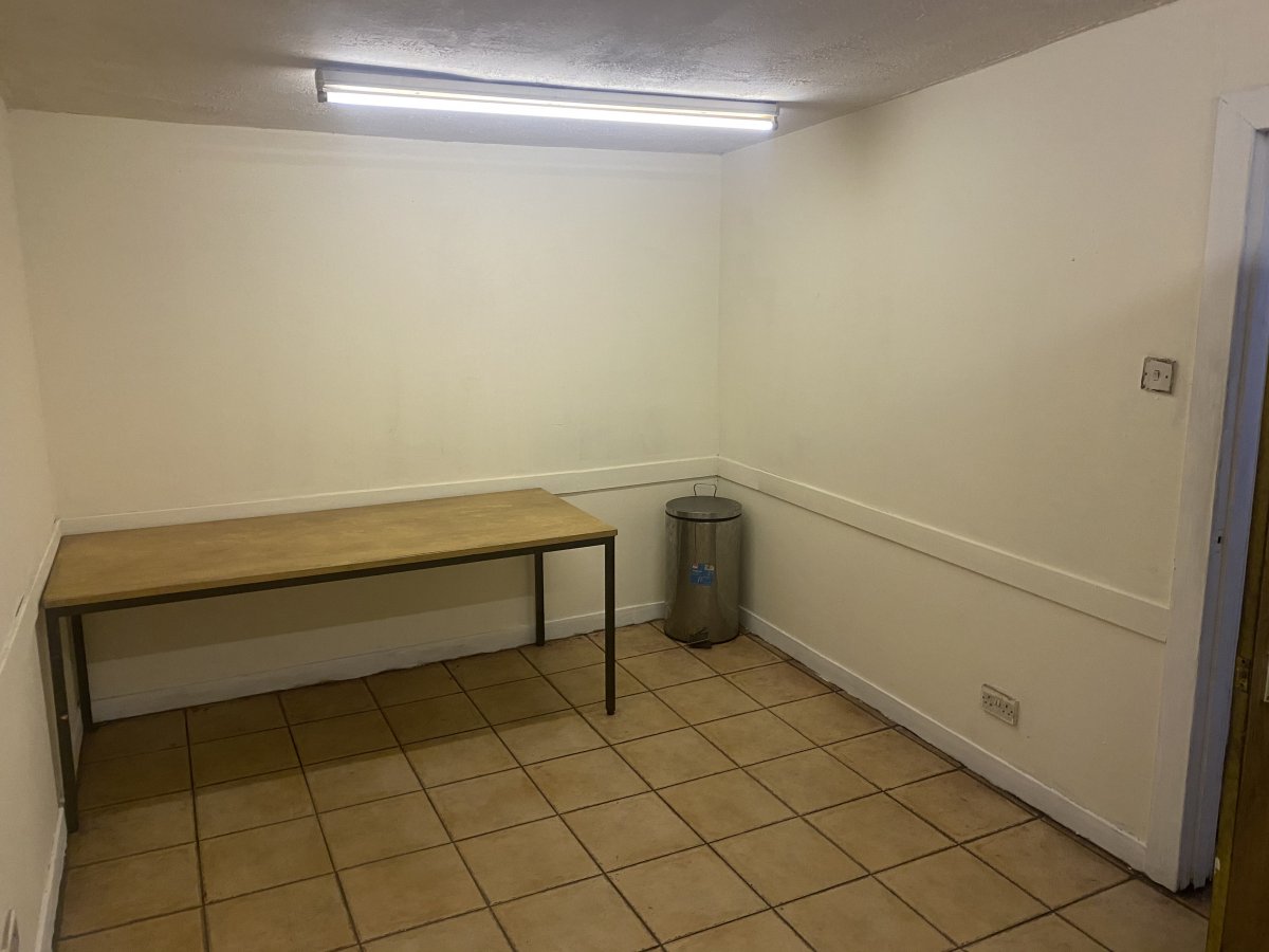

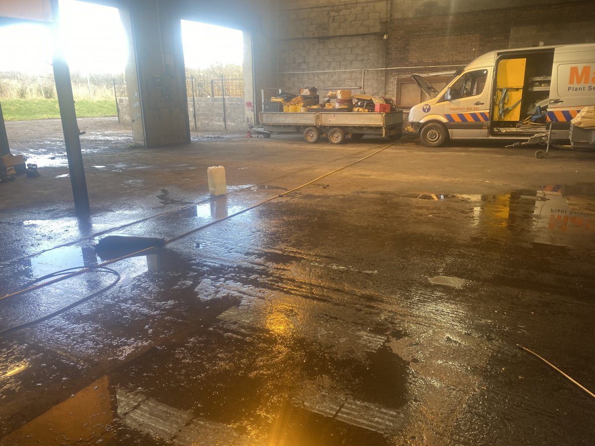

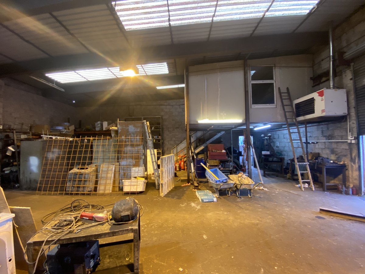

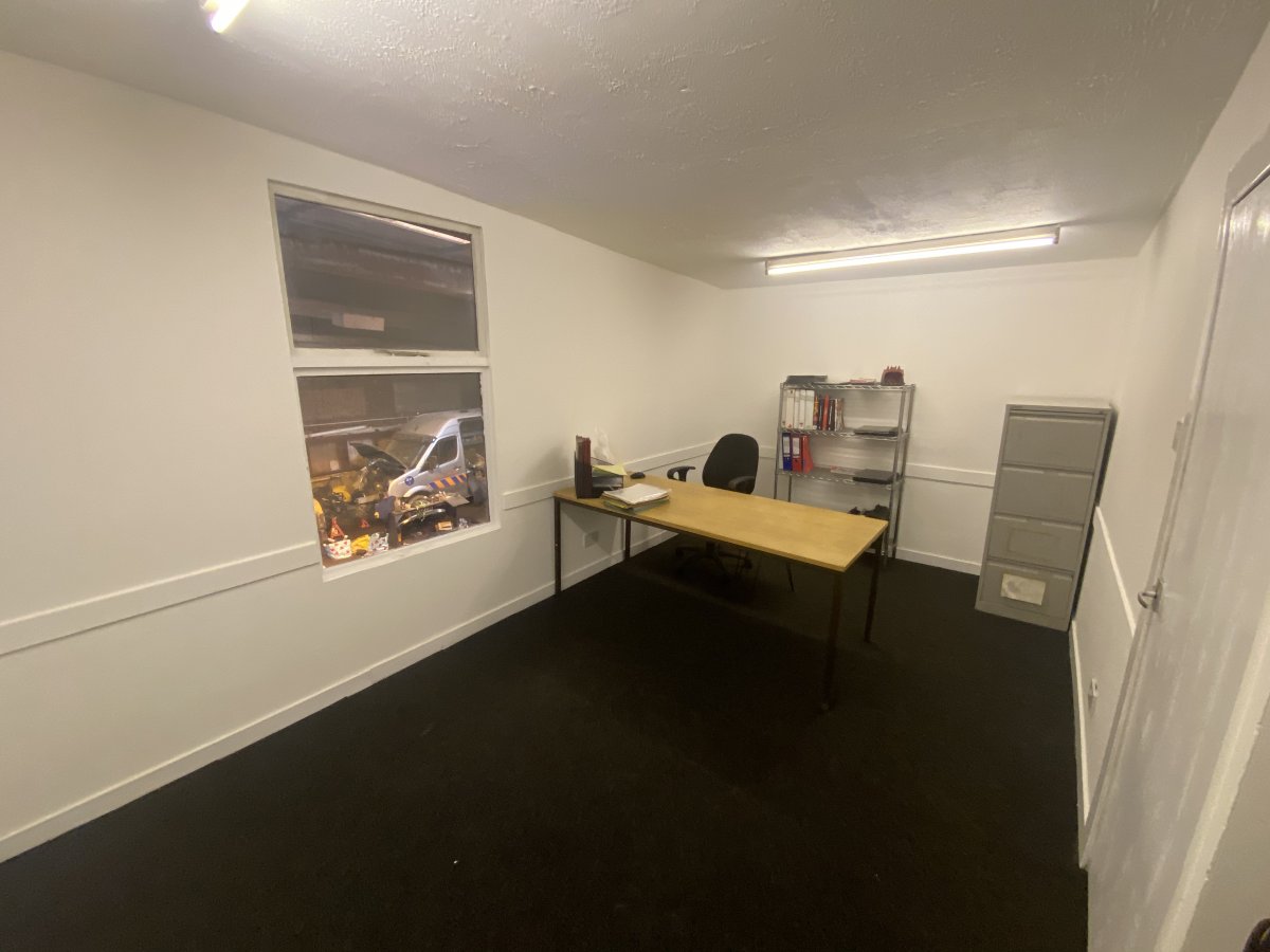

Workshop slowly coming along when we get a chance. Still have some floor to grind and clean and paint, office and toilet installed

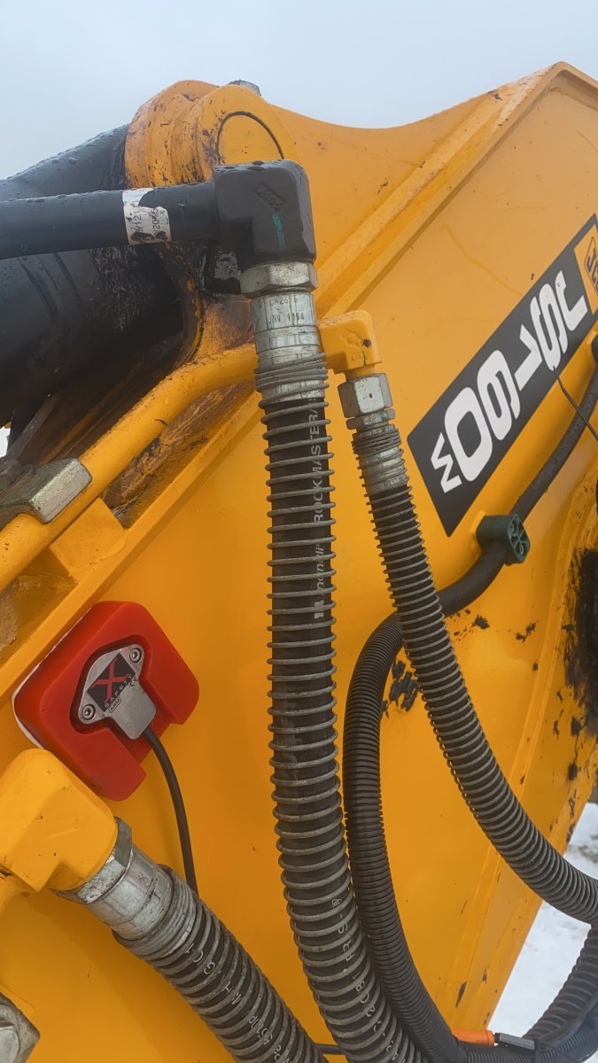

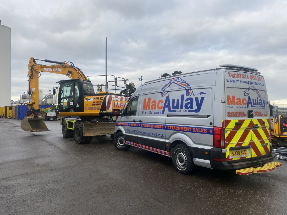

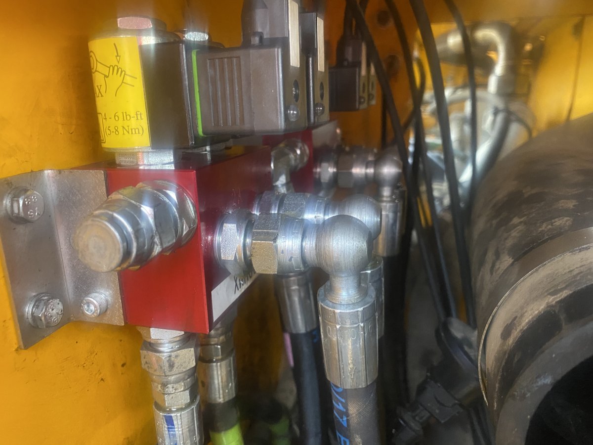

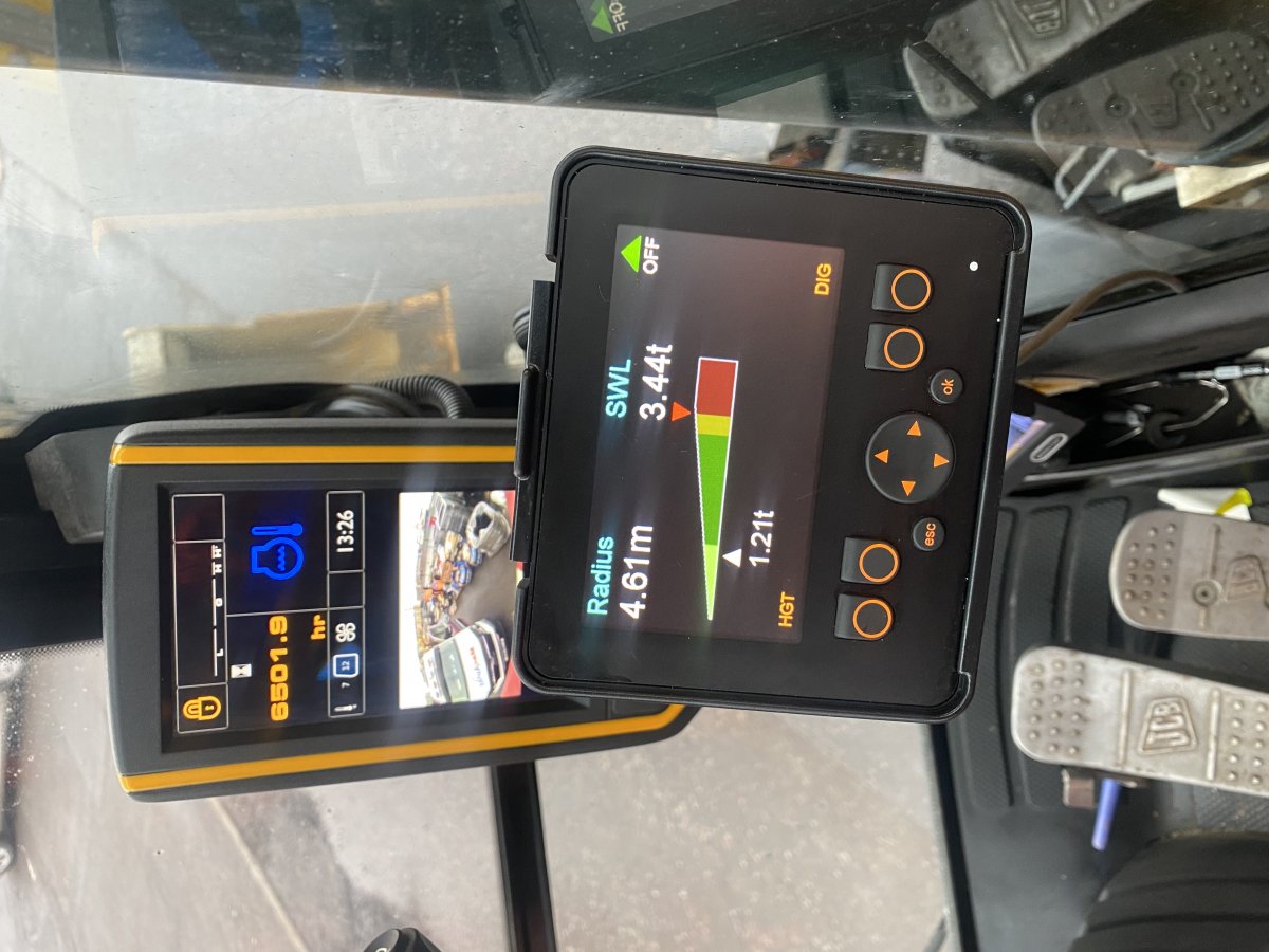

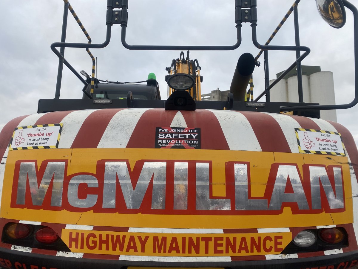

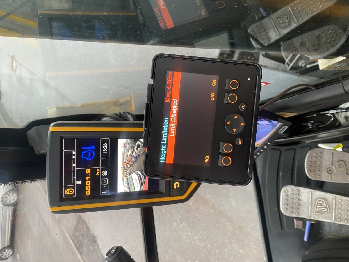

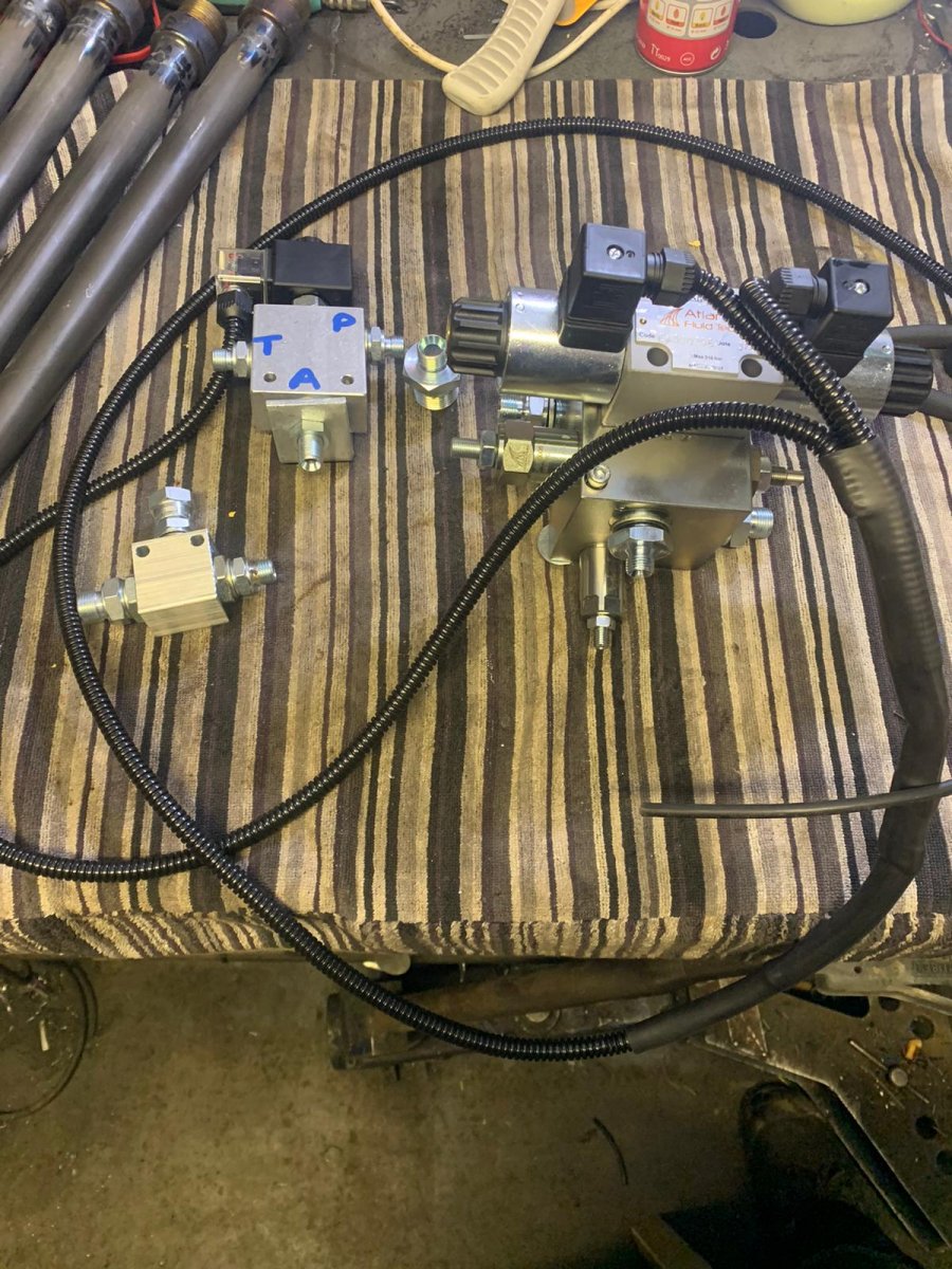

XWatch safety solutions XW2 RCI + height limiter installed onto this JCB JS160W
this is a fully proportional hydraulic control system which gives a nice and steady stop when coming to limits weather height or weight

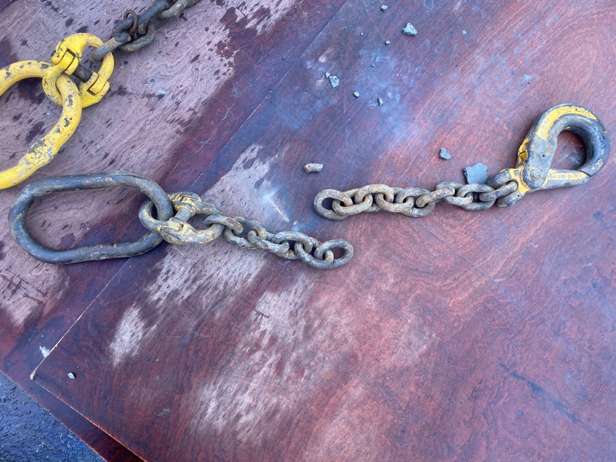

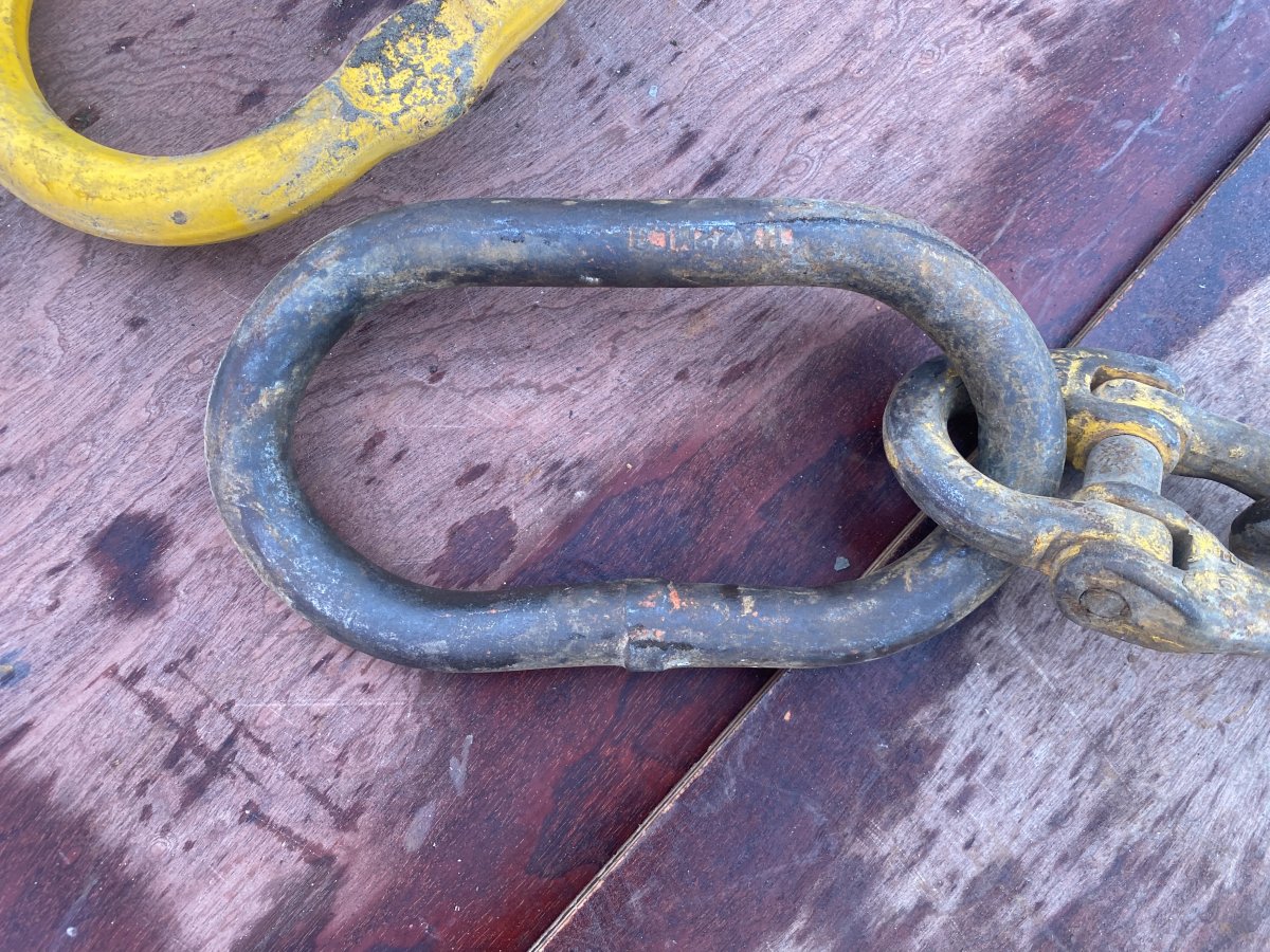

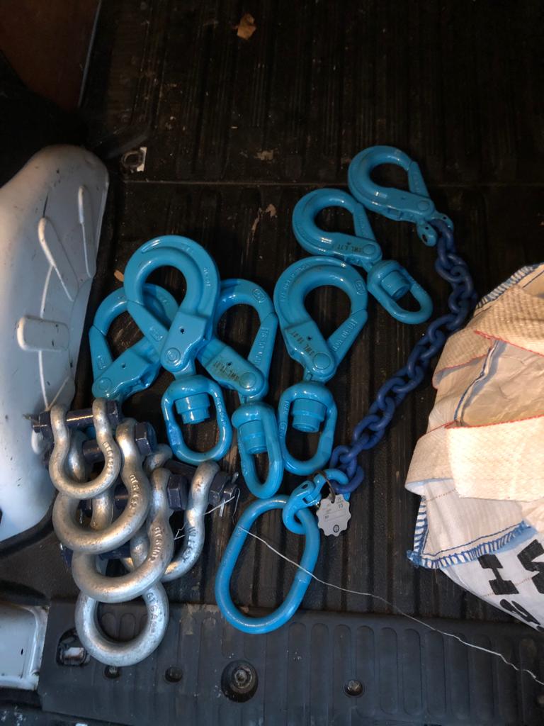

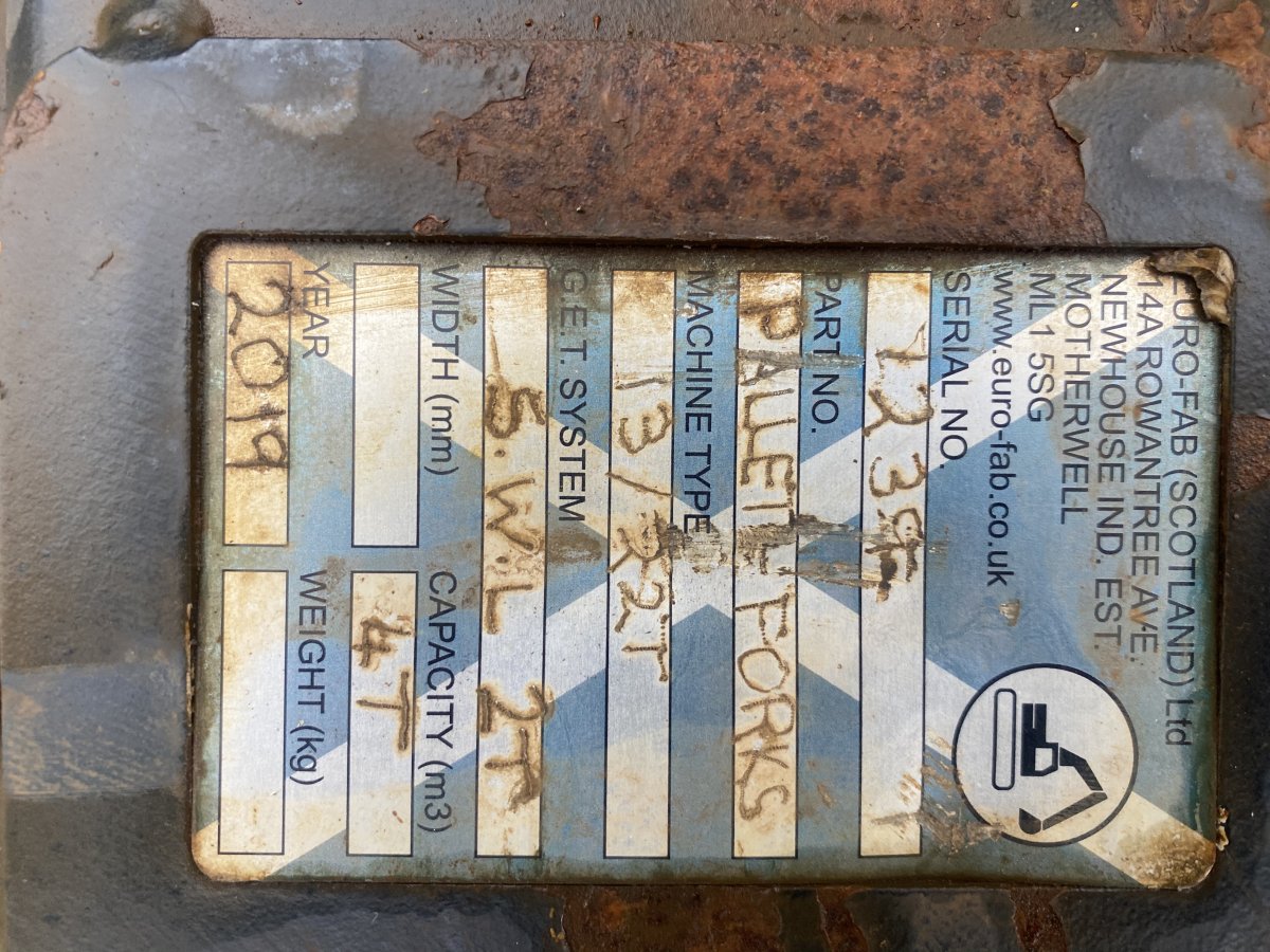

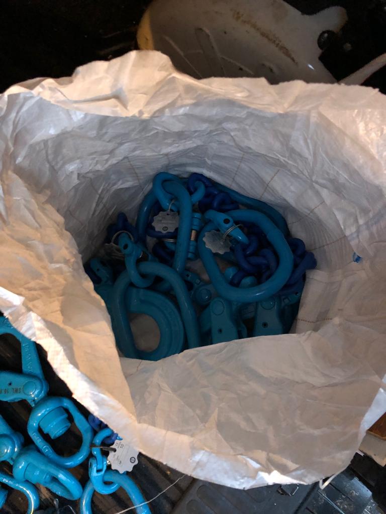

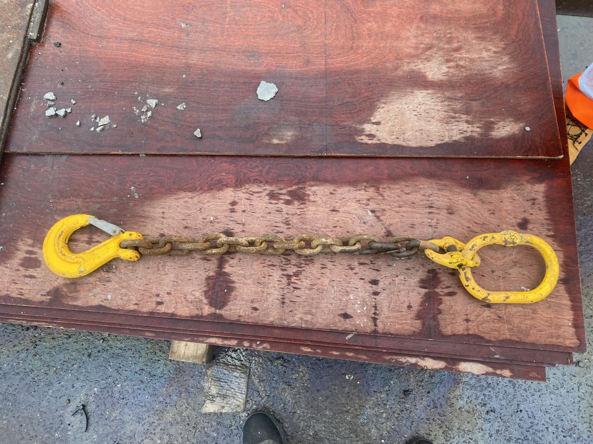

Lifting equipment inspections and supplying our customers with new lifting equipment

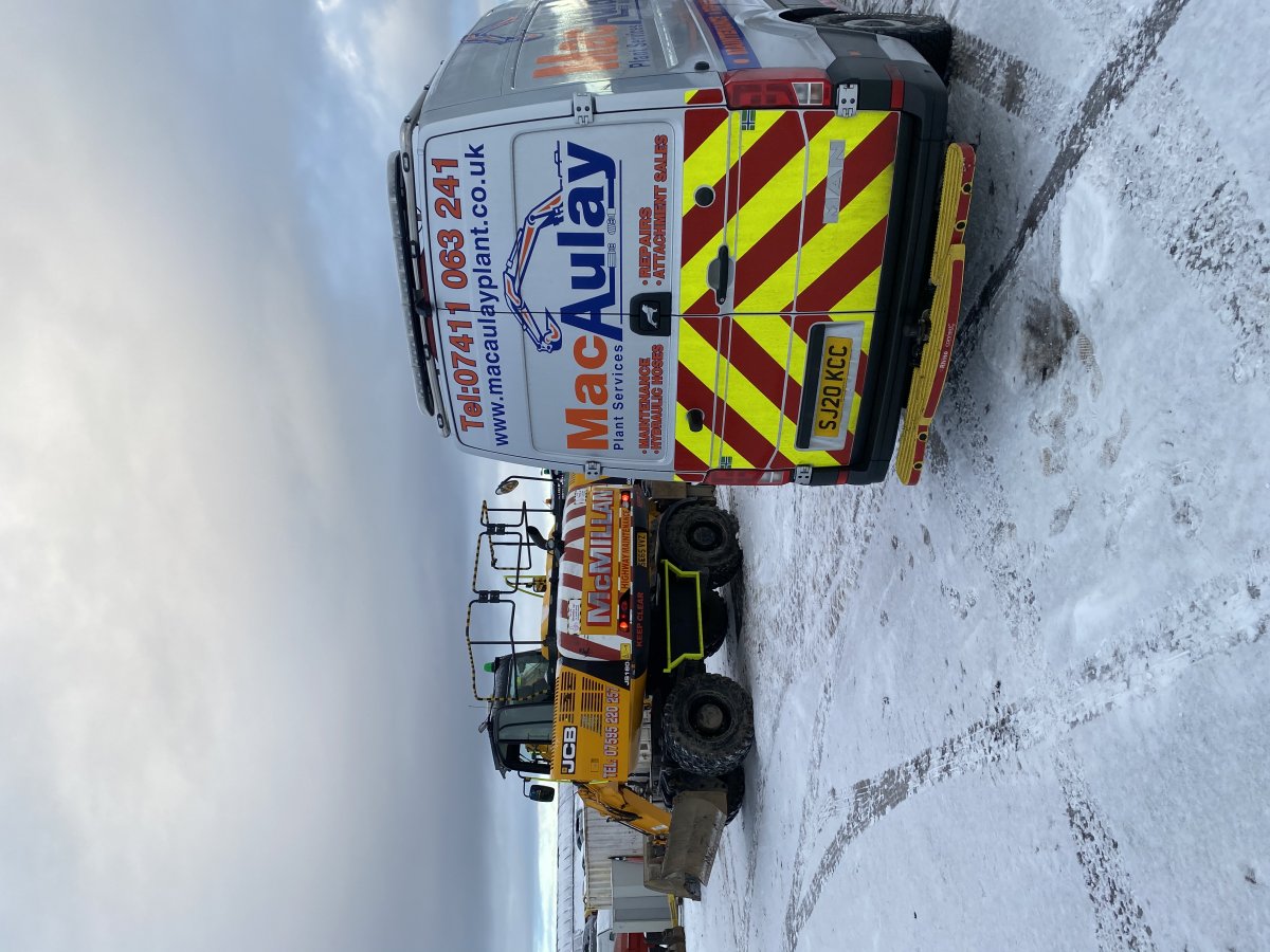

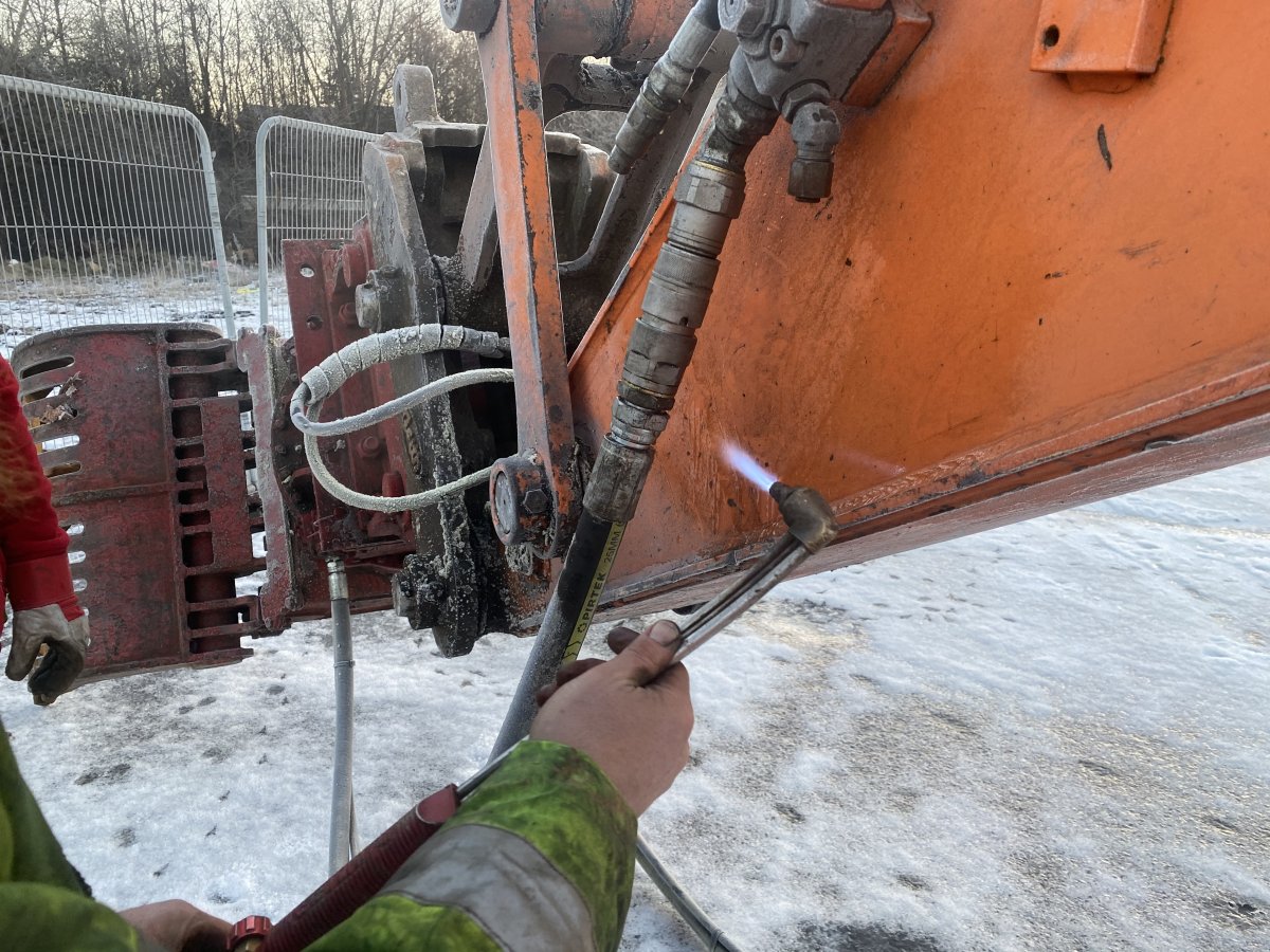

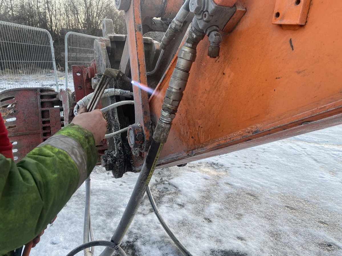

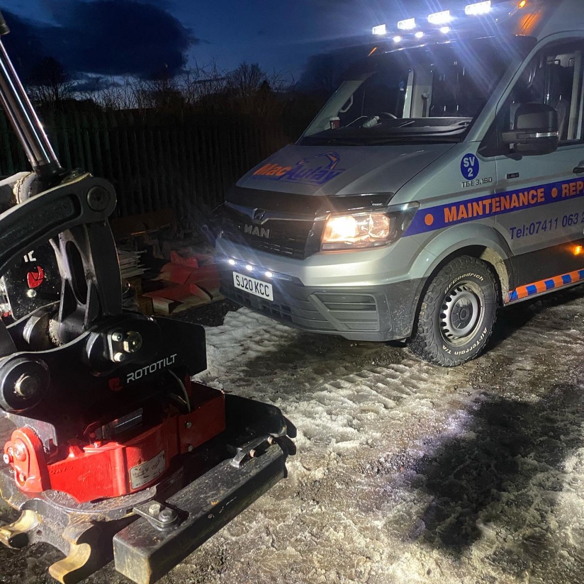

She’s been a bit cold,
Demo lads couldn’t get a selector grab of due to cold weather, quick fire up of the burner and she’s was off in jig time

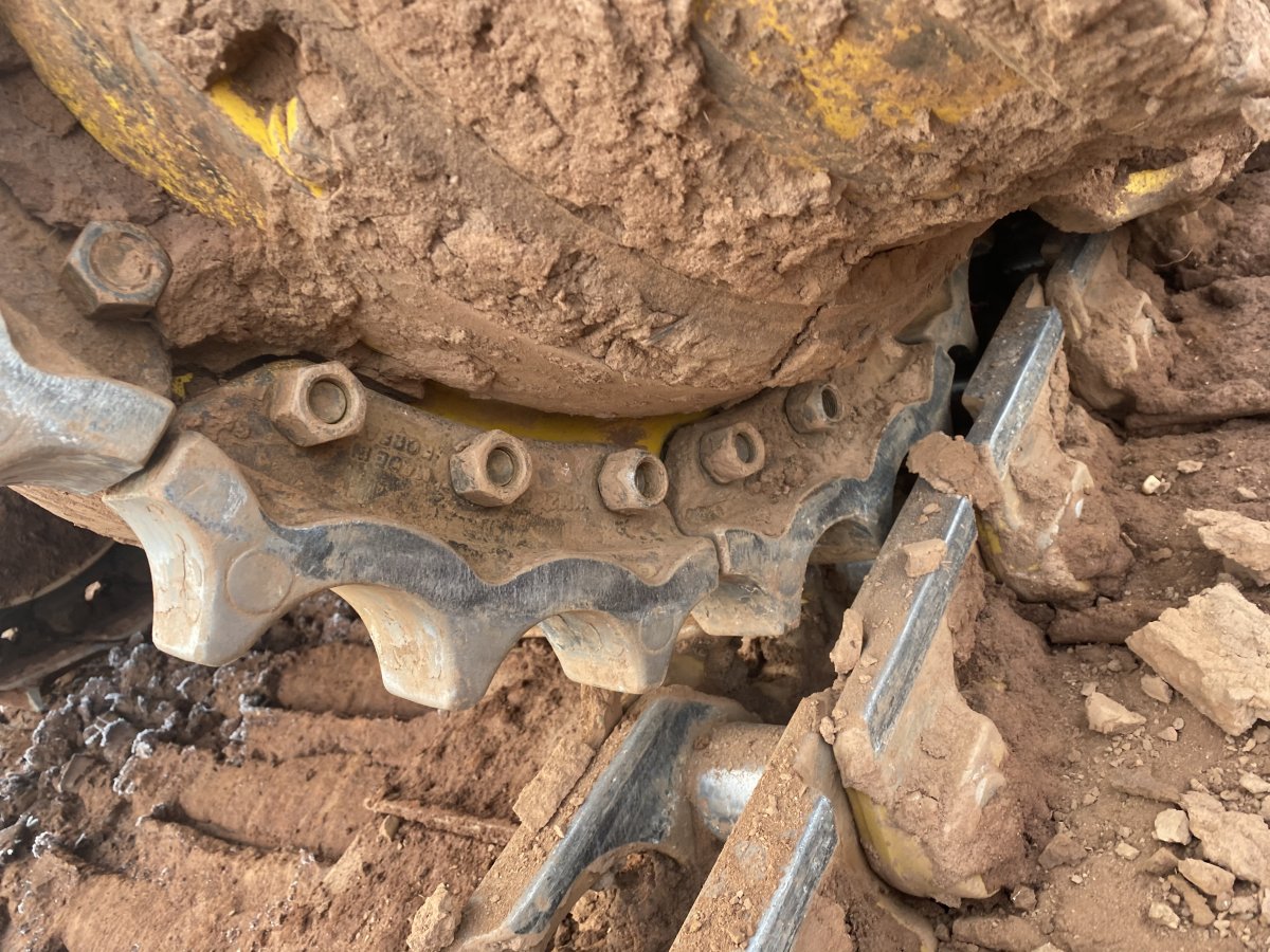

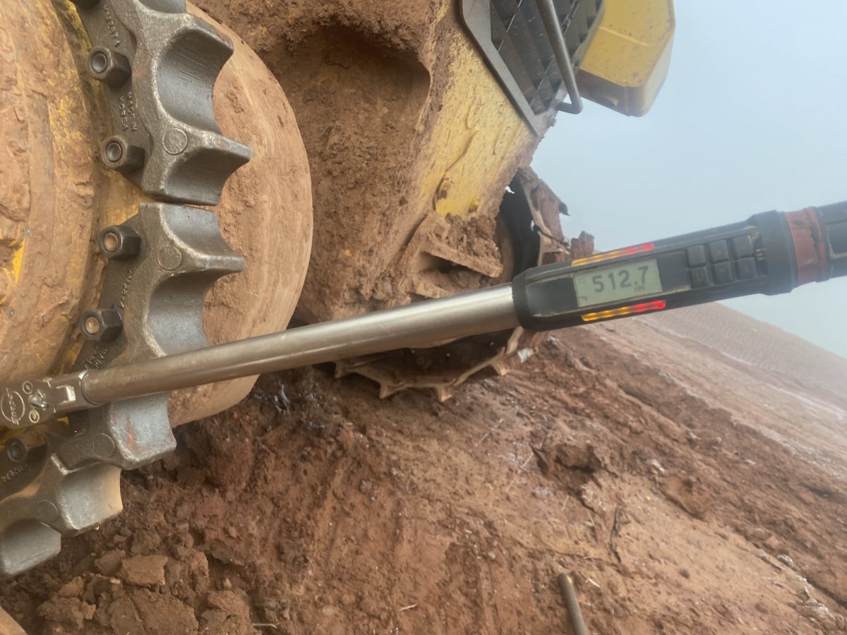

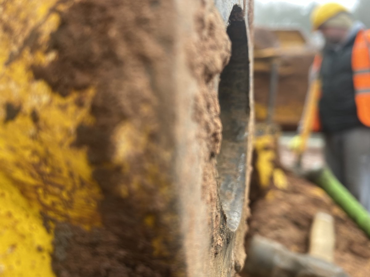

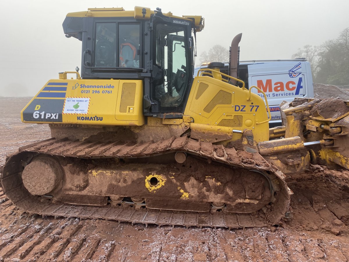

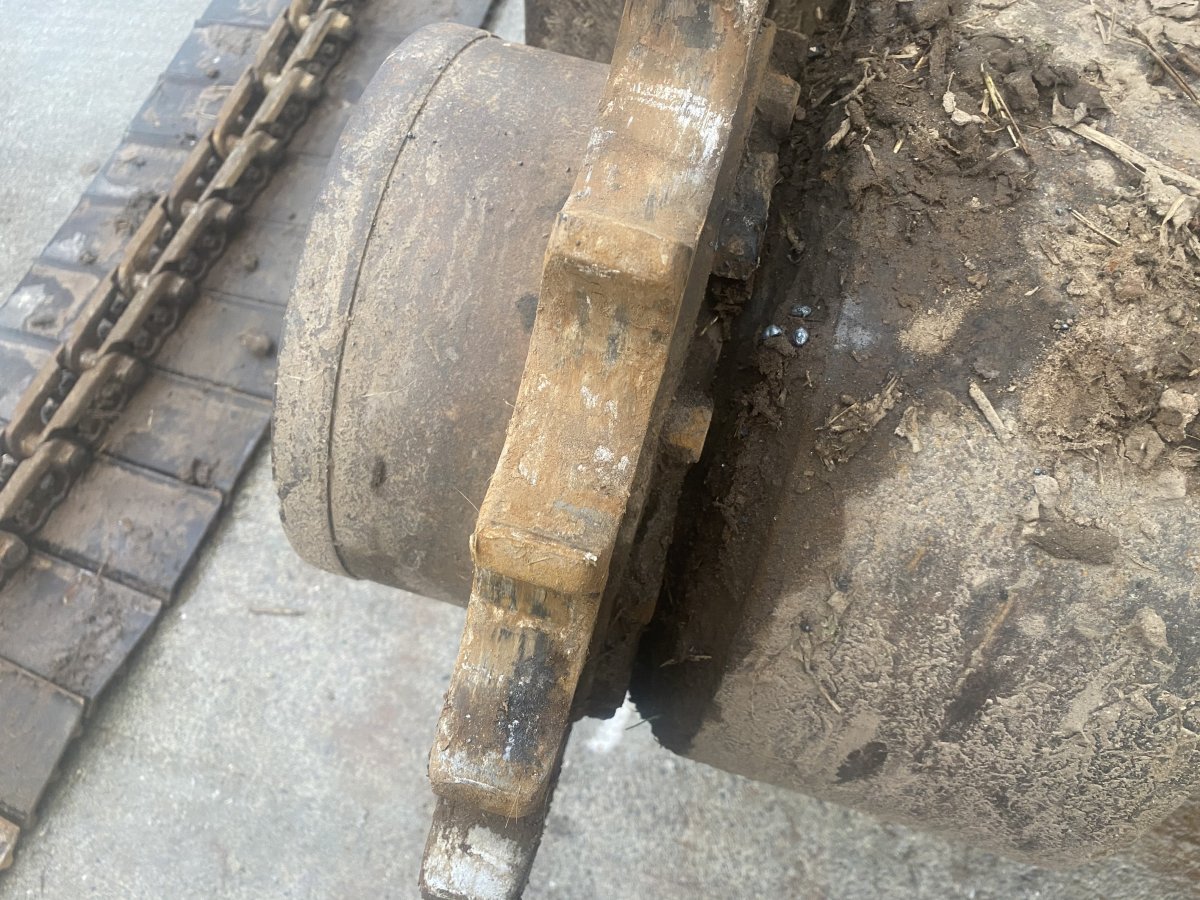

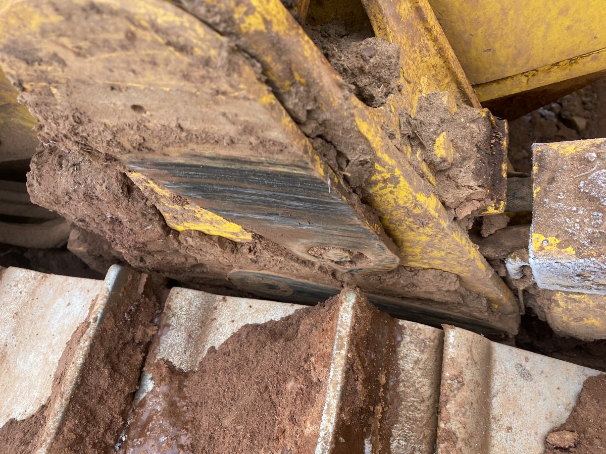

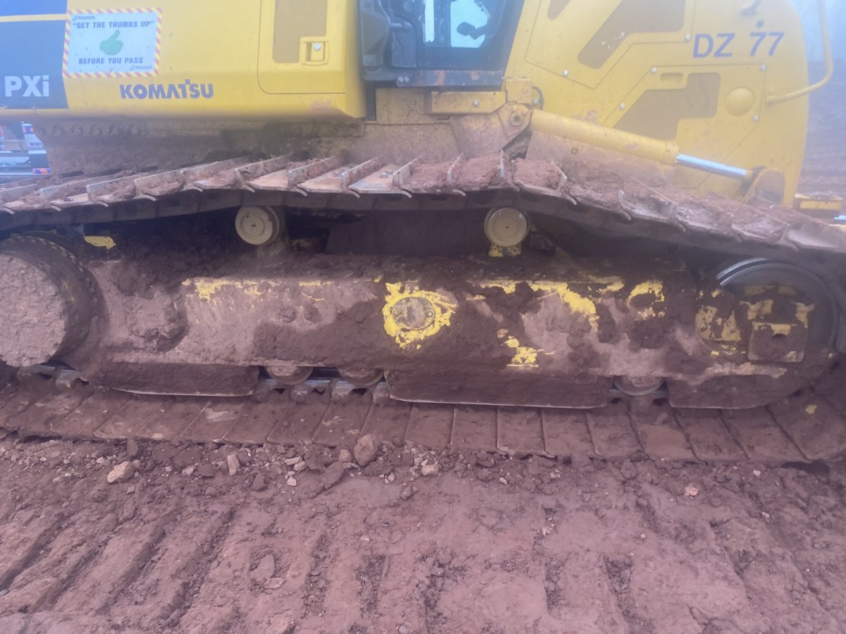

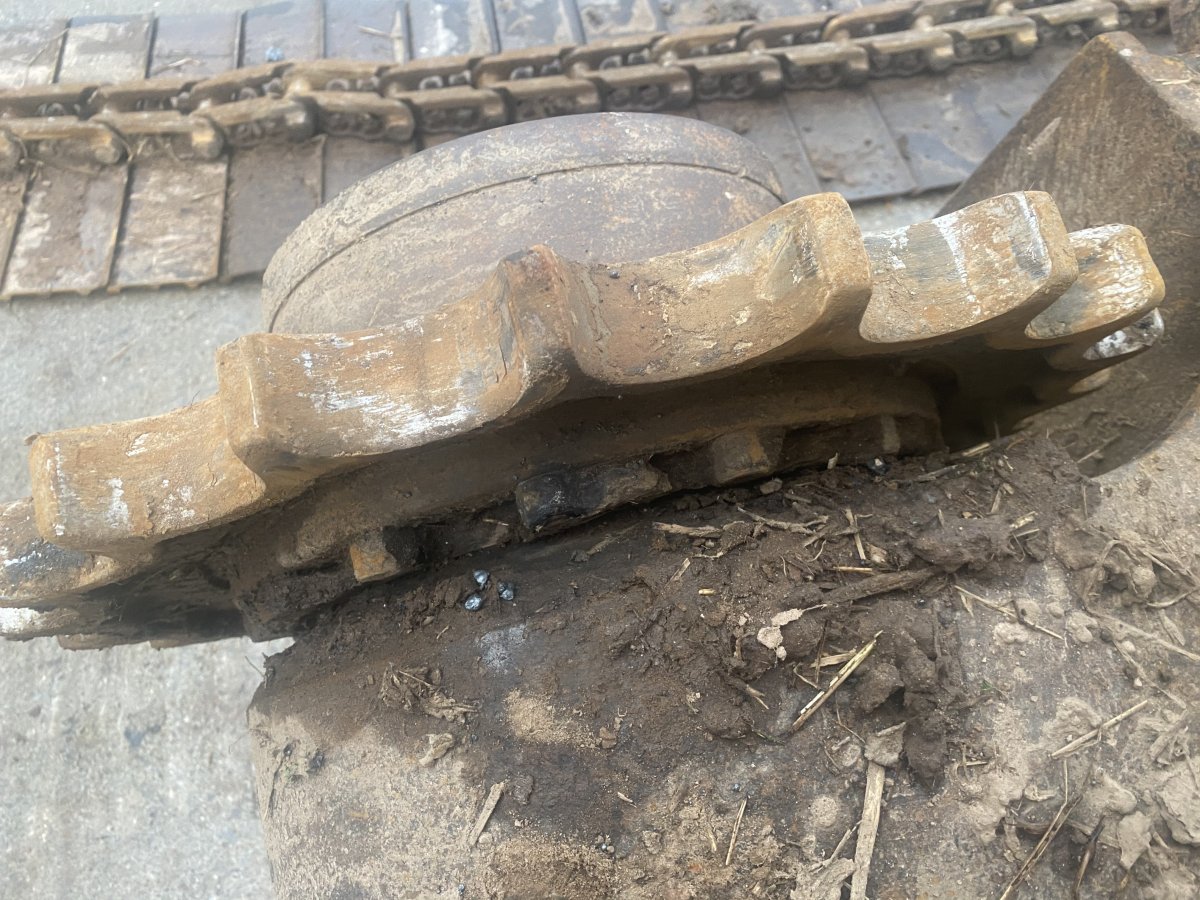

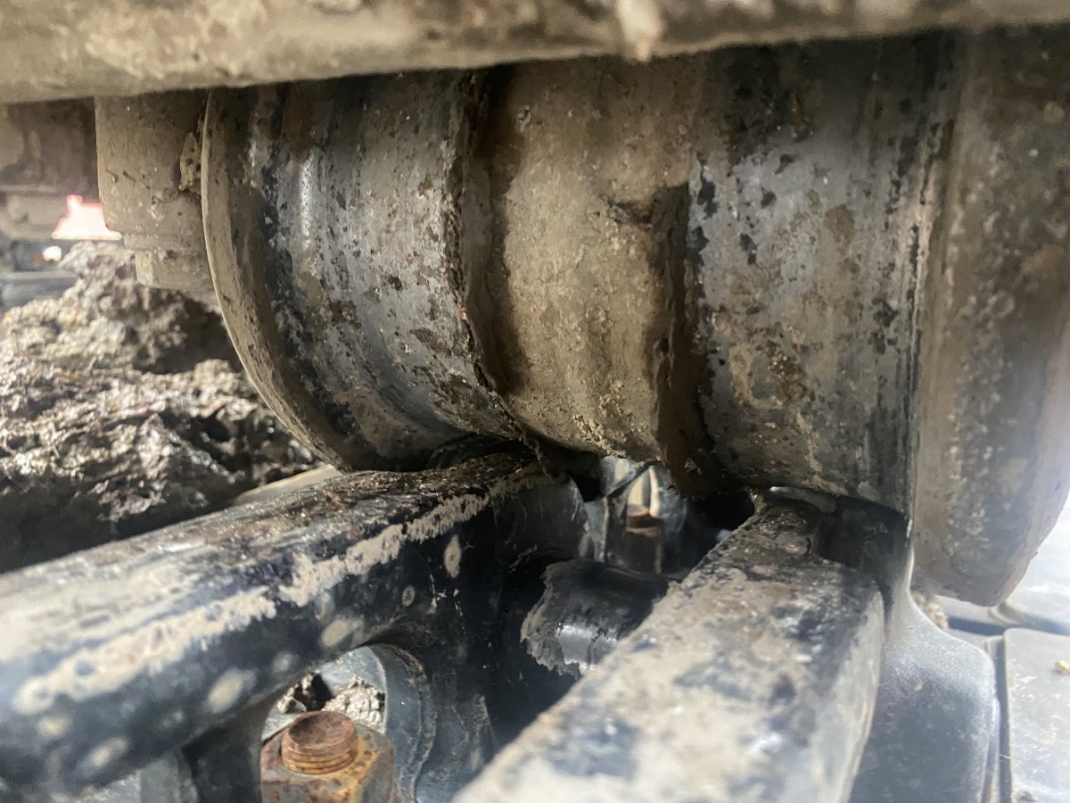

Run down to Coventry to repair this little D61 after another company installed the new undercarriage, in 80hours the roller worked themselves free and fell off and sprocket segments became slack.
we ended up replacing the top rollers and the segments
