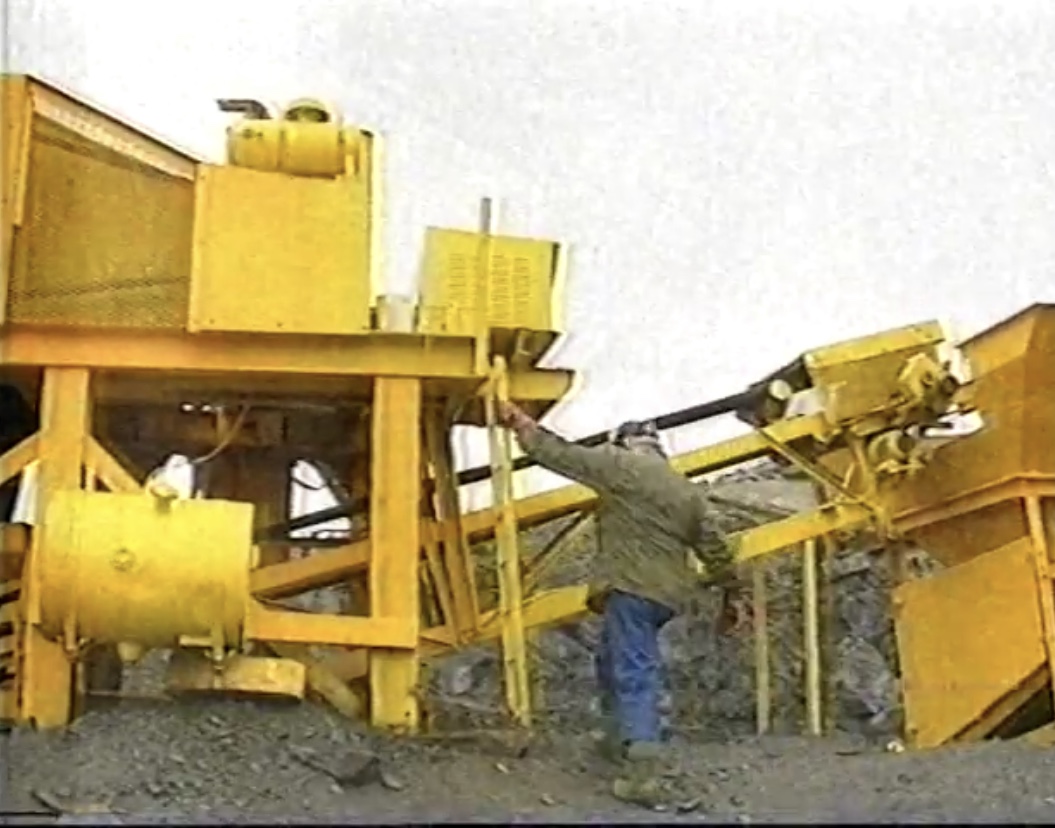

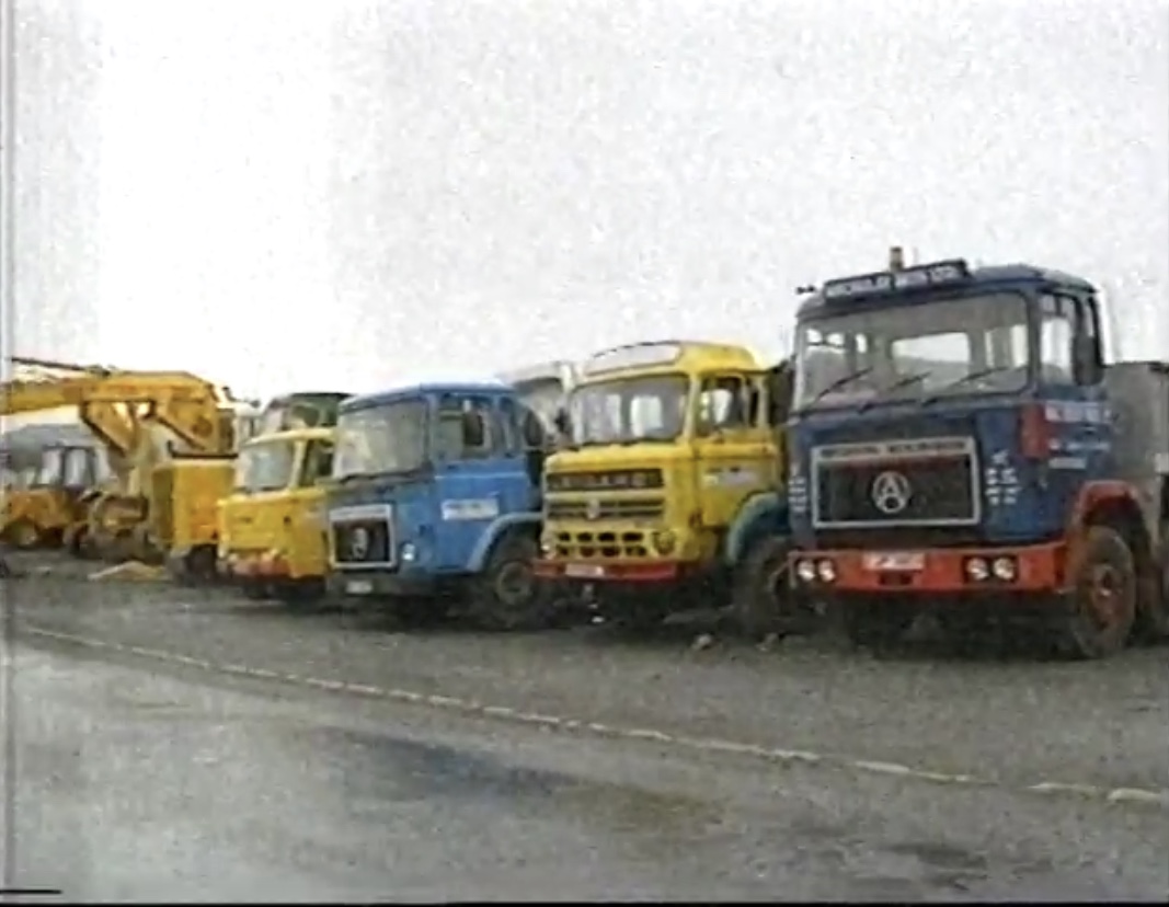

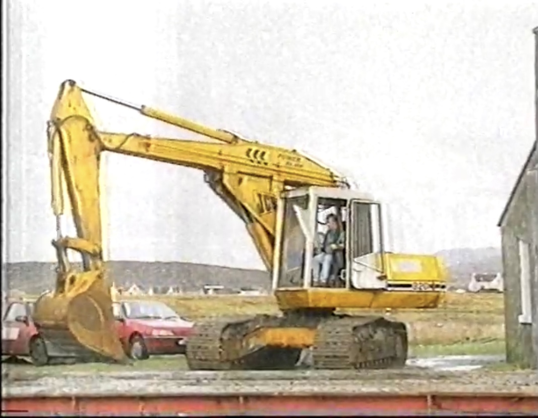

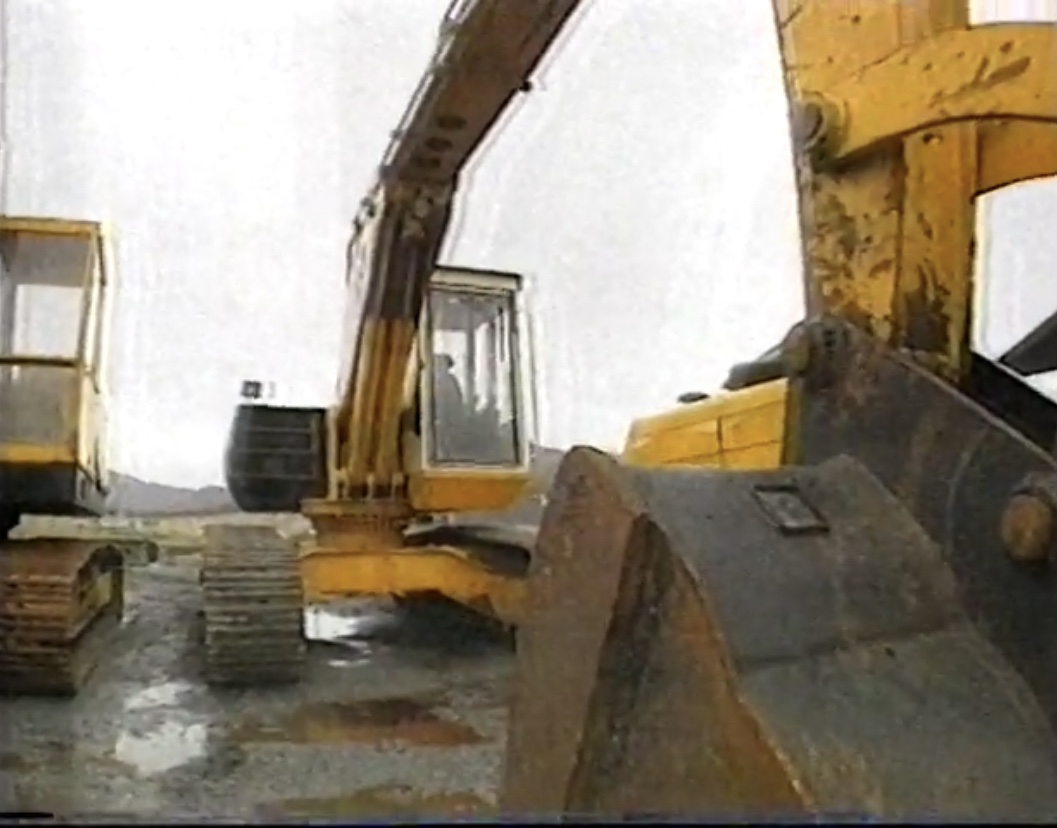

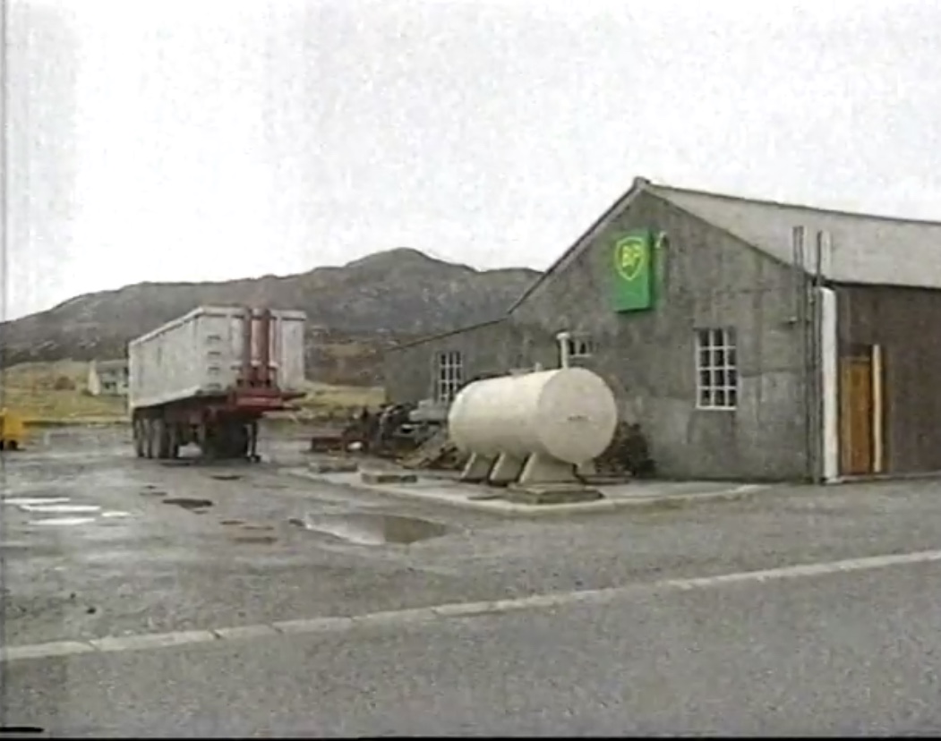

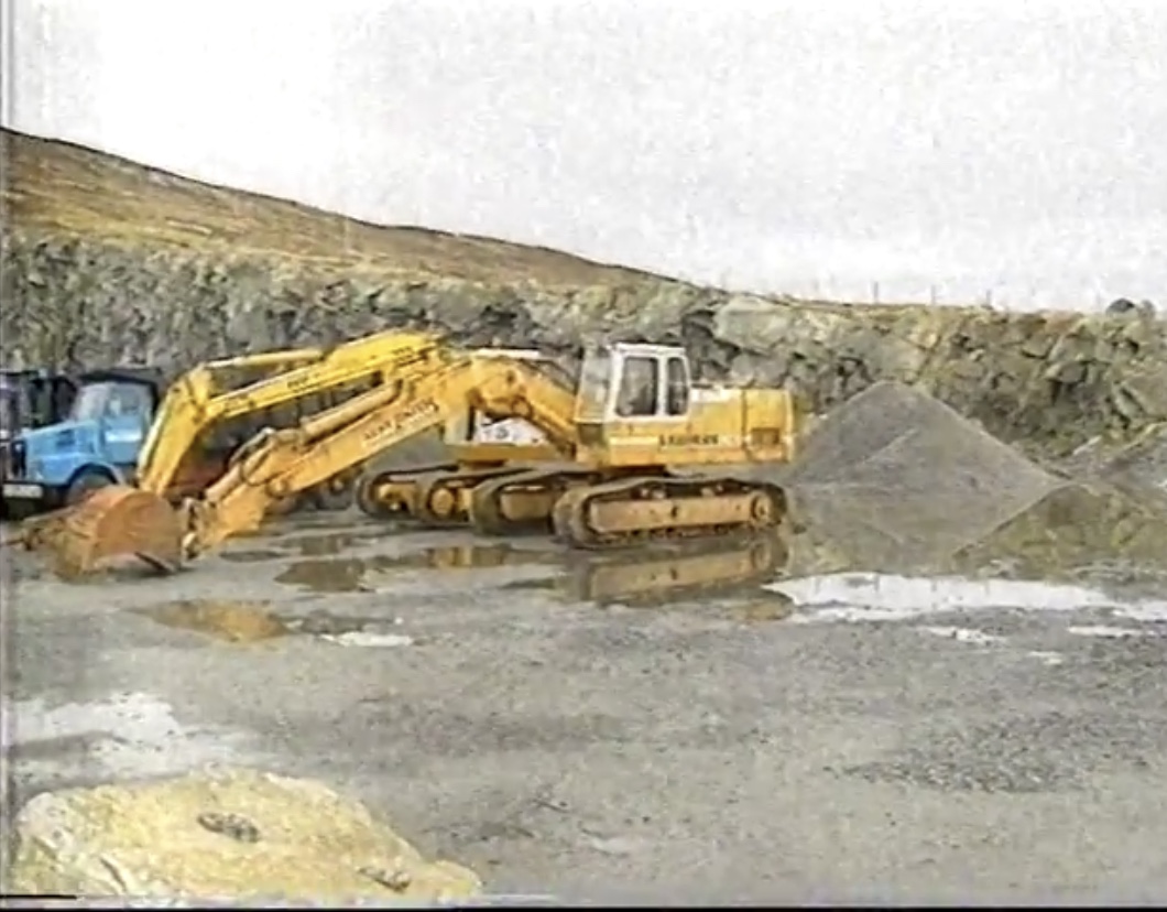

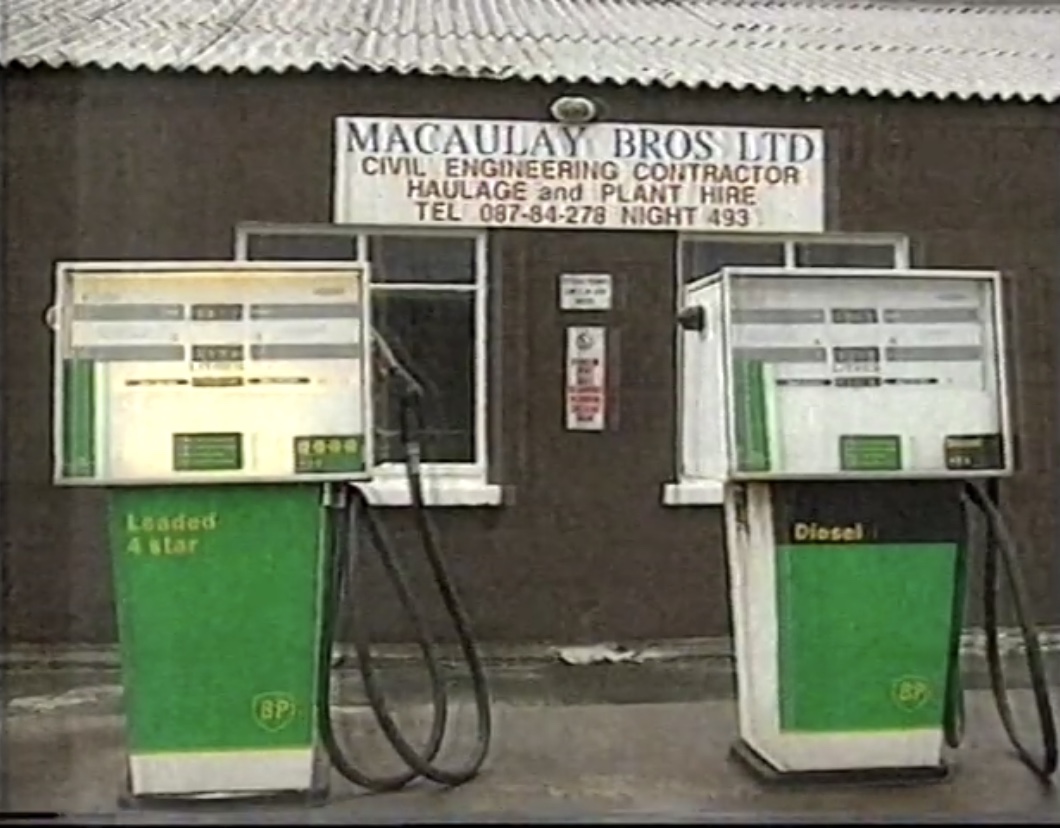

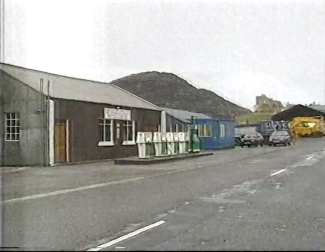

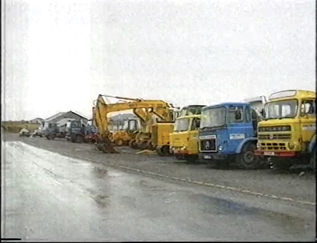

Found some of these photos of when my grandpa ran the business in 1992,
He ran Hymac 580c, Jcb 814, 820 and liebherr 942 with Two piece boom, ran 22 trucks at his peak just before the BCCI banking disaster and unfortunately had to pay off 90% of his workers

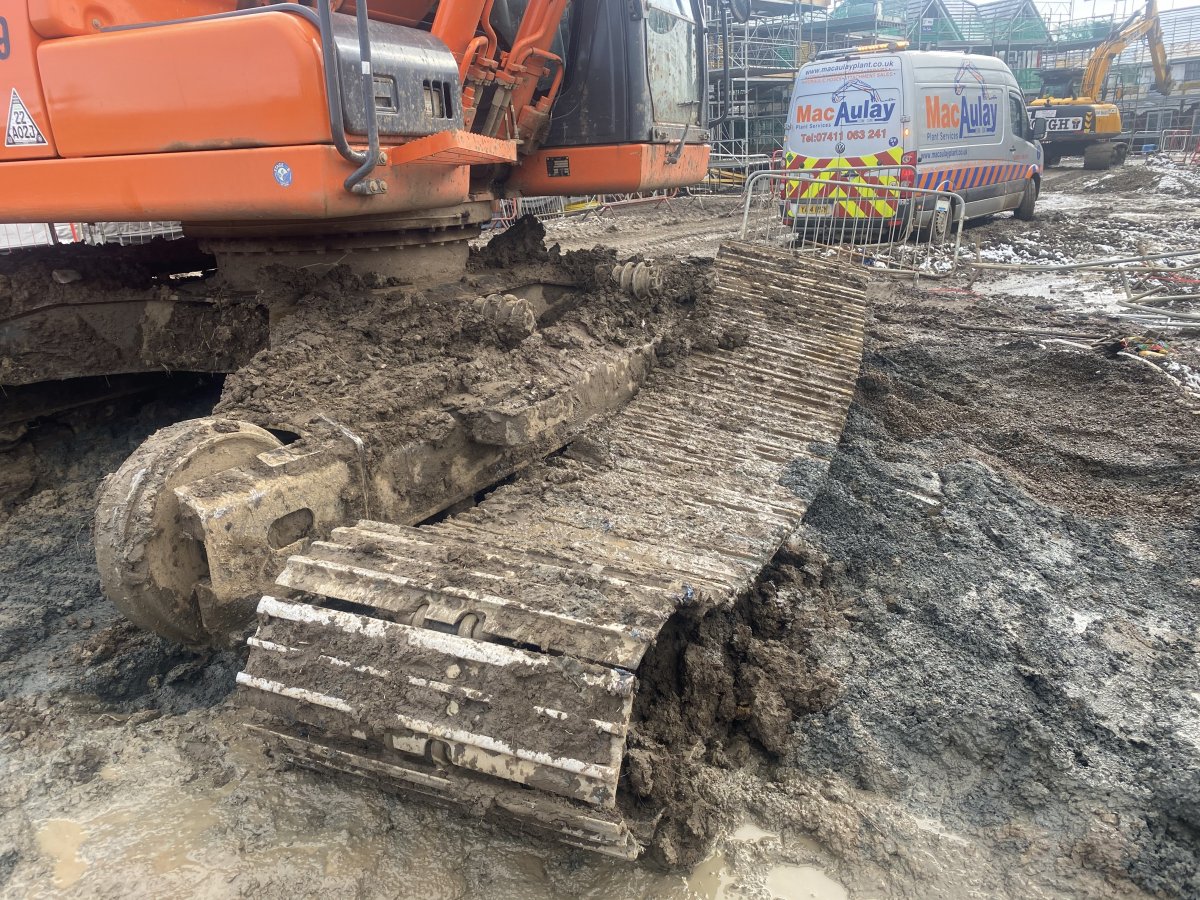

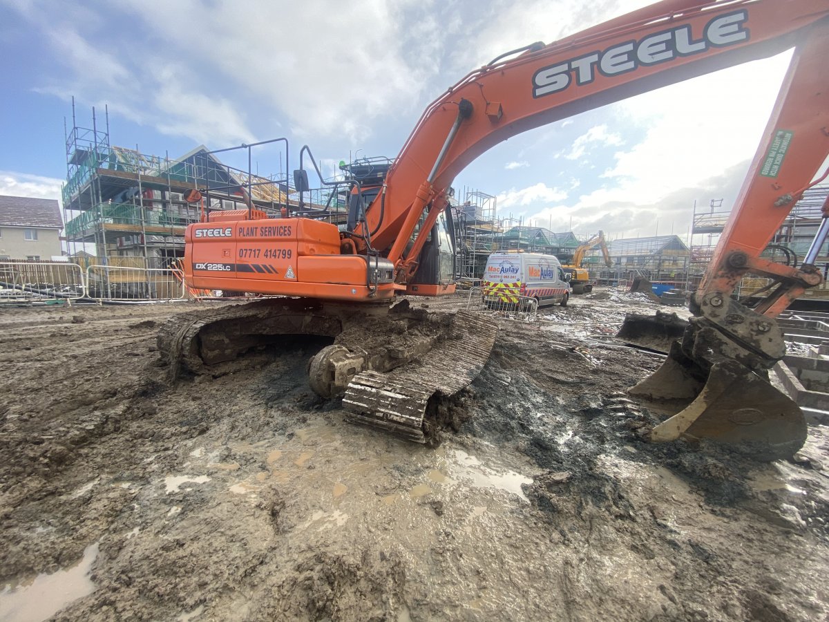

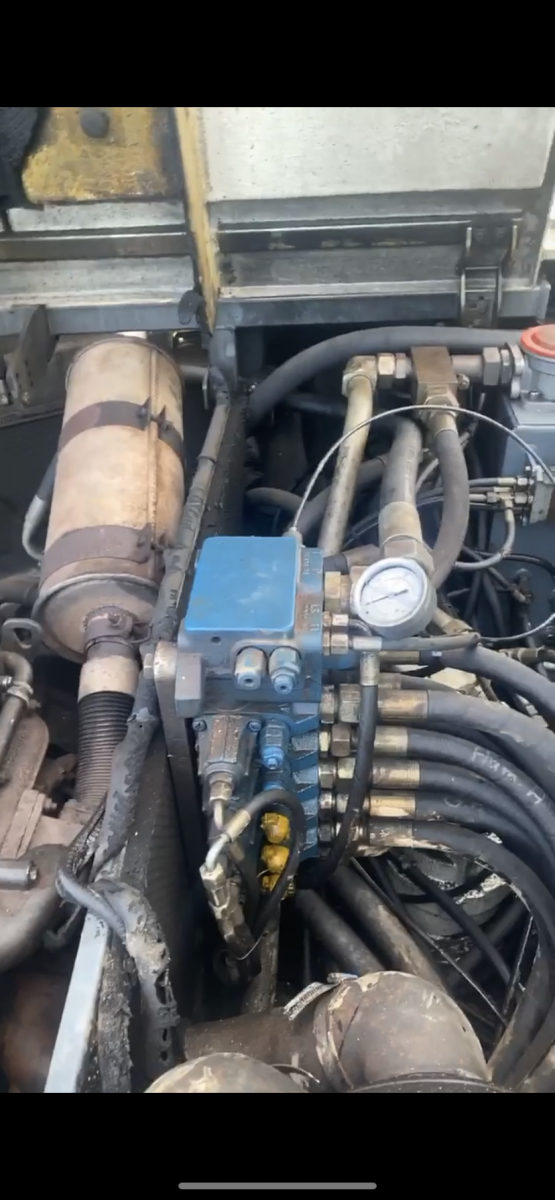

Doosan that kept throwing the track and setting up pressures on Terex duck after someone was messing around with it

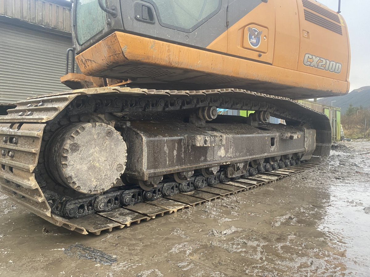

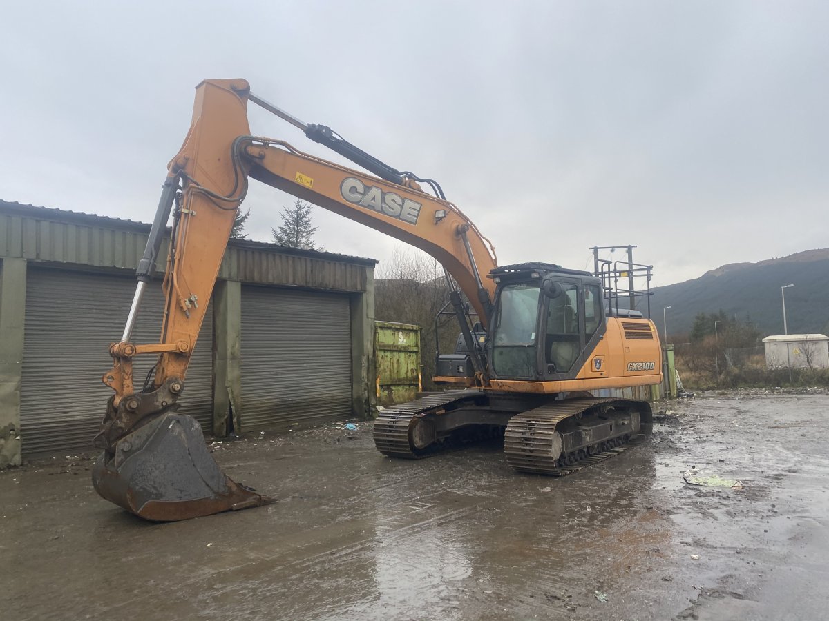

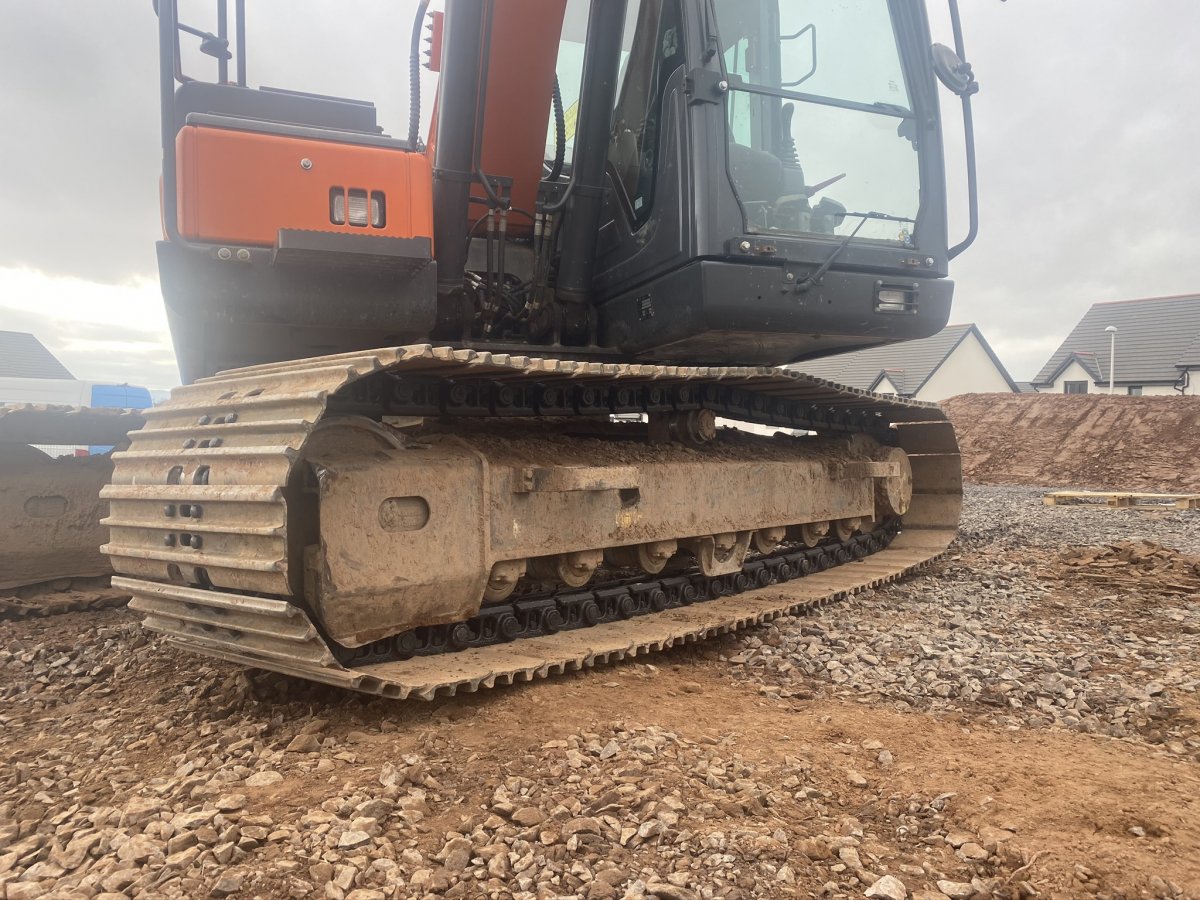

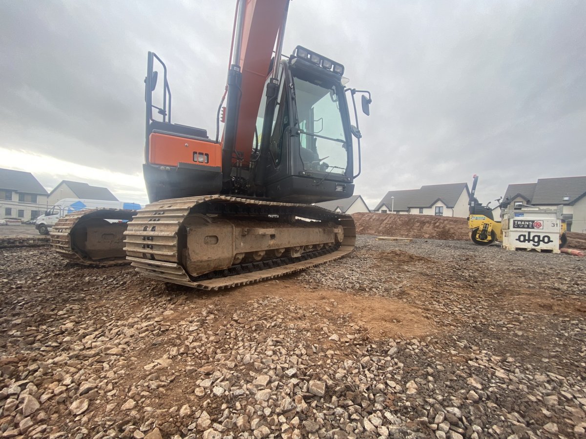

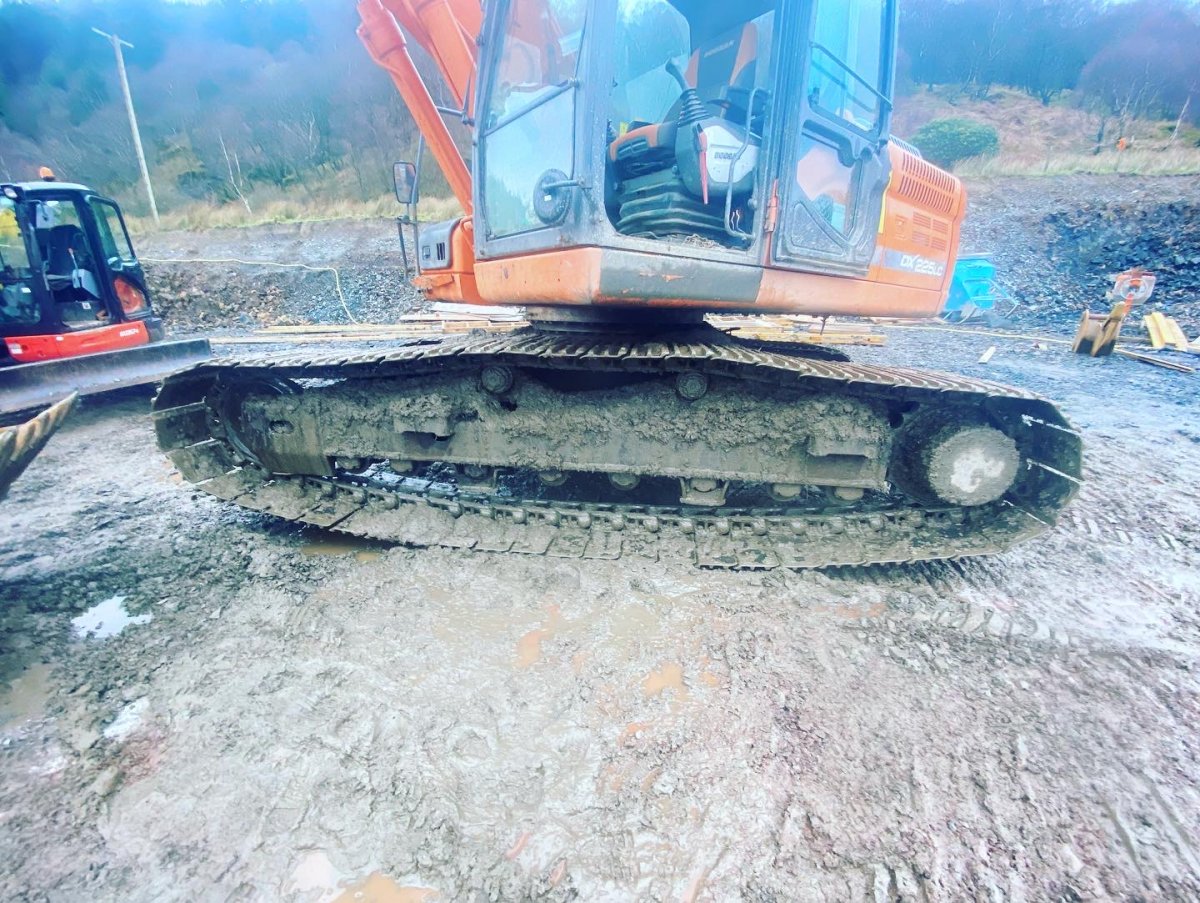

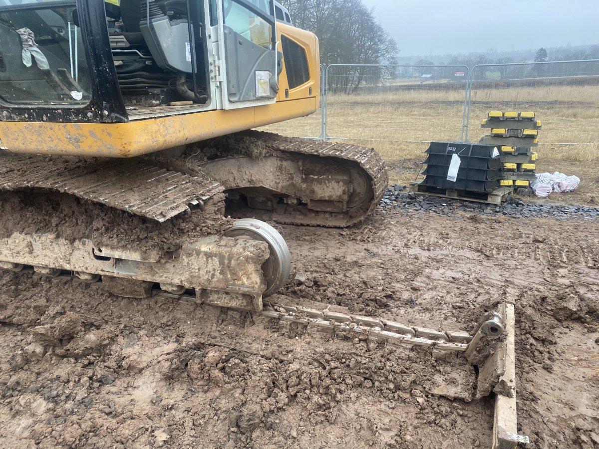

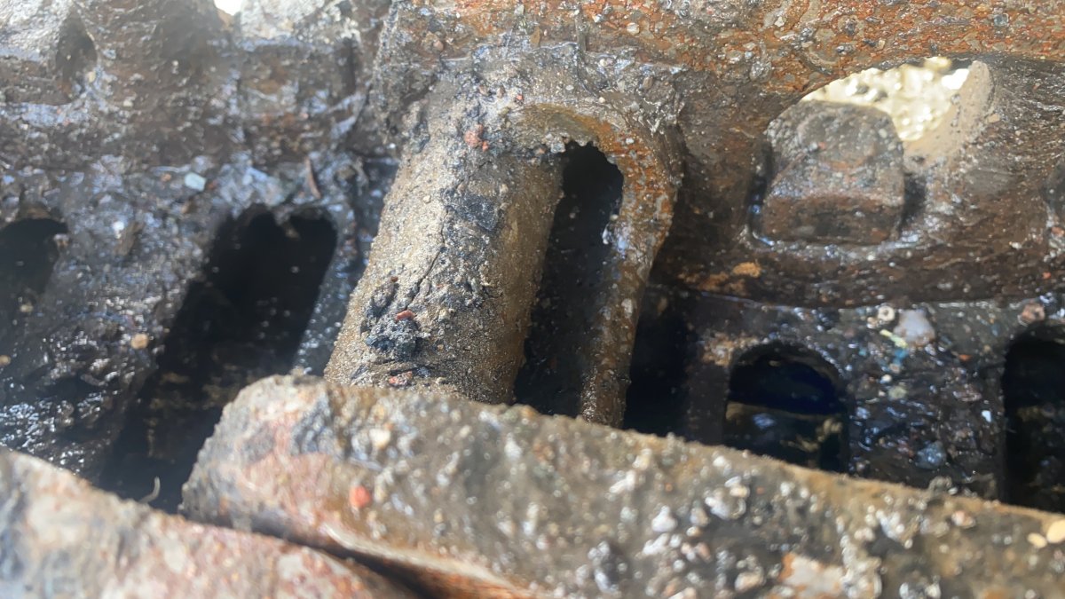

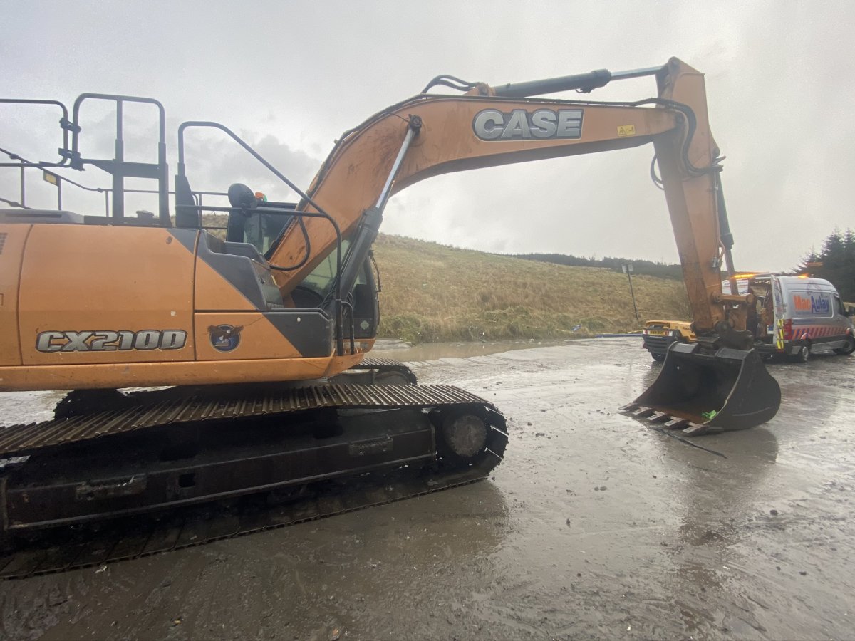

Case CX210D that we went to change sprockets and rollers but found chains behind service life so these were replaced following week

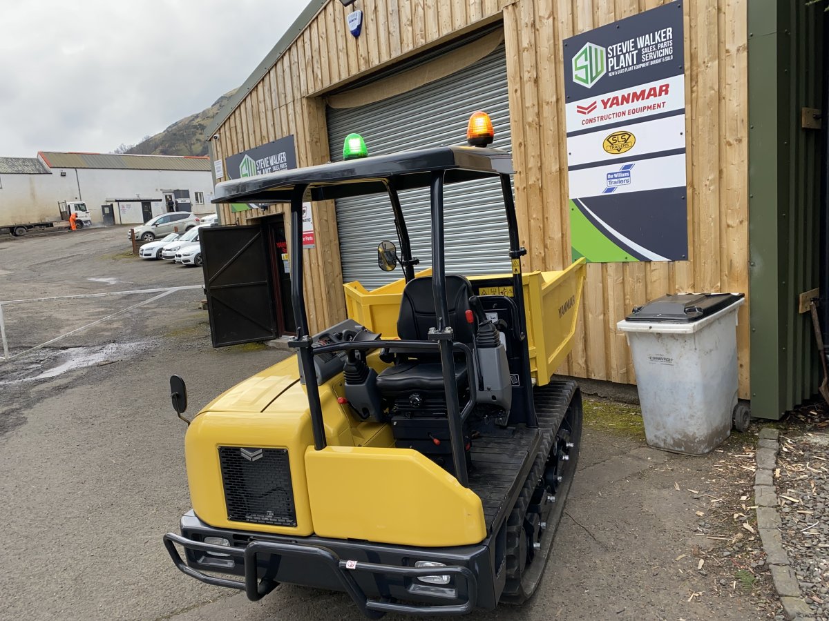

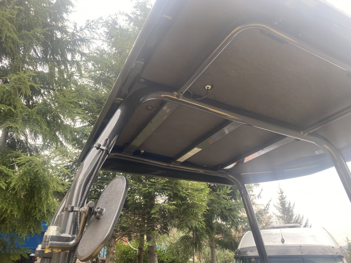

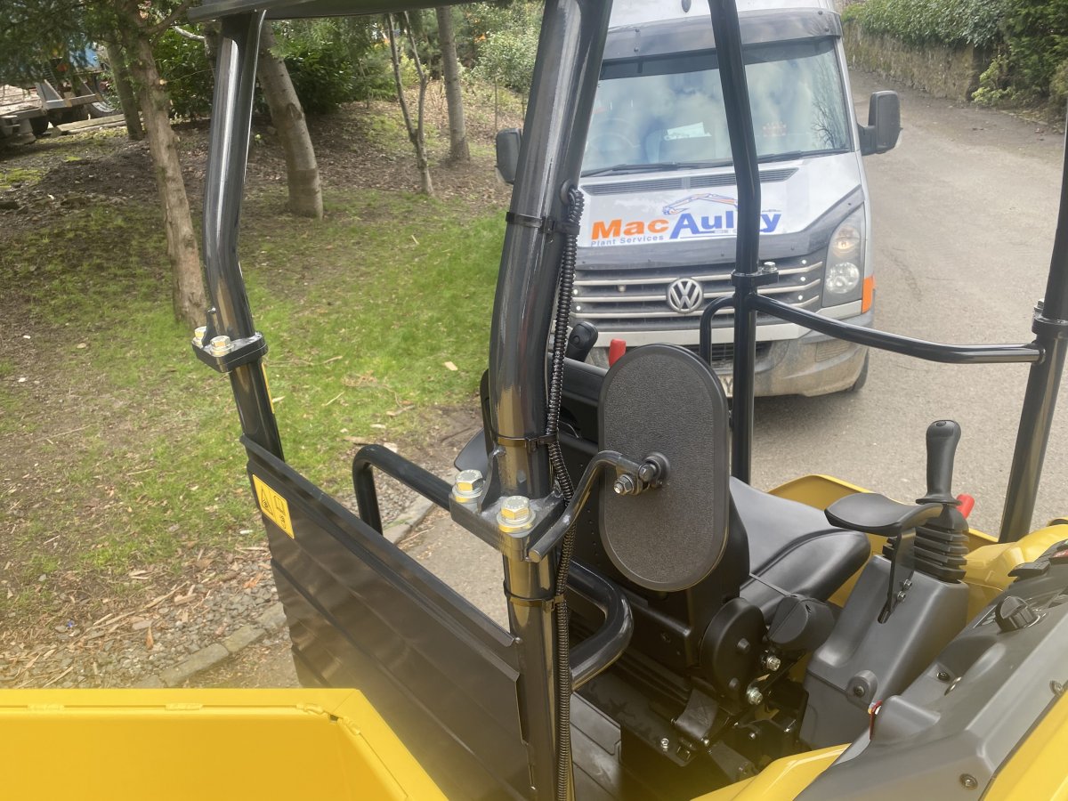

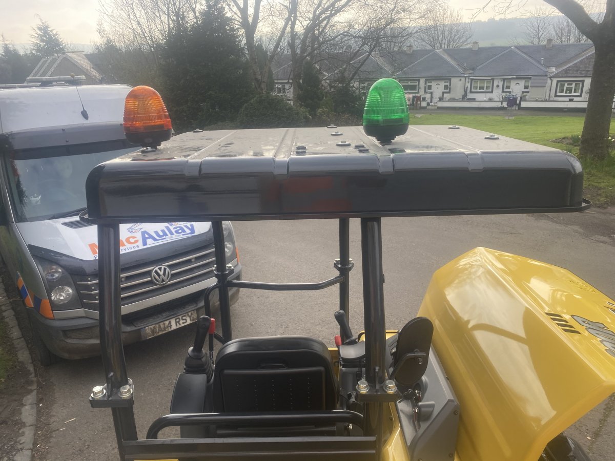

Amber and green seat belt beacon kit wired in and wired into both safety deadman levers

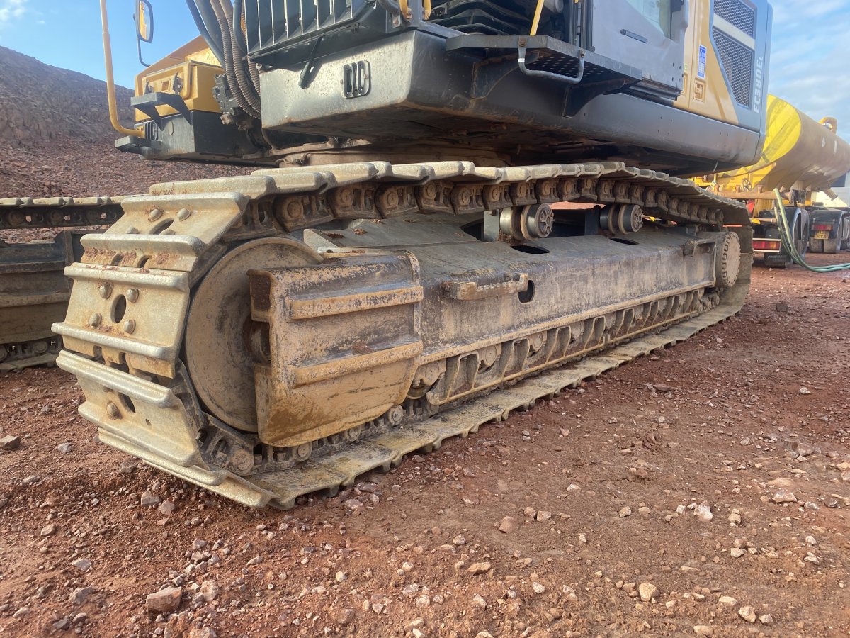

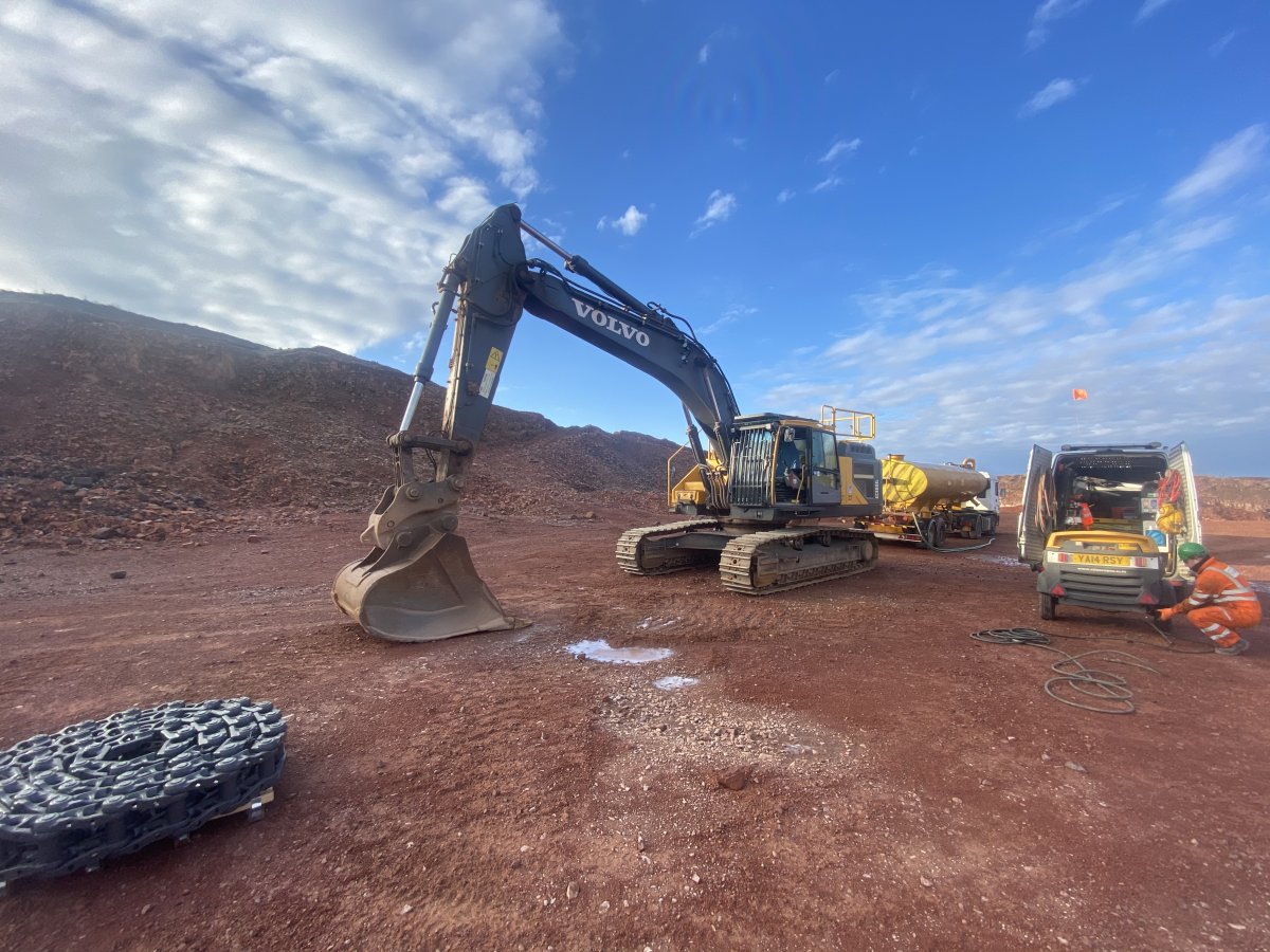

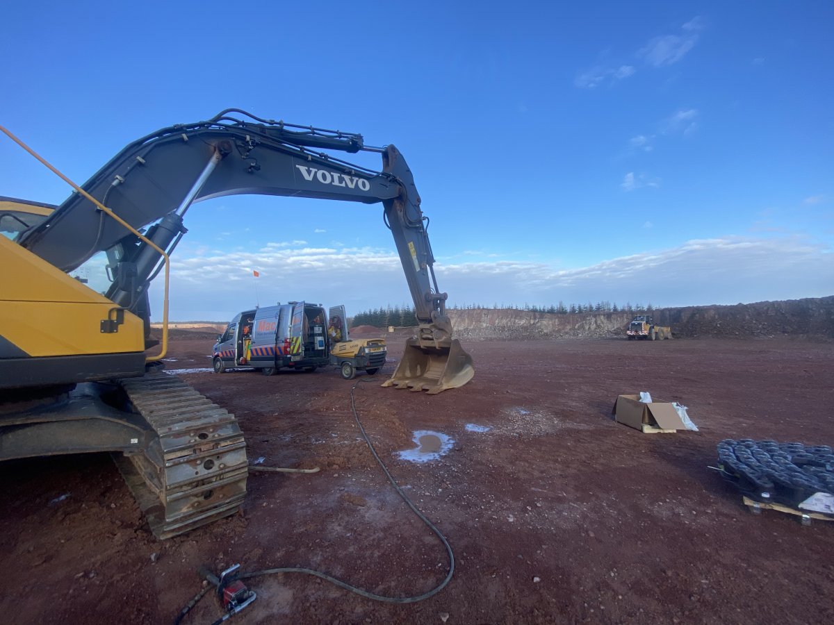

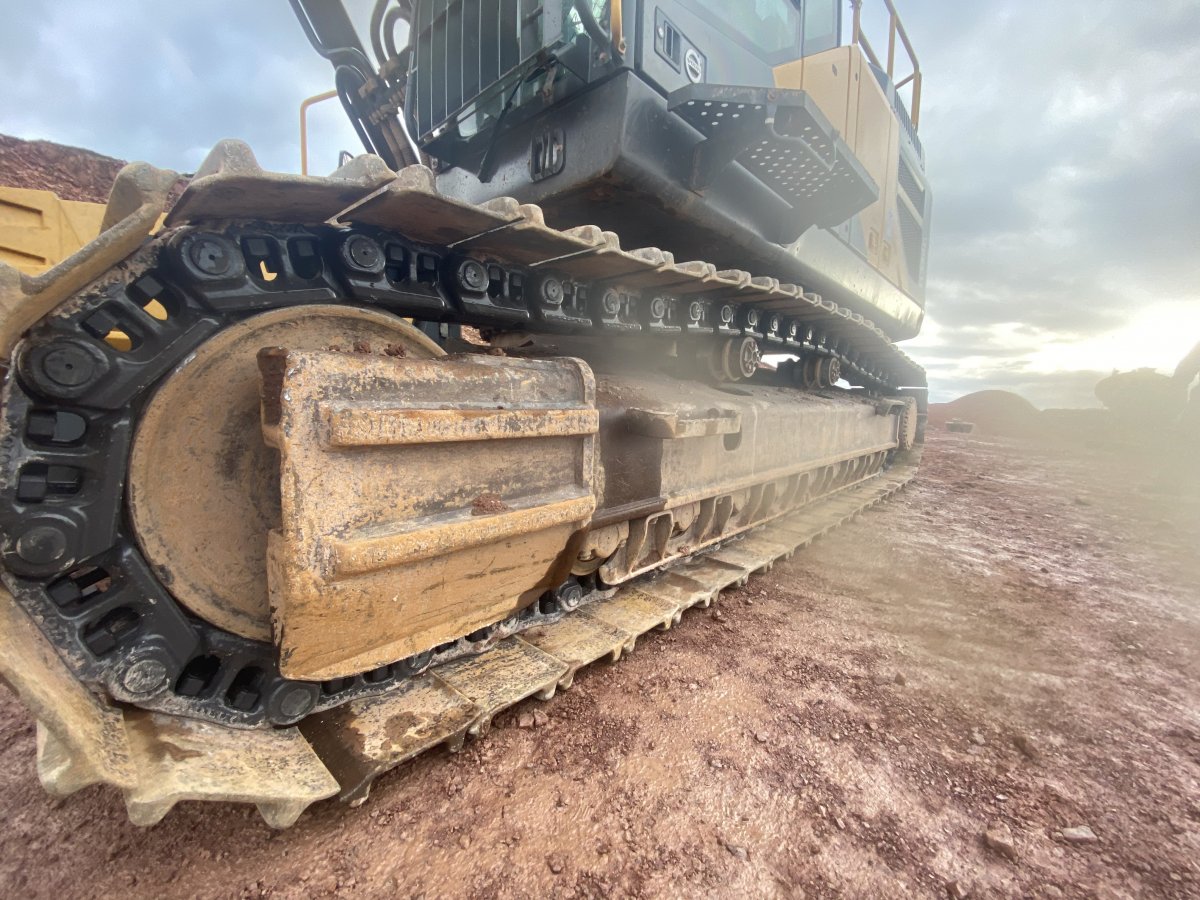

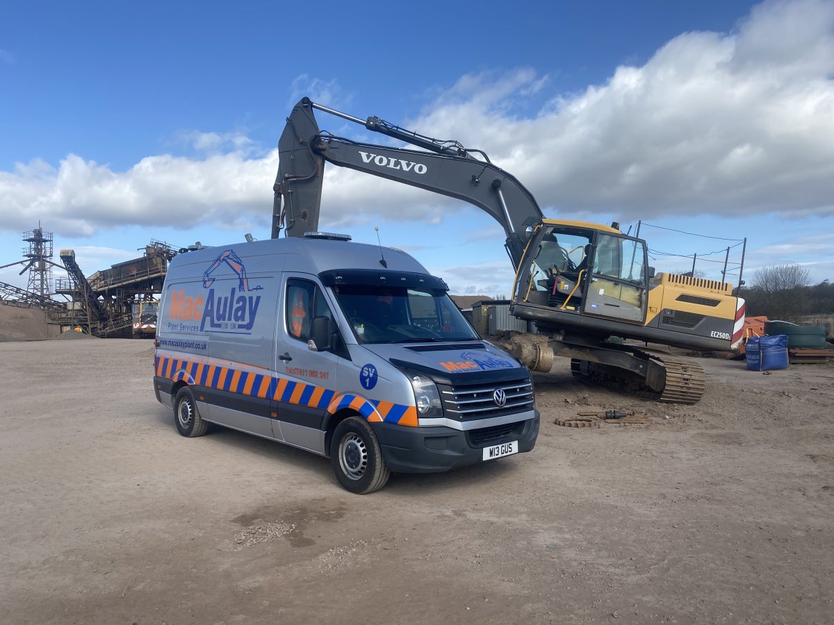

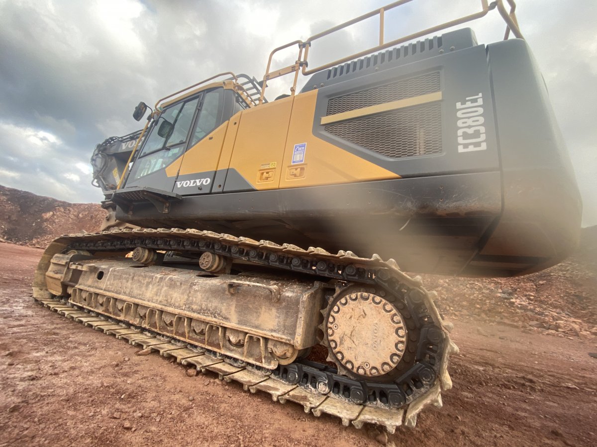

Pad swap and full set of chains on this Volvo EC380E on behalf of SMT Stirling

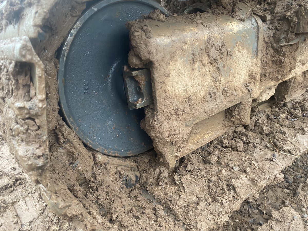

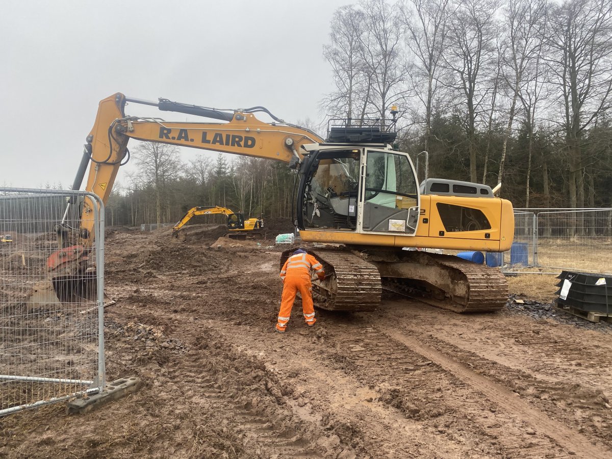

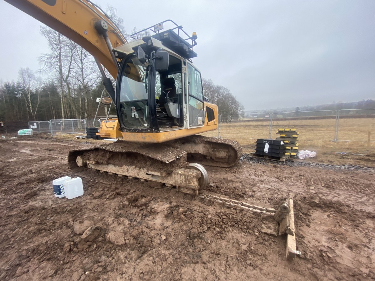

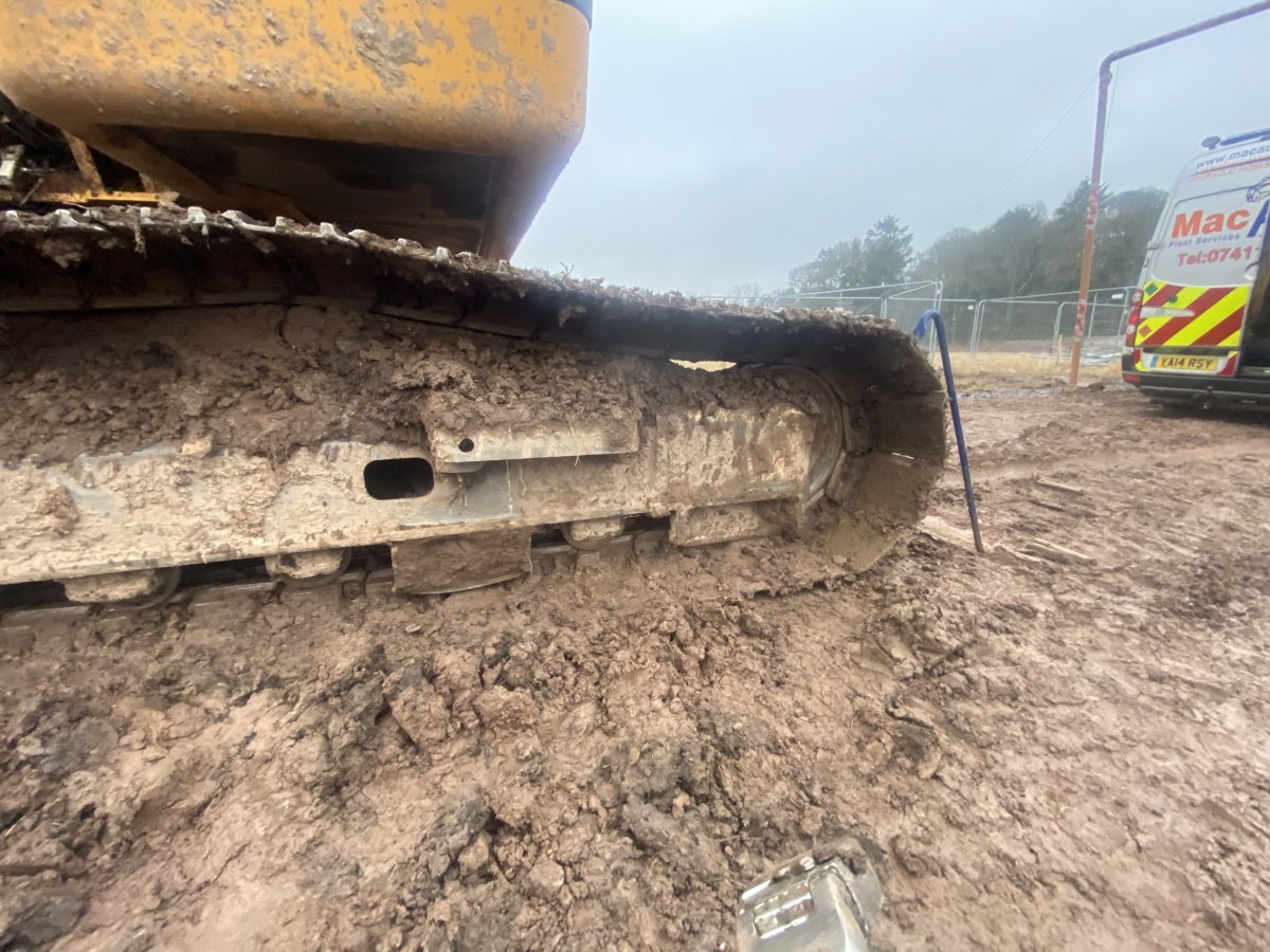

New idlers on Liebherr 922, could do with a link or 2 out 🤔

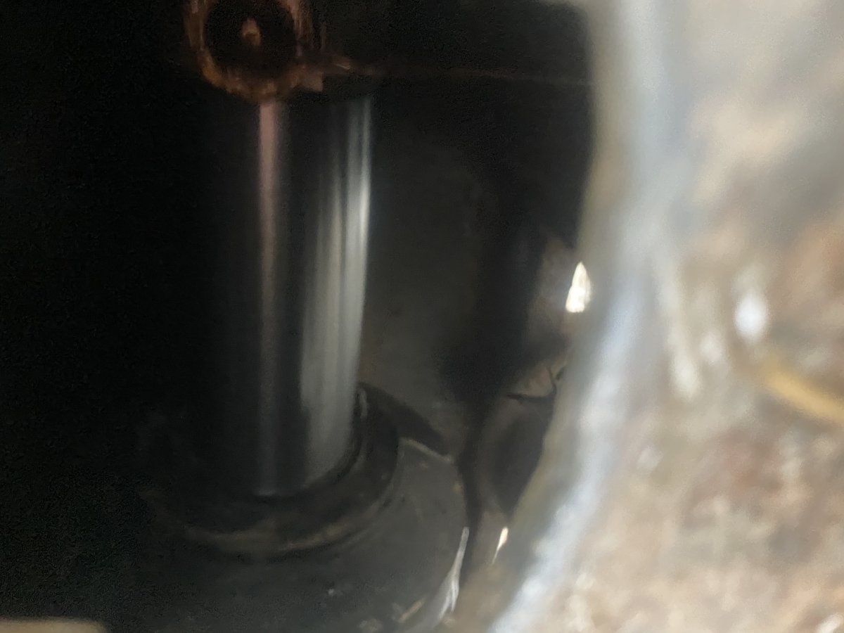

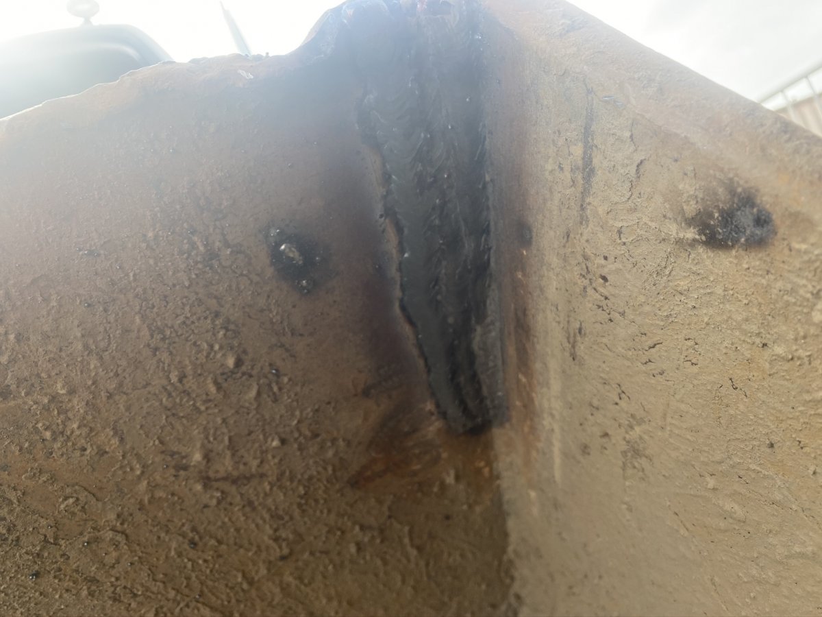

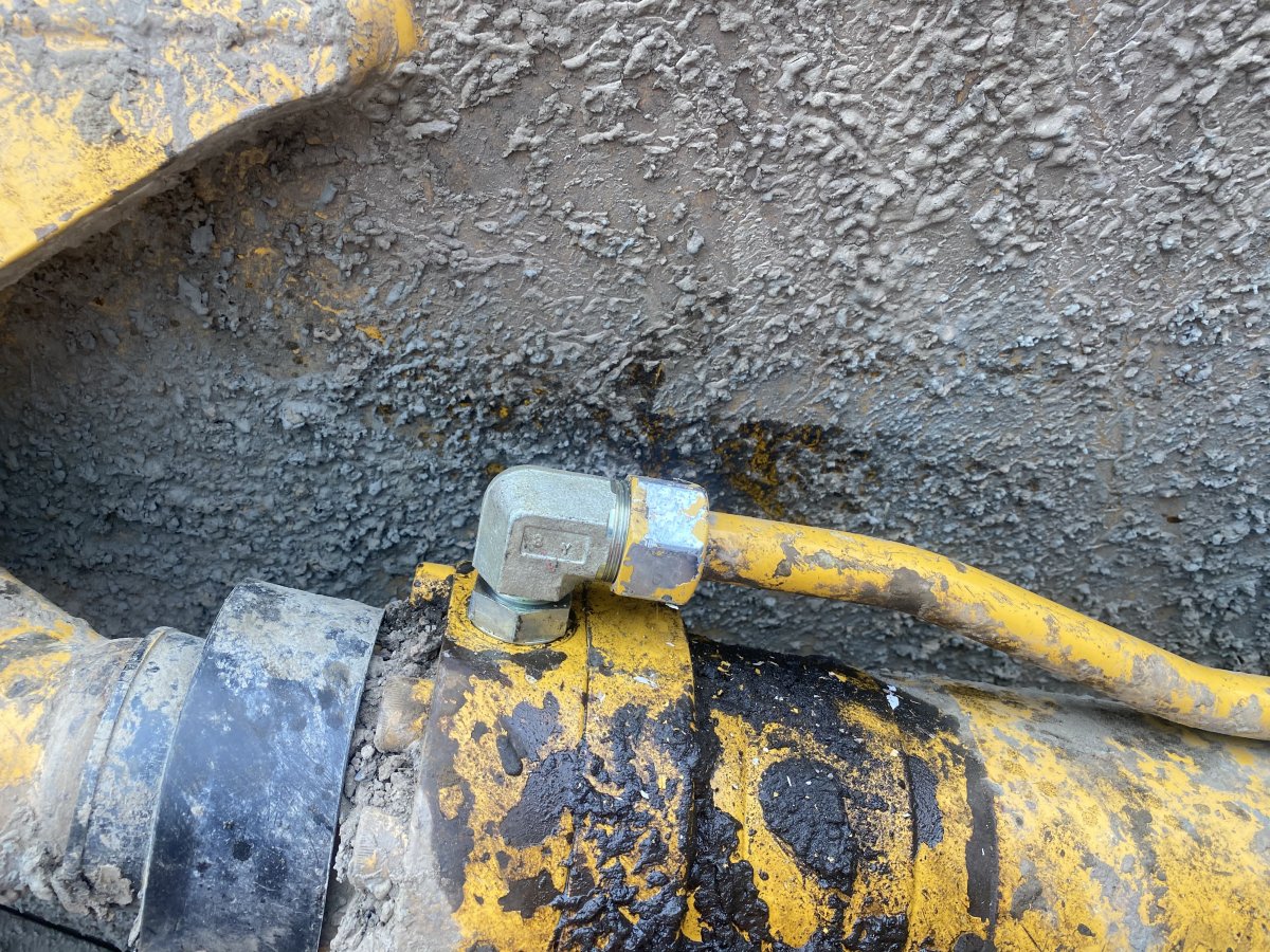

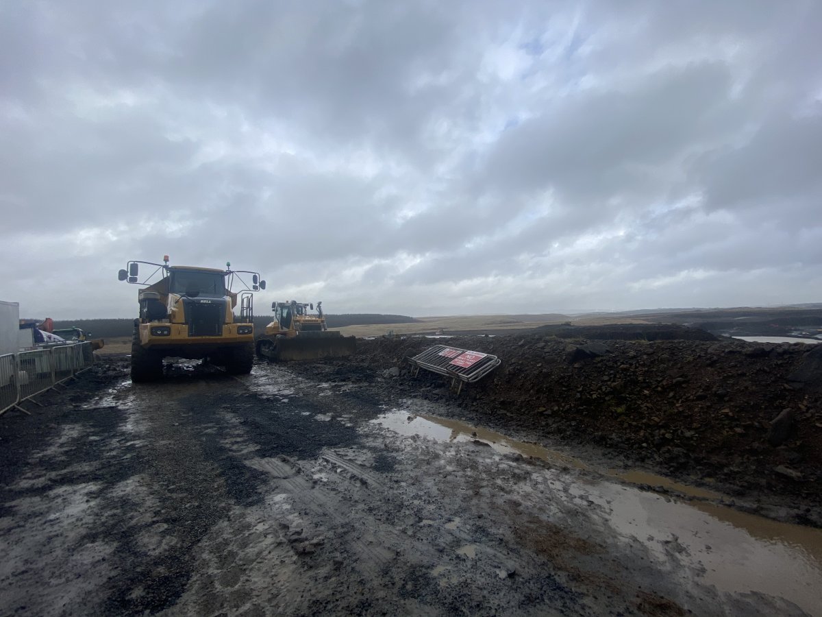

Rock fell and damaged the 90 compact on bell B40D tipping ram.

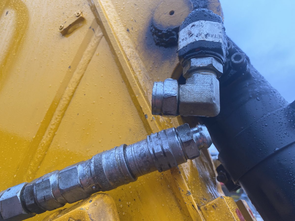

Bucket ram hose caught on piles and pulled adapter apart,
More bell repairs.
Bucket cutting edge turn.

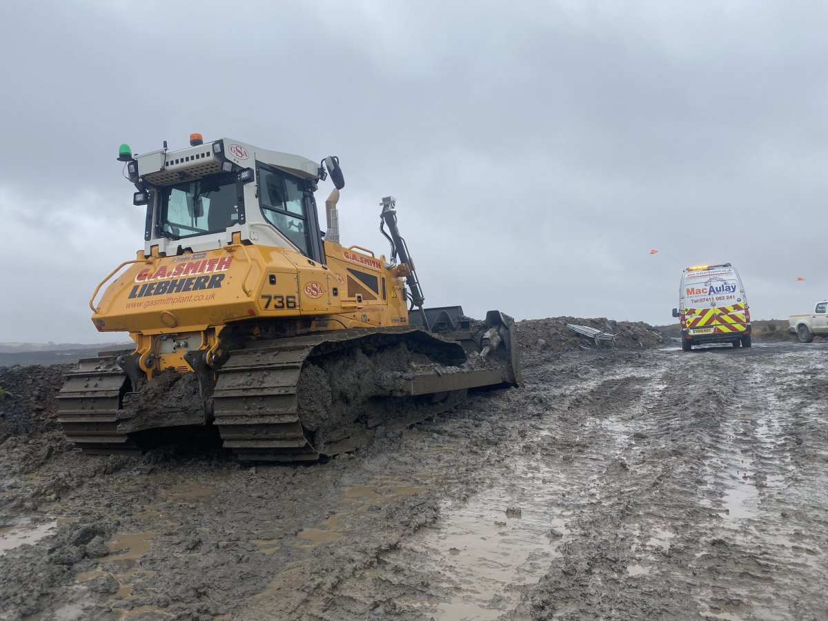

Liebherr repairs to blade

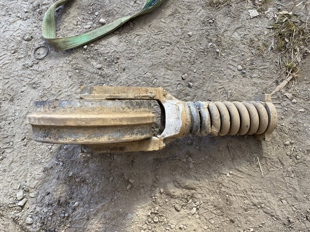

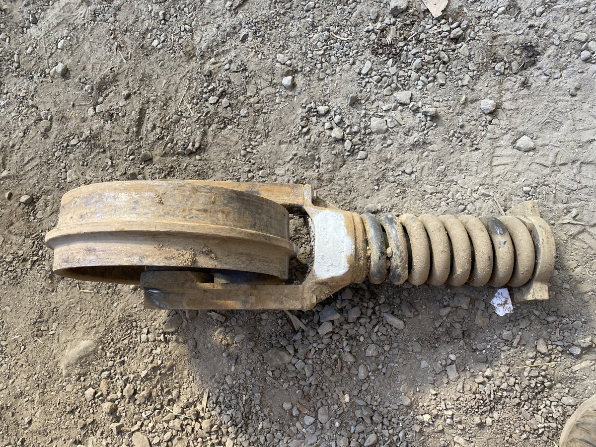

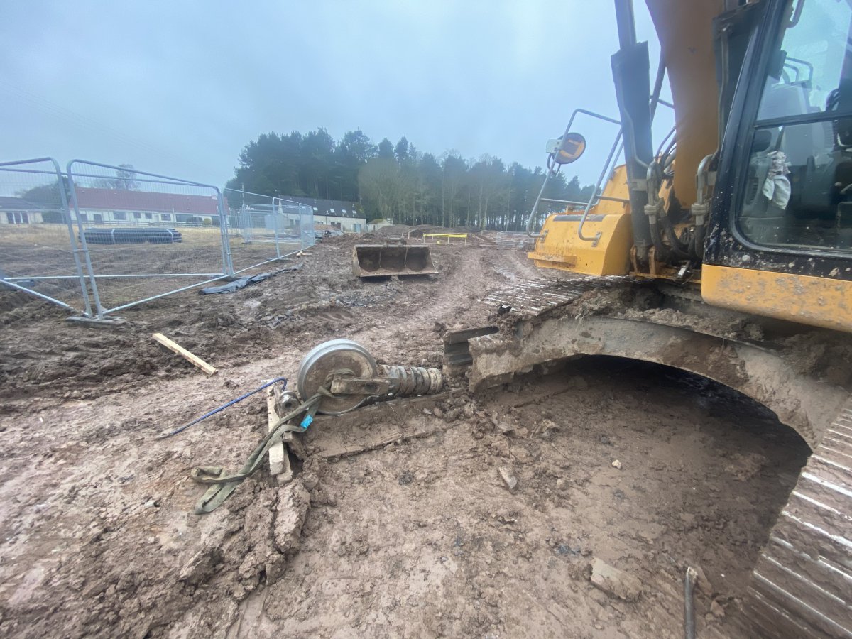

Doosan dx225 track adjuster replacement

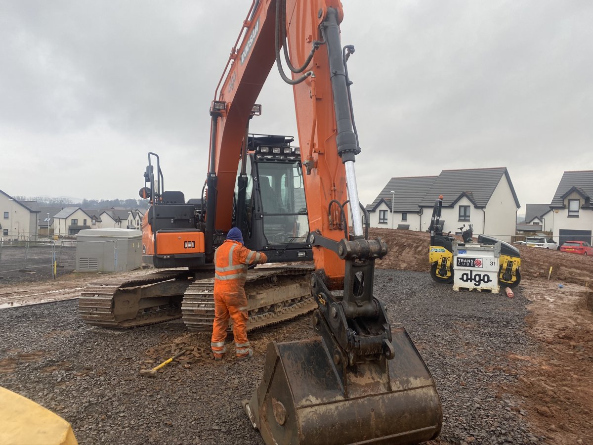

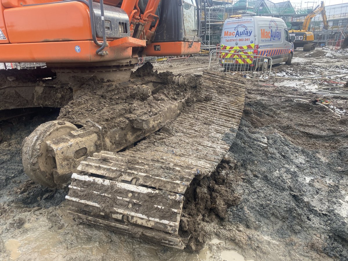

Track chain replaced on an absolute mint 5 year old dx140 with links seized

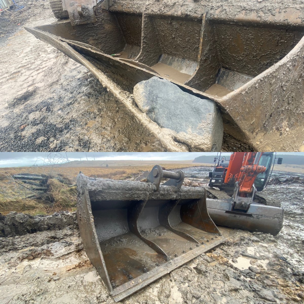

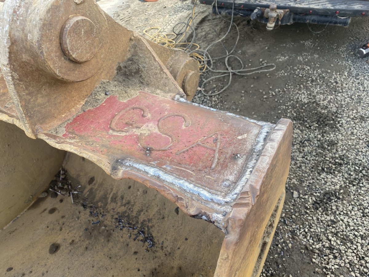

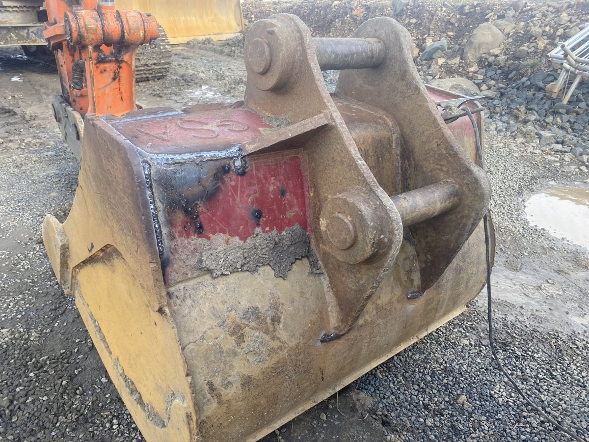

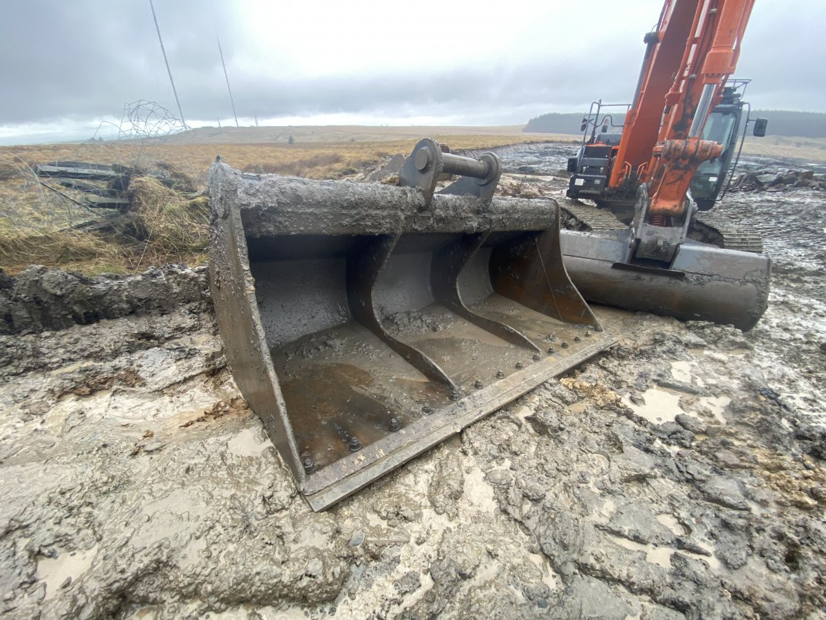

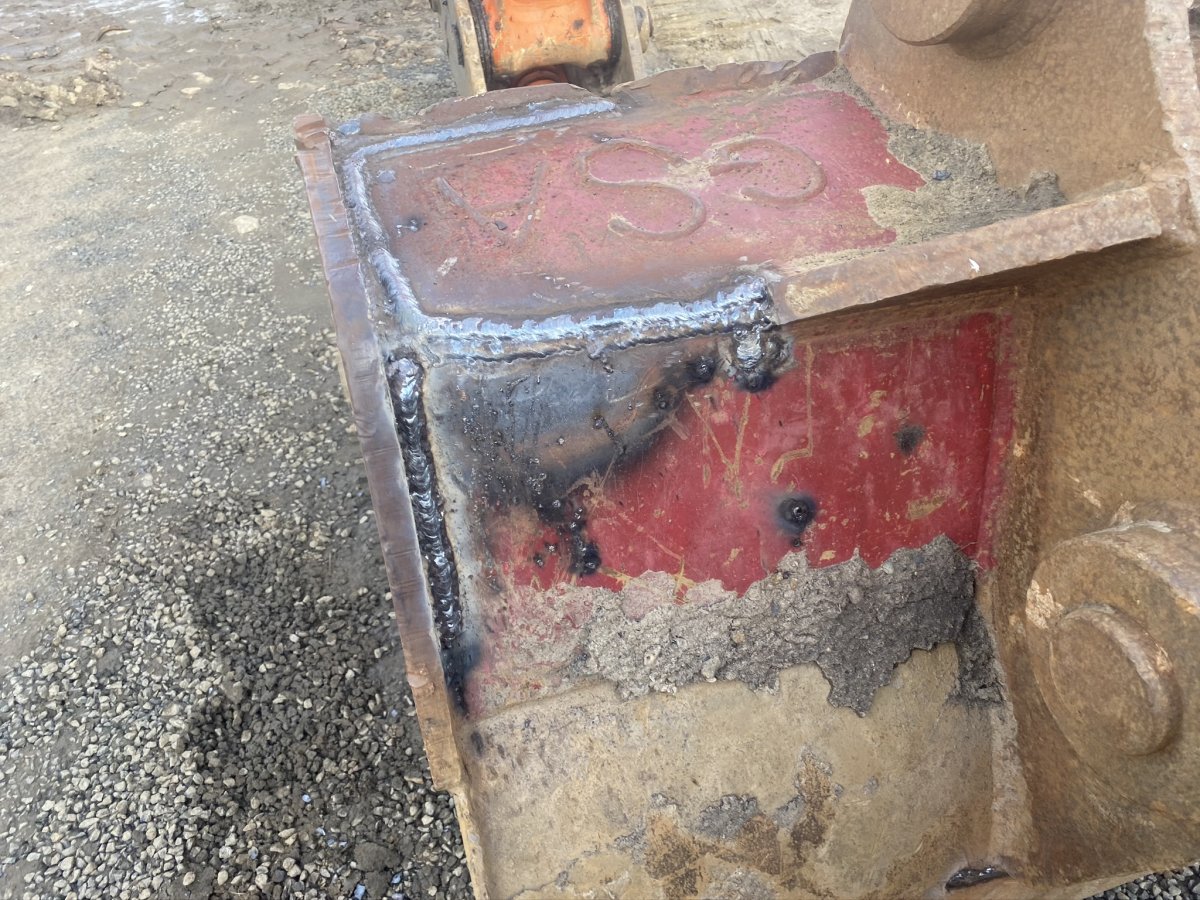

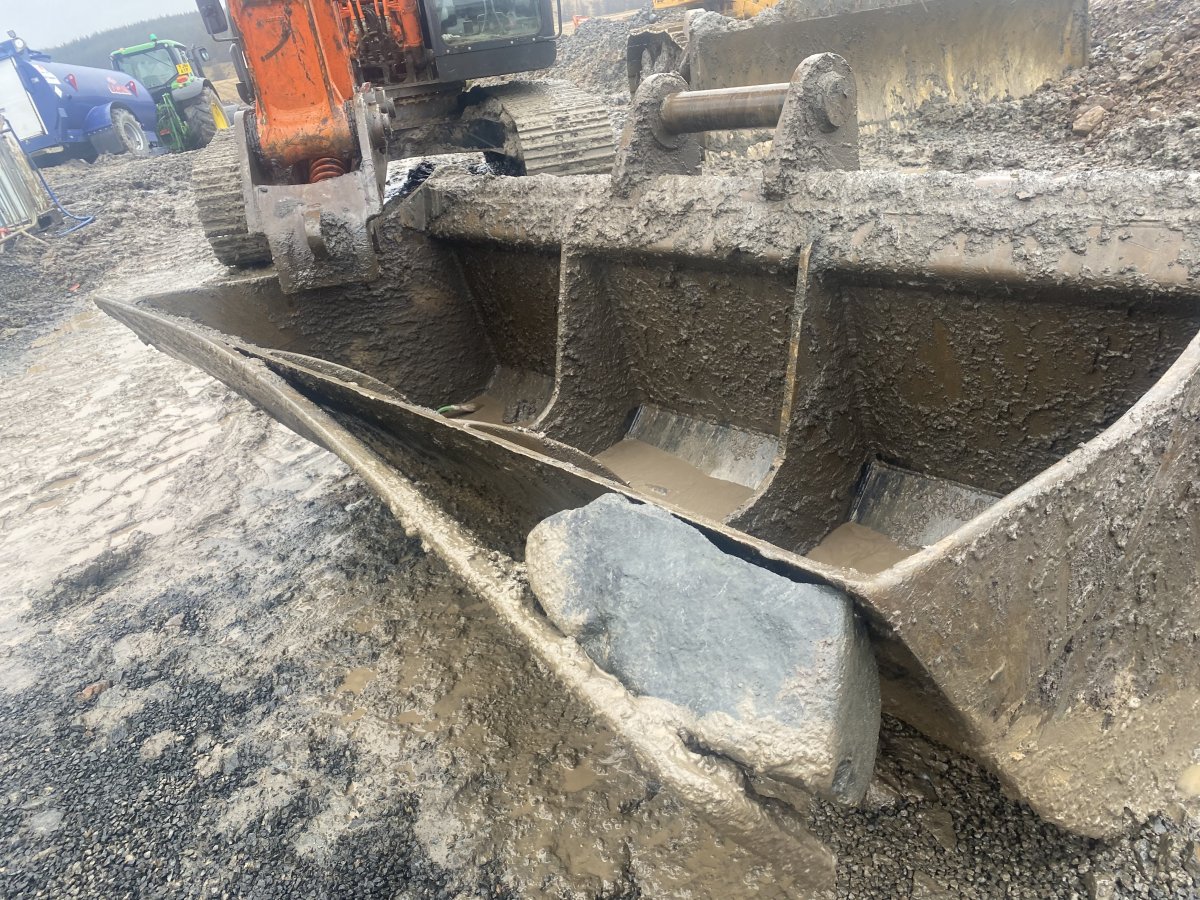

Bucket repairs and some self isolation in progress

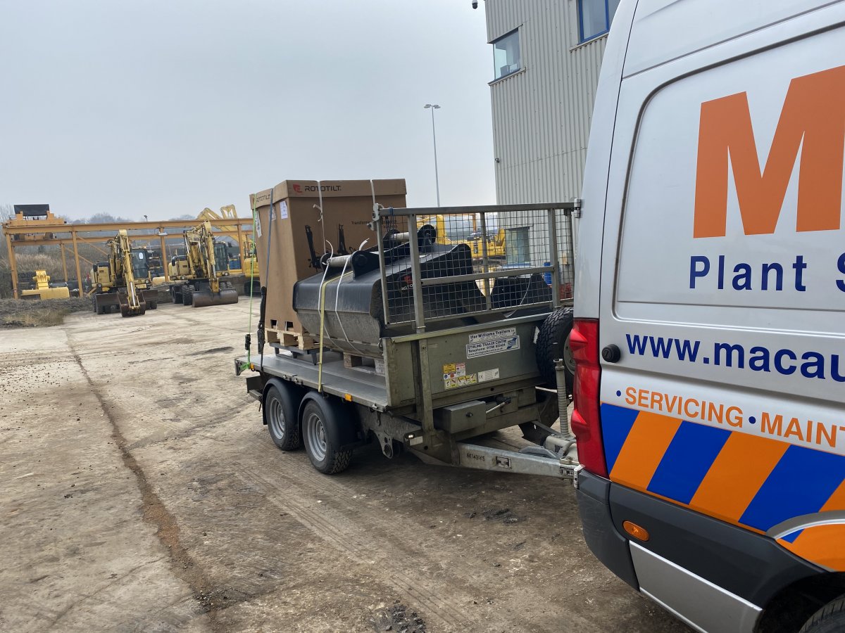

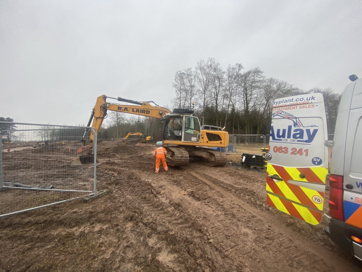

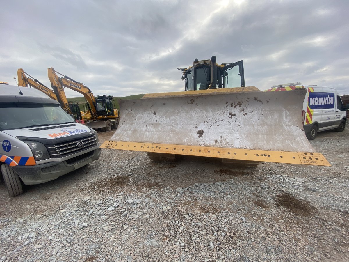

Cutting edge replacement for Balfour Beatty on A9 dualing project.
Rototilt and R6 picked up from Komatsu Chester Lee. Street

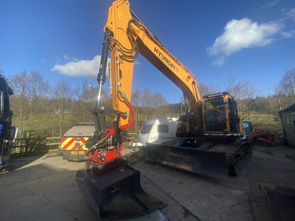

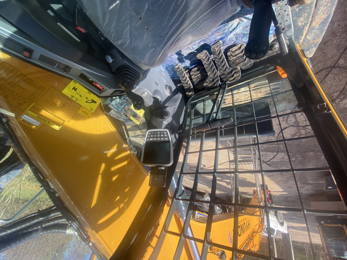

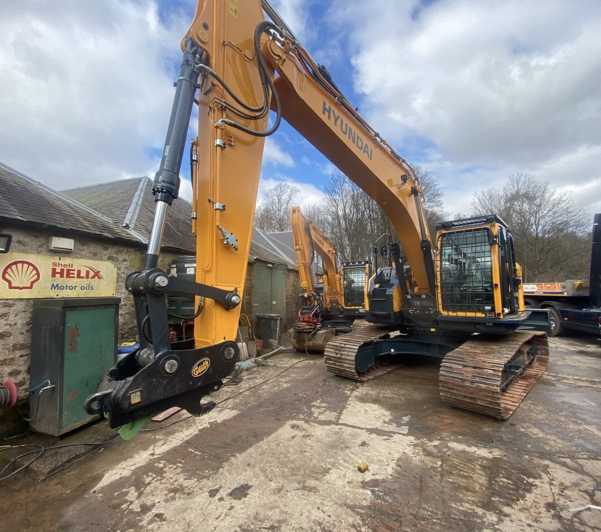

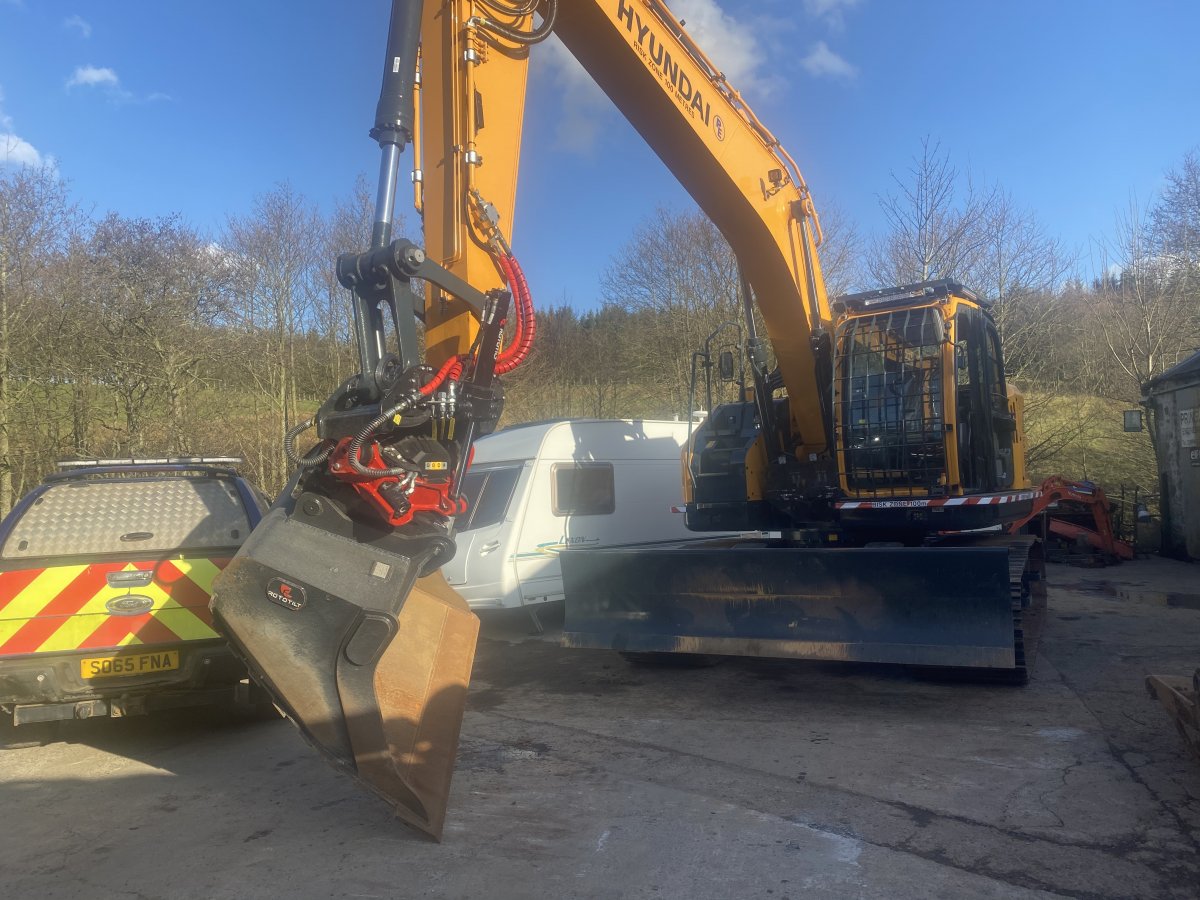

Not much been happening of late, still plodding away with the odd jobs I can.

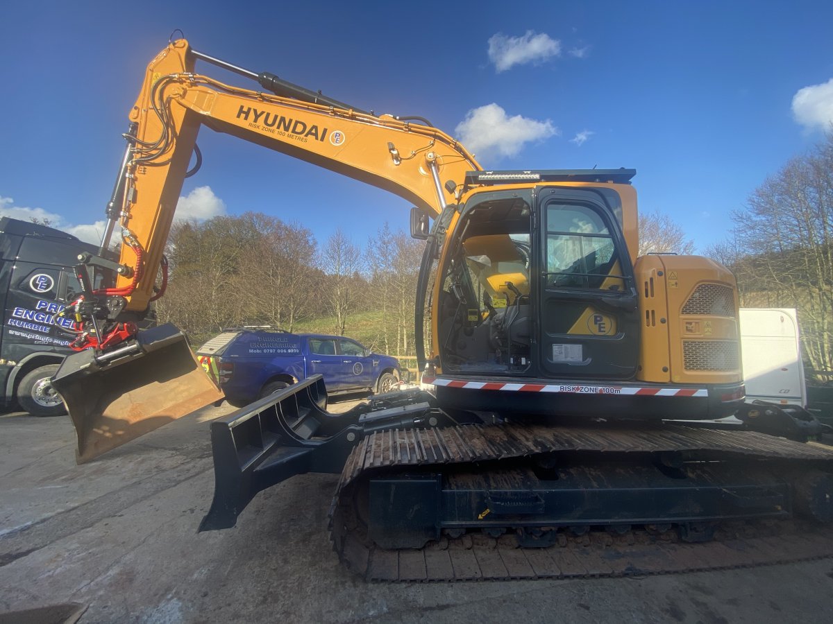

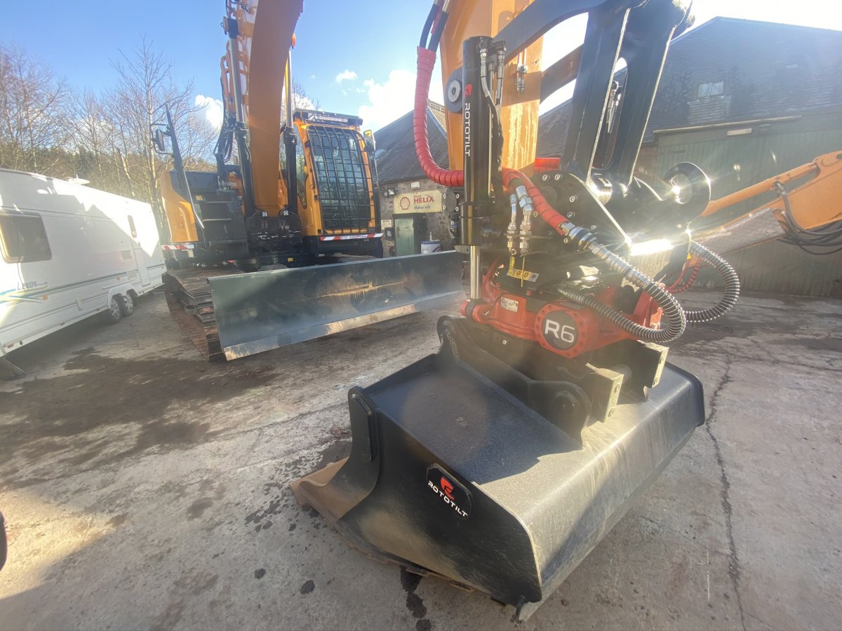

Rototilt R6 install onto Hyundai HX235.
ROTOTILT R6 Direct mount
HI-Flow
ICS control unit
Secure lock
ILS

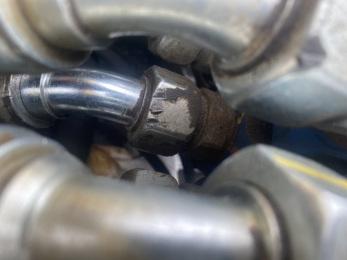

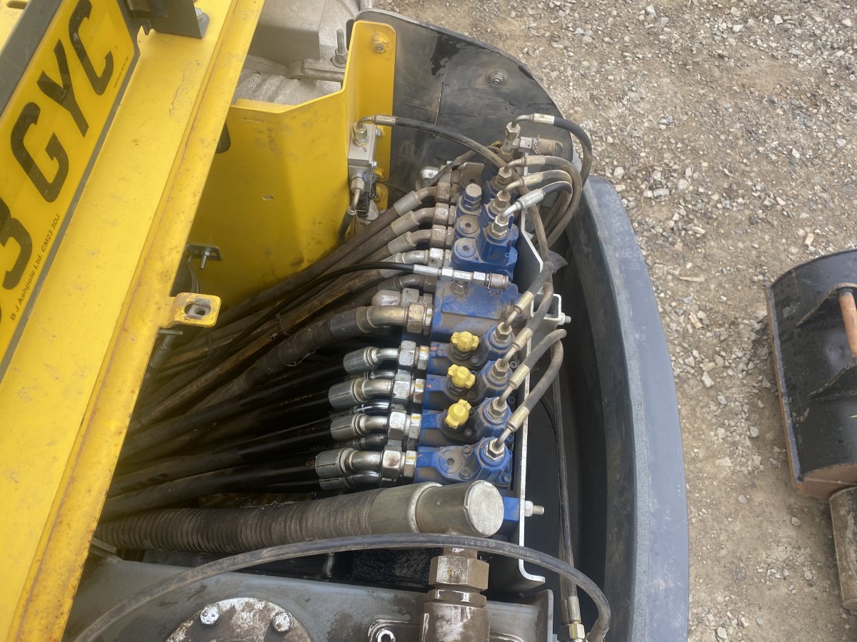

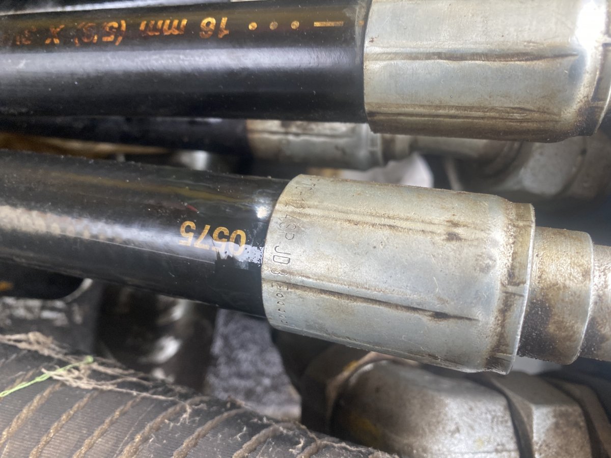

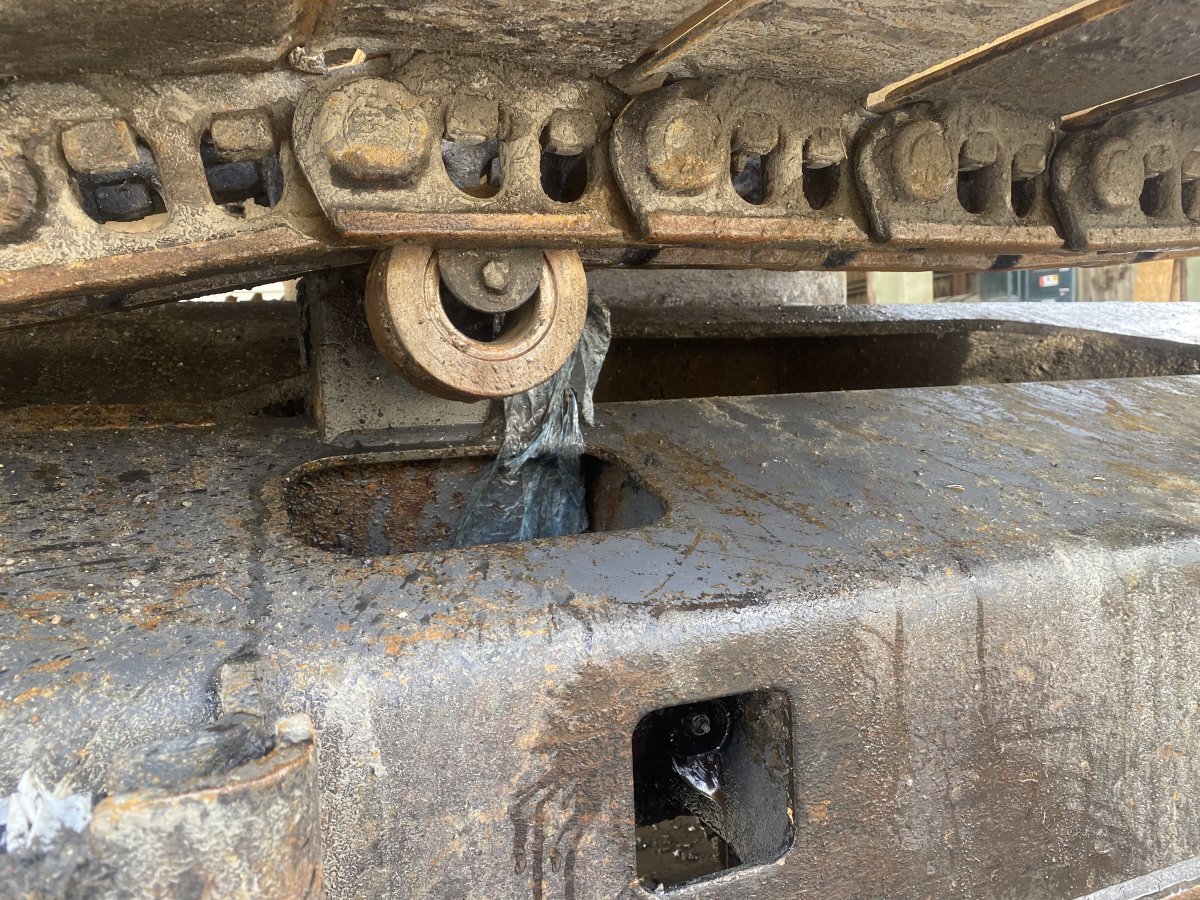

Wacker duck in for oil leak, after hours of searching found these 2 ferrules weeping!

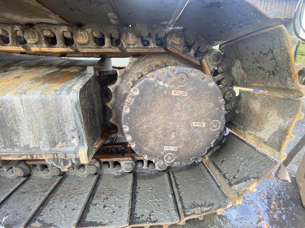

Volvo that decided it didn’t like its sprocket bolts anymore, sprocket bolts drilled out, re-tapped and new sprockets

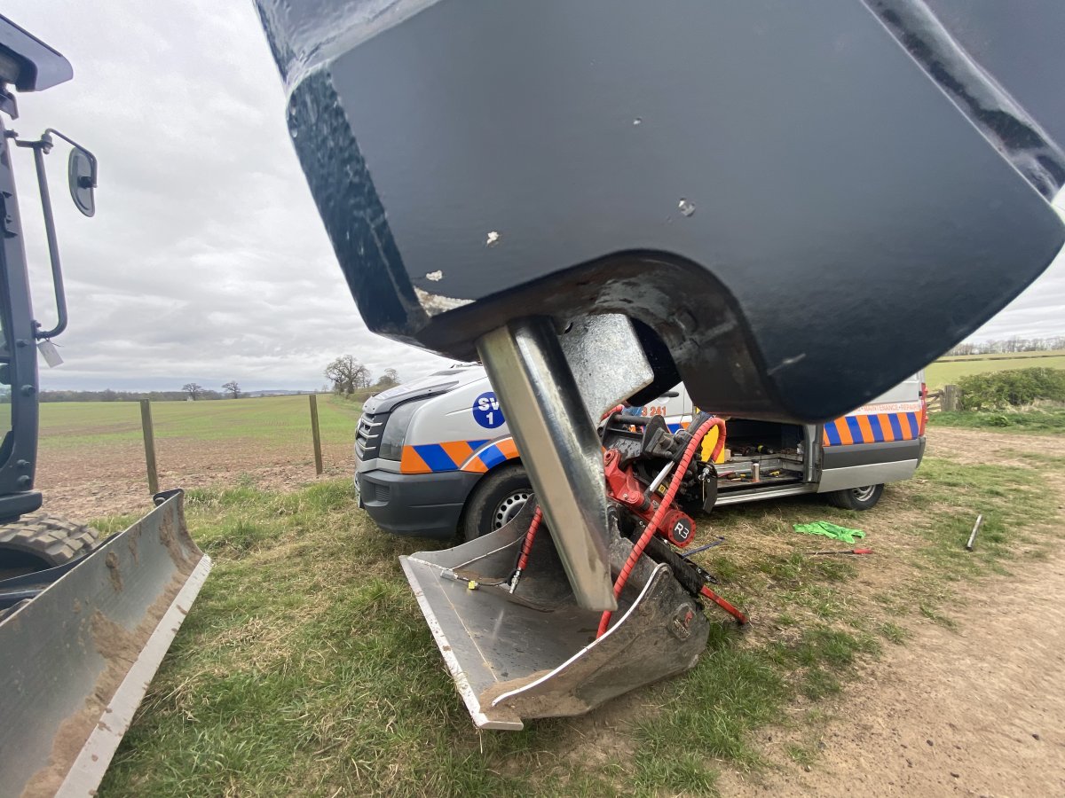

Rototilt hitch repair

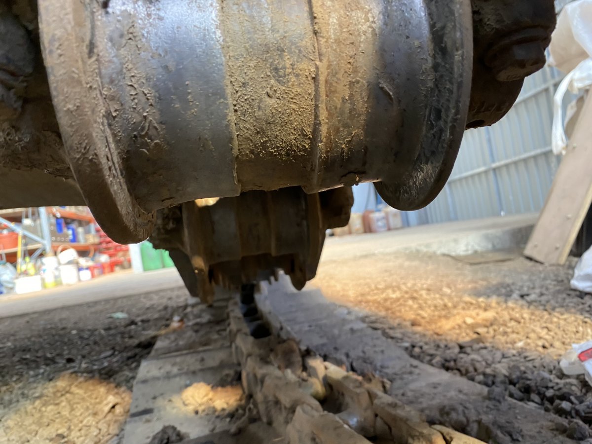

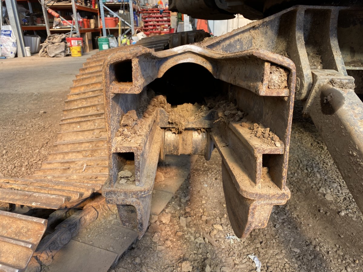

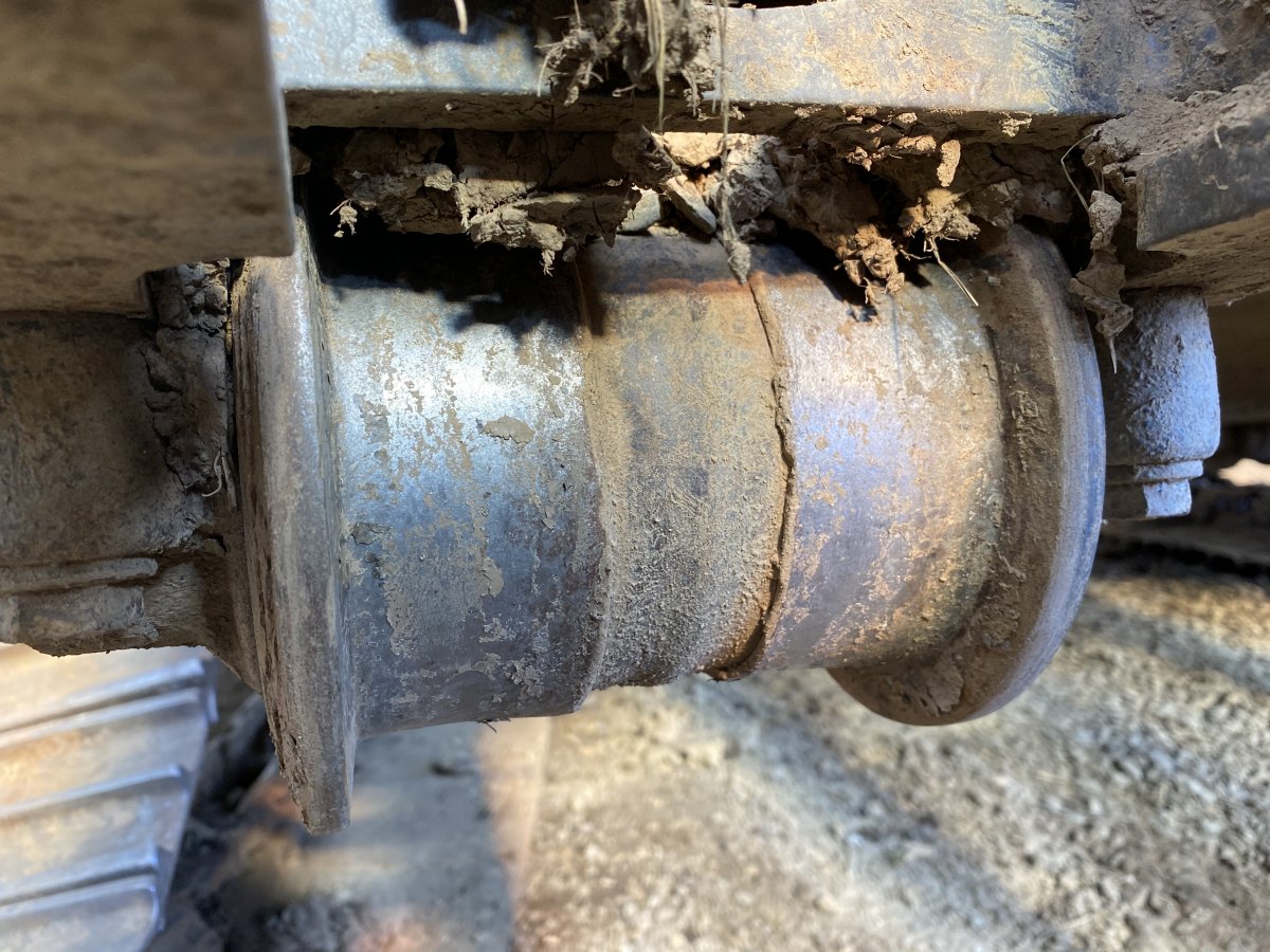

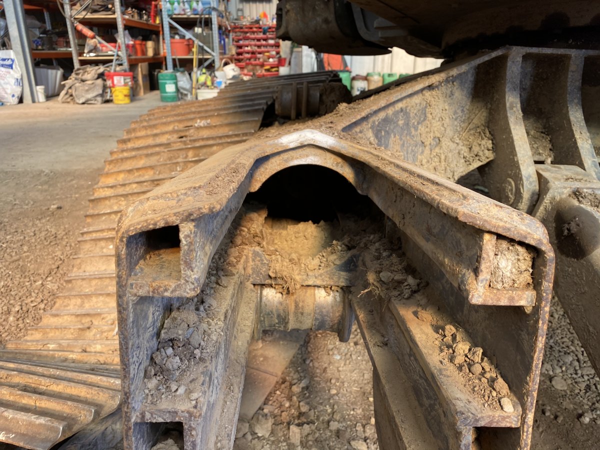

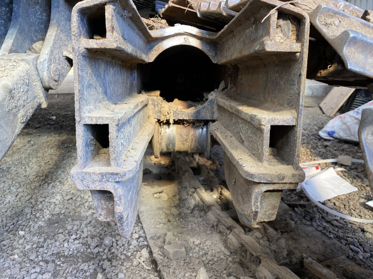

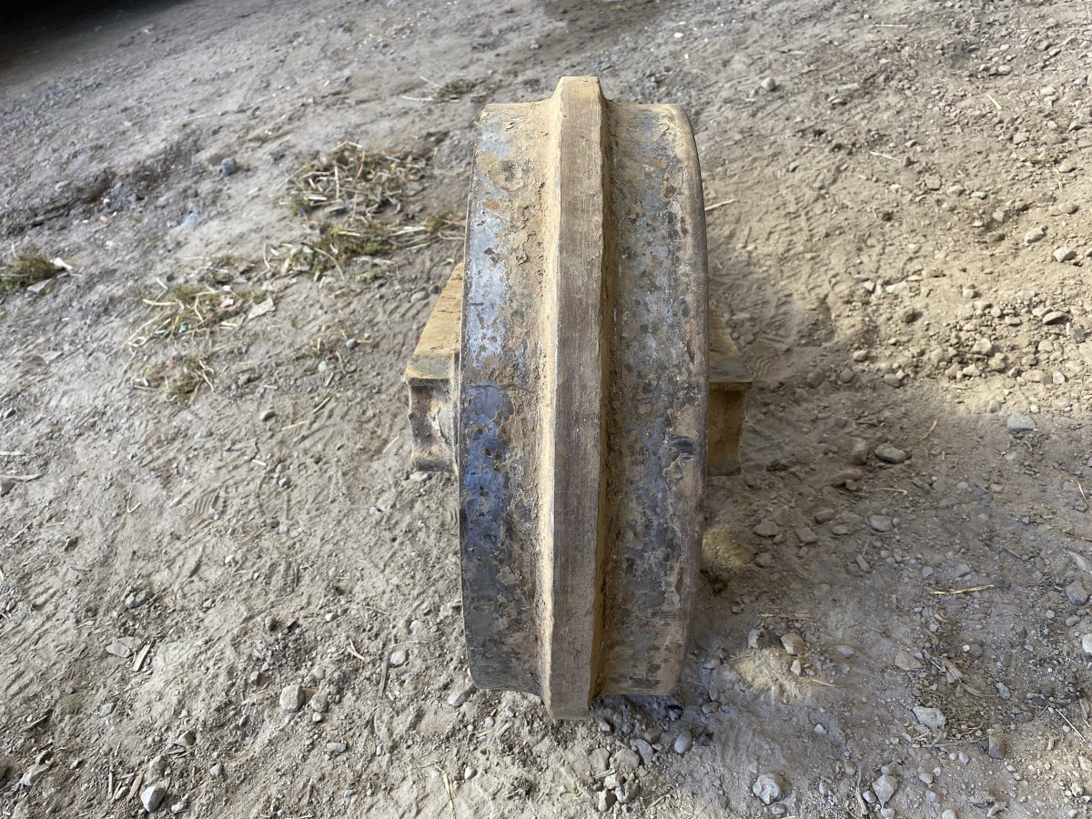

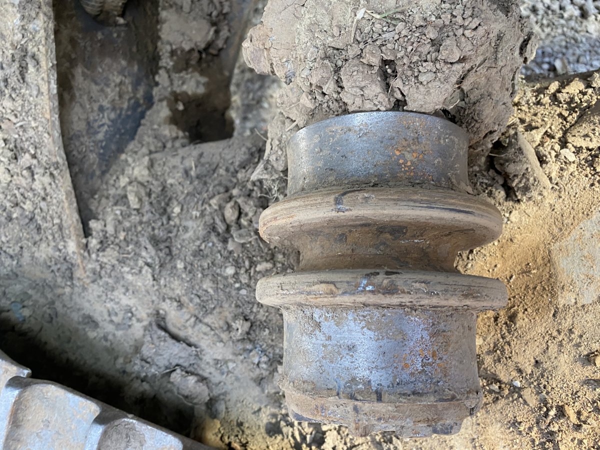

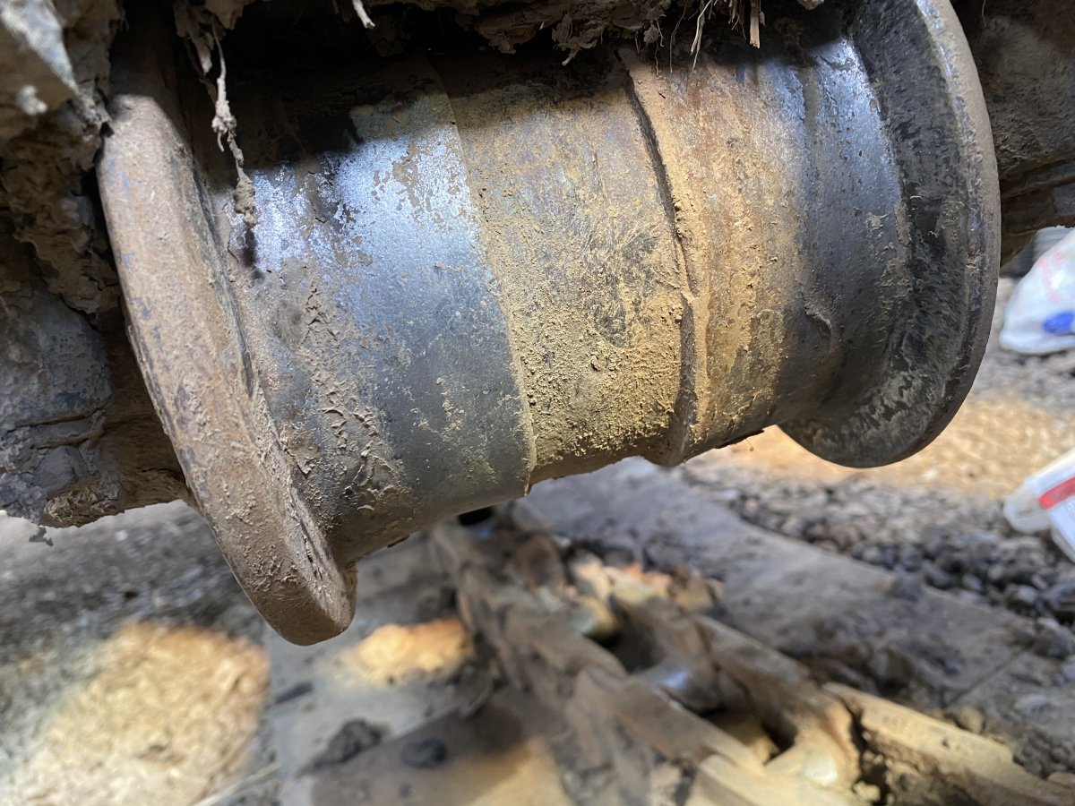

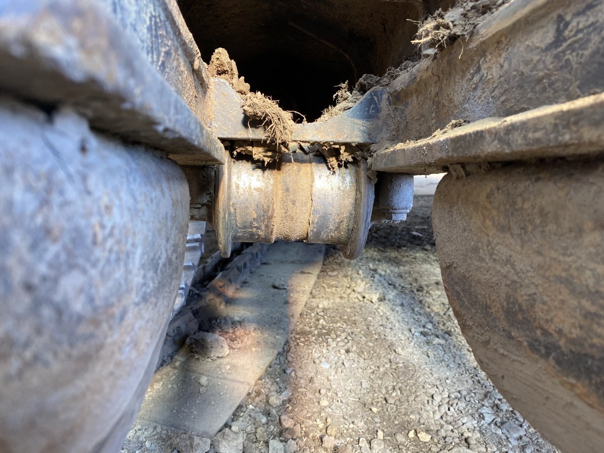

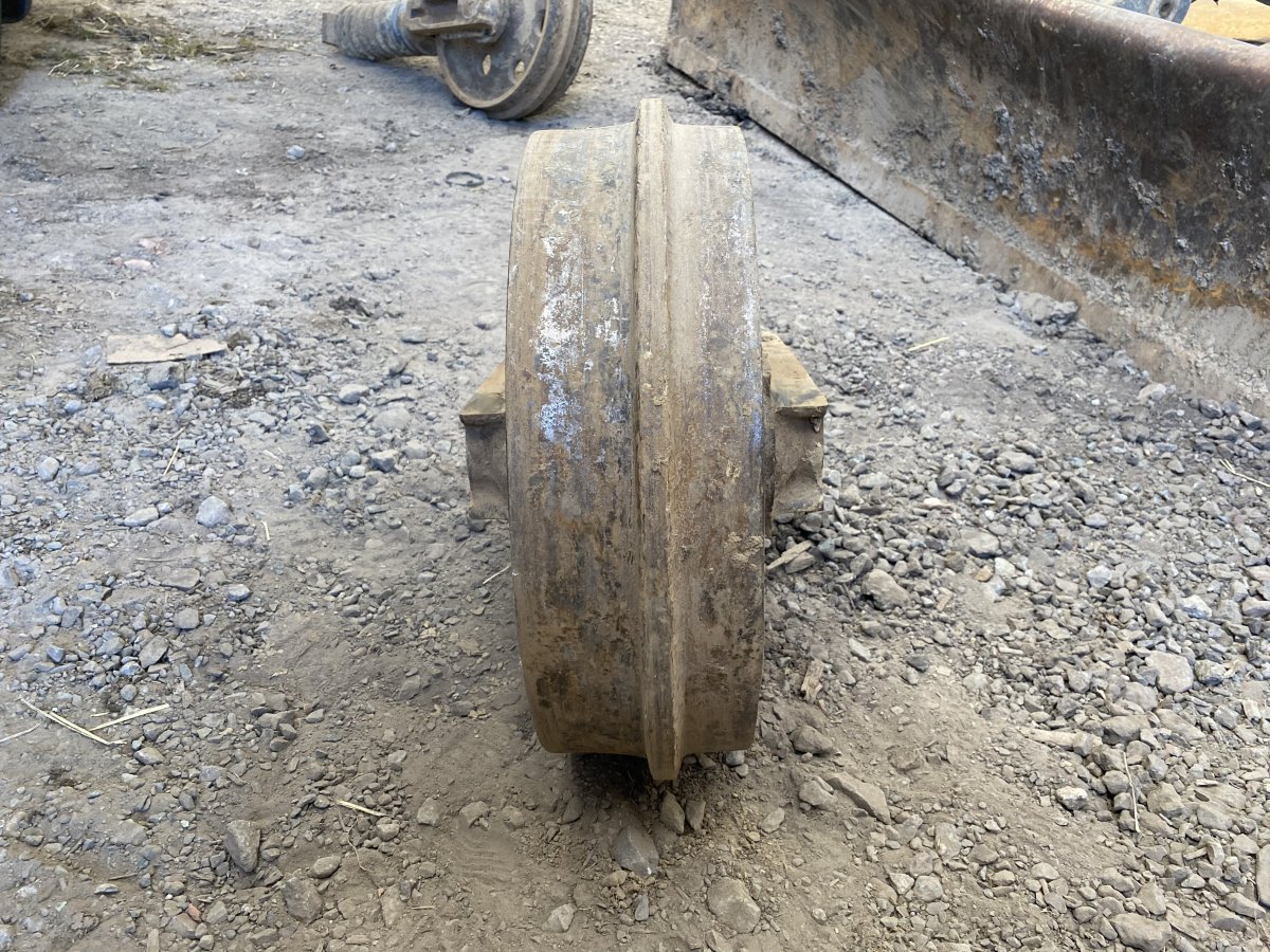

Volvo 8t with steel tracks with abnormal wear on idlers

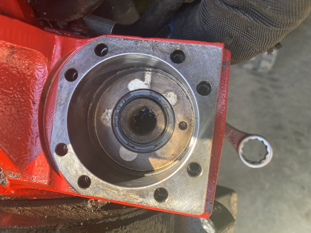

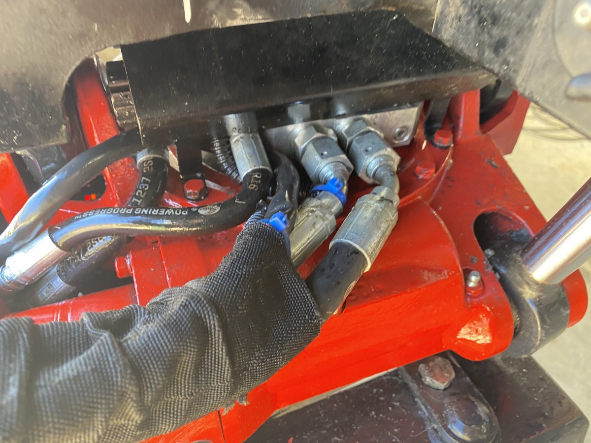

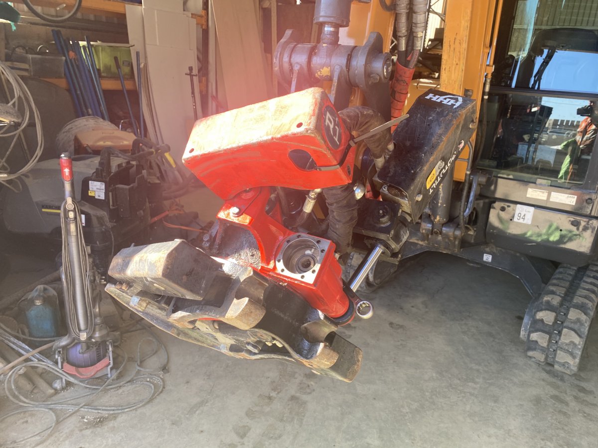

Rototilt R1 rotation motor replacement
