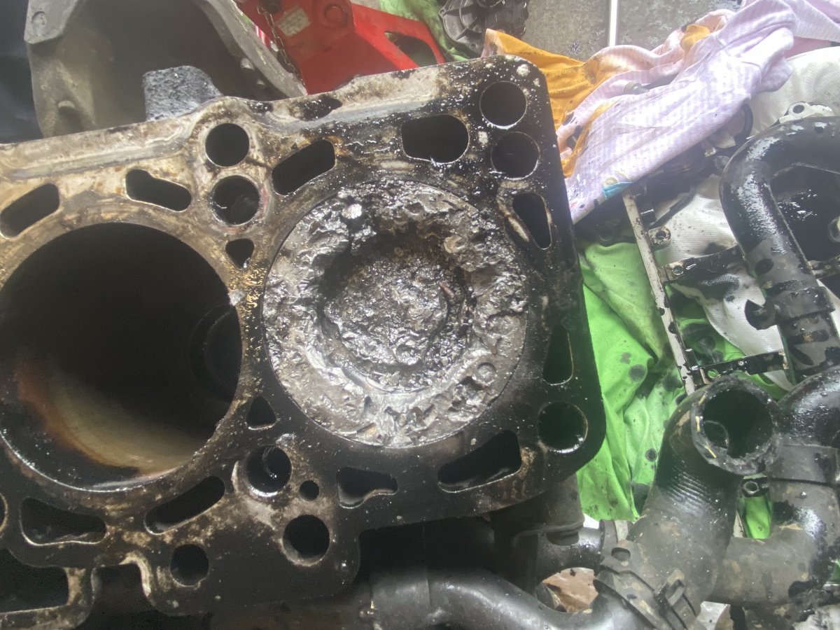

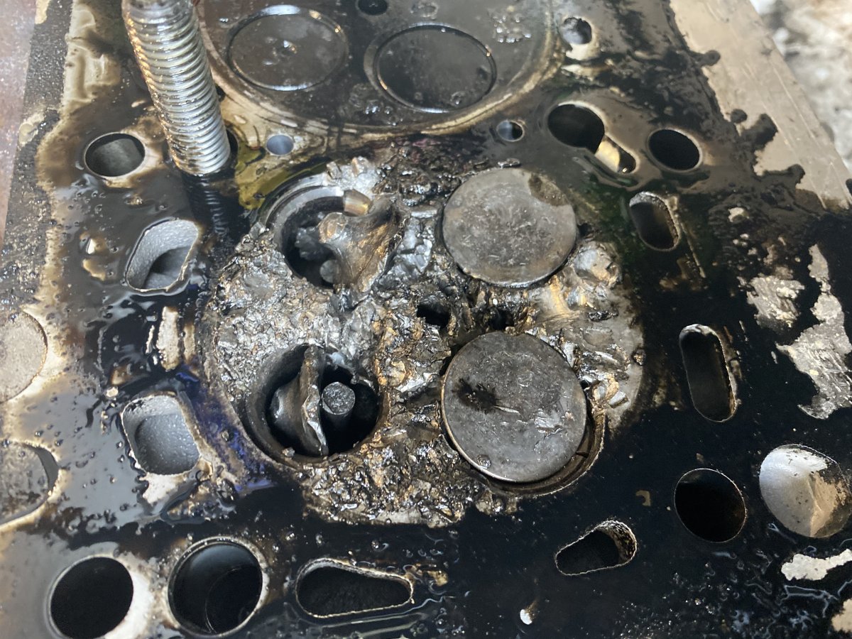

He broke downwhat caused you to have to be recovered Gus?
You didn't let Rory have a drive did you?
initial thought when I looked at the piston pic was ......
Has it been mapped/chipped? Were you giving it the beans?Nope can belt didn’t slip,
Still perfect. And the gear timing on the camshafts are perfectly lined up.
We think it got hot on that cylinder melted the end of the glow plug and hey Presto
