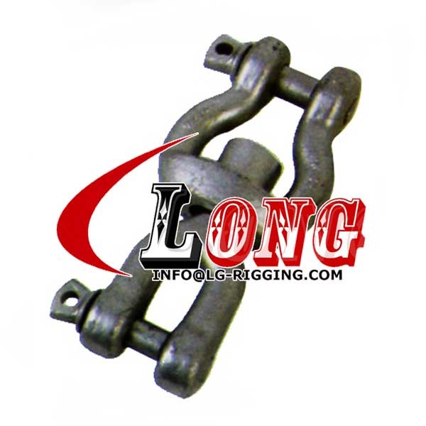

Be something like this you would need?
you would struggle to find a swivel on most chains now druid only really see them on single leg drop chains or hook assembly's. 99% of two and four leg sets I see now are just master link couplers grab hooks (shorteners) and then the bottom hooks and attached to the quick hitch by a shackle like in the picture.
not legal under LOLER though Andy ... chains/slings/lifting devices must be attached to a swivel to prevent overloading of chains/link by twisting and provide a straight pull to the attachment point .... has to be a swivel hook or swivel link between the fixed point on the hitch and whatever is hung off it

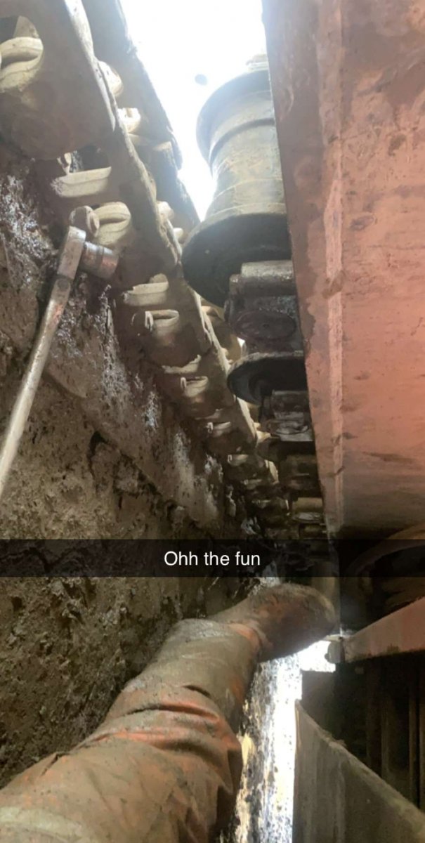

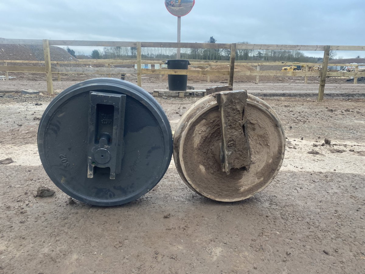

Someone supplying wrong parts again for idlers.

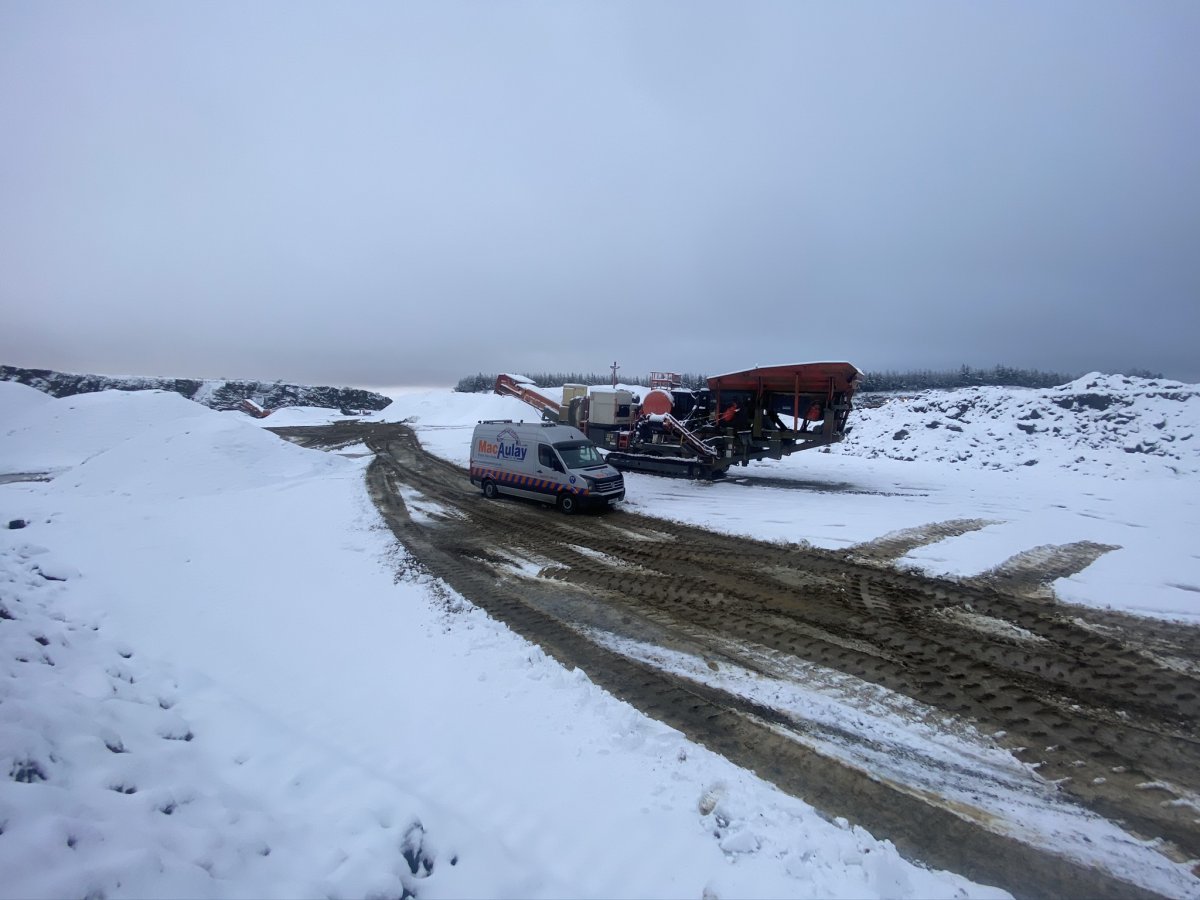

Bit snowy on crusher job and boy are we having fun rolling in the slop.

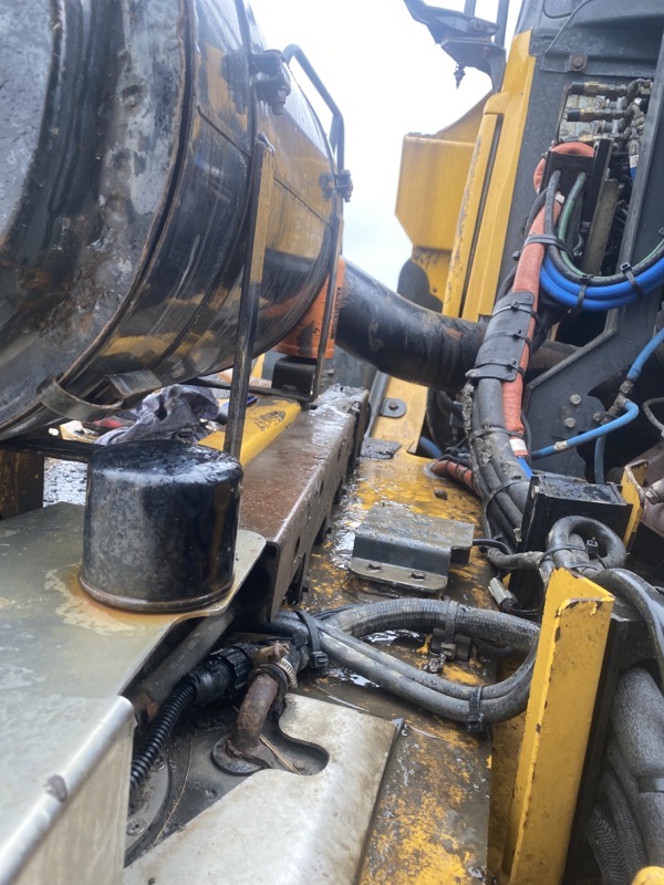

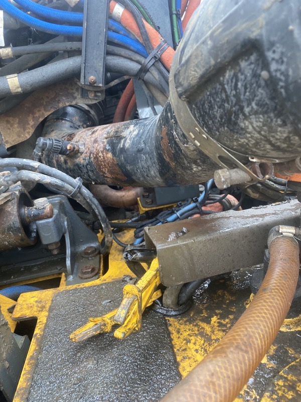

Bell B40D burst DPF coolant hose and damaged diff

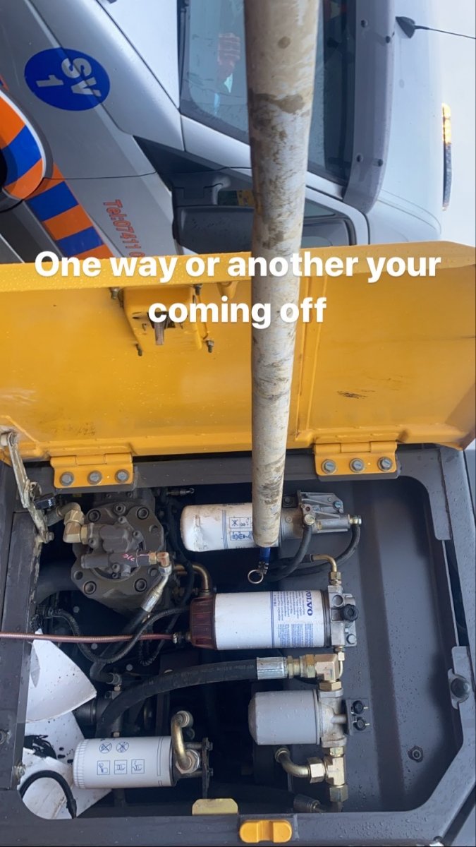

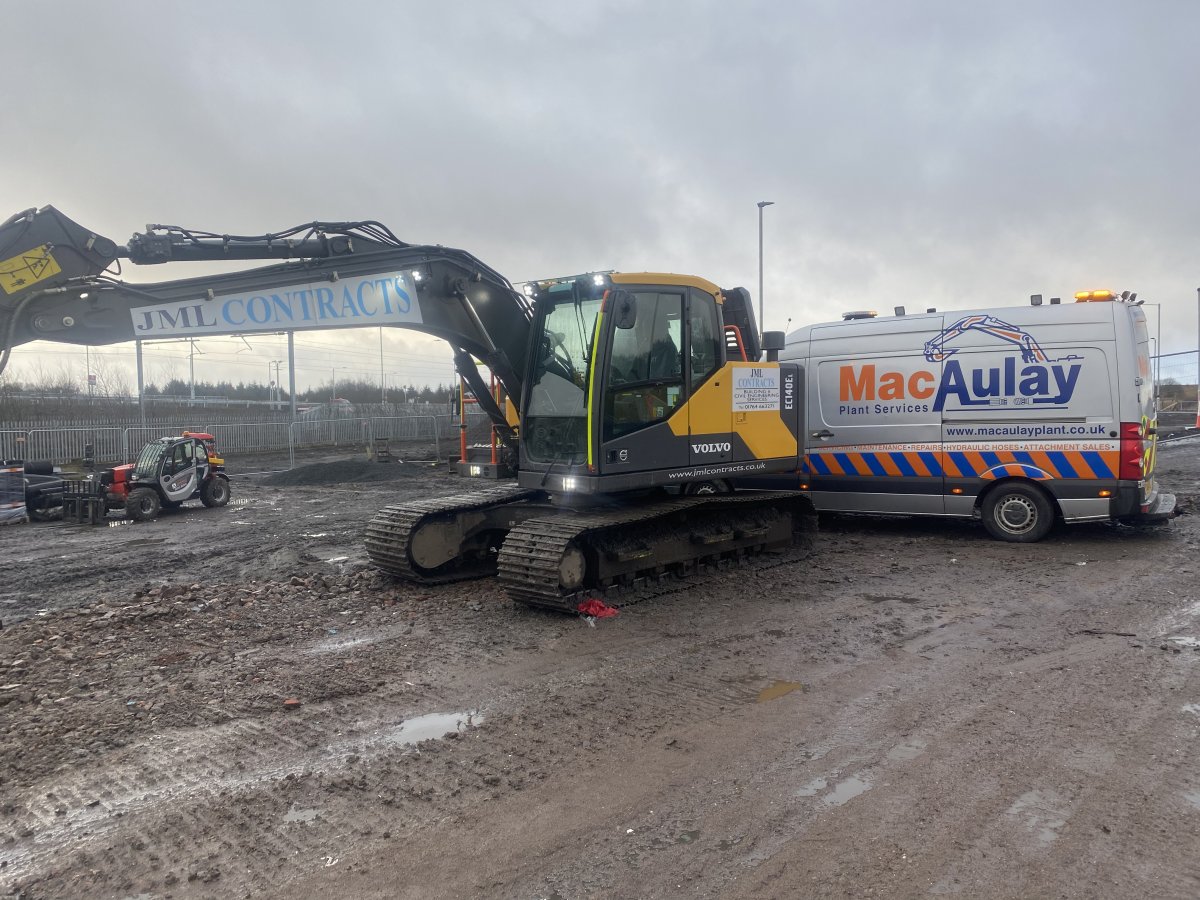

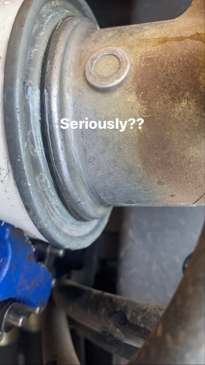

Nice little Volvo Ec140e for service today, but ridiculously tight filters!

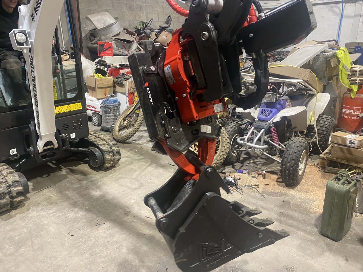

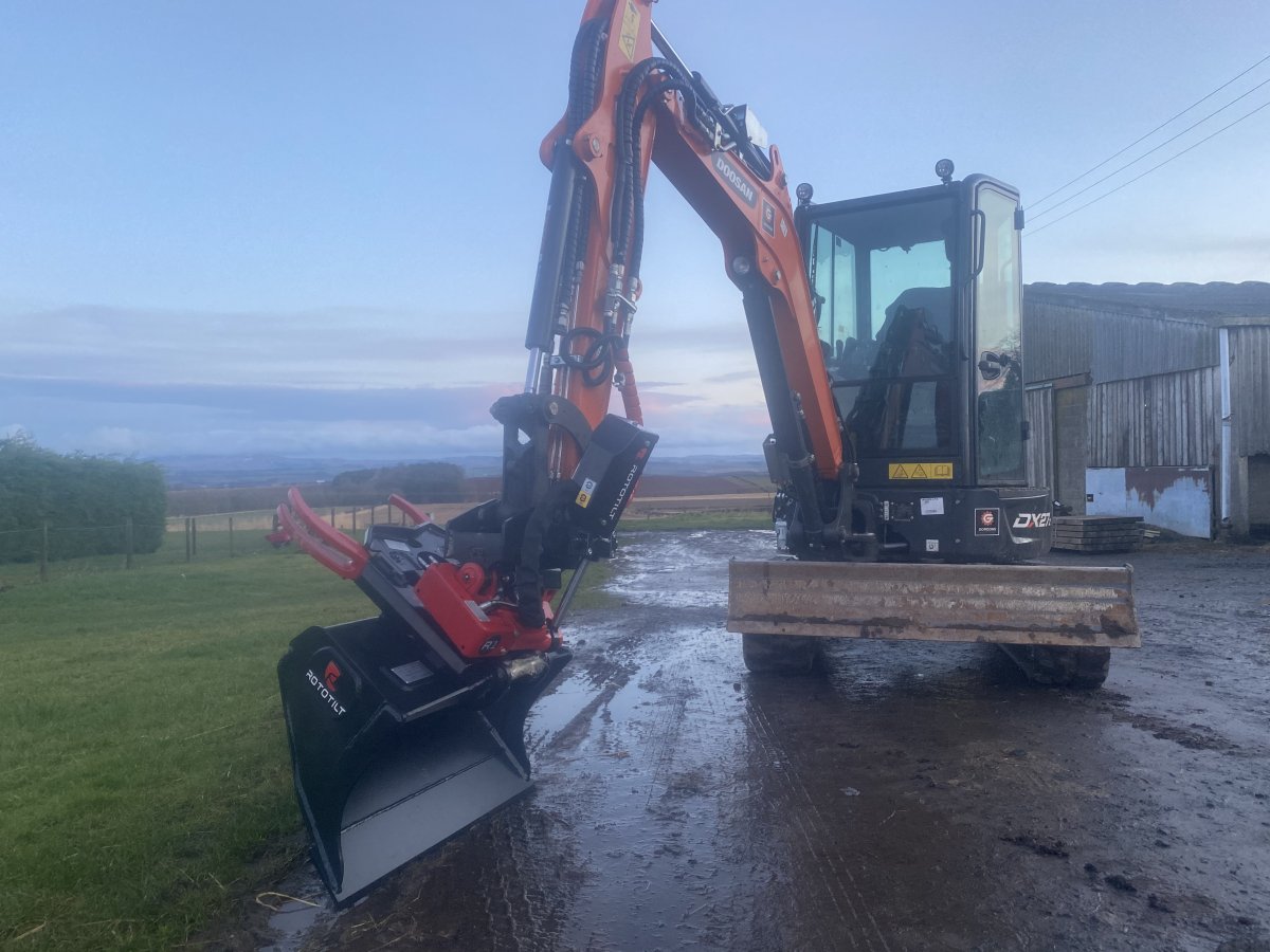

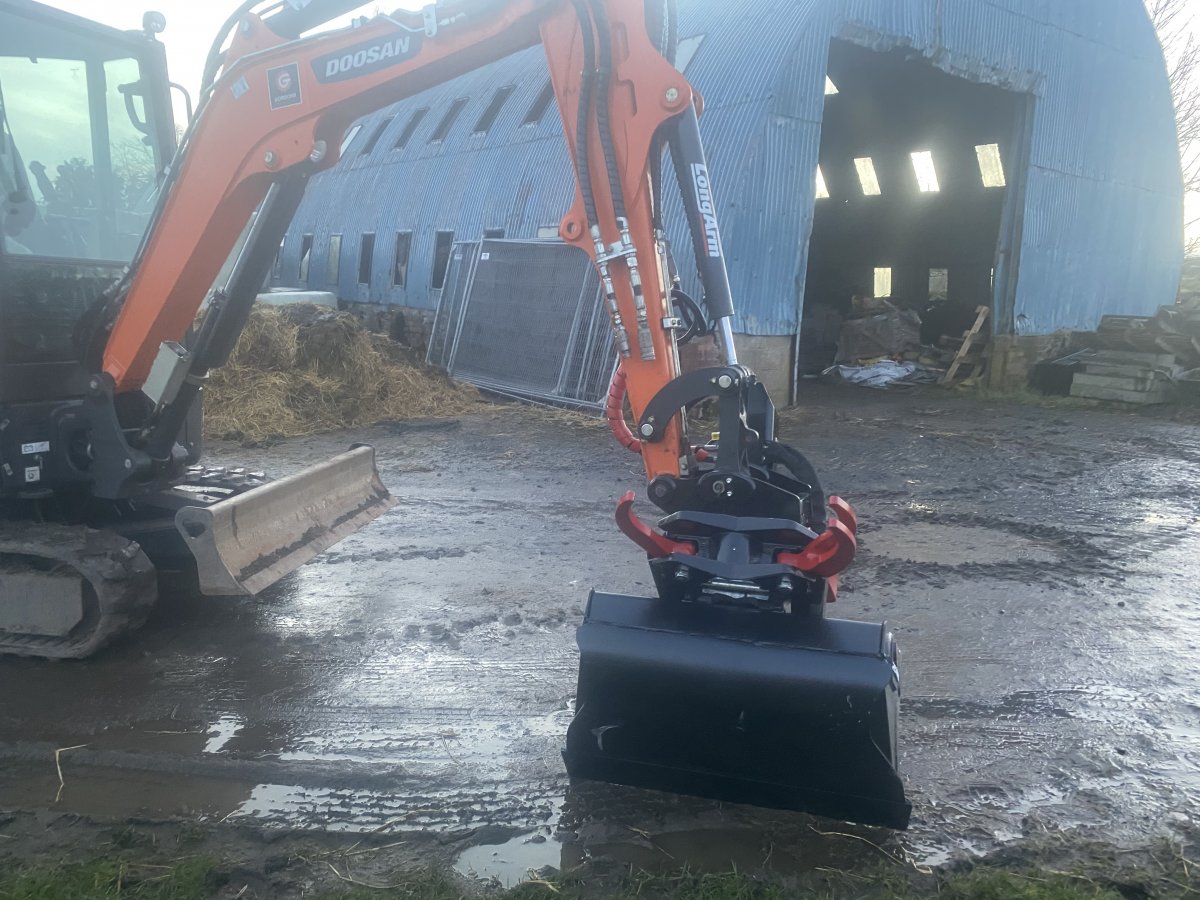

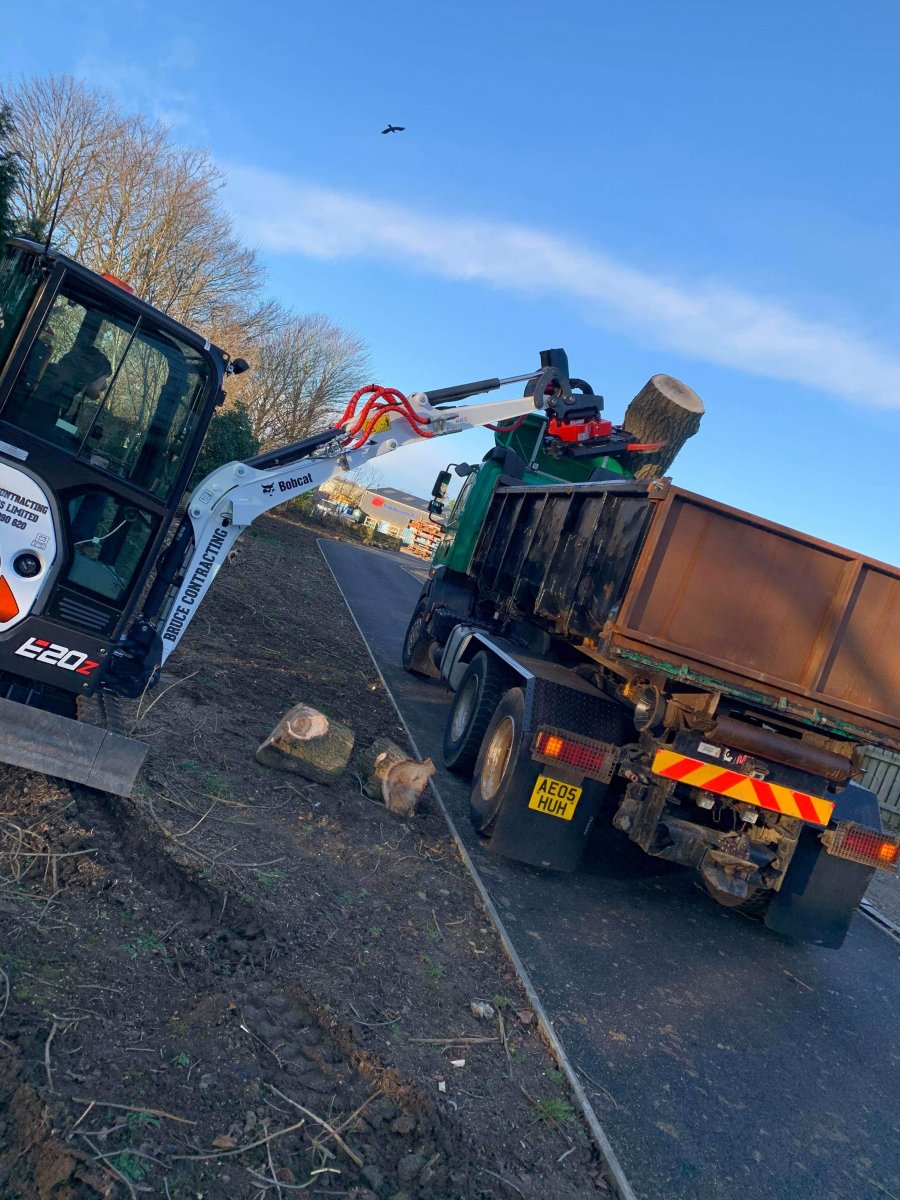

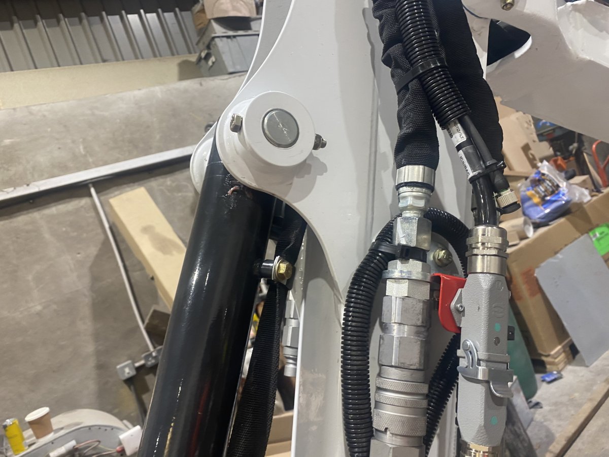

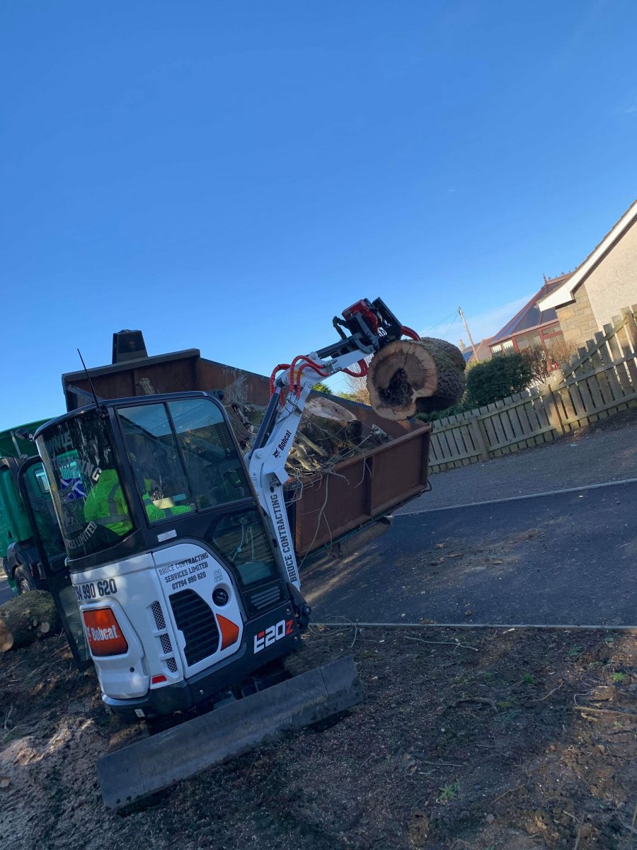

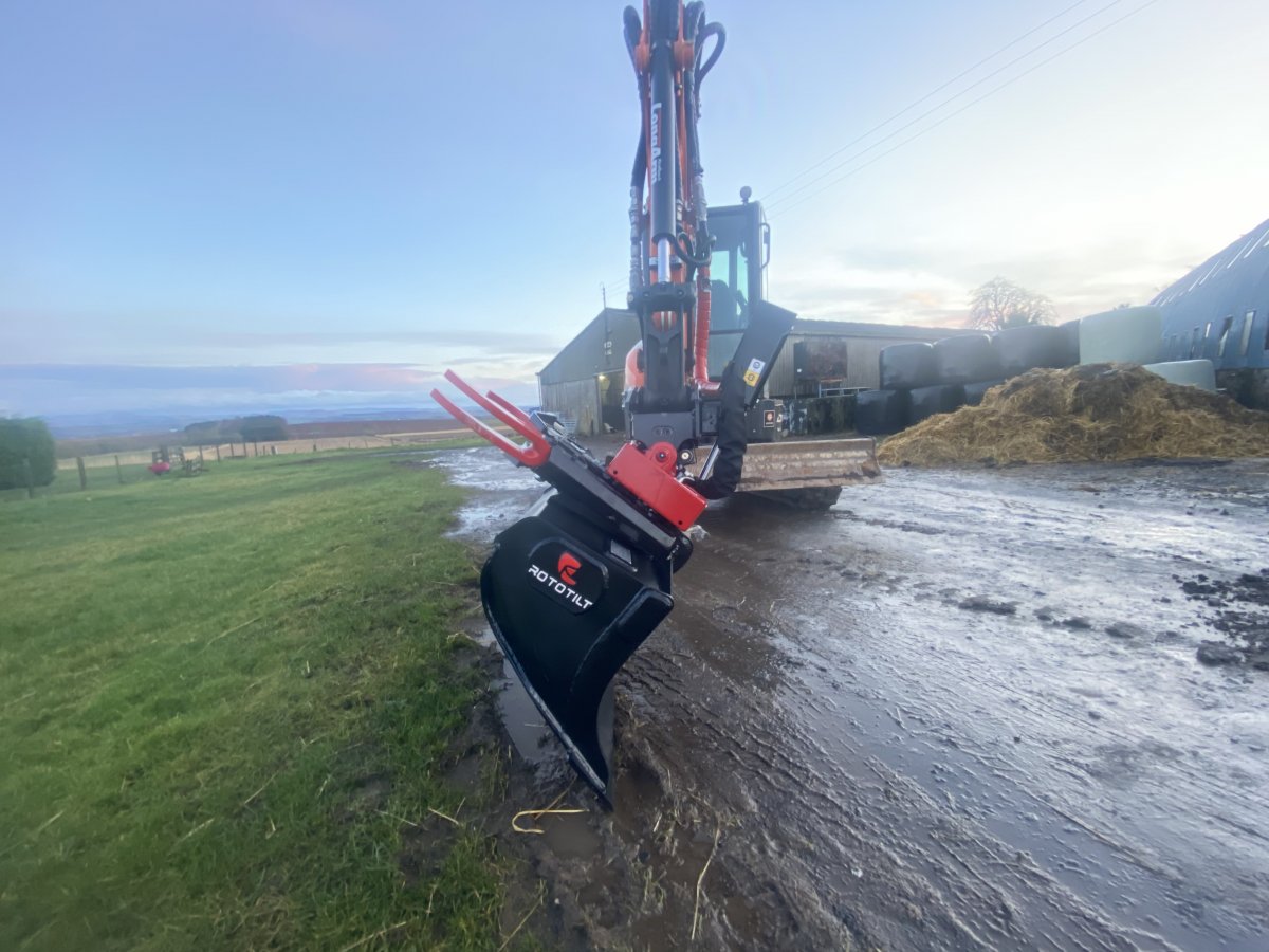

Recent Rototilt R1 installed onto Bobcat E20,
This machine is running direct mount with S45 pickup to enable the gripper module and full ICD control system

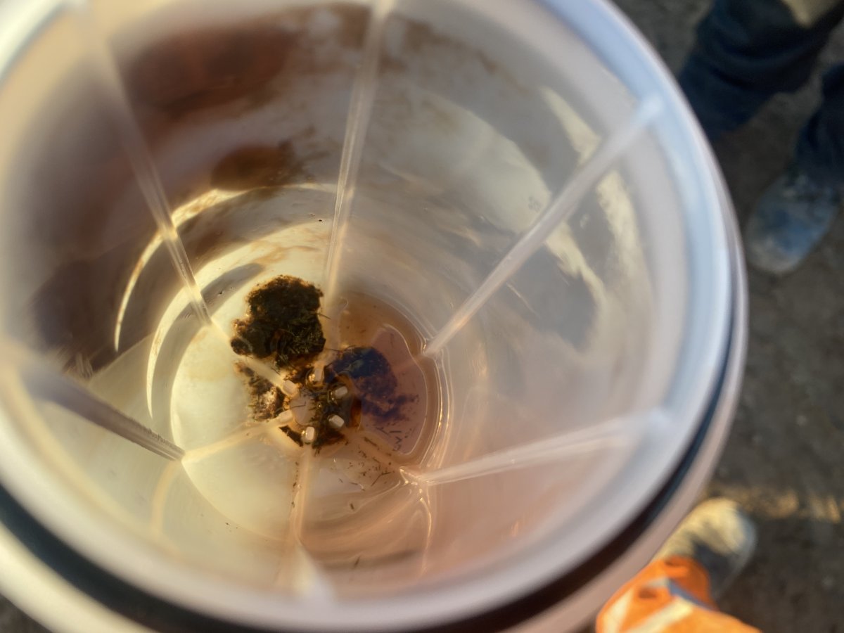

Yanmar in for warranty repair that turned out to be a non warranty repair as customer hadn’t serviced it for 750 hours! Filters choked and full of diesel bug!

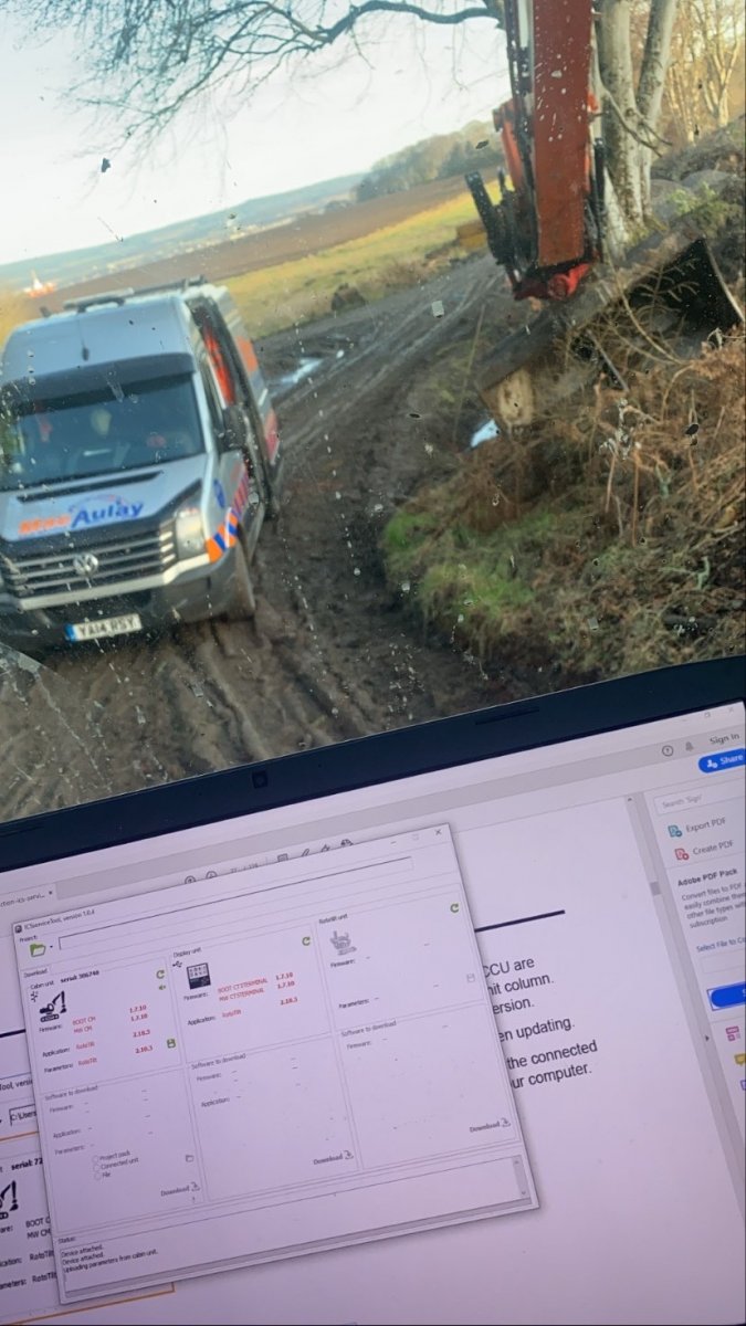

Software update and screen replacement on Hitachi zx225 with Rototilt R6.

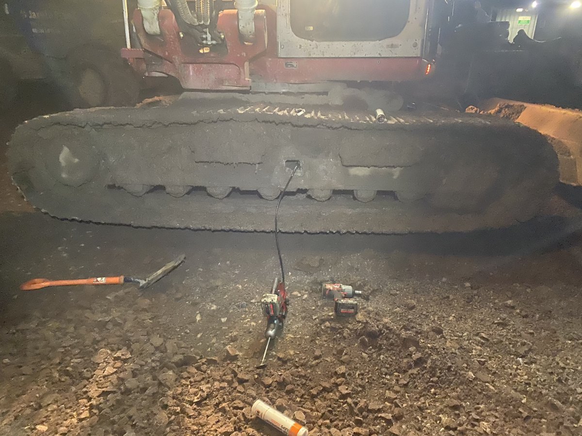

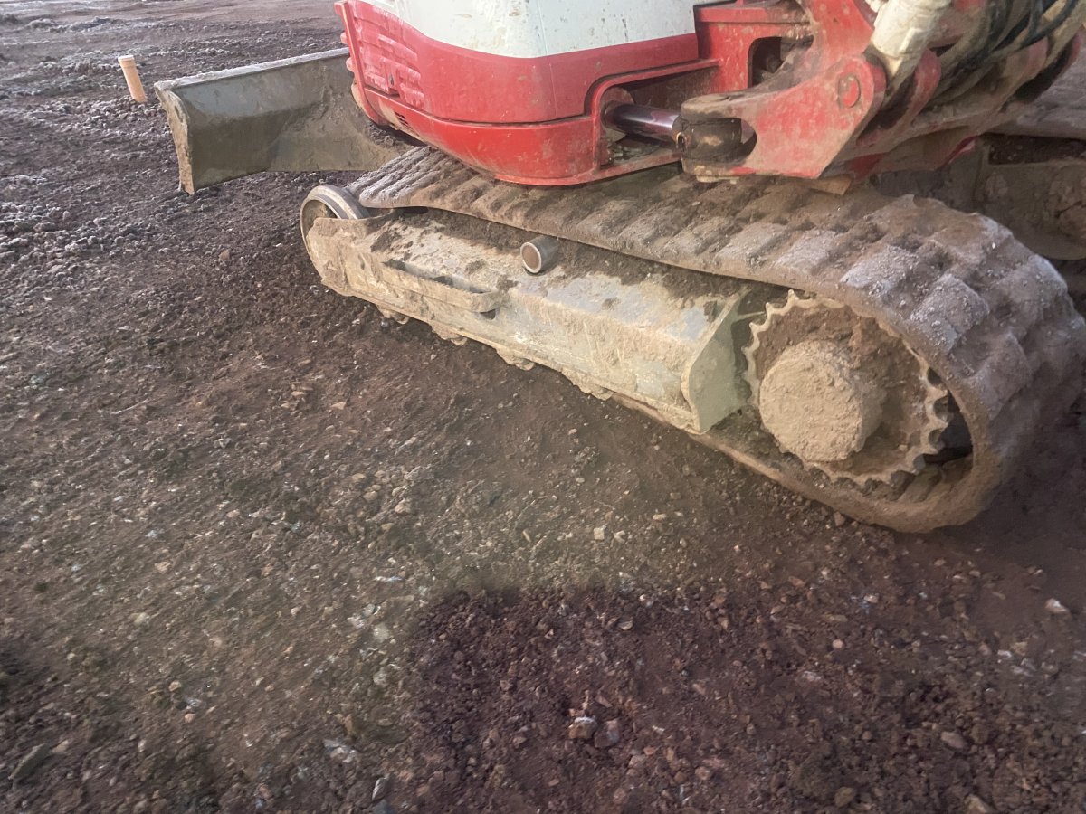

Takeuchi TB1140 with slack tracks! Needing a good clean to stop the slop from freezing! Same sight with a track off both the sprocket and idler!

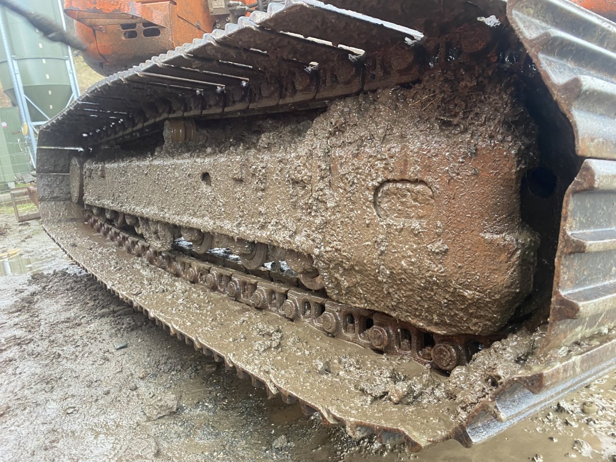

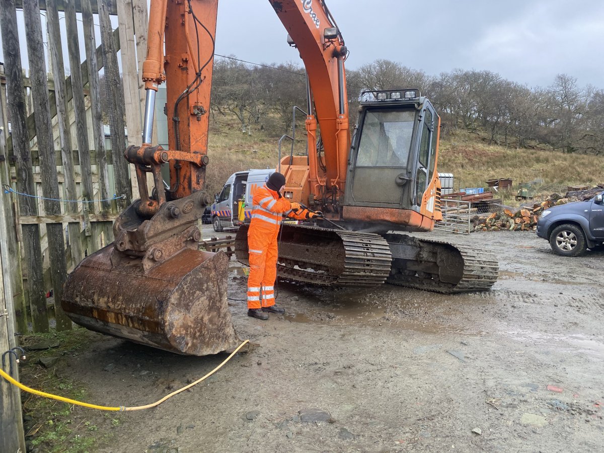

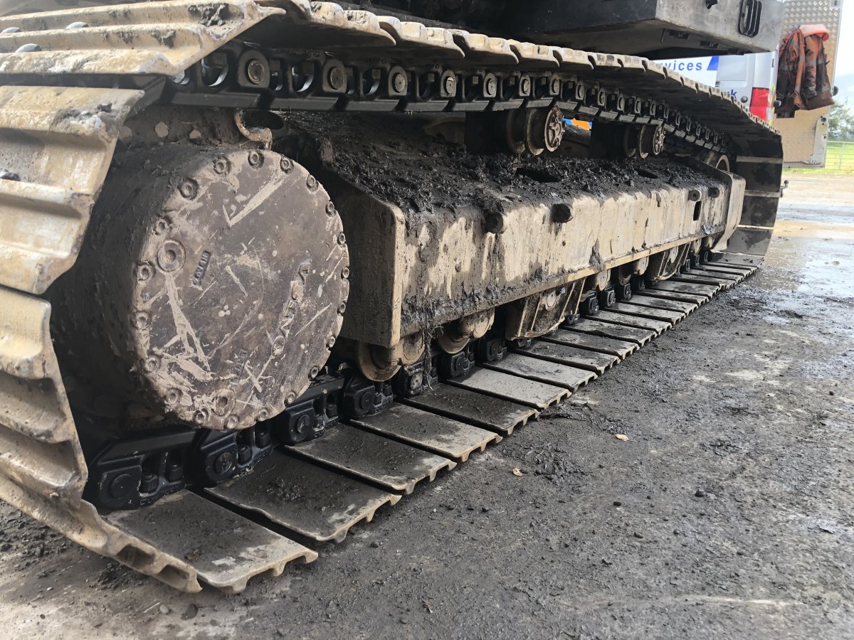

Doosan dx140 in for new chains, sprockets and idlers! Away up in Tighnabruaich.

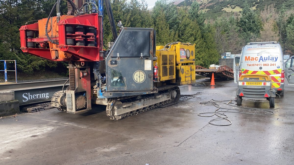

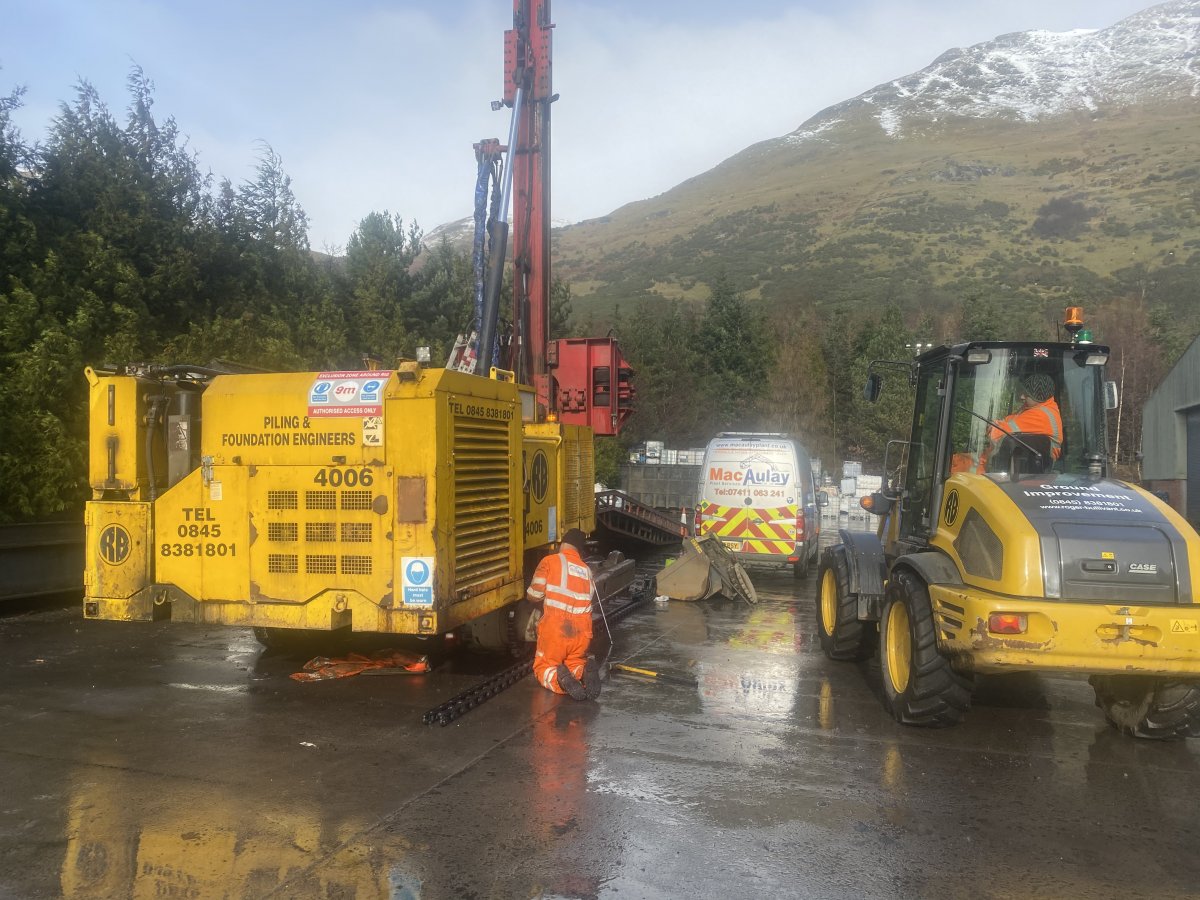

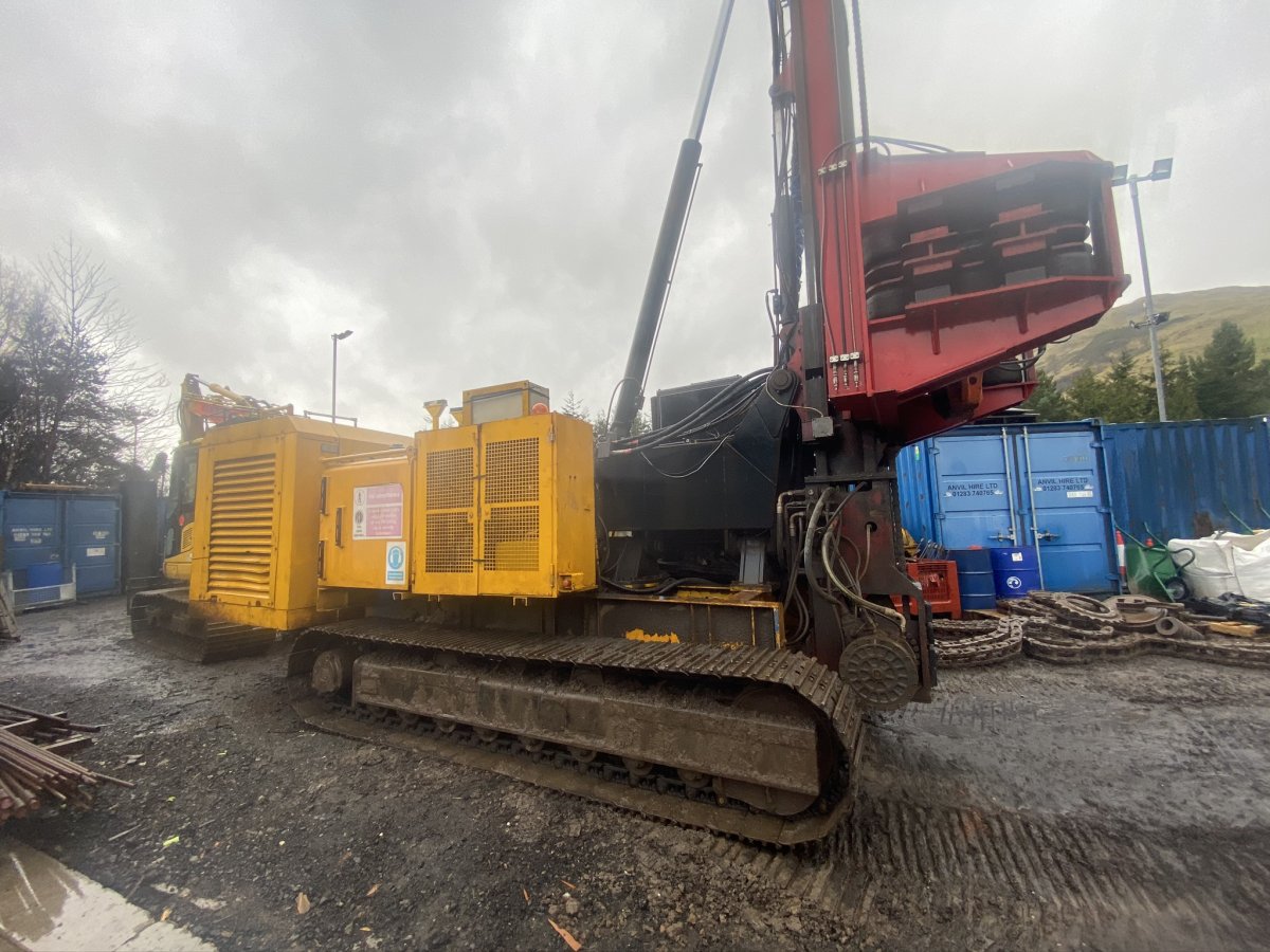

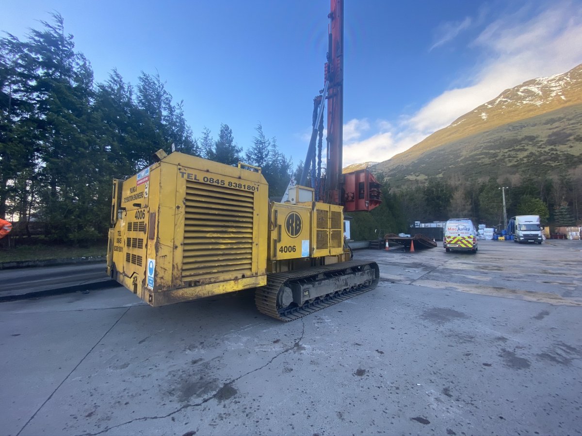

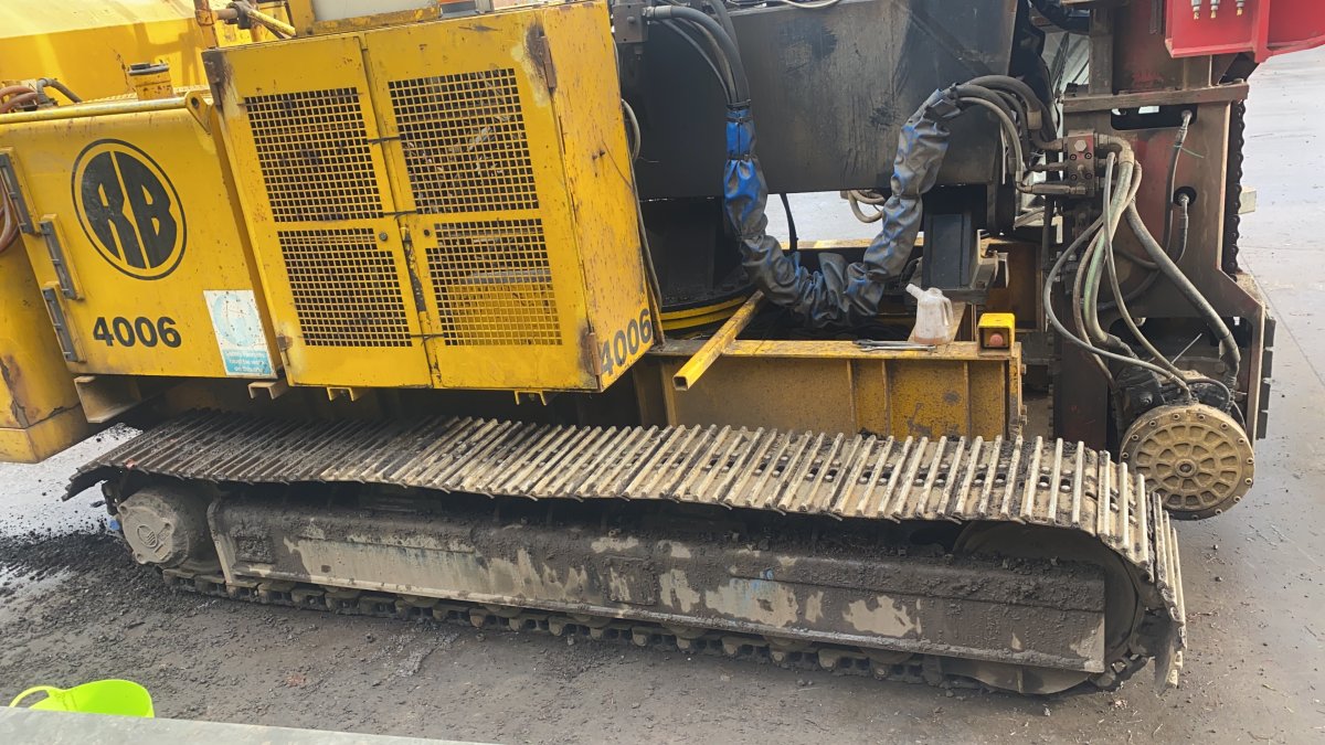

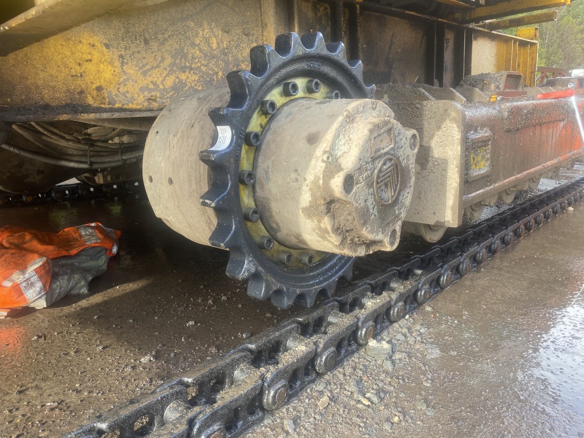

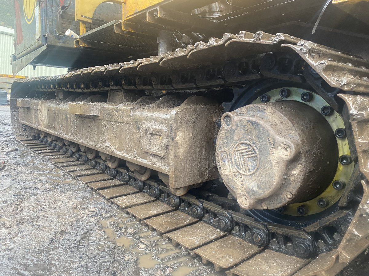

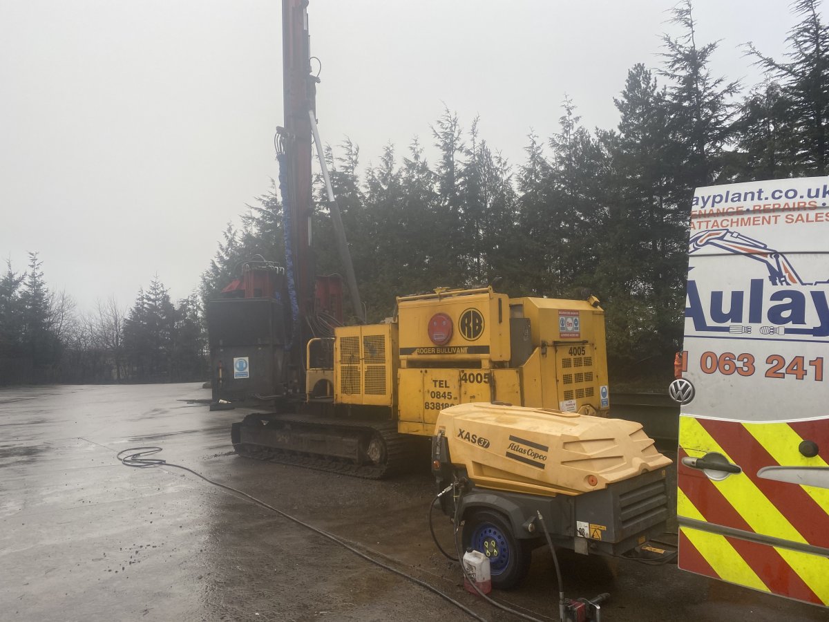

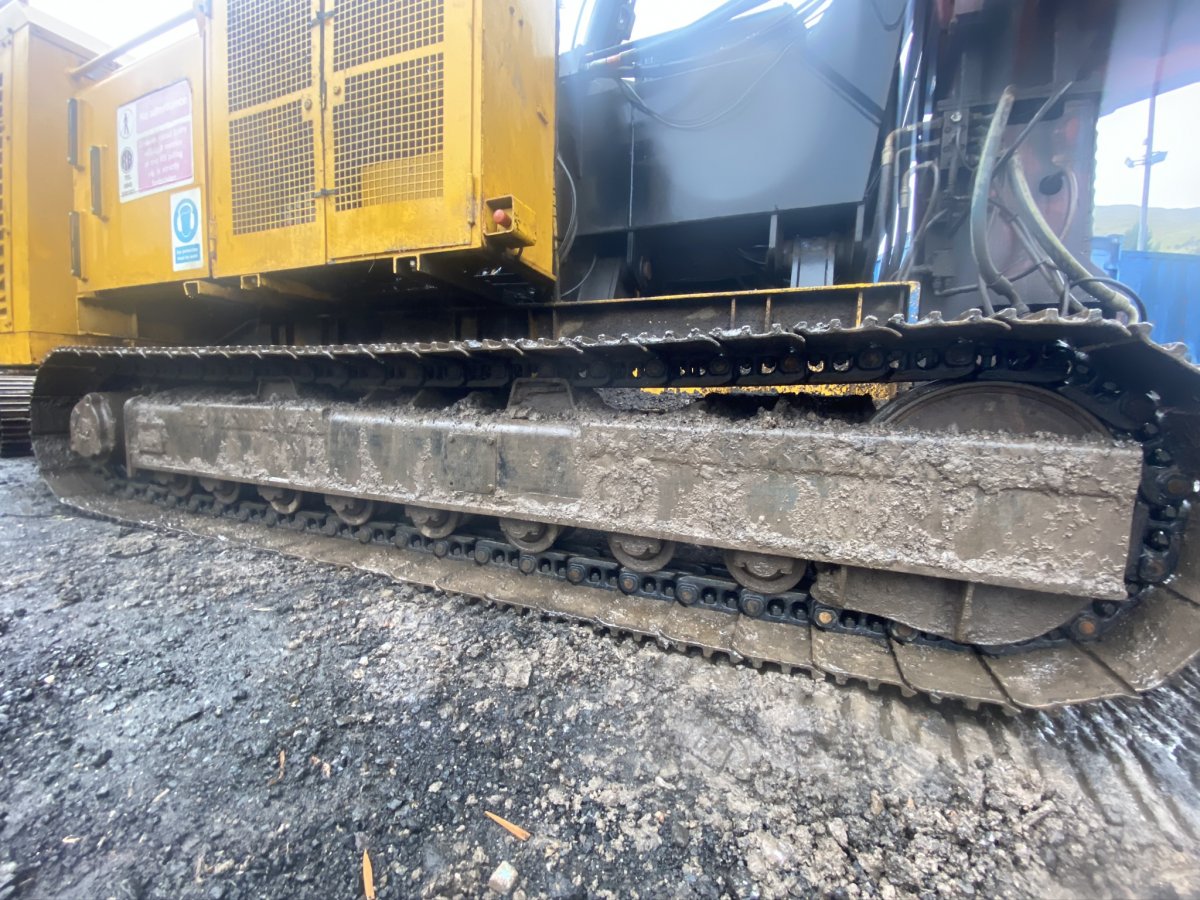

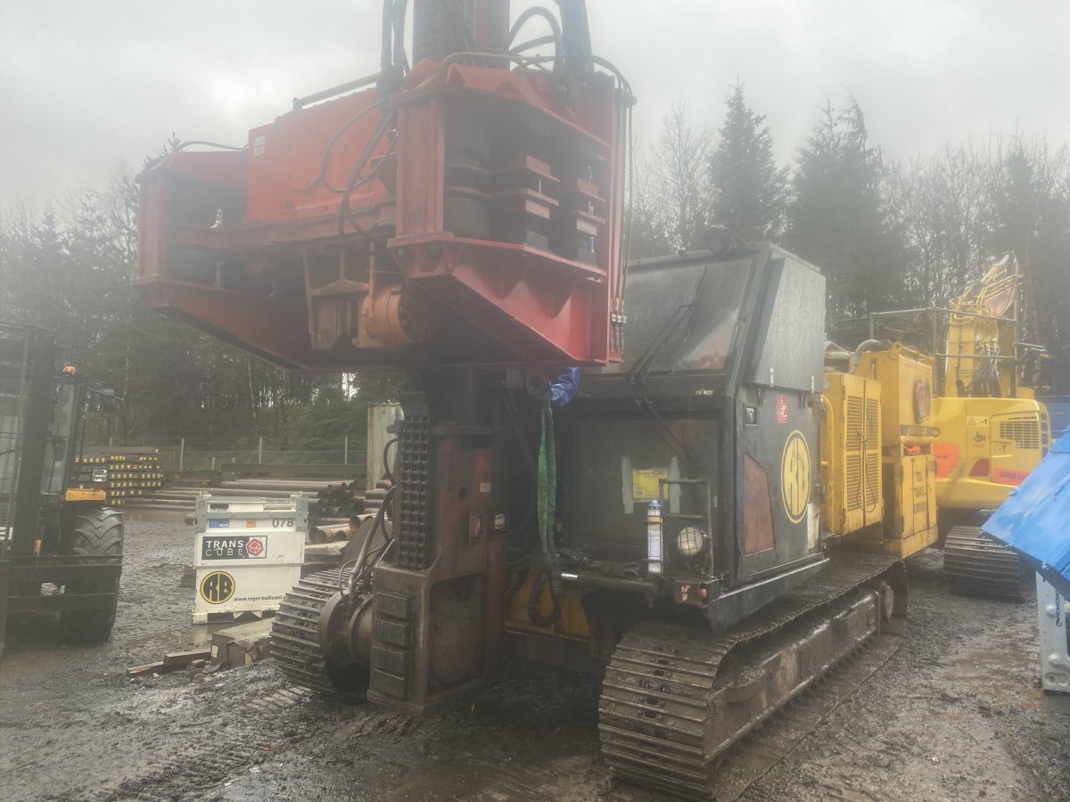

Piling Rig in for new chains and sprockets after cracking 2 bushes.

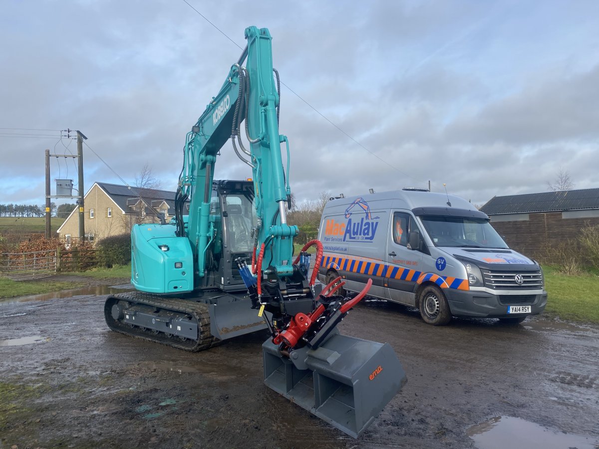

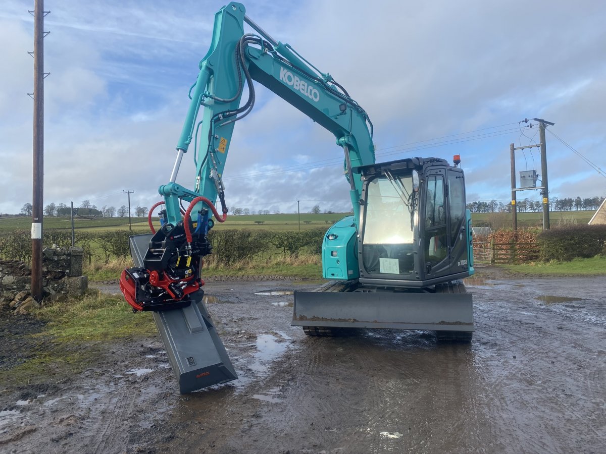

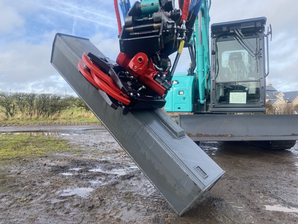

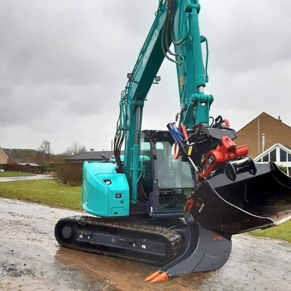

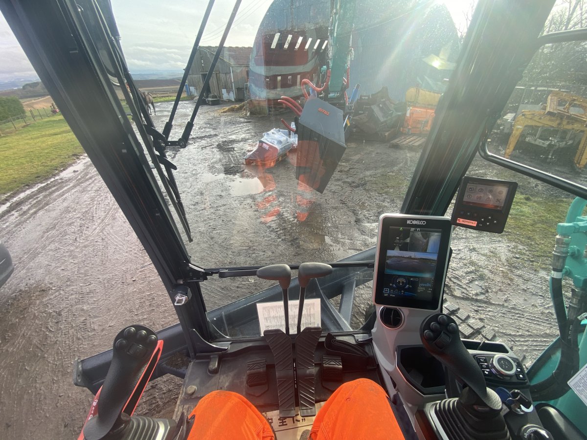

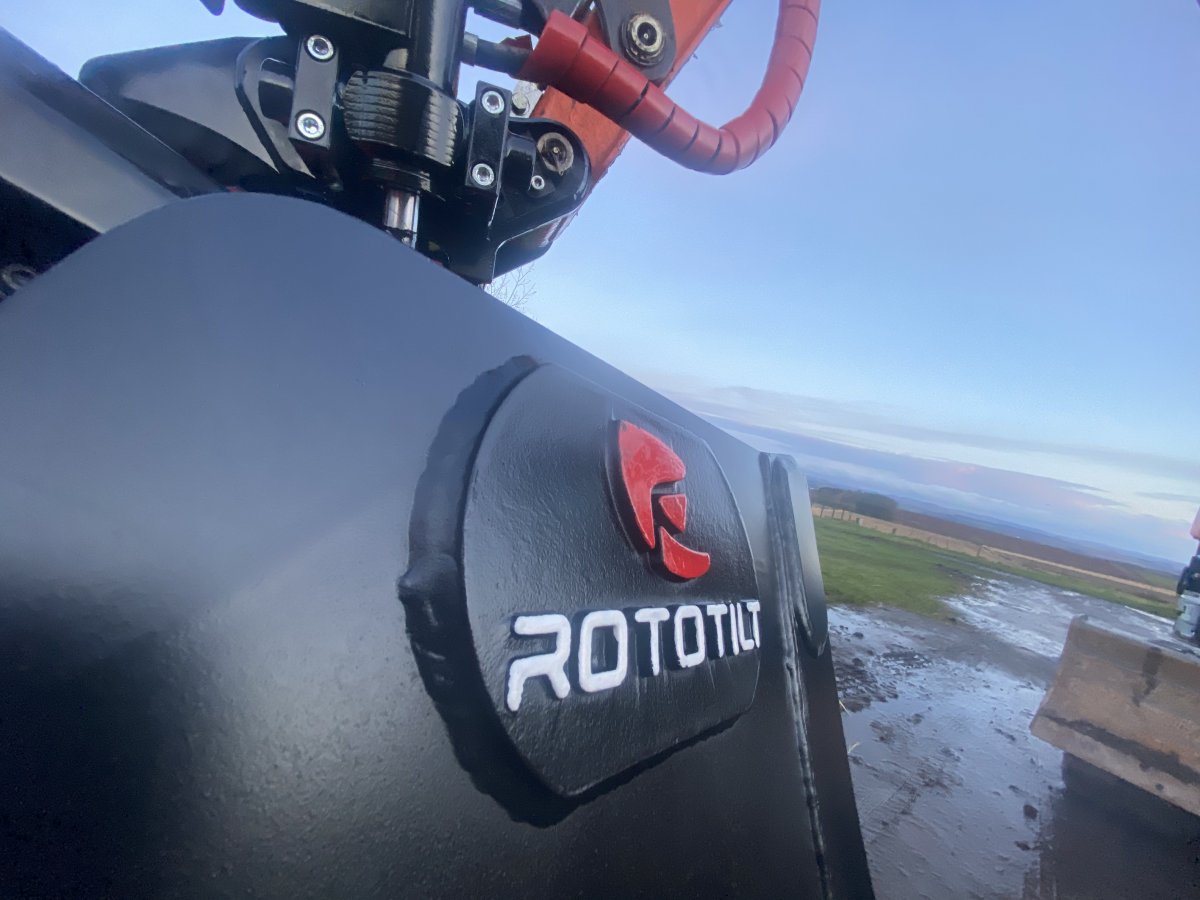

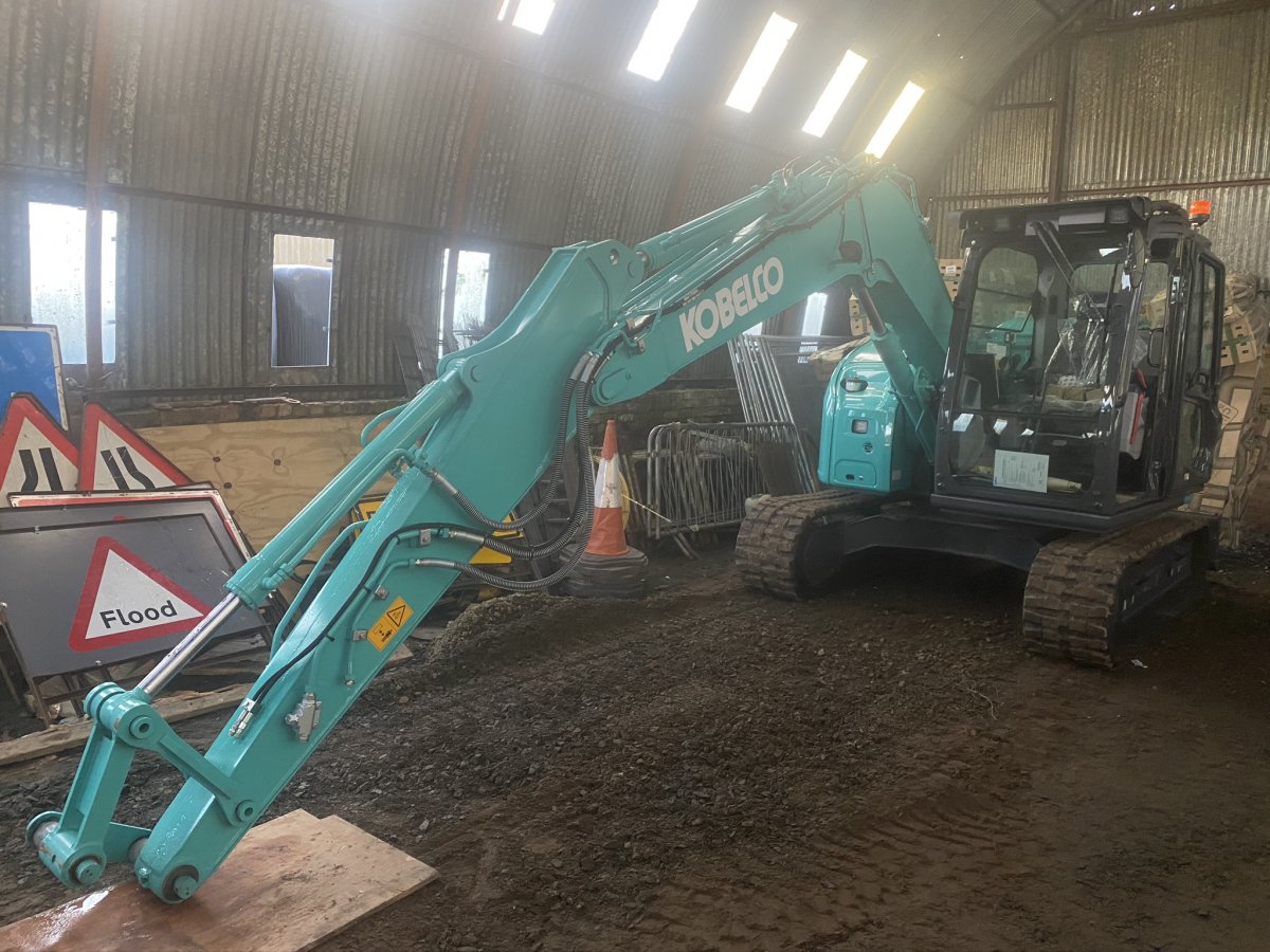

Brand New kobelco Sk75SR fitted with Rototilt R3, tilty came with ICS, securelock,greaser and bucket package.

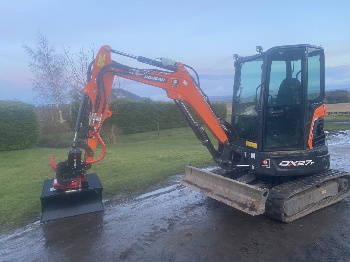

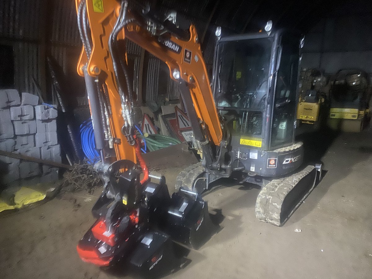

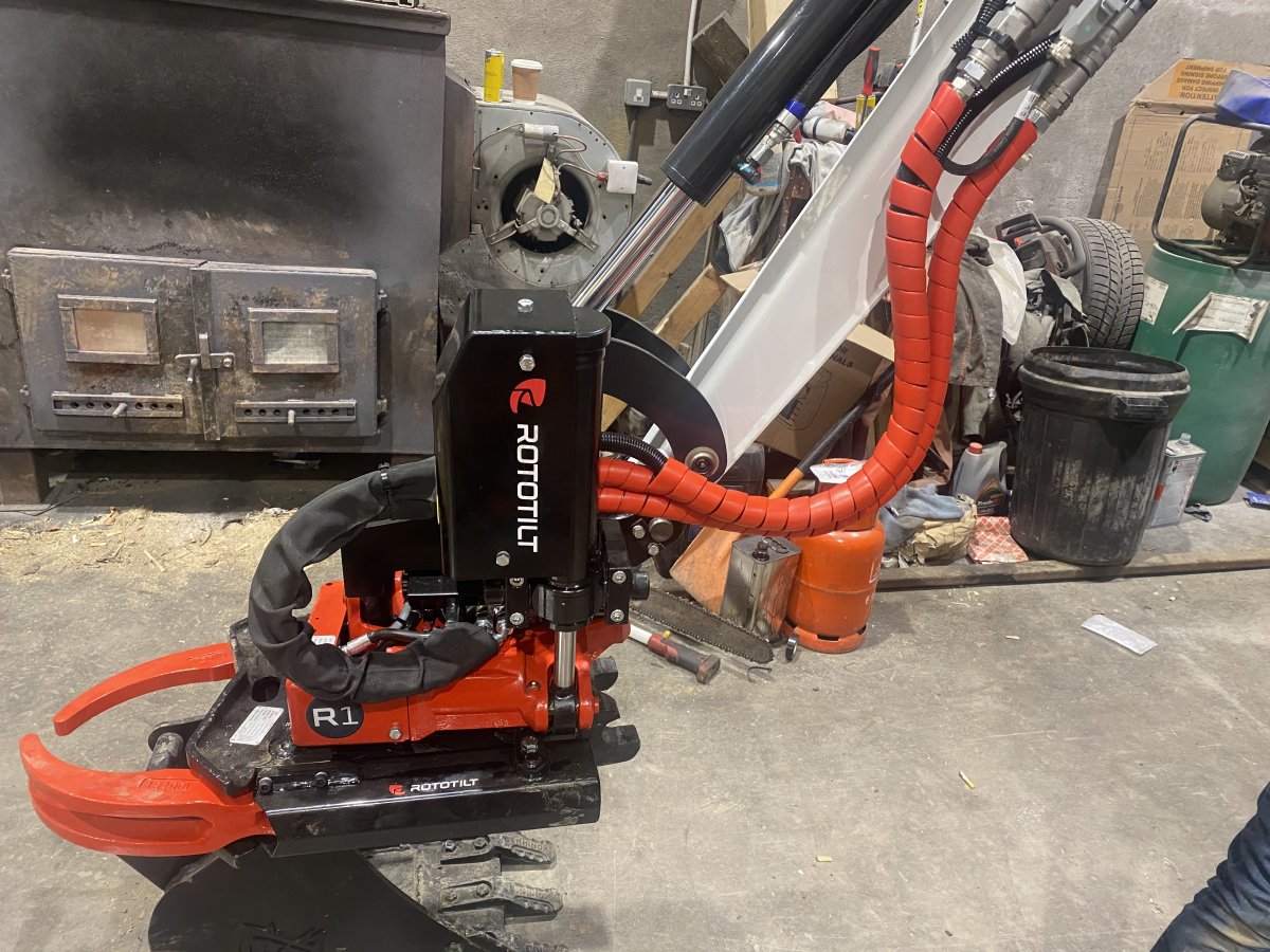

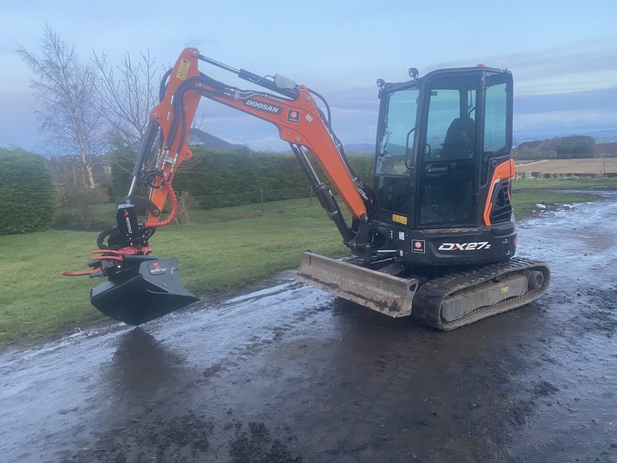

Another lovely little Rototilt R1 installed a few weeks ago on behalf of Rototilt UK

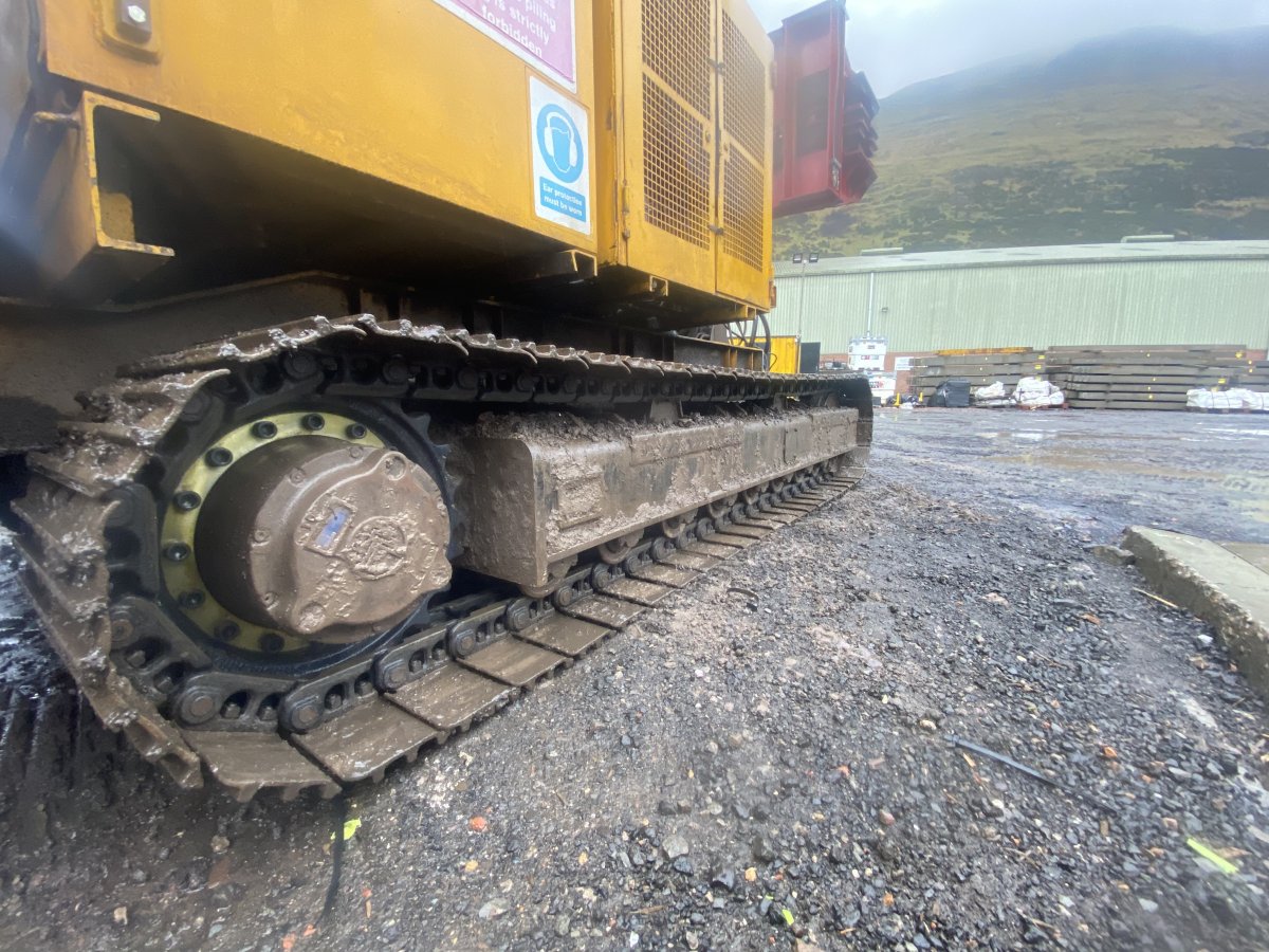

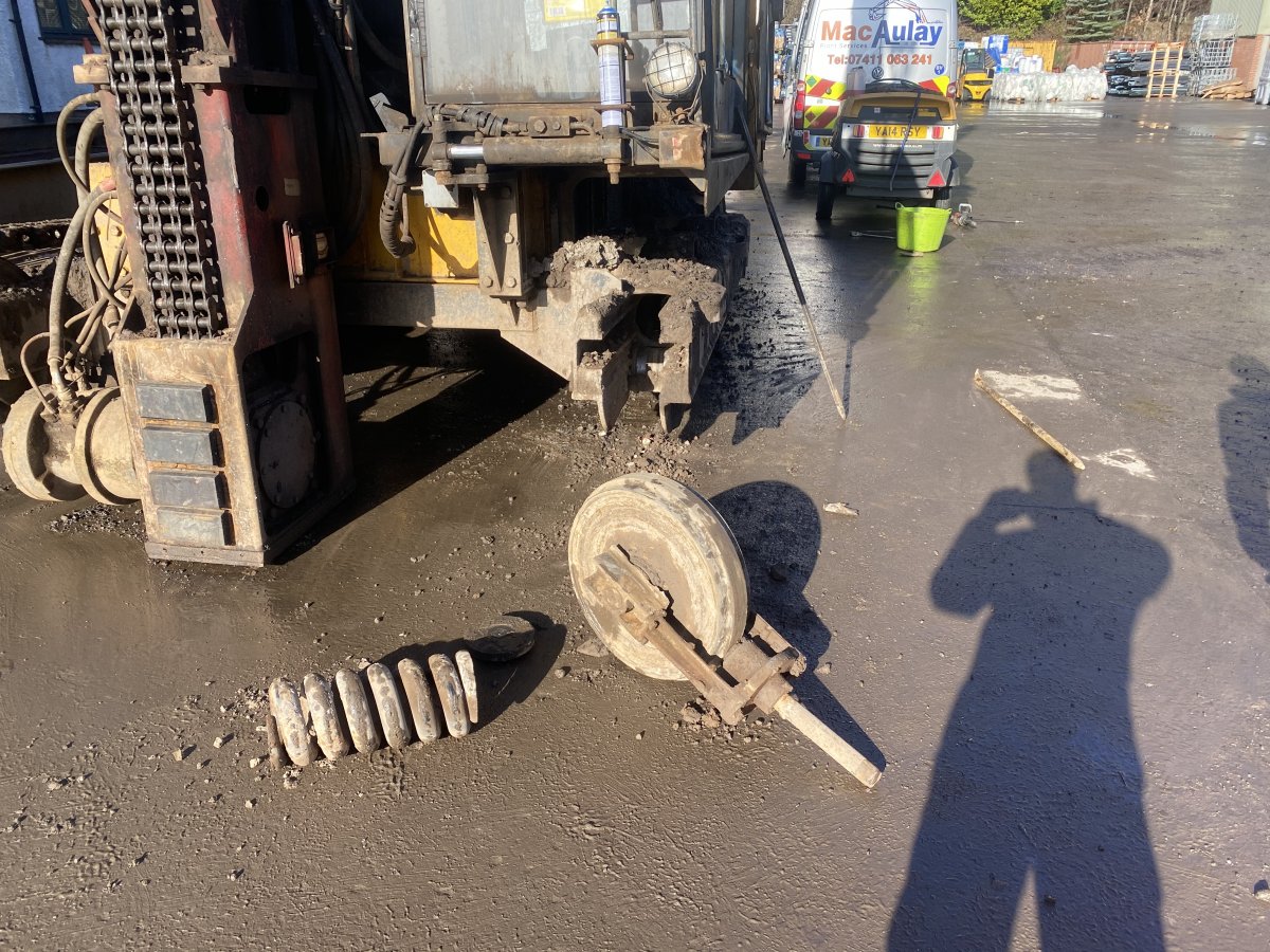

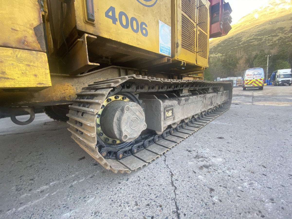

Another Drill rig undercarriage for Astrak. This one was found with snapped recoil rod

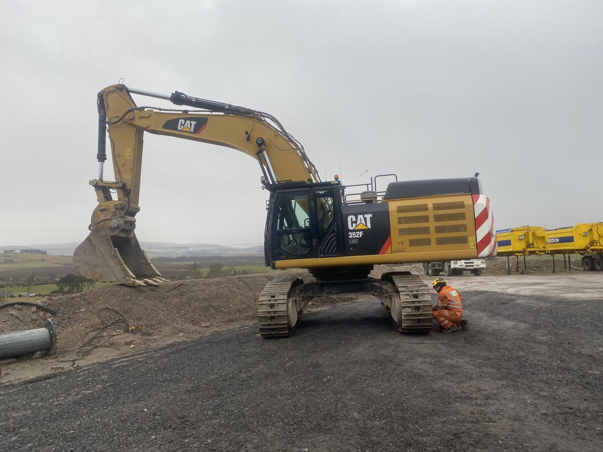

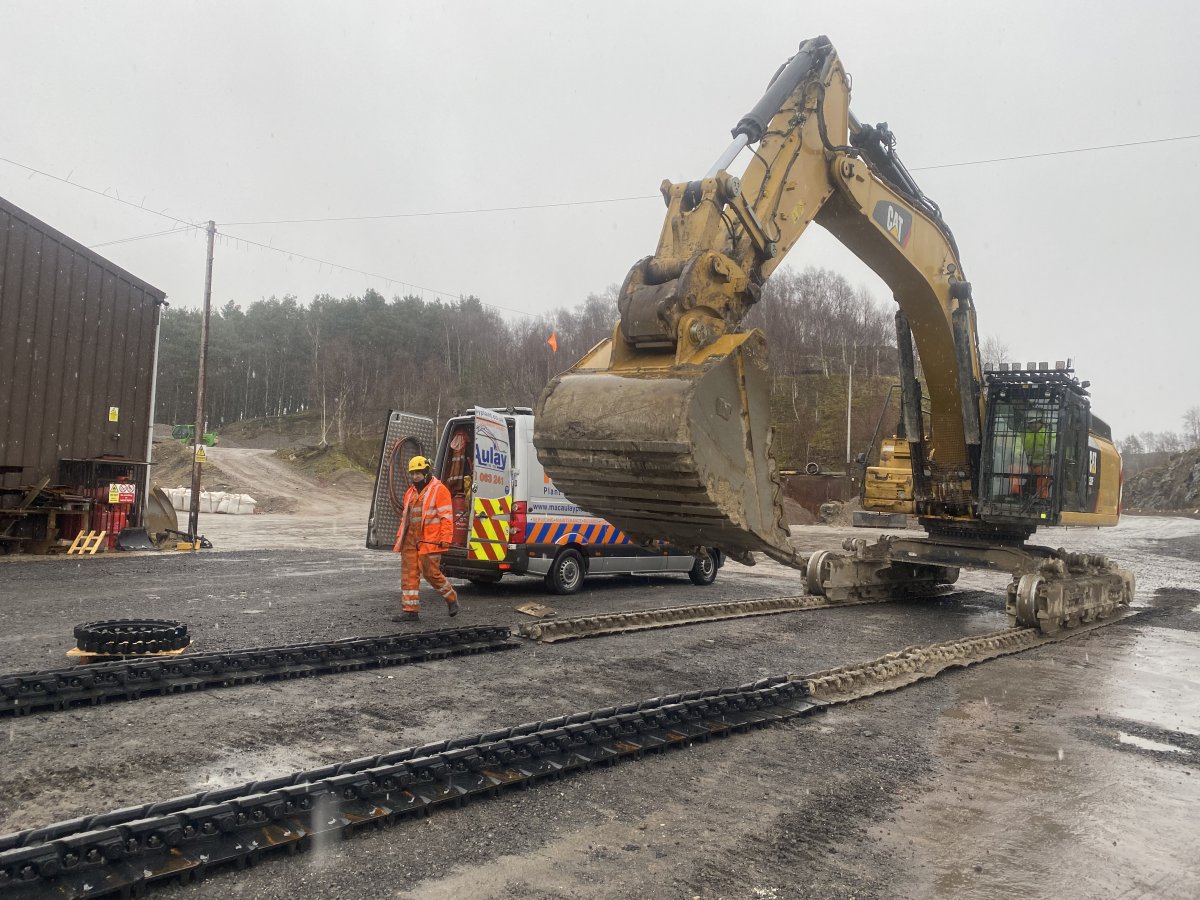

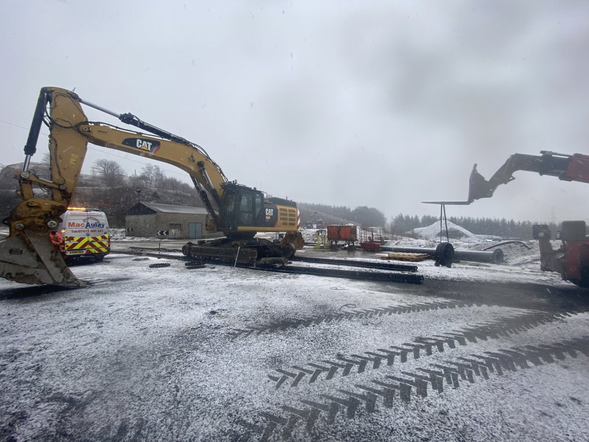

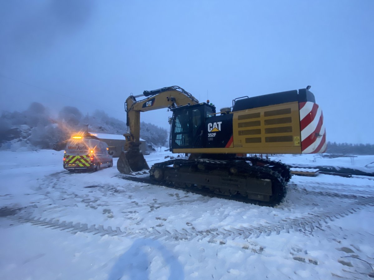

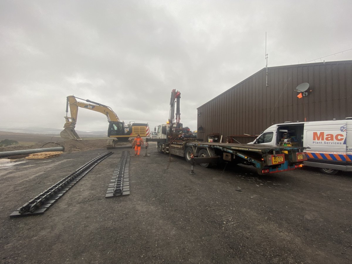

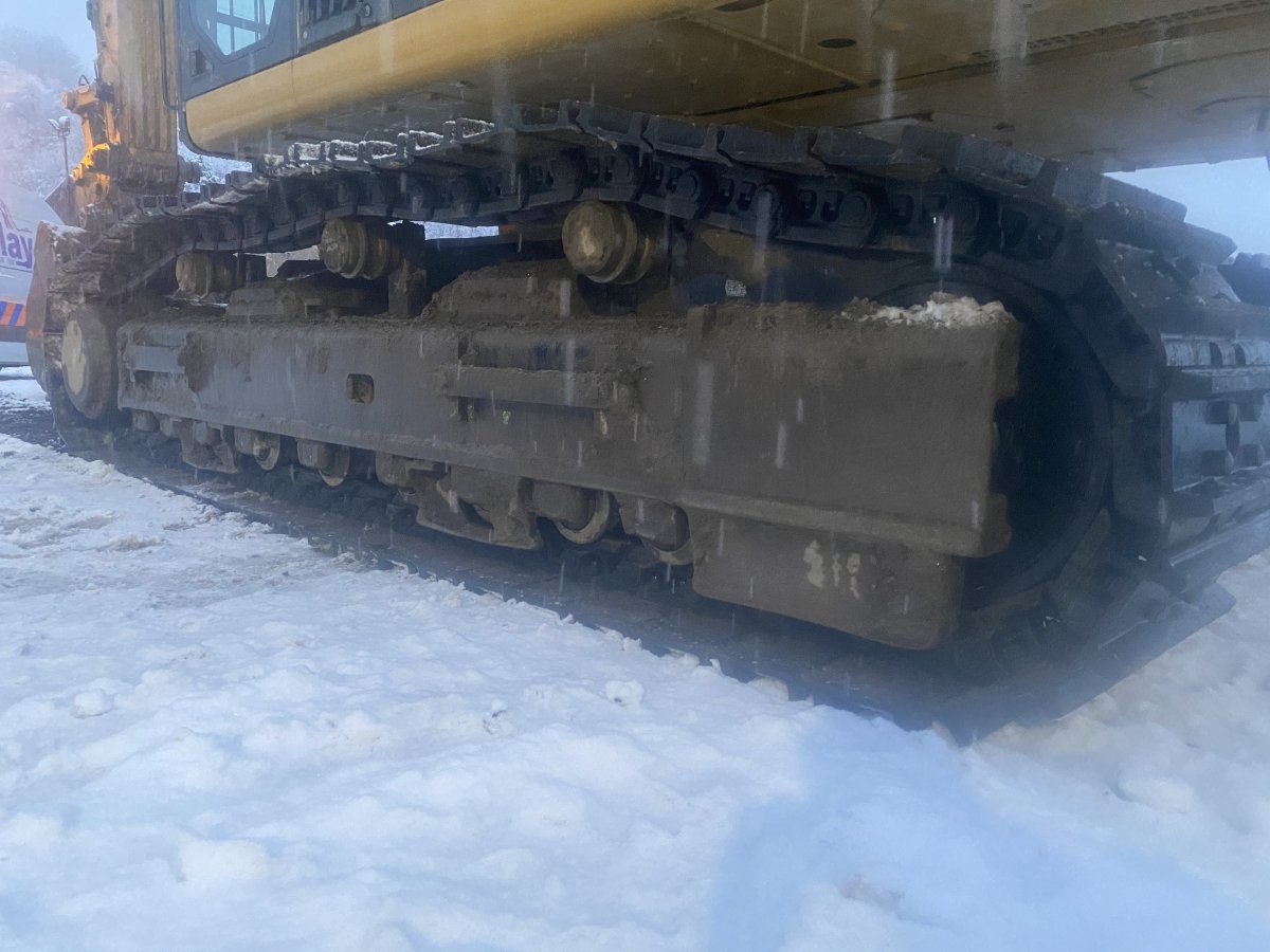

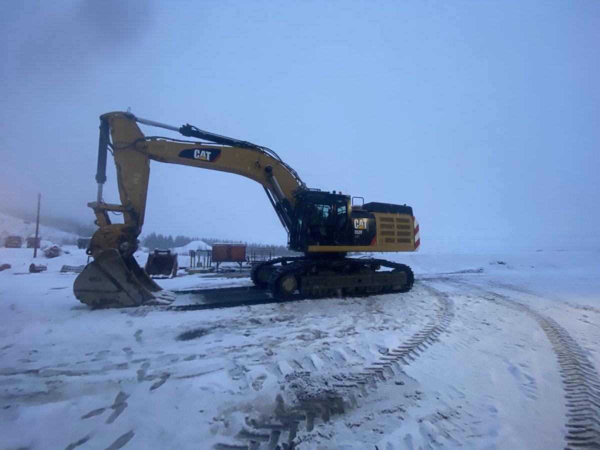

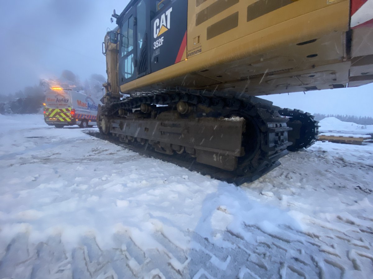

Big CAT 352F for chain, pads, sprockets & idlers on behalf of Astrak

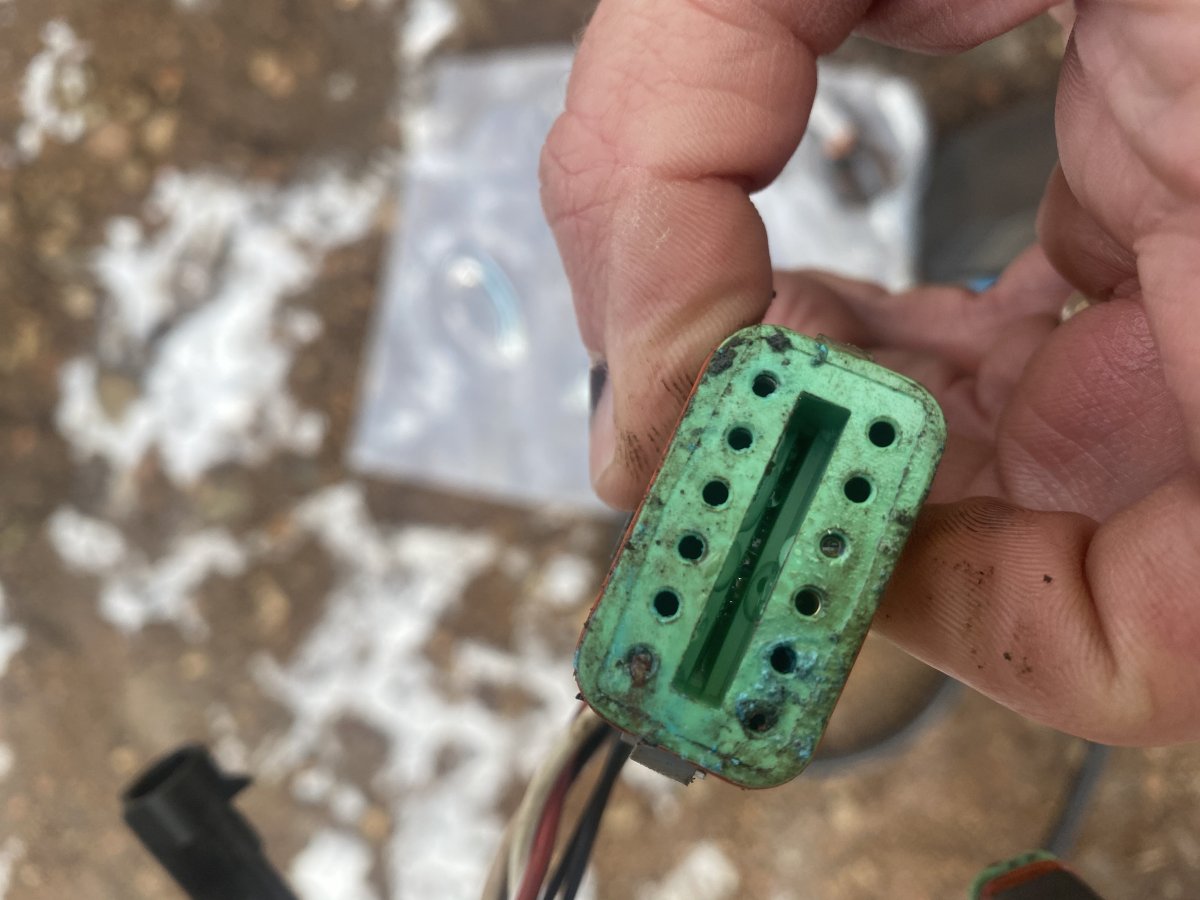

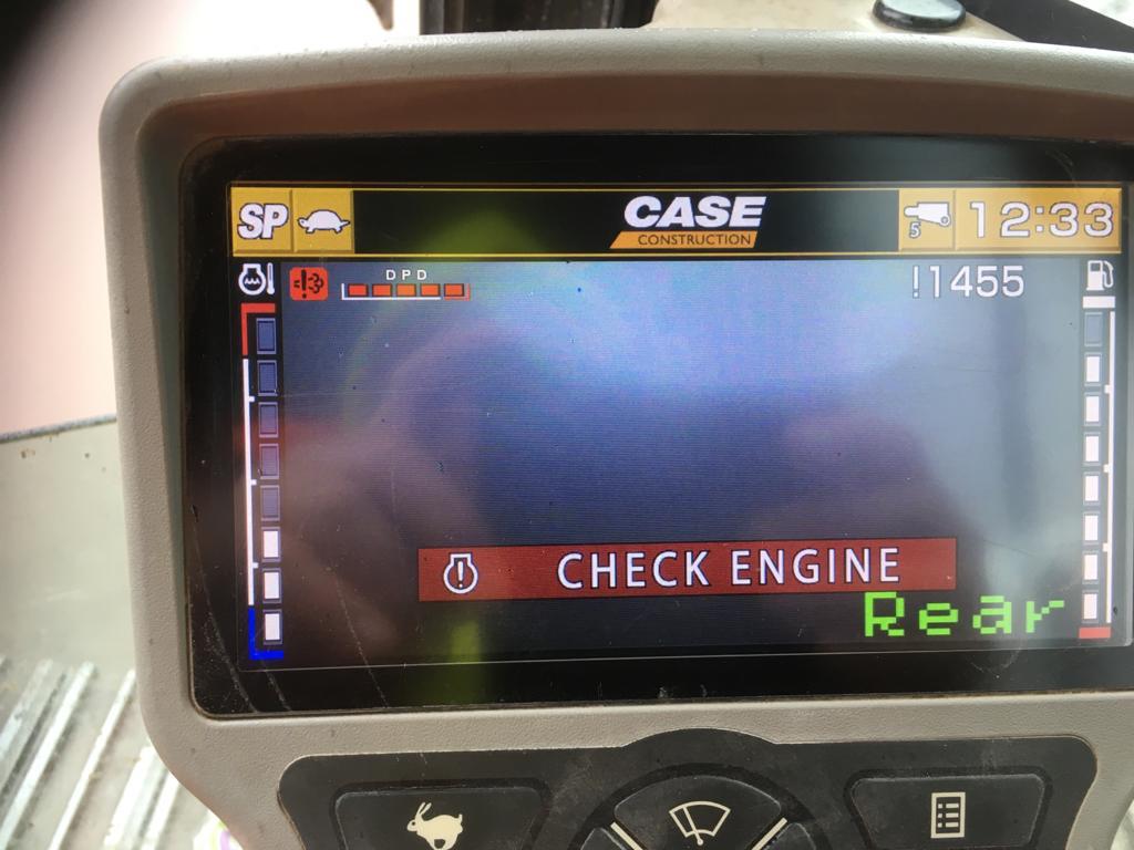

Case with regen fault, with damaged pins in plug,

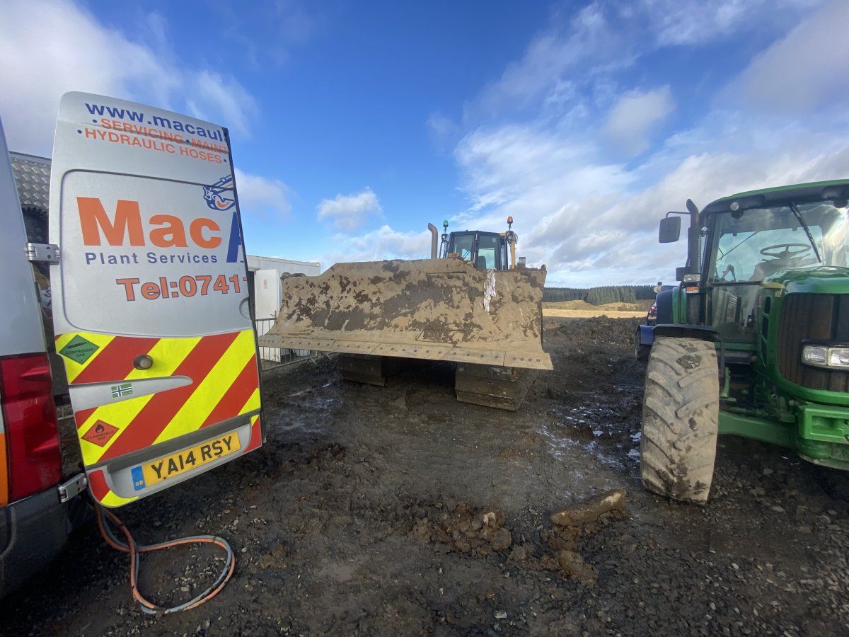

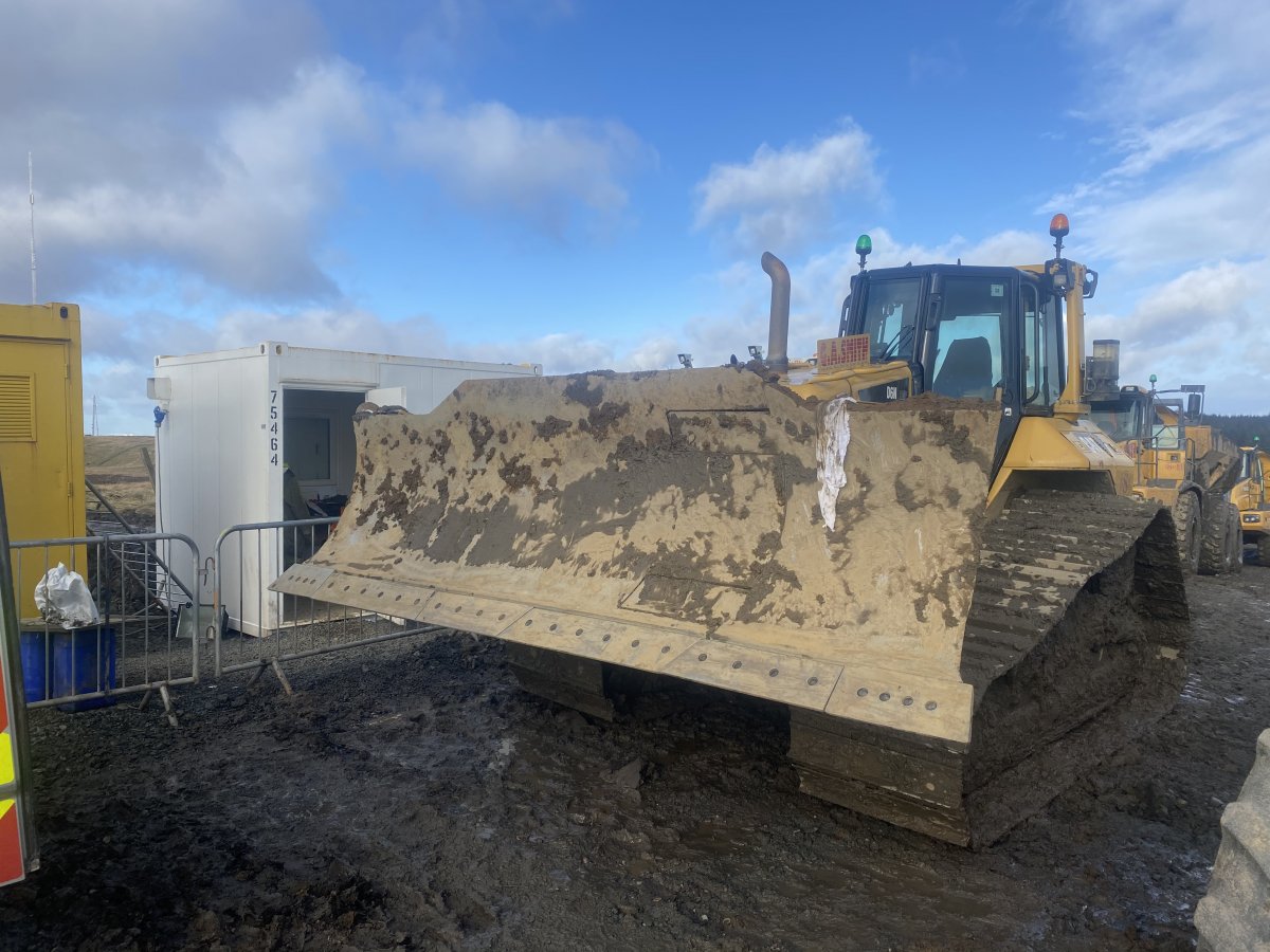

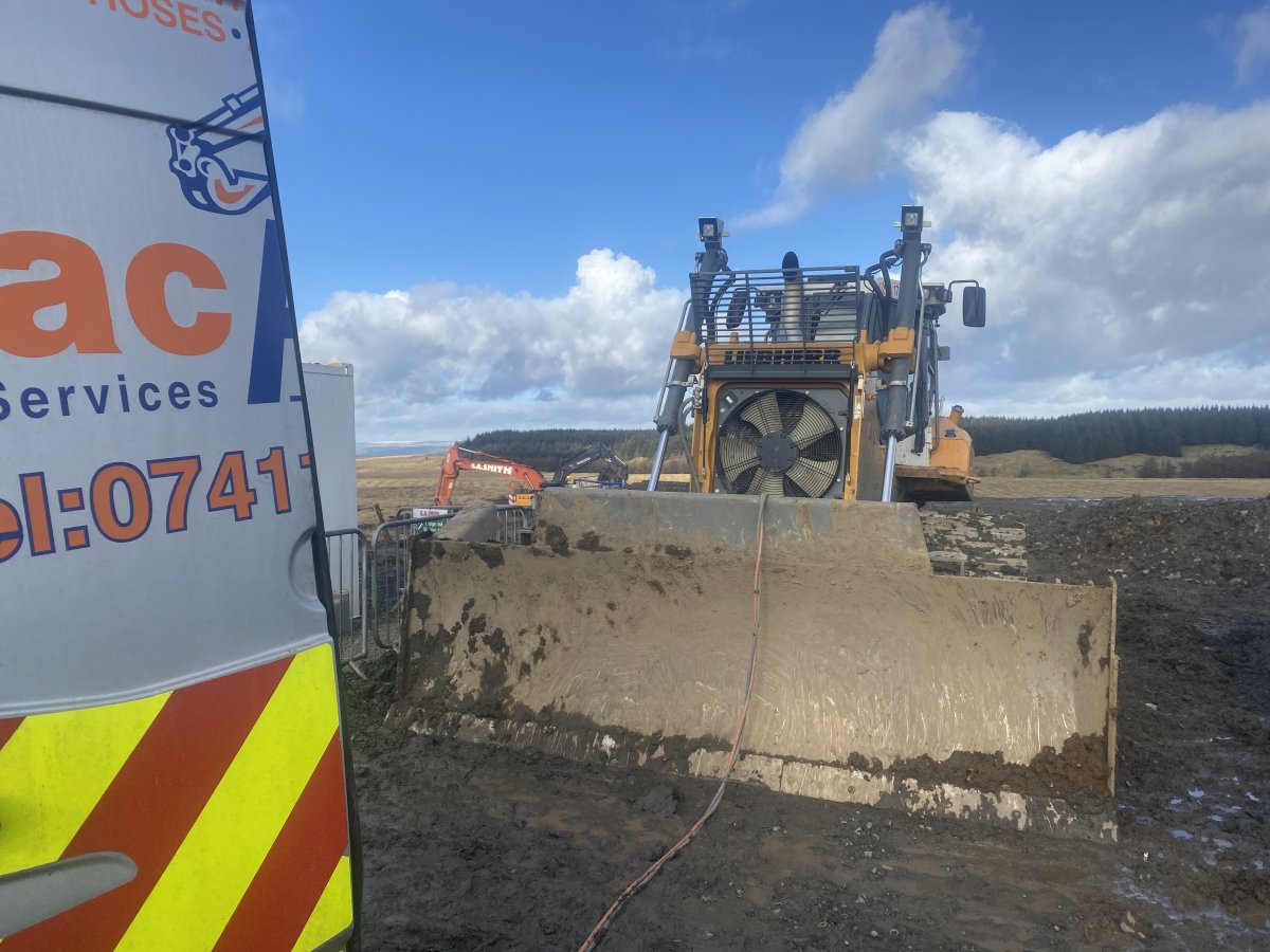

D6N cutting edge turn and Liebherr pr736 need some repairs to grill after grounding out
