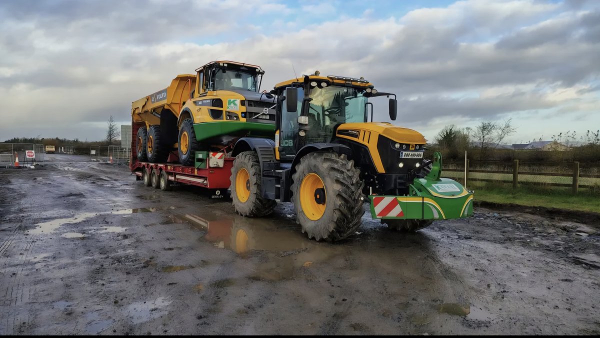

Picture from 22
Whilever there’s the “if it’s on it’s gone” mentality, people will keep pulling stupid loads. If I was a haulier I’d be furious at what the “agricultural” tractor and lowloader brigade currently get away with daily while more rules and regulations are imposed on them.
