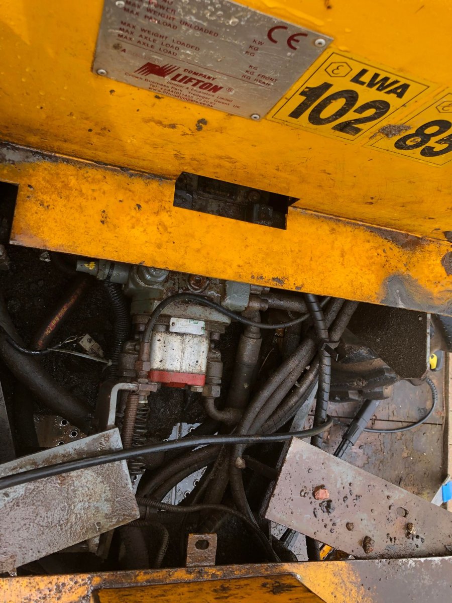

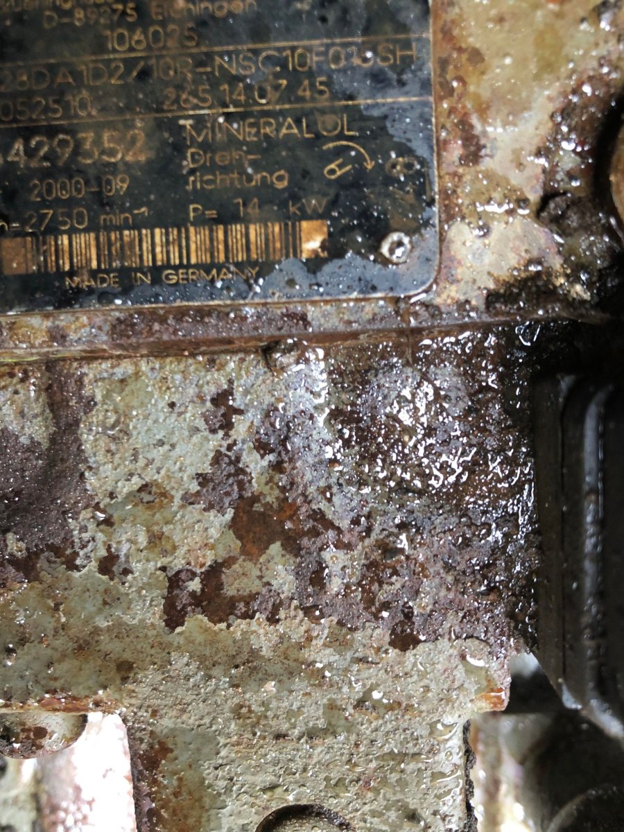

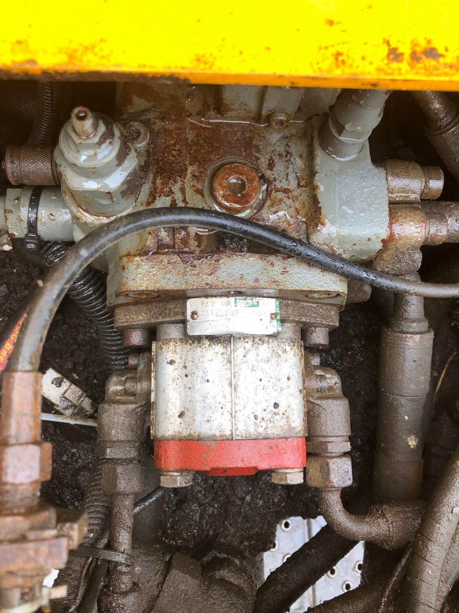

Floor plate up take some pictures I will arrow it all for you!! Guessing when the oil was changed the tank cap o ring is in place?

Cap O ring is in place

Mick-the-fitter
Mick-the-fitter
It’s what I do!
The small pump with the red end is a gear pump, (steering/tip) and the big lump behind it is the hydrostatic pump which on this dumper is mechanically operated drive (forward/reverse!):Slowing when hot could be a worn pump!
