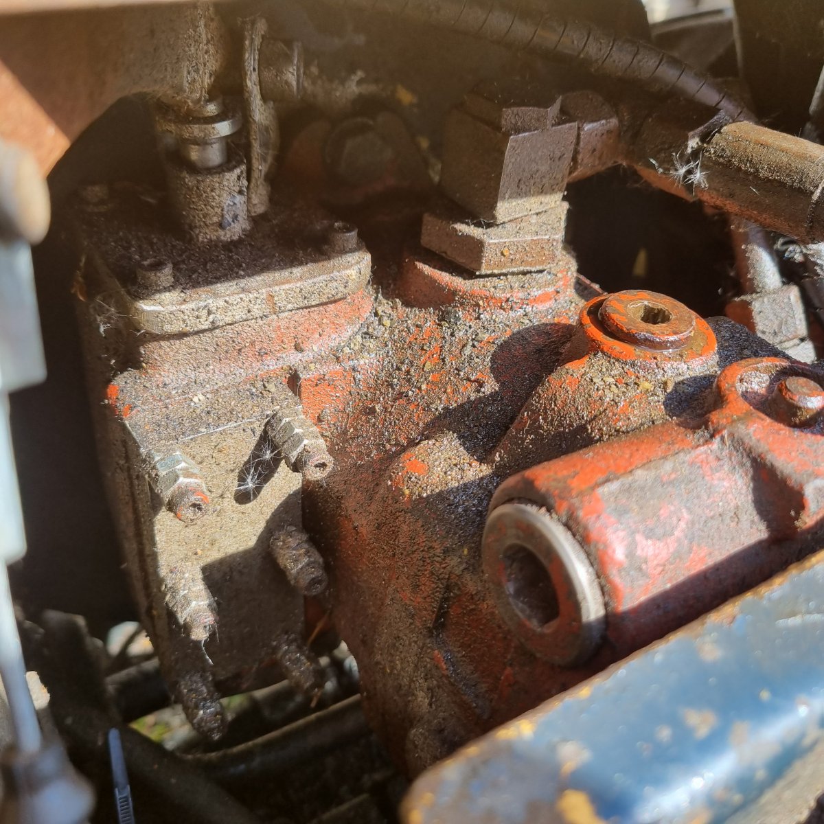

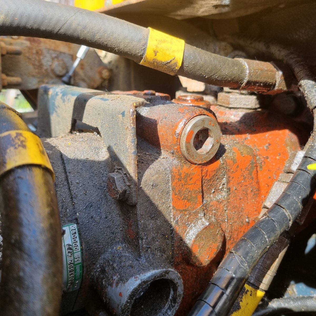

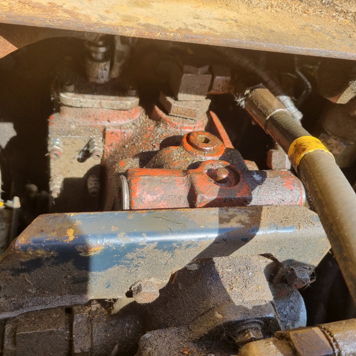

I was hoping you could tell me is it repairable if you look at the photos I just put up what's behind the plate below the leaver it been spaced out with 3 nuts on each Alan bolt

View attachment 37626I was hoping you could tell me is it repairable if you look at the photos I just put up what's behind the plate below the leaver it been spaced out with 3 nuts on each Alan bolt
would guess someone lost/didn't have the right length bolts and packed them ..... piston pump for sure .. where are the feed and Pressure lines coming in/out can't see them from those pix ... assume the very top line on the 'block banjo' is case drain.
I'd guess the button under the lever is pump control @Mick-the-fitter ?? .... being optimistic, I'm hoping it's in neutral and not pressurising

I'd be guessing that under that plate is the mechanical connection from your control lever for F/R, controlling the swash plate in the pump ... and judging by the 'packer nuts' someone's been in there before, possibly for a similar issue?? :unsure:

Sounds like the splined shaft that drives the swash plate for the hydrostatic pump has stopped driving the plate for some reason!
don't 'spose it's on a roll pin Mick? 'praps accessed under that plate with the long SHCS with the packer nuts ...
's obviously been off before :unsure:
first thing it wants is a bloody good wash off, drain the tank down and either whip that plate off ... or pull the pumps onto the bench, for a better view :(
The plate with the packer nuts, looks like its over the forward/reverse valve, looks like the fwd/rev lever coming off the top of it :unsure:
Still might be whipping the the off and having a look inside, no filter, tish build up in there:unsure:
