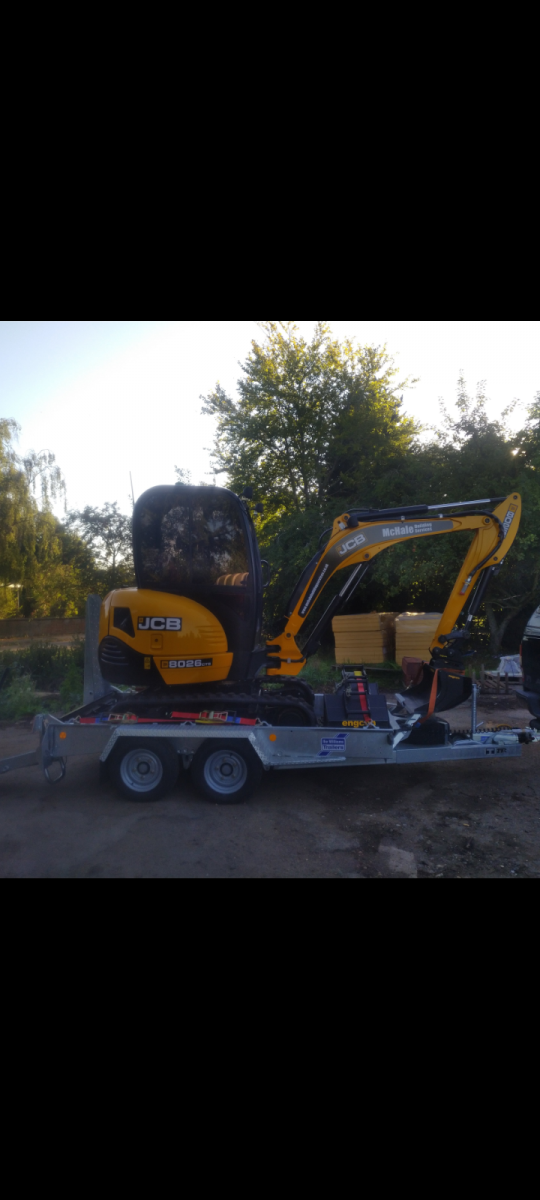

Get 4 straps about 6ft long and cross strap it on both sides theres 2 more ratchets to do but it's a lot quicker than walking round to hook them on. I keep the ratchets on the lashing points when there not in use so there always to hand
This - strap the opposite lashing point on the machine to give you more strap to work with.
Sounds similar to what I do, straps off the blade eyes pulling back, and straps off the eyes by the sprocket pulling forward, the straps cross over each other in the middle.
When not using them, don't roll them up, just unhook them off the digger and hook them on the nearest lashing point on the trailer, and nip them up.
Not a very good photo but @craig described it perfectly. The straps are pretty flat they dont pull down very muchView attachment 41162

Can you get to the sides of the undercarriage?
My 8026 and dx10 both have lashing points on the sides (dx10 is one on blade and one near final drive)
Not a great photo but this is what I end up with
IIRC and I'm sure @JD450A will correct it, you have to restrain 100% of load from moving forward, 50% from moving either side or backwards but there is no requirement for any restraint downwards.
So if this is the case, nothing wrong with cutting an 8x8" block of wood to trap between the blade and the headboard of the trailer and slapping a ratchet across the tracks just under the kingpost where it's easy to tighten up and then one over the bucket...
